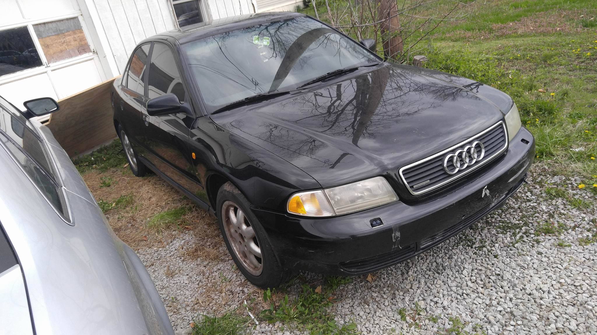

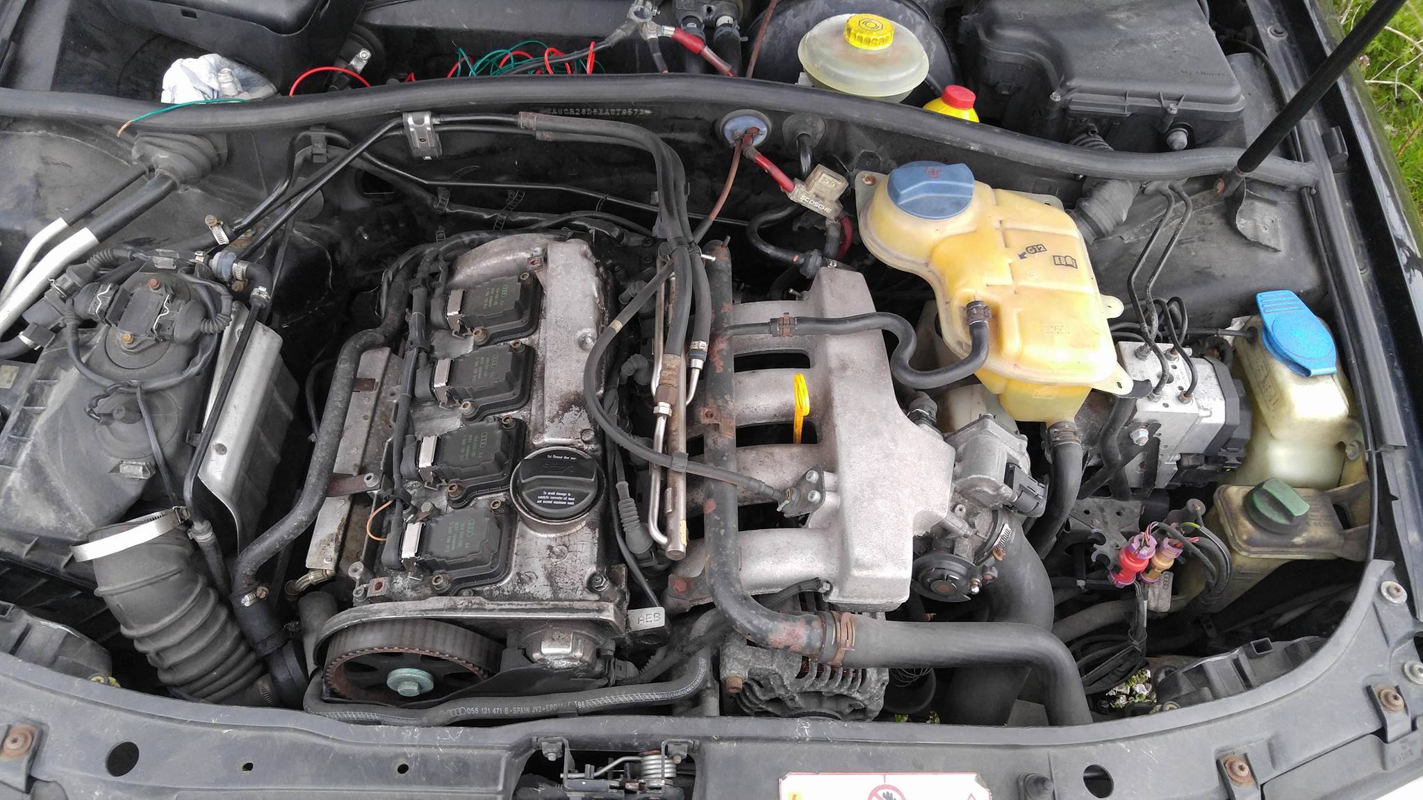

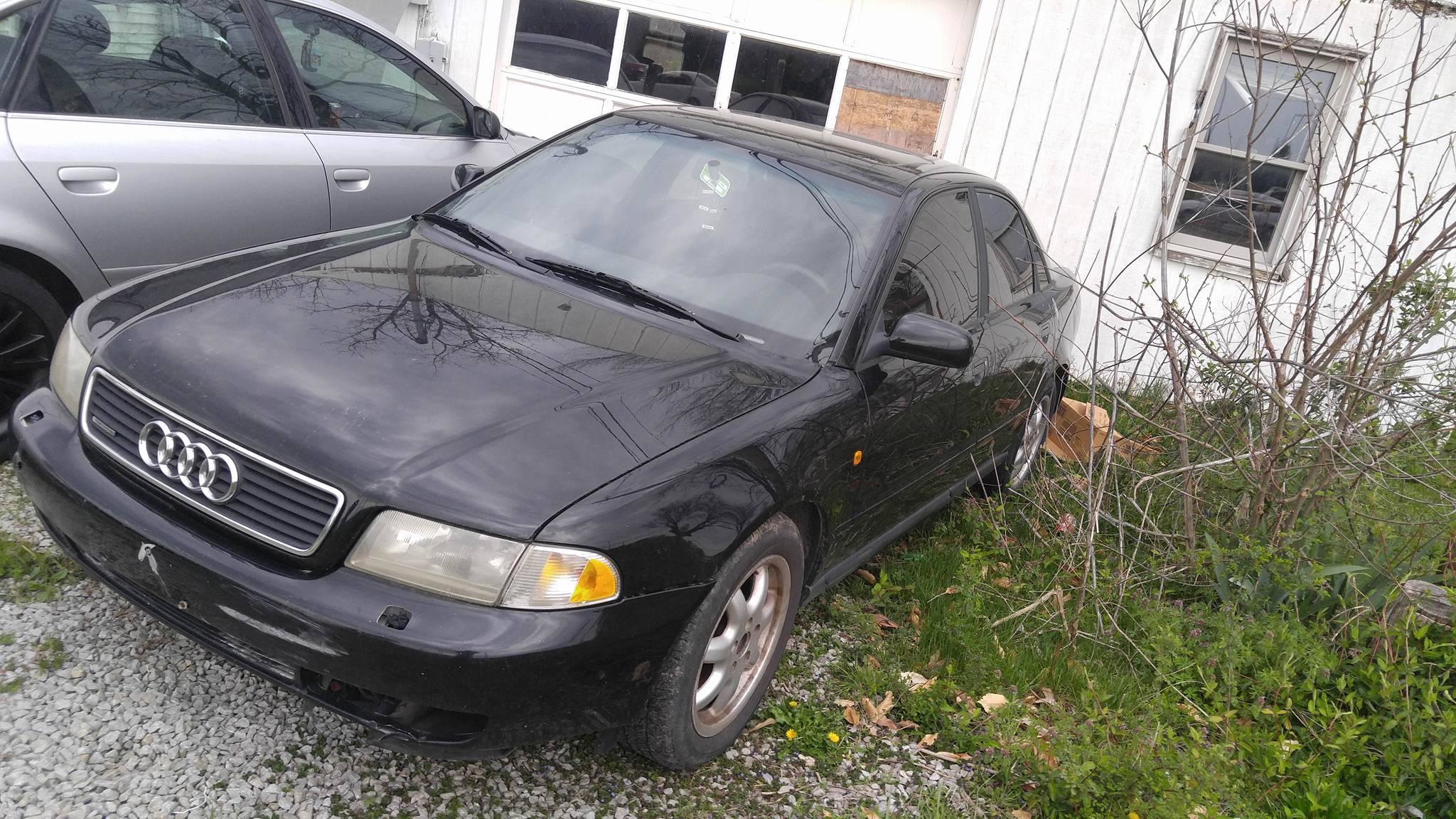

Hey everybody! I'm wanting to build fairly decent track car and weekend street warrior. I'm not looking to be fast, just fun!
I bought a '99 A4 18.TQM last year with 200k miles. Finally, at 214K mile the sludge was just to much and I threw a rod. I loved the hell out of that car. Still do. I started gathering things to build a BT 1.8T but I then purchased an UrS4 and lost interest. About two weeks after driving the S4 and getting bit by the i5 love bug I wanted to push the S4 more but I also didn't want to damage it. So I decided to fix the A4. Since theres a million of them incase I damage or break something. I was looking into doing a AAN swap but that was just a no go. Then somebody turned me onto the 07K. Did some research and figured that will be the way I go.
So now I have a 70k miles 07K from an 06 Beetle sitting in the garage. I have my B5. Whats stopping me from atleast removing the old motor and other things? I lost the key. Ordered a new key and picked it up today from Audi. $95 for a basic key. Good lord.
Anyways here are my plans:
Turbo'd on stock bottom end. ~300awhp
GT28R running somewhere in the teens. I already have the turbo. I'm trying to find a T25 exhaust manifold but haven't had any luck yet.
4:1 center diff. Purchased but waiting to be shipped.
Suspension. Not sure what setup yet.
Standalone - also unsure of setup
Trans will be the original 01A that was mated to the 1.8T. Since I'm not going to be drag racing or pushing an insane amount of power.
Stage 2 clutch
completely gutted and caged
I still need to source a B5 2.8/2.7TT subframe. I have a C5 A6 2.7TT that I'm parting out and people tell me that the subframe is the same at the B5 S4. I can't find any information to back that up so I'm going to match them up once I get the motor and trans out of the 1.8T.
The two main things I'm working on purchasing are the motor mounts and the oil pan from Hank. Once I get those and they are in then I can set the motor and trans in and secure it.
I'm open for questions, suggestions, and anything else!
Once this is done, then my UrS4 gets new bottom end and much bigger turbo!
I'm parting out a 98 A4 2.8FWD and a 01 A6 2.7TT tiptronic is anybody needs parts. Gotta fund my build! lol
