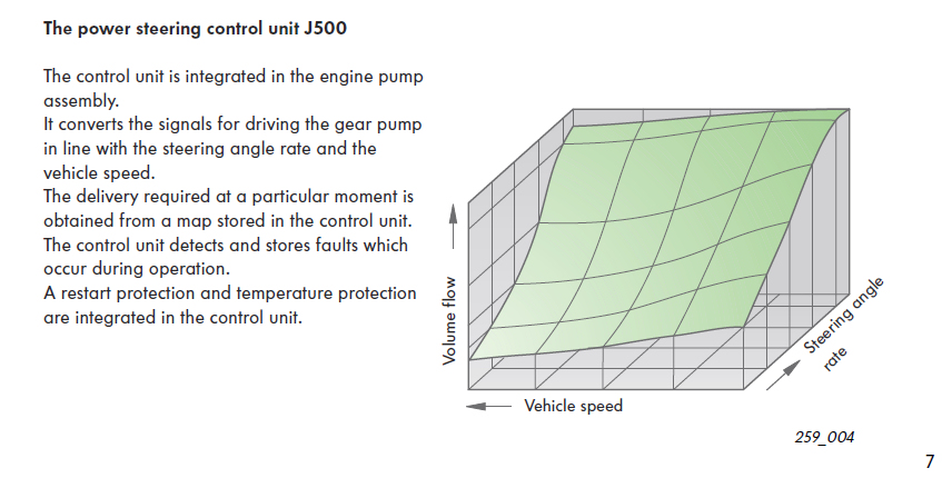

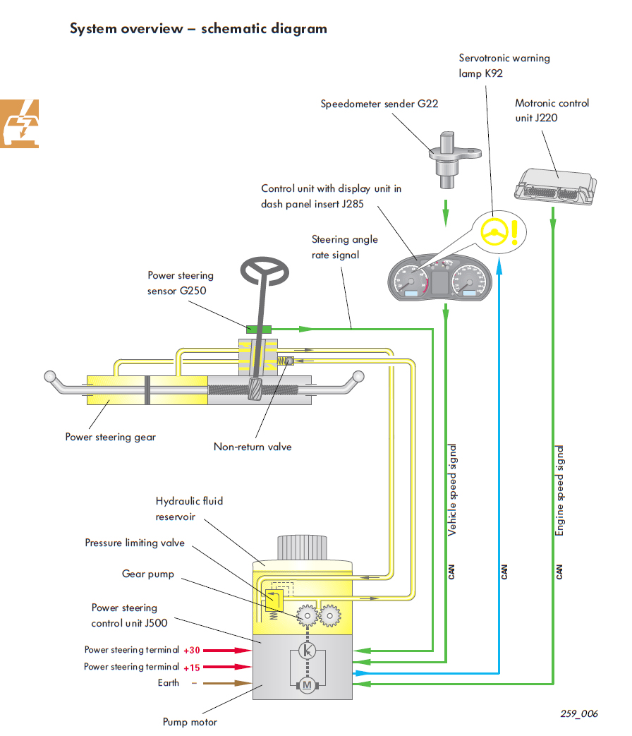

i had a little time so i did some research on this volvo pump/steering aka: EHPAS (Electro Hydraulic Power Assisted Steering)
luckily no extra control module needed, because its integrated on the unit itself, and it want to talk on the CAN bus system.....
it might work without the CAN bus but im sure its function will be limited
Increase assist - message for fast steering wheel movement from the steering wheel angle sensor
Decrease assist - high vehicle speed message from the BCM
also, Maximum assist pressure is 120 bar, a bit too mush for small chassis cars, around 100bar
do you have any other info? did you test yours yet?
Thank you!

The pump operates without CAN signals, albeit at one speed where drawn amperage is dependent on steering load (5-60A). Other pumps have drawbacks similar to this, with the exception being the second generation MR2 pump that has a regular vehicle speed sensor input. The drawback there is that they're popular and therefore expensive.
Working on the brackets now. Yeah, the unit "works," but I've only powered it on without lines/fluid/load. Need more time and better fabricating skills.

I understand it works as a basic pump, but we will miss a lot without the signals

varia wrote:I understand it works as a basic pump, but we will miss a lot without the signals
That's correct - we will be missing out on the noise reducing and energy saving features without CAN signals. The pump runs at 100% without these inputs.
