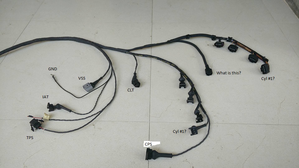

I have laid out the harness I have in the engine bay on my AEB. A few thing are clear: The connector for the CLT sensor is round, not square. The VSS connector is rounded, not square. I also have an unknown connector. I think this harness was made for a later gen engine (b6? transverse 1.8t?)
So, the issues:

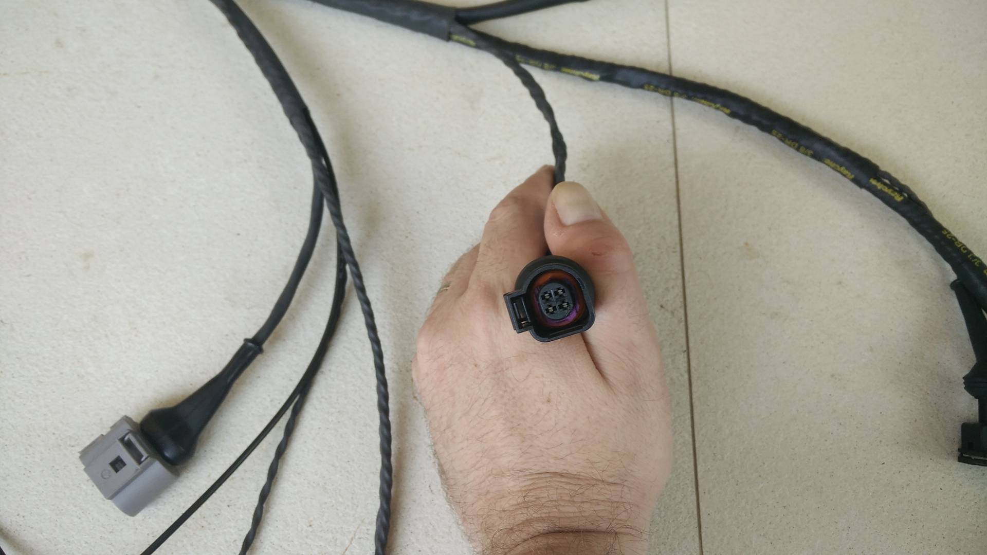

1. The CLT connector issue I can fix by just getting a round connector sensor. Should just fit right in the old style sensor place.

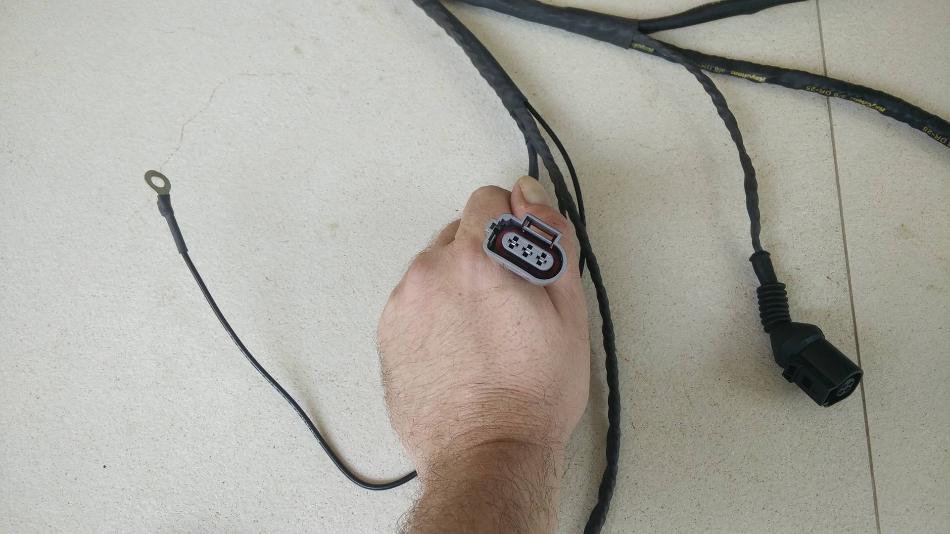

2. The VSS connector is a little more complicated. Do I a. cut off the current rounded connector on the VEMS harness and splice in the square connector? Or b. Can I buy a (later) rounded style connector VSS and bolt it into my trans?

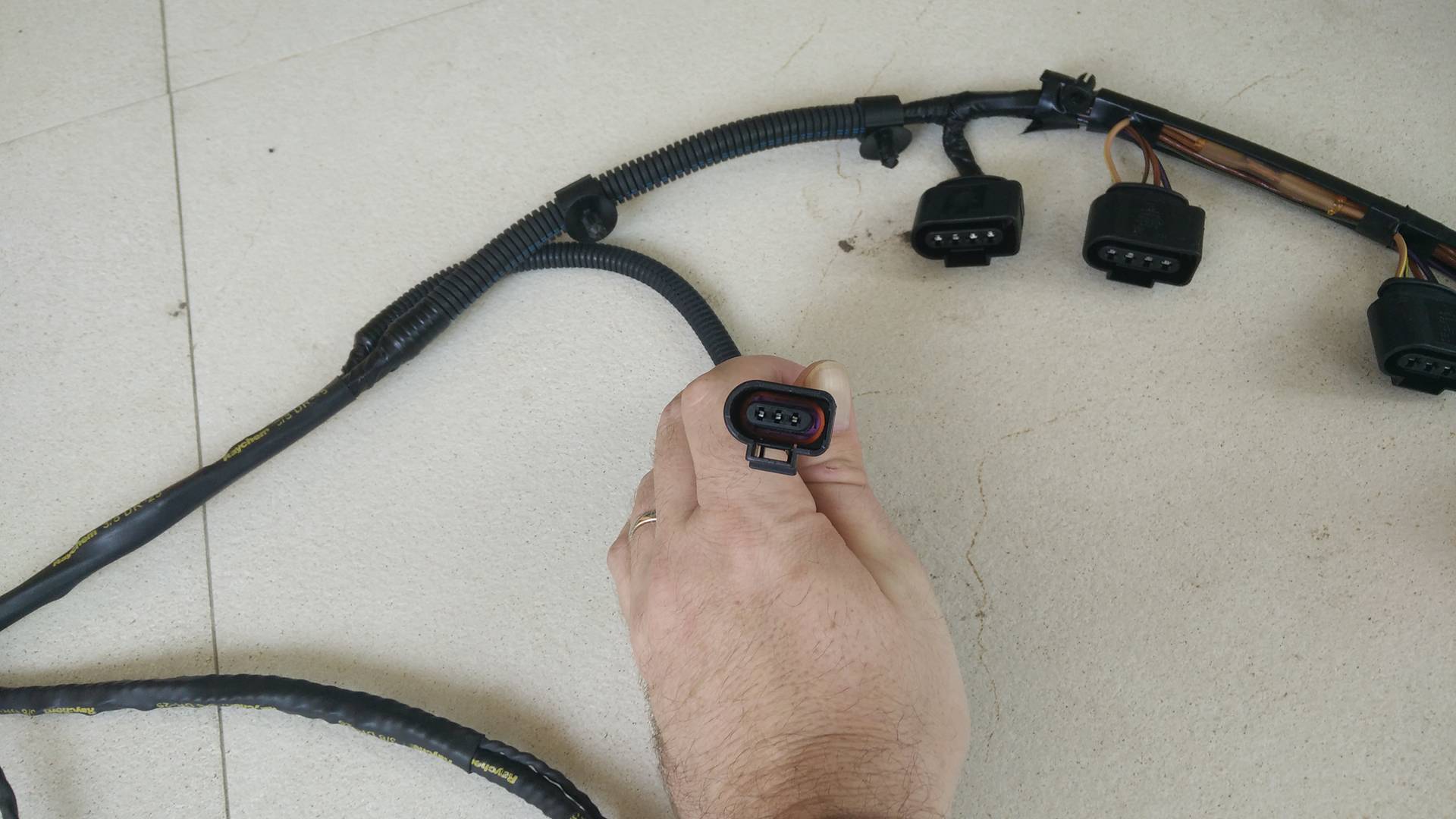

3. Unknown connector with 3 pins. No idea what it is. Do I need it?
4. TPS does not have the idle wires in it. IIRC, Marc said not really needed on an AEB, just adjust timing/idle speed.
5. There is a loose wire in the harness labeled FPR. I assume this is for a fuel pressure sensor. Correct? Do I need it?
I have marked the connectors in the overview picture. Please comment.

I think the unknown connector might be the AC pressure switch. Thoughts?
https://www.ecstuning.com/Audi-B6_A4-Qu ... ES2085410/
The connector matches. I say this because the other connectors seem to be B6 style.
Re: Game time: Name that connector...
3 pin near coils would be cam signal?

Name that connector: Solved?
To update:
The connector I labeled VSS is not VSS, but the crank position sensor. I is a VEMS n00b.
I have ordered the rounded style green CLT sensor (B6) and crank position sensor (B6) from ECS.

Re: Name that connector: Solved? Cannot trace
Today I managed to trace all wires to the EC18 and EC36 connectors, except the 3 pin connector I believe is the AC pressure switch. Its not wired to the EC connectors. Cannot find what it connected to.
Any ideas?
Any ideas?
- Posts: 875
- Location: Bangkok, Thailand
Finally traced it. The small 3pin connector is for vehicle speed. A unterminated wire pair labeled Speedo is connected to it.ChrisAudi80 wrote:Today I managed to trace all wires to the EC18 and EC36 connectors, except the 3 pin connector I believe is the AC pressure switch. Its not wired to the EC connectors. Cannot find what it connected to.
Any ideas?
However, it does not go into the VEMS ECU. So, don't really need it I think, since the VSS is already going to the speedo gauge in the dash.
Re: Name that connector: Solved! VSS
yes just tap that signal from cluster and send it to ec18 pin 8 for wheelspeed analog in.
that 3 pin grey d shape with keyway is a crank positon vr sensor
