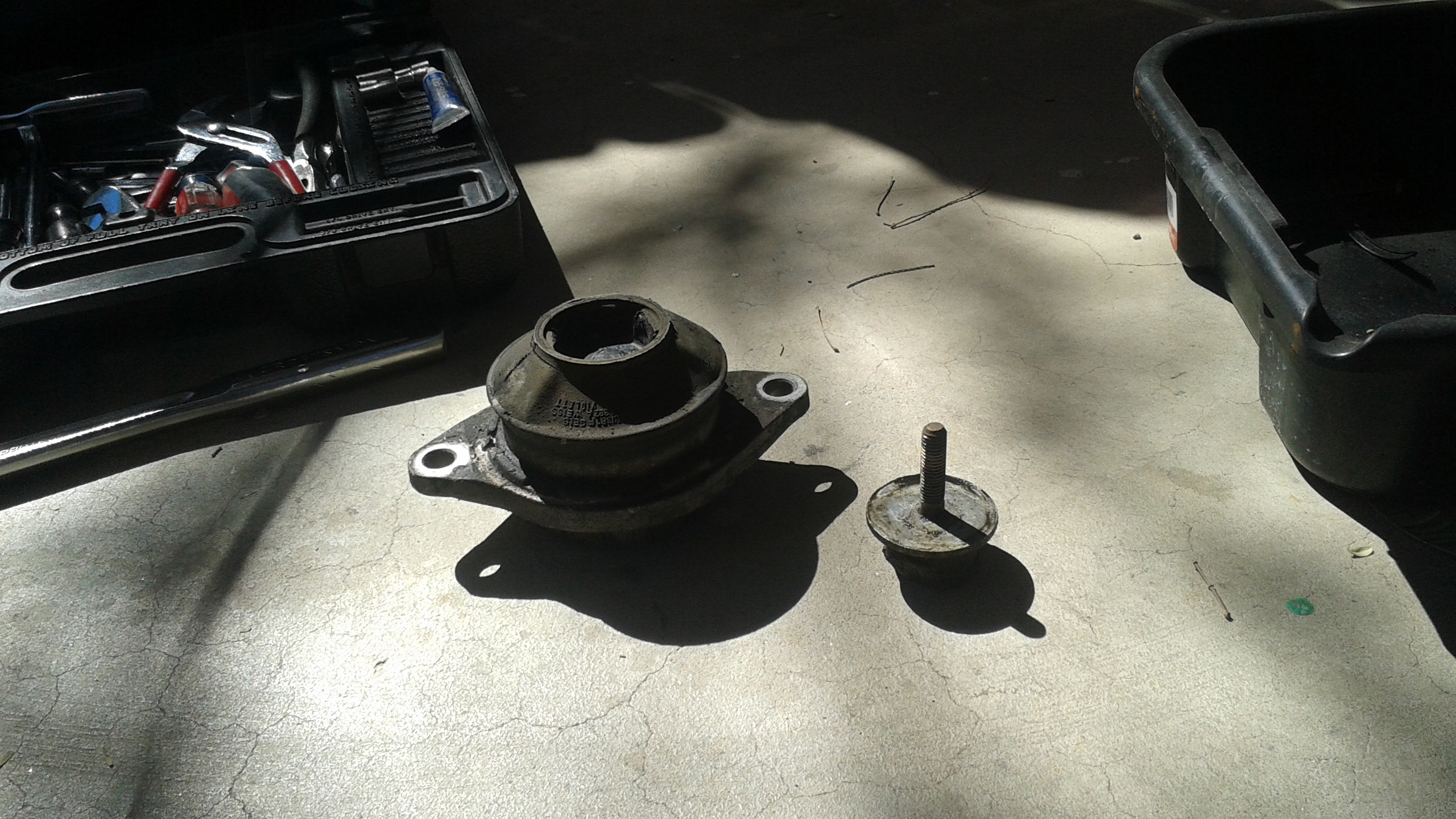

My heat shields are still in pretty good condition. As a result, they were blocking any sort of access to the mount from all sides. Fortunately, I was able to remove the airbox and gain access to the shields. Once they were removed, I was able to get to the mount.
As is usual, my old mount was toast :shame:. New mounts going in are HPR Epics, yay.
Old dead mount:
old dead OEM Audi engine mount
