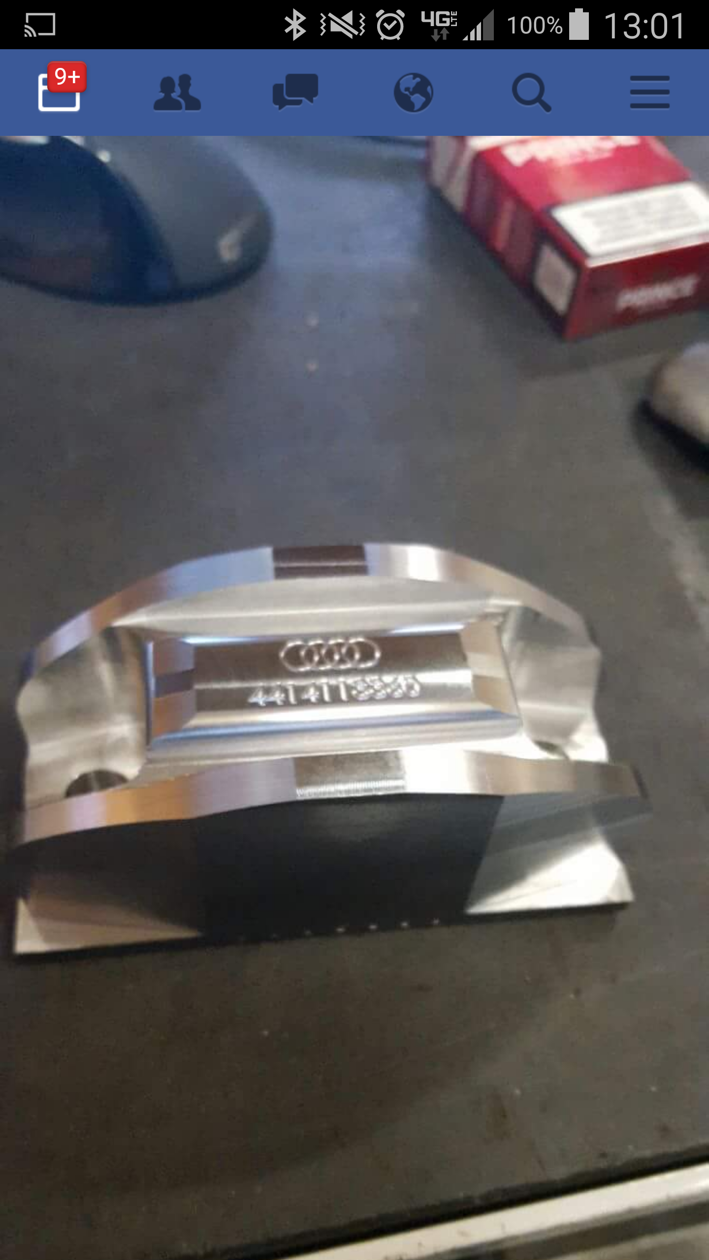

T44 guys,
An upgrade to any 5k, 200, and most v8q is the 28mm sway bar from the v8q special order sport package. If you get one of these, the clamps needed to fit one are extremely hard to find.
After much searching, Corey Henkin was able to find a source for having them made in Germany. They are expensive, but there is a group buy going on, and the more people we get in on it, the better the price will be.
Current price is $99 each. It's a fair price for a low volume part like this.
Please show your support here or on Facebook if you are willing to commit.

I don't think the for its the same actually. Are you sure about that?
Re: Group Buy: T44 28mm Sway Bar Clamps
C4 chassis swaybar mounts wont work with t44 swaybars and mounting points.
Would love if Albert at AK would make some of those camber swaybar mounts for the T44 though...

Sorry I just assumed they were the same with most other bits being swappable. It's the same design but I see now that the t44 mount is further forward. Although if the bracket is the same dimensions for mounting, ie hole spacing, it could work right?
Sent from apollo 13 using tapatalk
The C4 mounts go parallel with the length of the car, the T44 mounts are kind of at a diagonal angle, I think this will throw all sorts of stuff on the front end off. Front swaybars quite different in dimensions between c4 and t44 unfortunately. Rear end stuff is practically identical, go figure.
