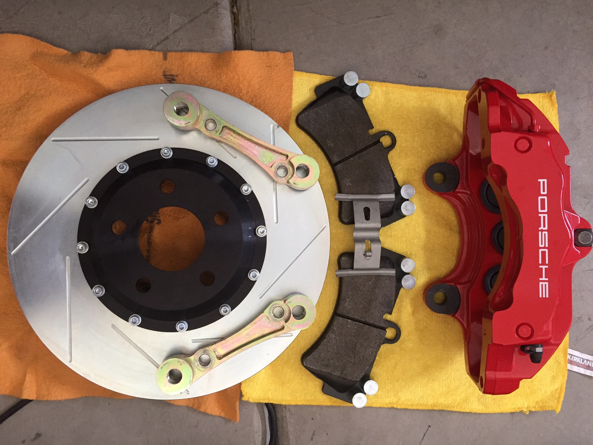

I got this Custom two piece 345mm rotors, anodized aluminum hat, custom steel mounting brackets zinc coated with brand new 18z calipers from Porsche for the cq im building.
for the rear i was planning to use my setup
and i was hoping, it will just bolt on and work. soon we shall see
