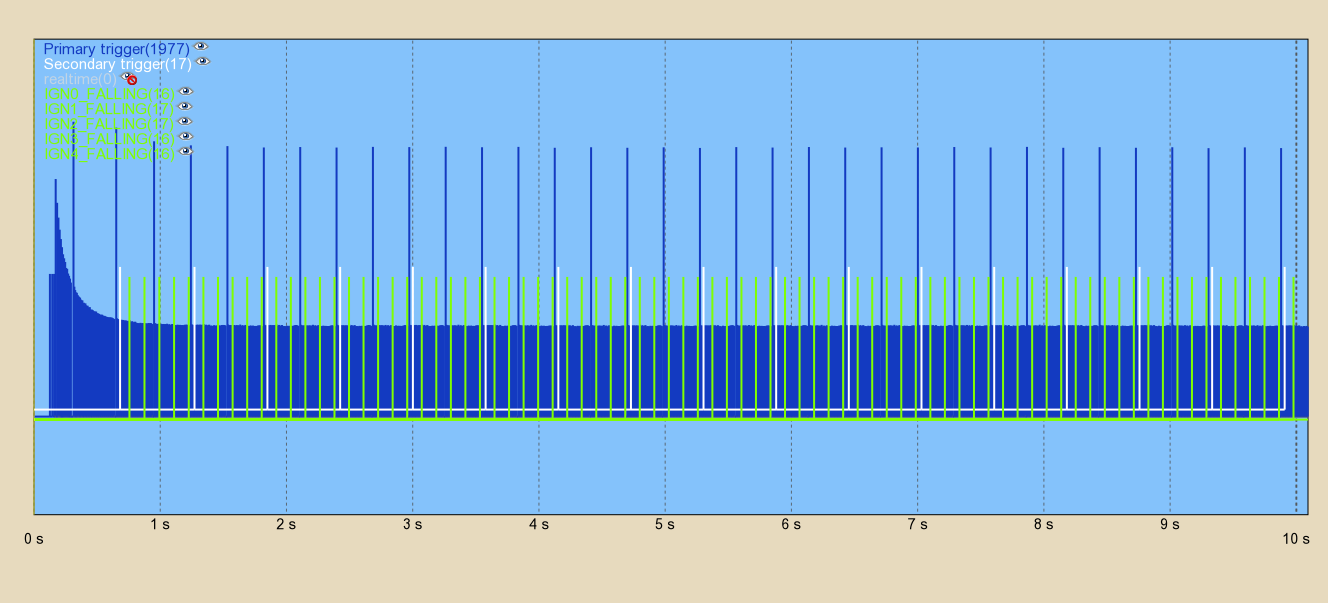

im trying to start my car with not much luck (didnt have much time lately), i got my base config from Marc, thank you
7A camshaft;7A FPR (4bar);Siemens deka 60lbs injectors;Volvo turbo, k24 machined hosing, rs2 exhaust manifold;NTC IAT sensor;Rear crank VR sensor;fuel type: 91 pump gas;wastegate spring size: stock;3B engine but has CPS on the front, LS2 coils
config: http://quattro4life.com/download/vems/c ... e2.vemscfg
trigger log: http://quattro4life.com/download/vems/v ... triggerlog
vemslog: http://quattro4life.com/download/vems/c ... e2.vemscfg
60-2: http://quattro4life.com/download/vems/14.jpg
wanted the trigger zero'd in
- removed spark plugs
- removed injector connectors
- set Under tools->ignition lock value to 0.25
- set TDC after 60
- connected the timing light, 12V+, ground, and the signal to the #1 spark plug wire
and no flashing, no spark :(
Looking for some advice, wisdom here, where to start, what to check.
(tomorrow after work, i can check the voltage at the coils, just to make sure its good)
Thank you!
ps: if i could start the car, i could bring it to bbq

I tested the harness till the coils, installed an LED. Its flashing when I hit the test button. I set the correct order.
After that, Ive put a spark park to each plug wires one by one and tested for spark, its OK
So I though its all good, i put a spark plug into #1 plug wire, cranked the car, no spark.
Sum: I have spark in output test mode, but dont have when im cranking it.
What could it be, the config?
Thank you!
Jim, if i could fire this thing up... i could make it to BBQ
¯\_(ツ)_/¯
project 2226
varia
Posts: 354
Location: Los Angeles
Re: vems help
Post by varia »
Huston, we have spark!!!
It was the config, trigger edge needs to be falling for Hall sensor.
