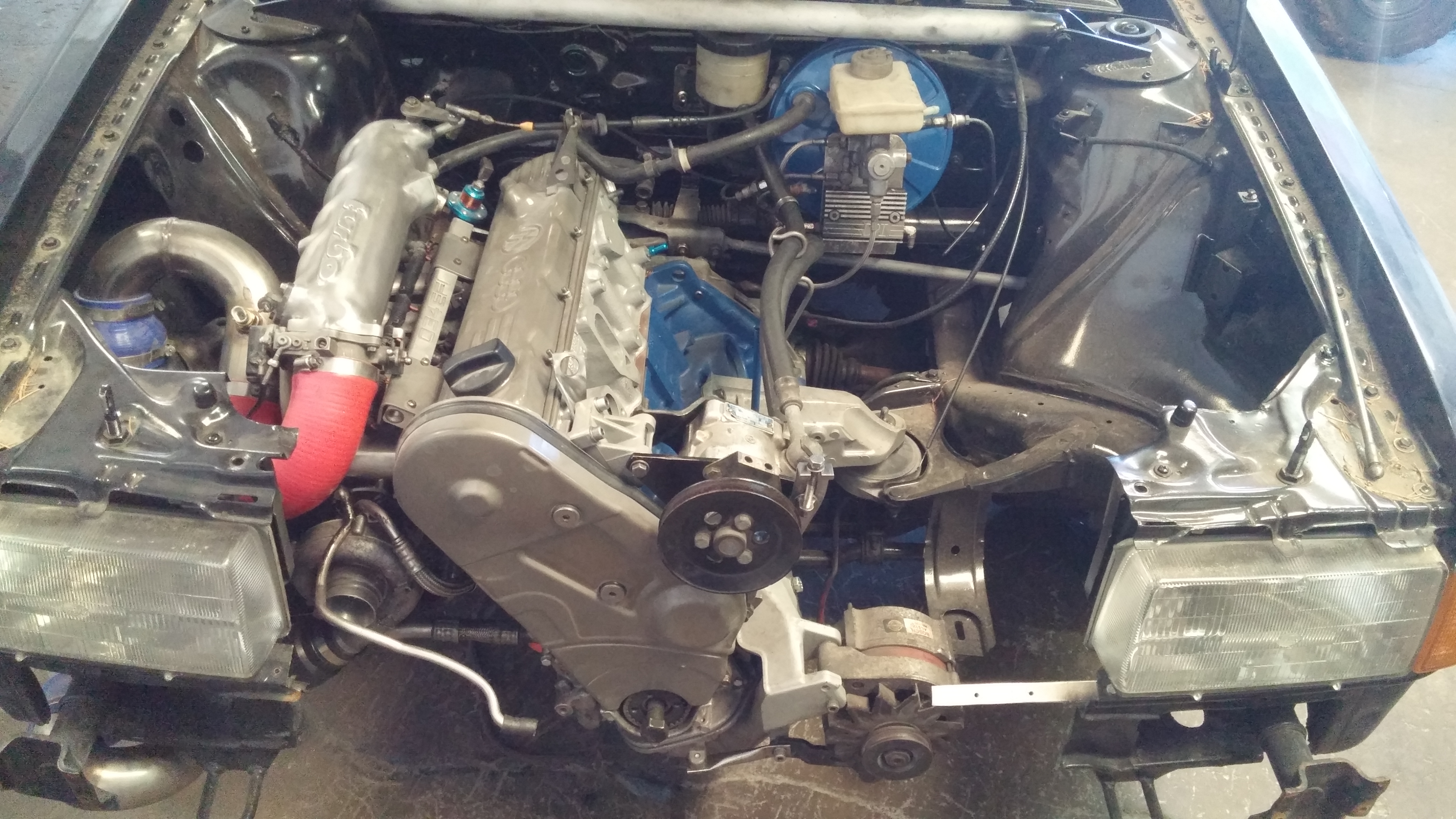

So I have a 84 Audi 4000Quattro that has been gutted and roll caged, has a 2.1 block bored out to replace my mc2 block, ported and polished head, intake, and exhaust manifold, exhaust manifold and k24 have been ceramic coated, 3" pipe out, 32lb injectors, air to water intercooler, ran by ms1-extra fired by 5 window hall sensor. I am having issues finding a timing and fuel map if there is anyone that could help a a b2 fanatic it would be awesome

Thanks anything helps im pulling my hair out trying to get this hall sender trigger angle timing issue every time I get the fixed angle back down to -10 it dies then it's a beast to get started again
