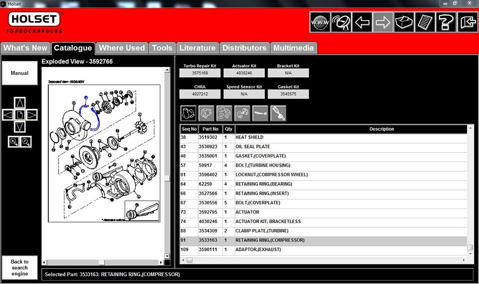

i managed to get a copy of the factory holset parts catalog software! this is really freaking useful!
- 12006374_10153059096836771_4449606938117245152_n.jpg (82.23 KiB) Viewed 60985 times

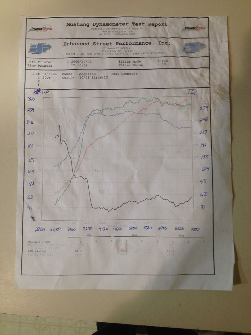

I ran the hy35, it was only on the dyno once and it only made 310 whp, but I was having trouble with my boost control, and could only get low-mid 20's out of it for boost. Found the problem was a loose power supply on my auxiliary fuse board that fed the n75.
I was running it regularly at 30psi once I found that issue, but never went back to a dyno. It was enough power to get a full weight b3 90q down the quarter mile at 124 mph, so probably more than 310 wheel. Maybe 350-375 wheel? Not really sure. It was very fast as far as im concerned.
I do have a dyno sheet, but its faded old piece of paper. I guess I could take a photo of it.
Re: anyone here have experience with holset turbos on the AA
i'd like to see it the dyno sheet definitely! i know power to weight is the biggest key. my 4000 when it was a mostly stock AAN swap could easily run with a buddy's URS4 that had a pretty decent laundry list of mods. he was pissed lol. i was like well my car is 2800lbs with me in it, full interior, half a tank of gas and a bunch of random crap in the trunk and you car is floating around the 4000lb mark. power to weight thus why i put the AAN in the 4000 and could care less about making my over wight pig of an S6 avant go retarded fast.dana wrote:I ran the hy35, it was only on the dyno once and it only made 310 whp, but I was having trouble with my boost control, and could only get low-mid 20's out of it for boost. Found the problem was a loose power supply on my auxiliary fuse board that fed the n75.
