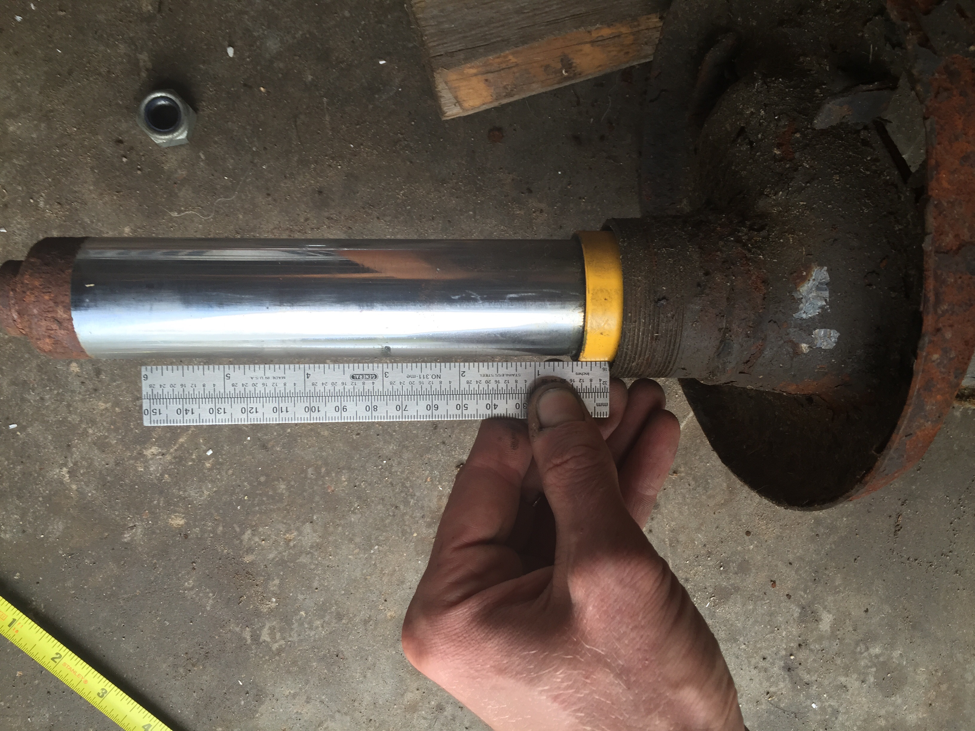

- Shock tube bottomed out...
- image.jpg (1.75 MiB) Viewed 35095 times
- Shock tube bottomed out in housing.
- image.jpg (2 MiB) Viewed 35095 times

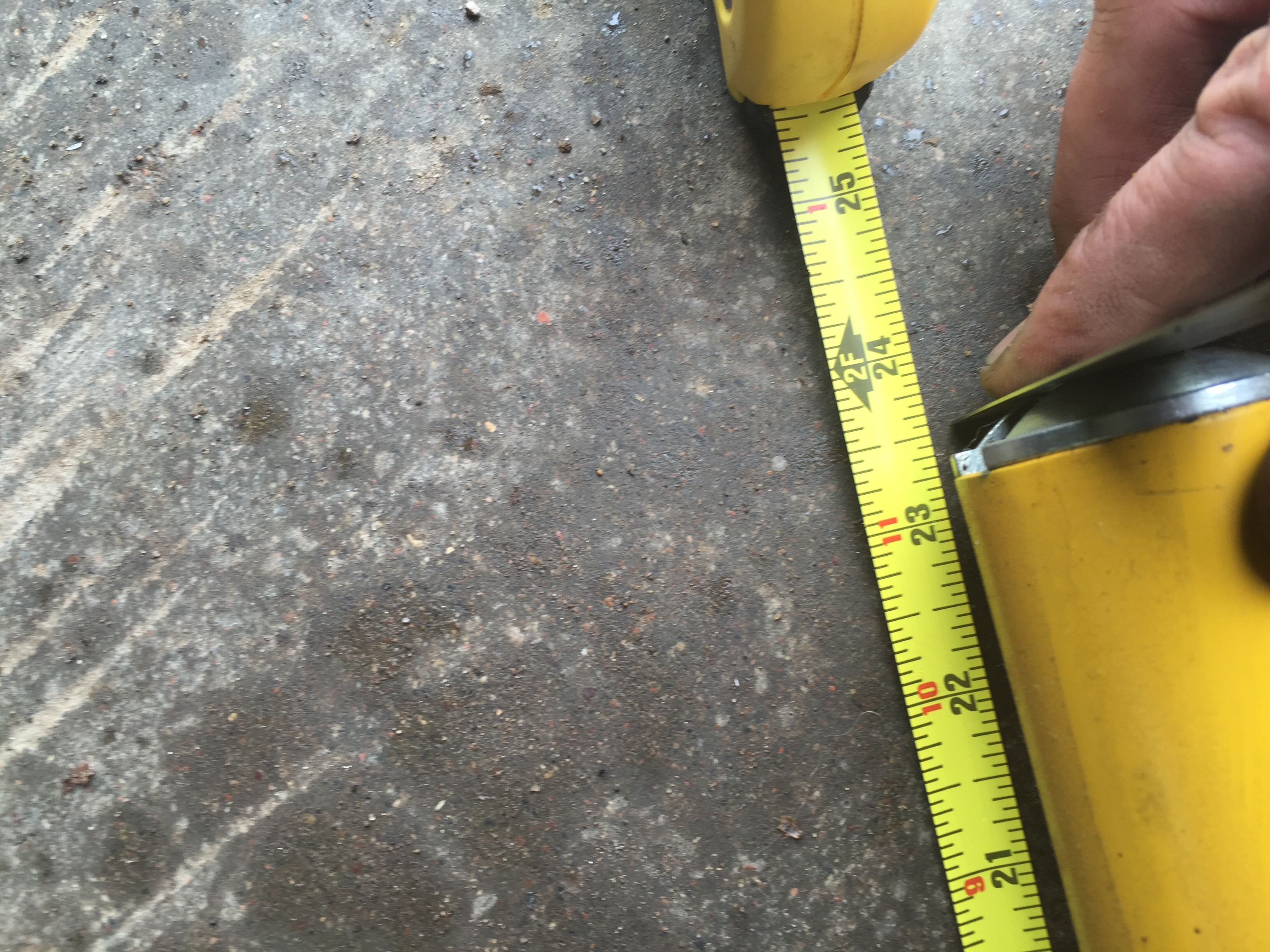

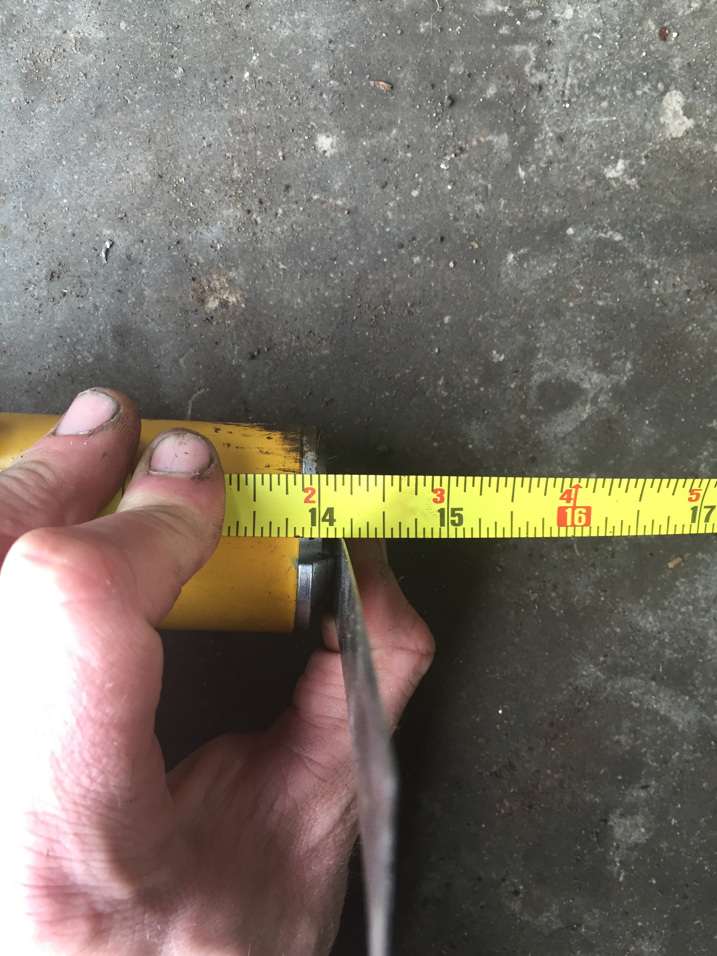

- Shock tube length
- image.jpg (1.7 MiB) Viewed 35095 times
- Total length from pin.
- image.jpg (2.23 MiB) Viewed 35095 times
- Total length, from the pin.
- image.jpg (1.78 MiB) Viewed 35095 times

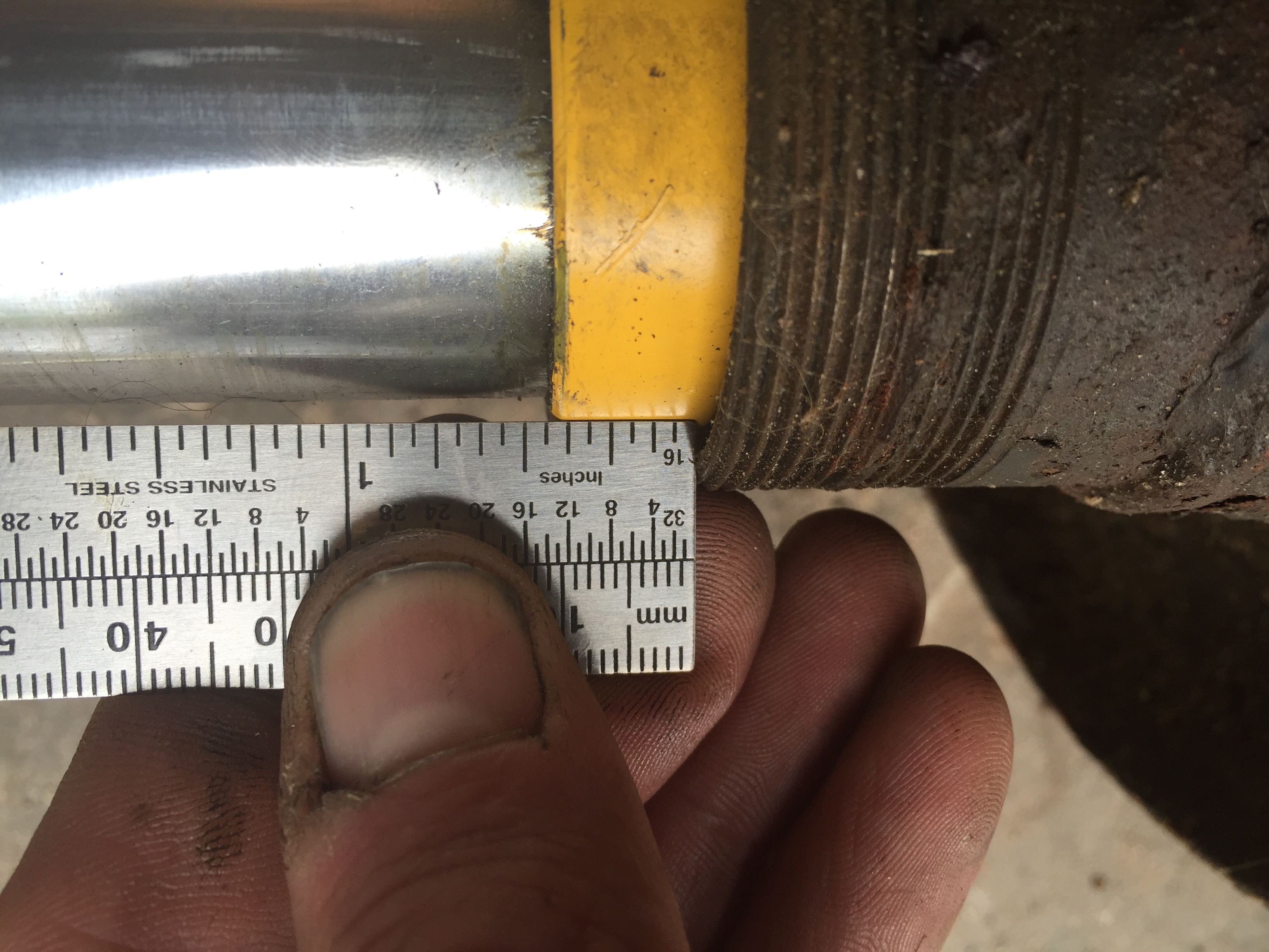

Is that a UrS housing you are showing it stick out 7/16" from?
Re: BBSE question
Yes it is. I put that up because I couldn't find an accurate way to portray through the interwebs, the depth of the cap that screws on. Figured just showing you what sticks out would work easiest.

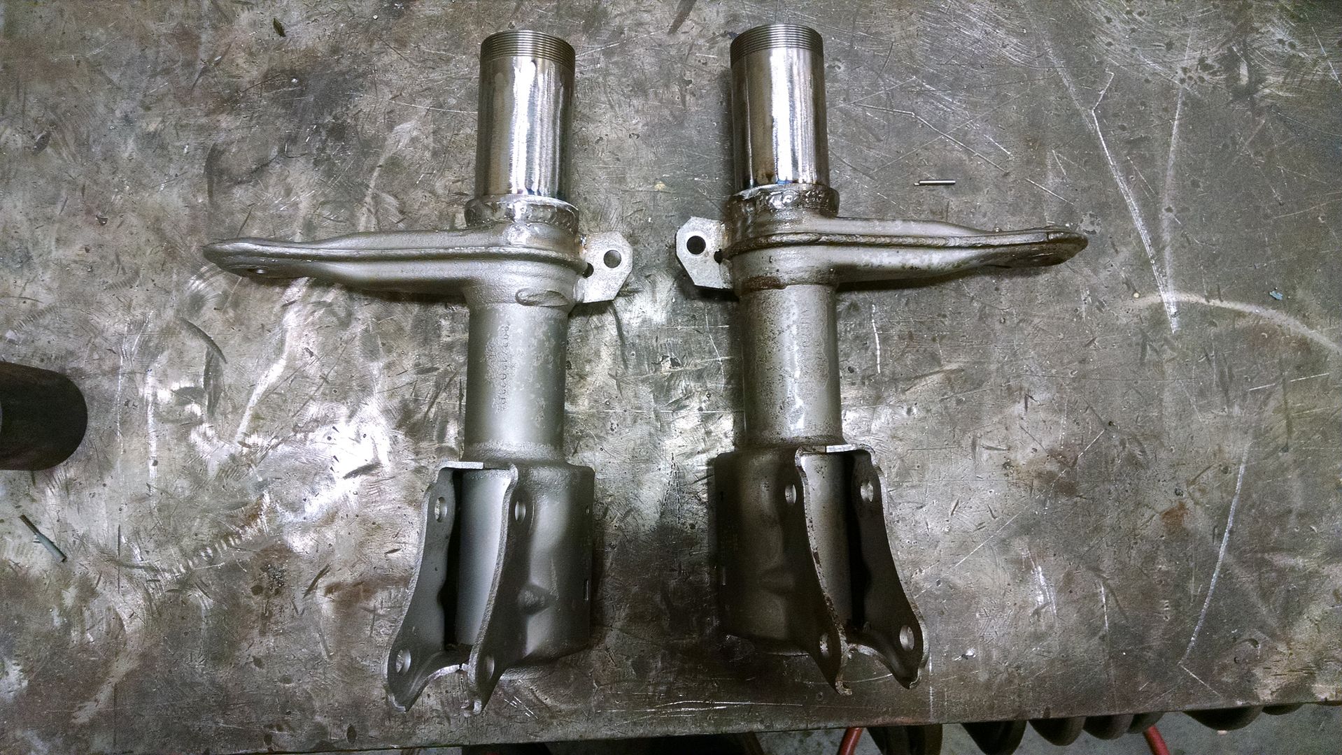

So its been a while, but thanks to deaner, I have a pair of B3 front housings, and a well blown UrS bilstein. I needed the housings as a sacrificial offering to the Audi gods to allow me to get the sizes I needed. And here is the result
When I cut off the same 50mm length off of the B3 strut housing, this is how it looked with the UrS bilstein insert.
A little too tall. I cut another 3/8" off the strut housing, and all was good. I got the 7/16" stick out I needed as per the UrS housing. I'm going to check the housing against a B3 rear(aka UrQ front) koni insert, and see what needs to be changed. I'm thinking I may need to make a change to them to use the koni inserts. I know the koni inserts use a spacer not only for alignment, but its also what the gland nut pushes on to keep the insert down.

Re: BBSE question
So here is the final product. Came out well, I just need to reblast, and paint them before shipping them back to their home.
