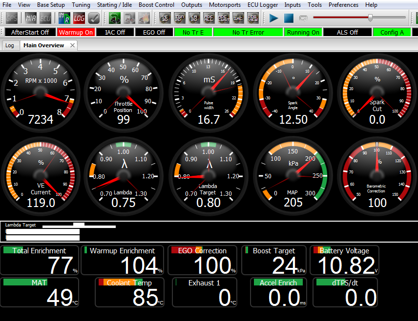

for doing some of the tuning i have a big long concrete pad that used to be an old warehouse on my property at my shop so i just run cars back and fourth there, no sweating cops or anything like that. what i ended up finding out was that i had my TDC after trigger set too low and it was actually retarding the timing. i dug out the timing light and did a 20 degree lock and adjusted the TDC after trigger so it matched the timing light. strange thing is that it is spot on with my TDC after trigger at 57 degrees. not sure if thats good or bad but it runs best so far set at that. my other problem now is the severe richness under boost, i see roughly 10.0 AFR at full boost, my battery voltage drops down too and i know voltage is a factor for the injector constant or it alteast should be. lower the battery is the more it richens the car fuel mixture up. so i took all my spare 20V, V6 and 16V alternators to auto zone and had them tested. i chose the best alternator out of the bunch which was a 90amp from a 16V. i figured i dont need the big 120amp anymore because im not running the crap ton of electronics and such that the URS had in it. that helped a little with the voltage drop high RPM. next i got a brand new battery and installed that, it helped a little bit more but not cure it. the car would originally go as low as 20v at 7500RPM, now it goes down in into the high to mid 11 volt range which is better in my opinion but not right. i mean it is charging so i may just tune around the problem and go with it because i cannot think of for the life of me what else it could be. i have a super over engineered grounding system i built now, literally everything is damn near grounded to everything. i thought it might have been the 044 fuel pump causing a draw so i put it on a relay right off the battery and there was no change at all there. im trying to get dyno time setup in the near future because thats what it really needs. theres a schmuck running around my area with a 330i thats converted to single turbo and his PA plate says VAG SLAYR and i know he's not talking about pussy so i plan on teaching him a lesson to not fuck with volkswagen audi group cars. even though i dont want to i think i may have to remove my 016 and swap in my spare URS 01E because the 84 model year 016 is severely gear limited compared to the 01E. the one up point of having the close ratio 016 from 84 is the tranny and rear end both have 4.11 R&P which is what the URS tranny has so no need to even touch my rear end, sweat trying to track one down or worse case rob the rear end from my URQ.

Not quite sure i understand that whole post, what are you loading at high rpm? Tps or rpm based kick in fans to cool stuff up? Surely not 90 amps worth. Voltage should be going up with rpm if anything, unless belt is slipping... Coils are probs not giving as much energy either at 20v...
Unless you're running without an alternator for the drag strip...;) In that case i'd get a better battery, like a 14v car audio competition battery. With no load on a good charged batt you should be getting 14+ volts at any rpm.
Def something wrong in your charging system.
Also, ignition lock panel should be kept up/open during the timing like chaloux said, otherwise it defaults back to ignition map that will dance around even if set to all the same timing across, unless you turned off ignition influences everywhere in your tune.

i posted my VEMS log in my other post by accident last night, whoops! it was late and i was tired. anyhow, here's the VEMS log from my very last pull on my test pad yestersday. this an easy first gear and than load it up in 2nd and pull to the rev limiter.

Voltage too low + Trigger errors.

carl wrote:Voltage too low + Trigger errors.
i dont see where your seeing trigger errors in the log. i have no idea what is up with the voltage, it has a brand new alternator and battery in it now.

Yea , my bad opened up wrong file :hammer: lol (v3.3_u009465-2015.06.22-02.30.24) guess windows nudged the file at the end being a new file and having the folder open or something.
Checked out the new log, no trigger errors, seems ok, like you say voltage still weird.
If you have one, what do your standard car gauge say, same deal? Maybe strap is jumping off the pulley from a wobble or too loose or something.
Can't say much otherwise, spool up seems a tad slow depending on what turbo you're running, interesting use of the mat retard table.
