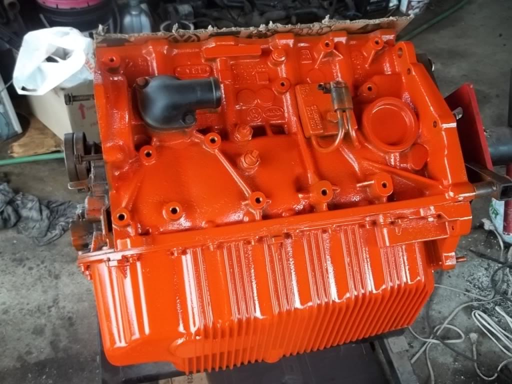

The facts: "Eurospec" 2.6L rally shortblock 82.5x 95.5
I verified the bore and stroke before installing.
Looking at my old 2.3 NF block side by side there are many difffernces:
subtle increase in strengthening ribs on both sides
looks like the lower half of the block is wider (like a VW bubble block), to clear the 95.5 crank
passenger side of the block has "channels" cast to add clearance for the crank throws, you can see them on the outside as raised sections under the strengthening ribs.
I can't remember the deck height, I might be able to measure it in the car.
Deck height is taller because I can barely fit the timing belt with the water pump adjusted all the way out.
It clearly DOES NOT have "2.5L" stamped on the side like the eurovan blocks have...
Pics for reference (black is 2.6, blue is 2.3):

I've seen diesel blocks and this isn't one of them, diesel's have the skirts almost touch the main caps, there is a ton more material on the bottom of the block. Years ago, a guy on Motorgeek posted side by side pics of a 2.3 and the diesel block, you could clearly see the difference!
My block has oil squirters because Eurospec installed them, they also bored it out to 82.5mm, as far as I know, no "2.5L" blocks came stock w/ a 82.5mm bore, they were either 81 or 79.5 (diesel).
I found a pic, 1st is a diesel, the others are my Eurospec block.

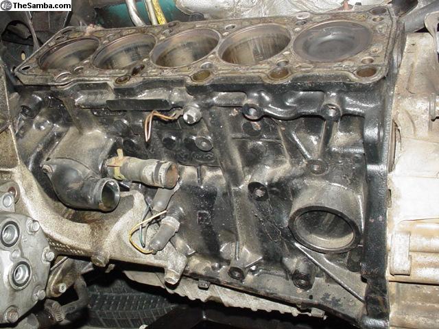

If it's not a diesel block, then it might be a special version of the petrol block. You said Eurospec installed the squirters. The bulges are puzzling. Your pistons might be 9As.
BTW, I fucked up. Petrol 2.5L engine is AAF (later ACU). Not AAT.
Some pics I have of petrol 2.5L.
EDIT: found this: http://forums.vwvortex.com/showthread.p ... viewfull=1

I'm trying to get the part # from the side of the block. The serial number "pad" is blank or has been ground off, so that's no help.. I guess I could try Euospec again.. I called years ago and never got an answer... they didn't know and the guy who "did" was out.....

PRY4SNO wrote:For what it's worth, I've heard that the MC1 and MC2 blocks were among the strongest.
This isn't an MC block or an NG/NF (see pics for comparison), the casting is very different, it has clearance cast into the skirts for the larger crank throws and the reinforcing ribs are different/larger....
