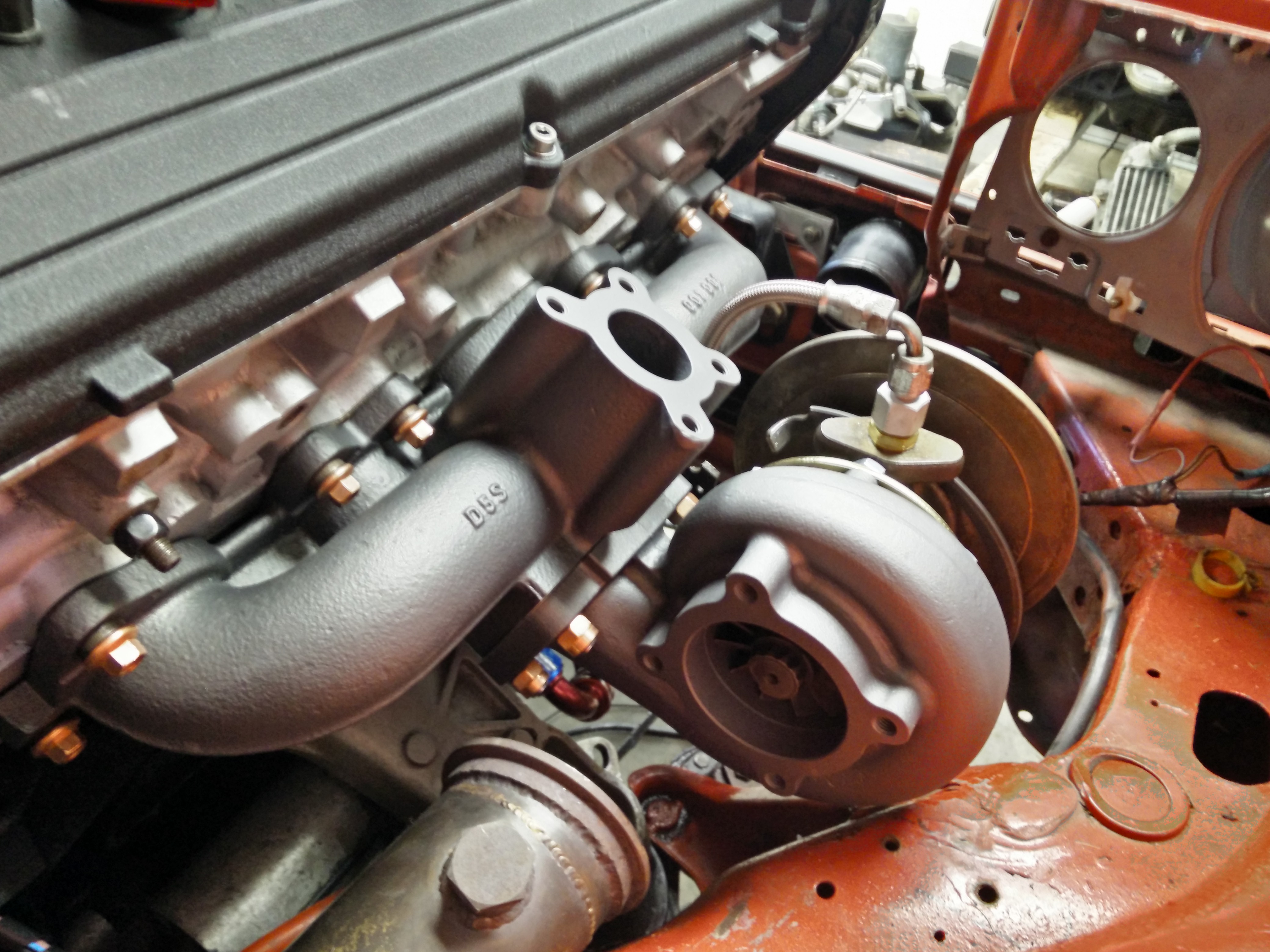

Ceramic Coated Newness

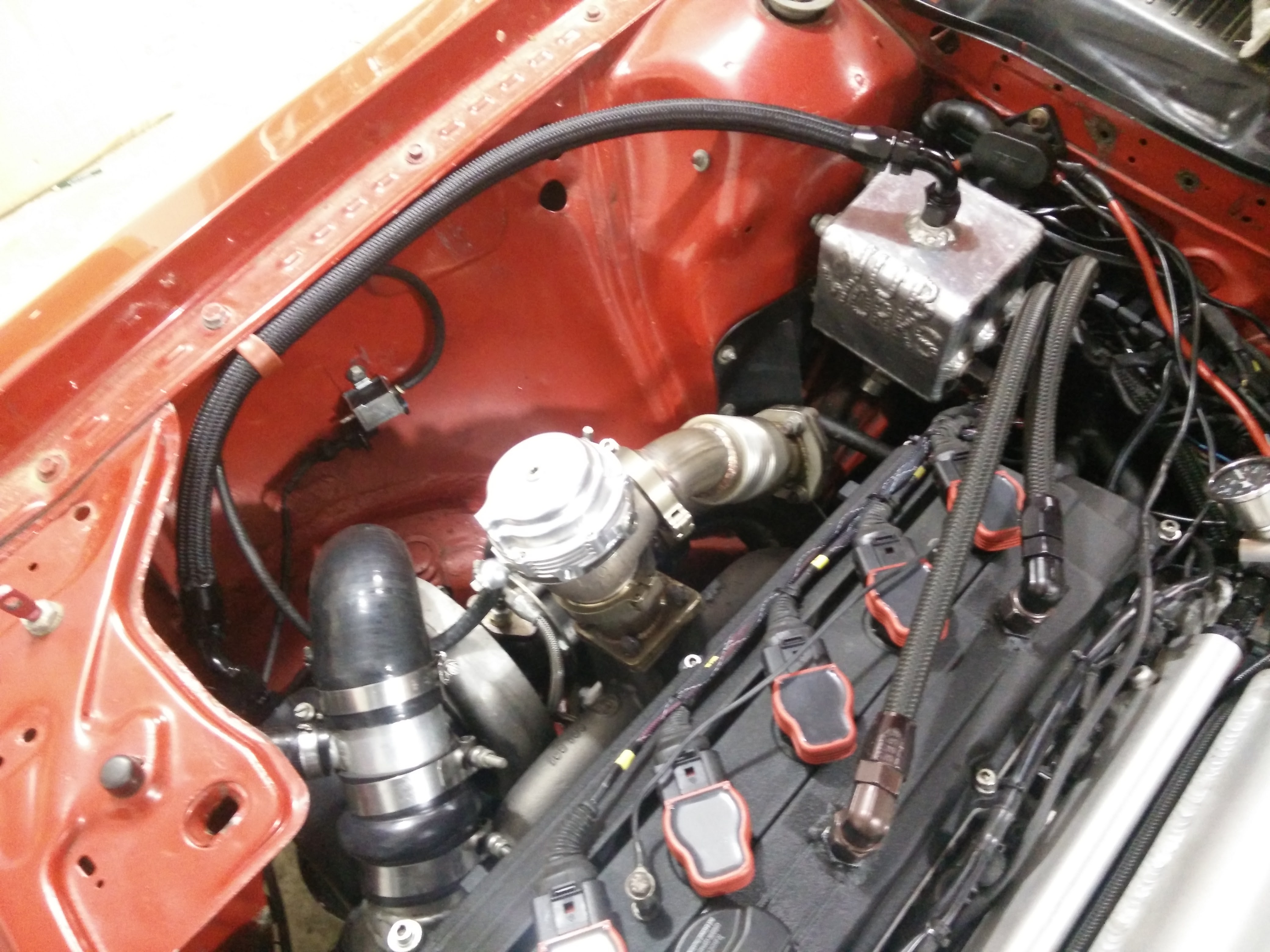

New Turbo Setup

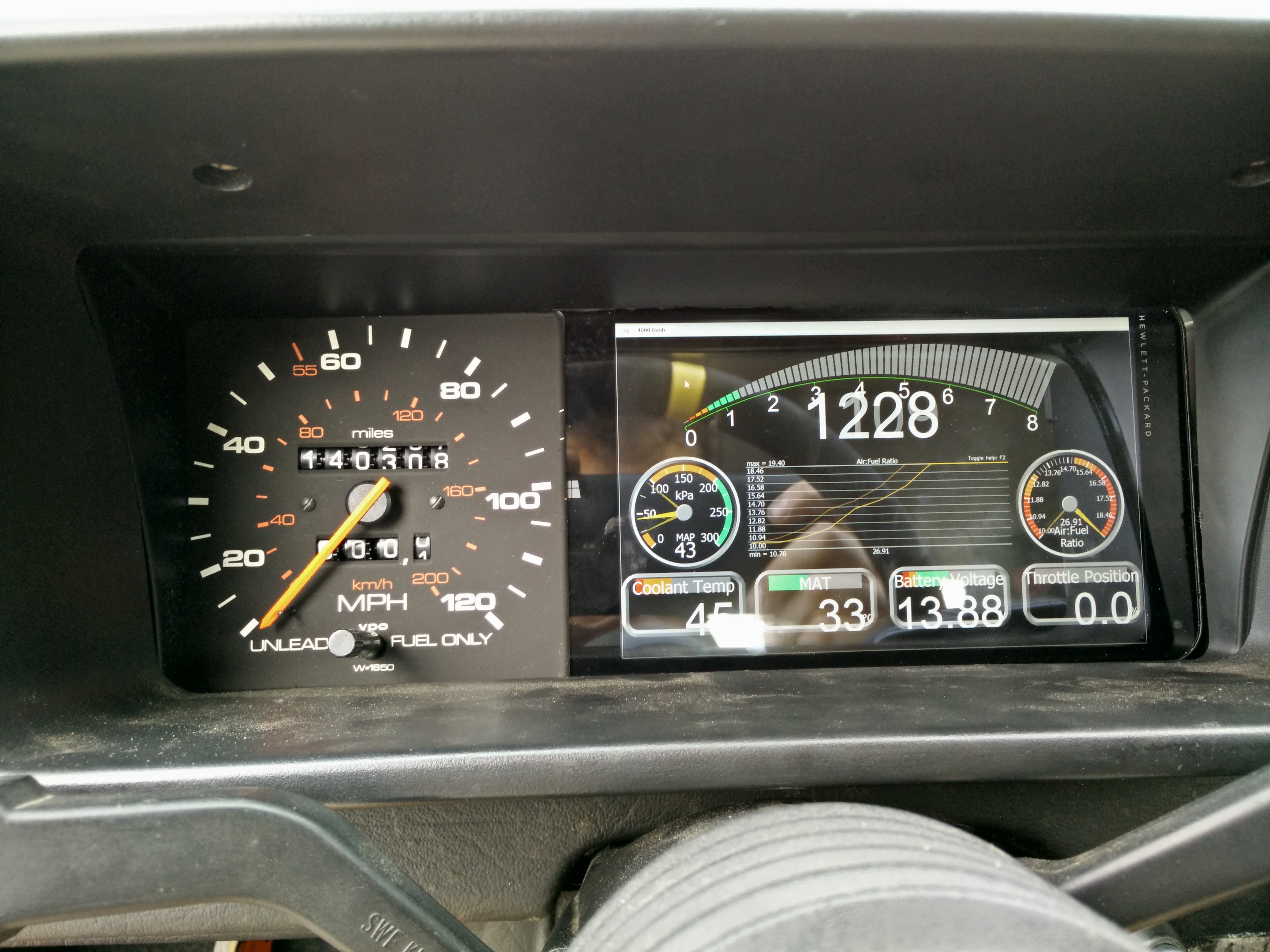

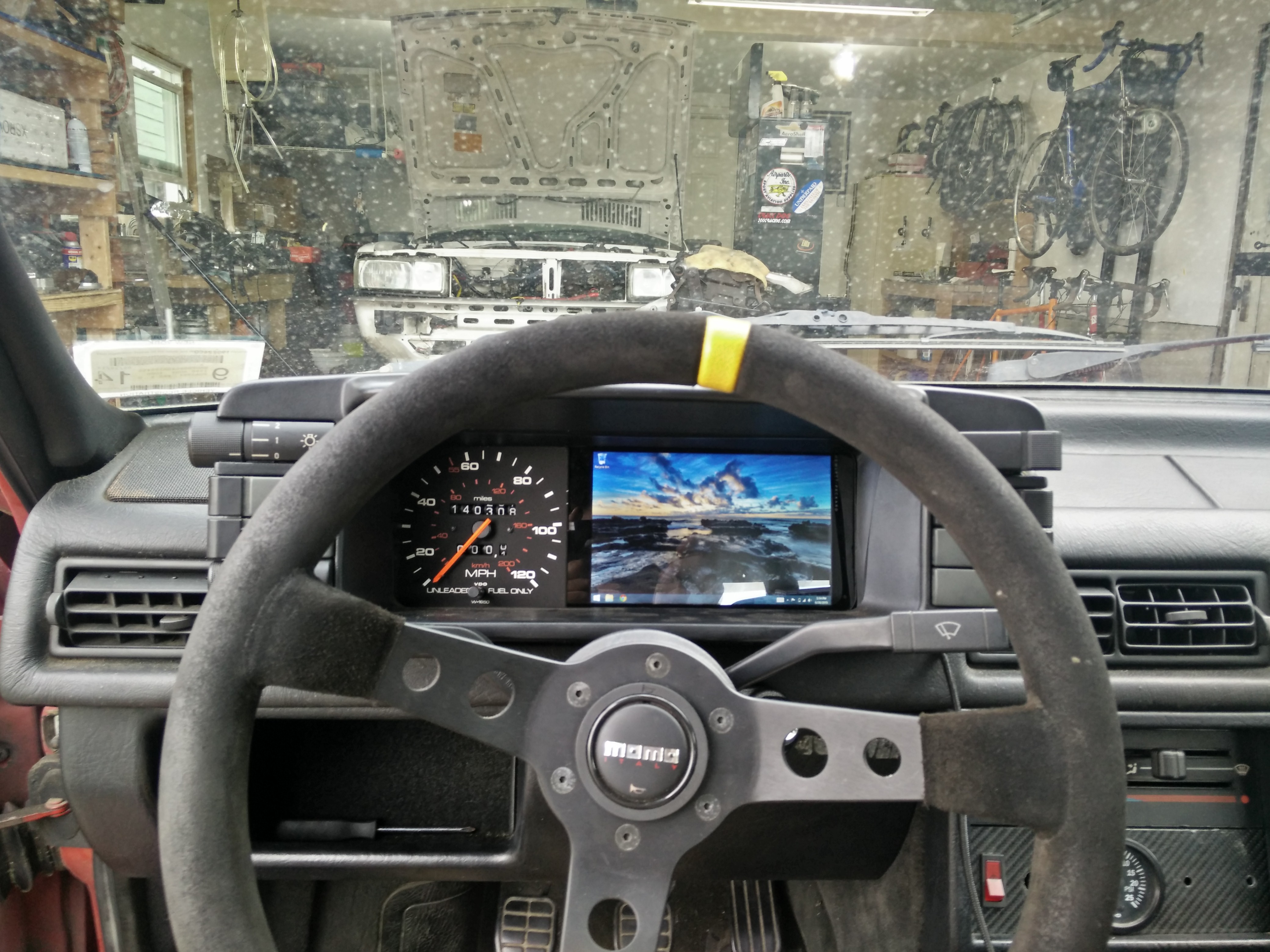

Since switching to VEMS the dash has always been a bit suspect. Specifically the tach with intermittent and I don't trust most of the gauges anymore. I've had the idea to install a VEMS display for awhile now. Decided to pull the trigger. I purchased an HP Stream 7 windows 8 tablet last week and got it into the car over the weekend. There's definitely some bugs to work out still but it seems to be working as intended. USB charging while interfacing with the Serial connection as well as sleep/wake have been the biggest issues thus far. The gas gauge was removed to make room for the tablet. Haven't decided what to do on that front yet. I'll either wire it into the ECU or put in a standalone gauge.
I kept the mechanical speedometer as I wasn't sure if I'd have enough screen real estate for a GPS one. Looks like there is going to be room, but I'll leave it as is for awhile longer.
Zoomed Out
Zoomed Out
Zoomed In VEMS
Zoomed In VEMS

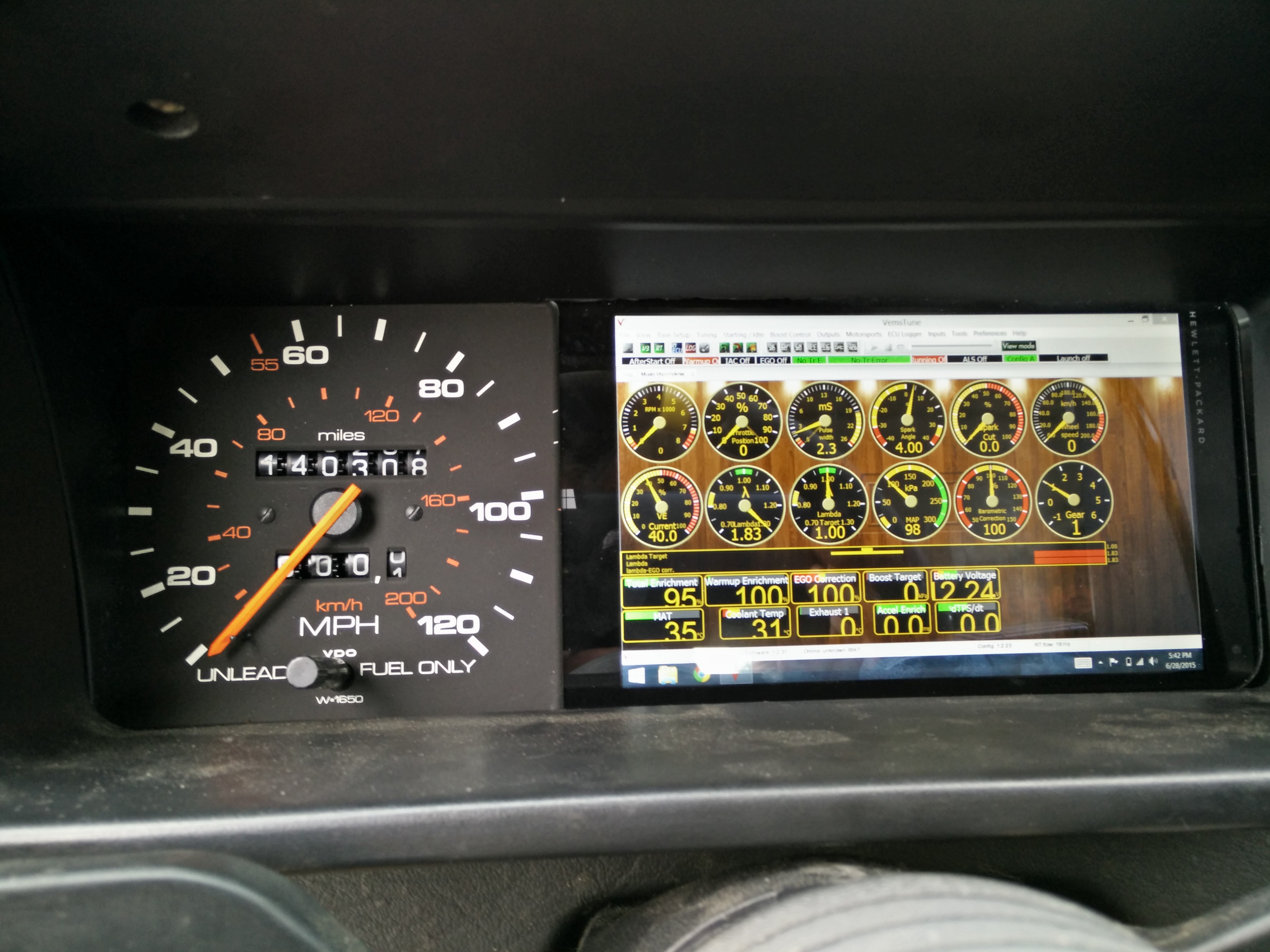

Here's a view of the current custom interface I'm running. Still preliminary.
Prelim Gauges
Prelim Gauges

For the tablet, I'd try an anti-glare screen protector. Might dull the colors a bit, but will make it easier to read during the day.

That's the plan! With it shrouded under the original gauge hood, the glare is minimal. Certain angles are still troublesome. I'm hoping windows 8 has some auto screen brightness adjustment because night viewing kills my eyes, while just just about full output is perfect during the day.

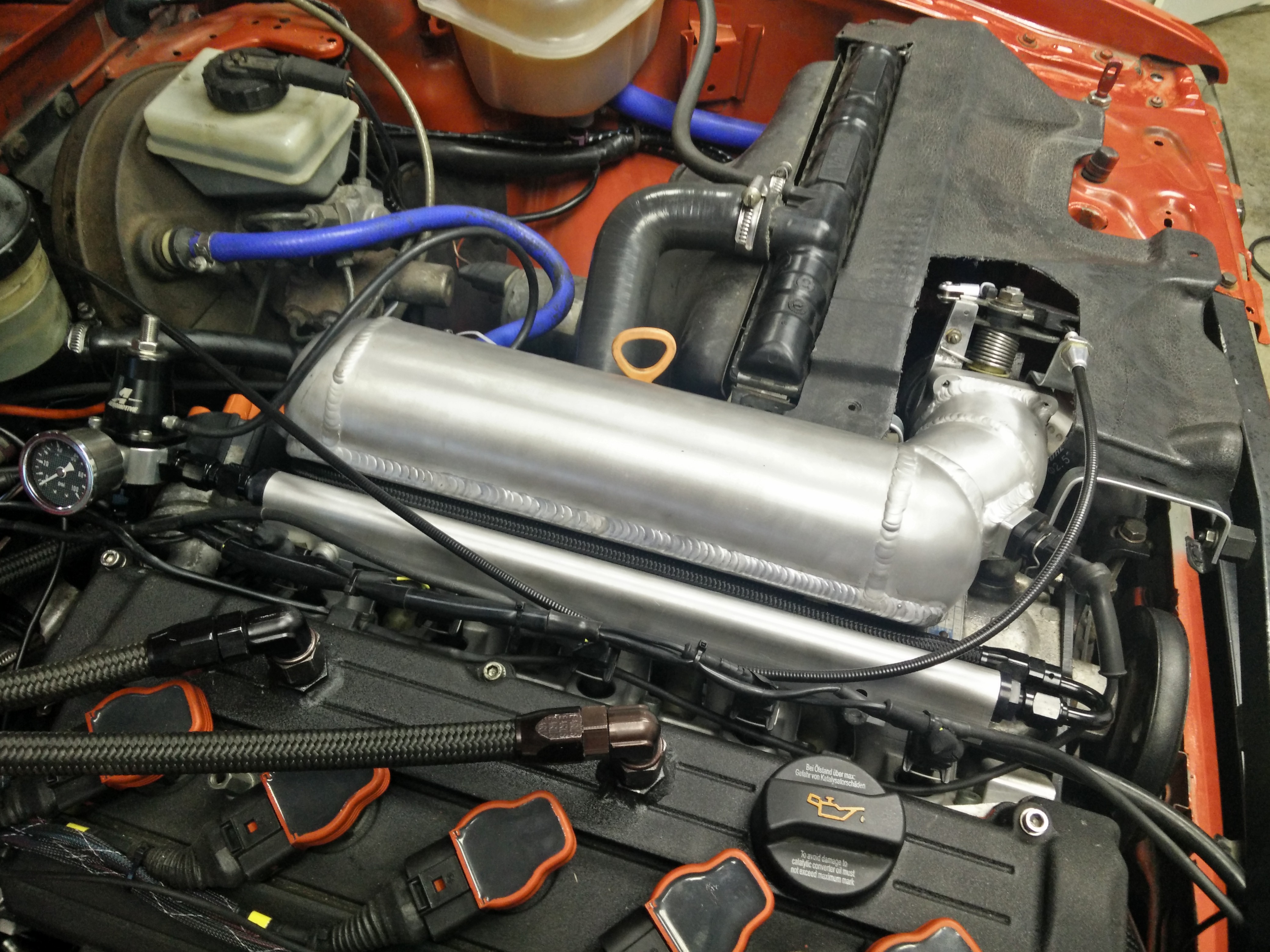

Got the intake plumbed up. New Iroz Fuel rail installed. New AFPR from Aeromotive. Took the car around the block a few times for the first time in two months. Running well. Having dash issues otherwise I'd have done a full pull. This thing lags like crazy. I knew there would be a difference between the K26/6 and the T3 .63A/R hot sides, but this seams ridiculous. I'm wondering what spring I've got in this wastegate.
I experimented with the radiator shroud a bit. Excuse the roughness in the picture. I don't like it...
I ended up going with this throttle cable kit: http://www.amazon.com/gp/product/B003JB ... ge_o02_s00
Had to fab up a little bracket to hold the TB end but it wasn't too bad.
Still left on the list is wire management. Needing to run the IAT and TPS sensors to the front of the bay ruined my nice little wiring packaging. I'd used some 2x2 wireway along the fireway to keep everything nice and neat.
http://www.amazon.com/dp/B0094JEXOW/ref ... TE_3p_dp_1
http://www.amazon.com/dp/B009DHNFOO/ref ... TE_3p_dp_2
This worked pretty well but I think some 3" tall x 2" deep would work better for the new setup.
http://www.alliedelec.com/panduit-g3x2bl6/70326979/

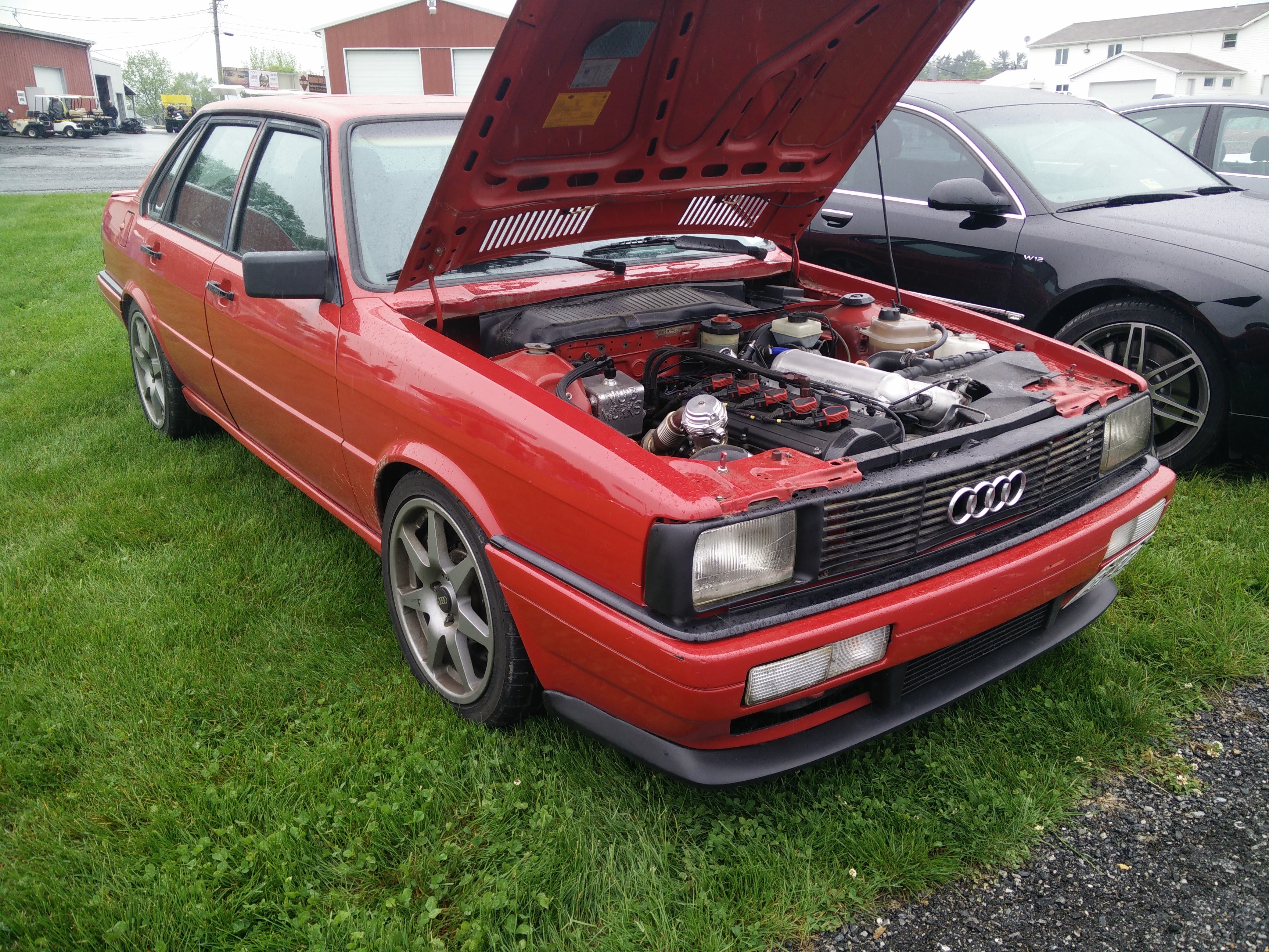

Successful trip down to Carlisle on Saturday. Too bad the weather was so bad... The car ran like a champ even after some last minute wiring changes (accidentally pulled the rad fan wire out of the ecu...).

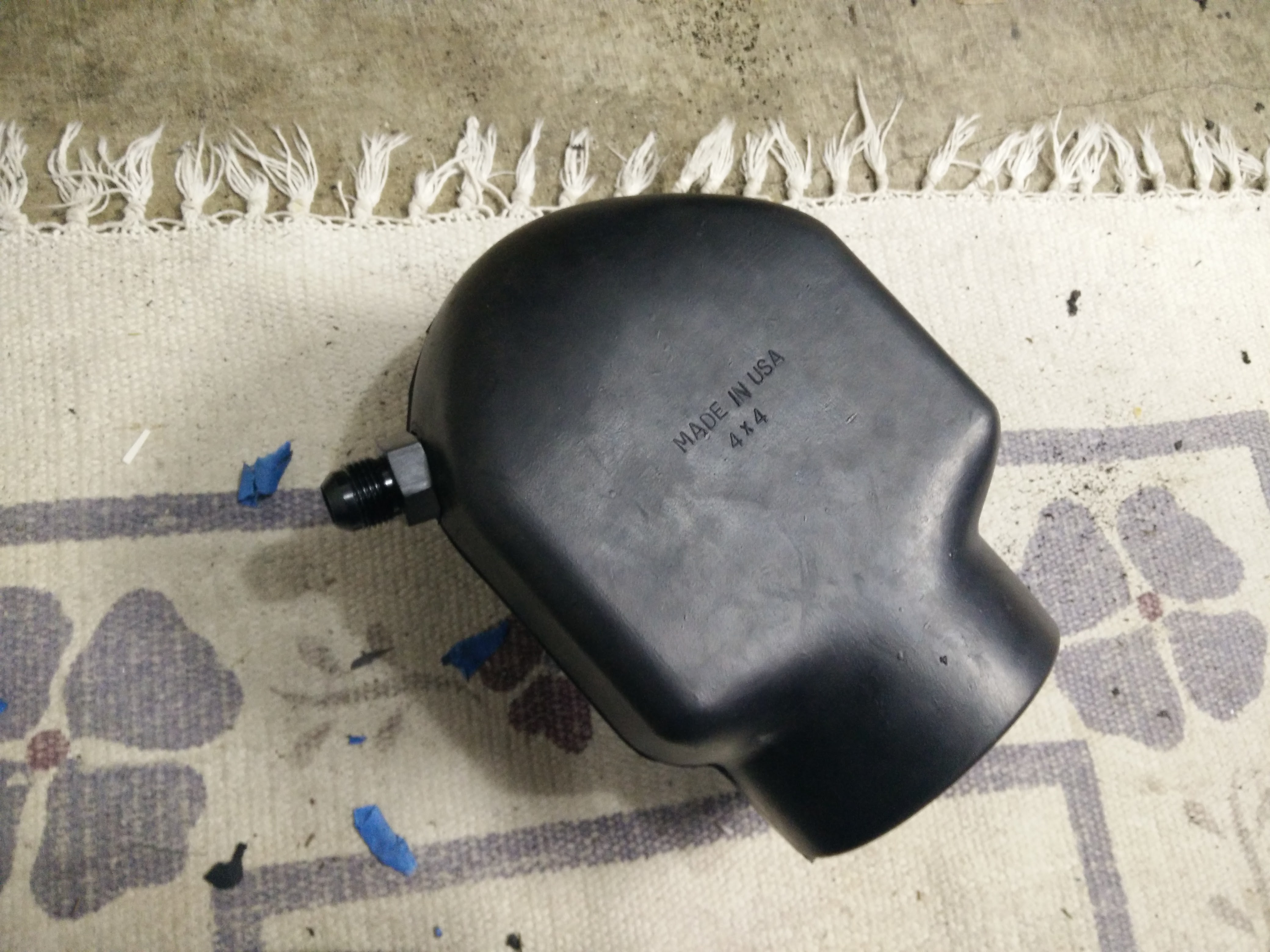

Only a couple quick and easy updates. The car was towed from Seattle to Baltimore on the back of our moving truck. So It's back out east! Right before leaving I installed a cobra head turbo inlet and tied the catch can vent back to the intake. Finally no more stupid looking filter and fumes smell.
Catch Can Piped To Intake
