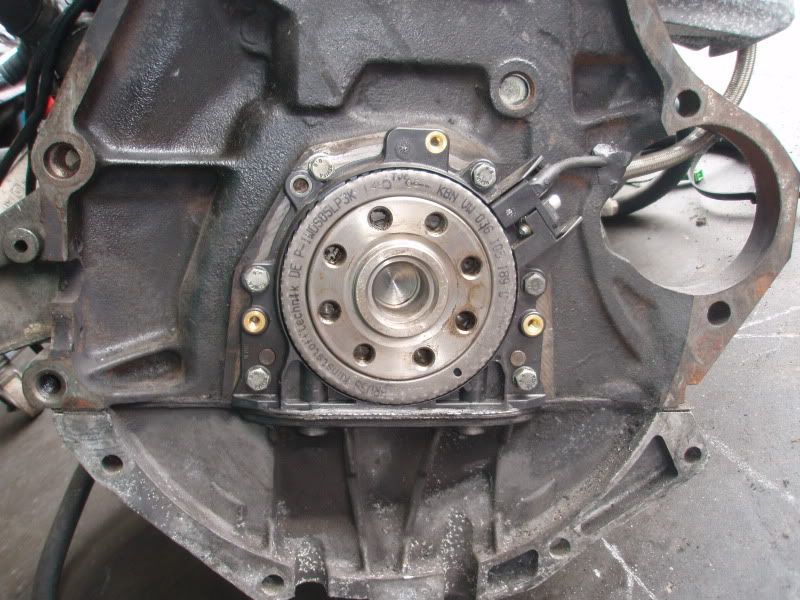

Well... I guess my best answer is that it depends on a lot of factors. Let me try to give you (IMHO) the pluses and minuses of 3 different options.deaner wrote:That's kind of what I'd gathered from your posts on the ms forums. I really need to go back through and reread it all a couple of times to really get my head around it. With all the monkeying around with those two different setups, are glad you went that route or would a guy be better off just using a 60-2 wheel off the crank? Even though it's a little spendy, those rear main 60-2 setups from Europe look like a really nice option.
First,the OE crank trigger setup with Jean's board. Getting this setup to work can be moderately difficult to darn near impossible depending on your background, patience, and what equipment you have access to. I've got a solid electronics background, lots of test equipment including an oscilloscope, and I'm incredibly stubborn so I'd say for me it was "moderately difficult". If you're not so good with electronics, don't have test equipment (and can't get access to it), or "just want it to work", this setup is probably not for you. Pluses are that it's the closest to OE, and is cheap.
Next is this:
It's a neat little 60-2 trigger thingy that sits in place of the rear crank seal. At one point when the OE setup was giving me fits, I actually bought one of these and my bank account never forgave me - it's about 400 bucks! However at the time the engine & tranny were in the car and I decided to put a little more effort into getting the OE setup working (which proved successful) vs. the large amount of effort required to separate the engine & tranny to install that trigger unit. If I'd had the engine out of the car at the time, I probably would have decided differently. Those units are very hard to come by, but Marc Swanson has them. There are also a few issues with them - as you can see in the photo one of the bolt holes doesn't line up right. And routing its cable out to an accessible location requires machining a hole or notch in the engine block as you can also see in the photo - as you can imagine you have to make *really* sure the cable doesn't hit the flywheel! The good thing with this setup is once you clear those hurdles it should be super-easy to get working: connect +12 and ground to the sensor, third wire goes to Megasquirt trigger input, and drive off into the sunset.
Other trigger setups with a wheel on the damper pulley or machined into the flywheel I don't have any experience with but are definitely doable, should be reliable as long as you do it right, and are simple and straightforward electrically. For a pickup I prefer a Hall to a VR sensor but each has its good and bad points. For each, make sure you can adjust the gap between the sensor and trigger wheel (/flywheel) as sometimes that needs to be "tuned". Make sure the sensor is solidly mounted (vibration can affect the signal) and if the trigger wheel is on the damper, give some thought to what could happen if the engine throws a belt (ie protect the sensor and wire).
One last point with any crank-trigger setup: make sure you use good shielded cable for the sensors! Noise problems on crank sensors can drive you absolutely batty trying to track them down and fix them.

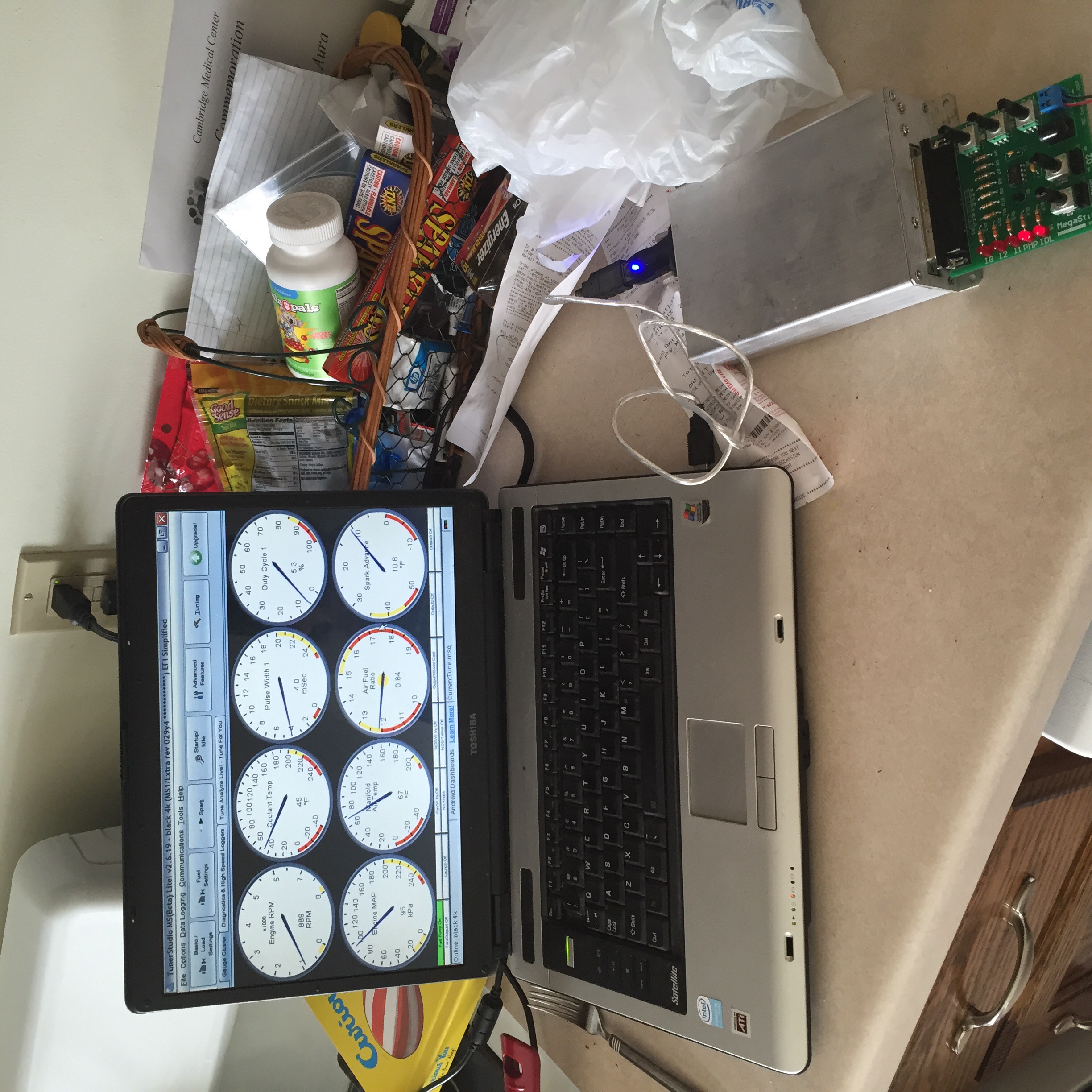

On a different note, Elaw is awesome and my ECU showed up today, which is looking faaaaaaaantastic! Thanks Elaw!!
Westco4k- I completely agree, again! Lol. I'm completely fine with a low powered and inconsistent 20vt 4000 for now. Like I mentioned earlier, this car fell in my lap a few months ago and I'm putting together pieces that someone started literally 10 years ago. There are tons of things that need attending to on this car and for now, the EFI is going to have to be a finicky and simple bitch lol. I've got this car and my rally car that need to be in a "driveable" state come spring so I can at least drive them on to a trailer to move halfway across the country lol. Spending a grand to completely upgrade management is absolutely out of the question, especially since I'm already not far away from being convinced to swap in the AAN from my rally car ha!

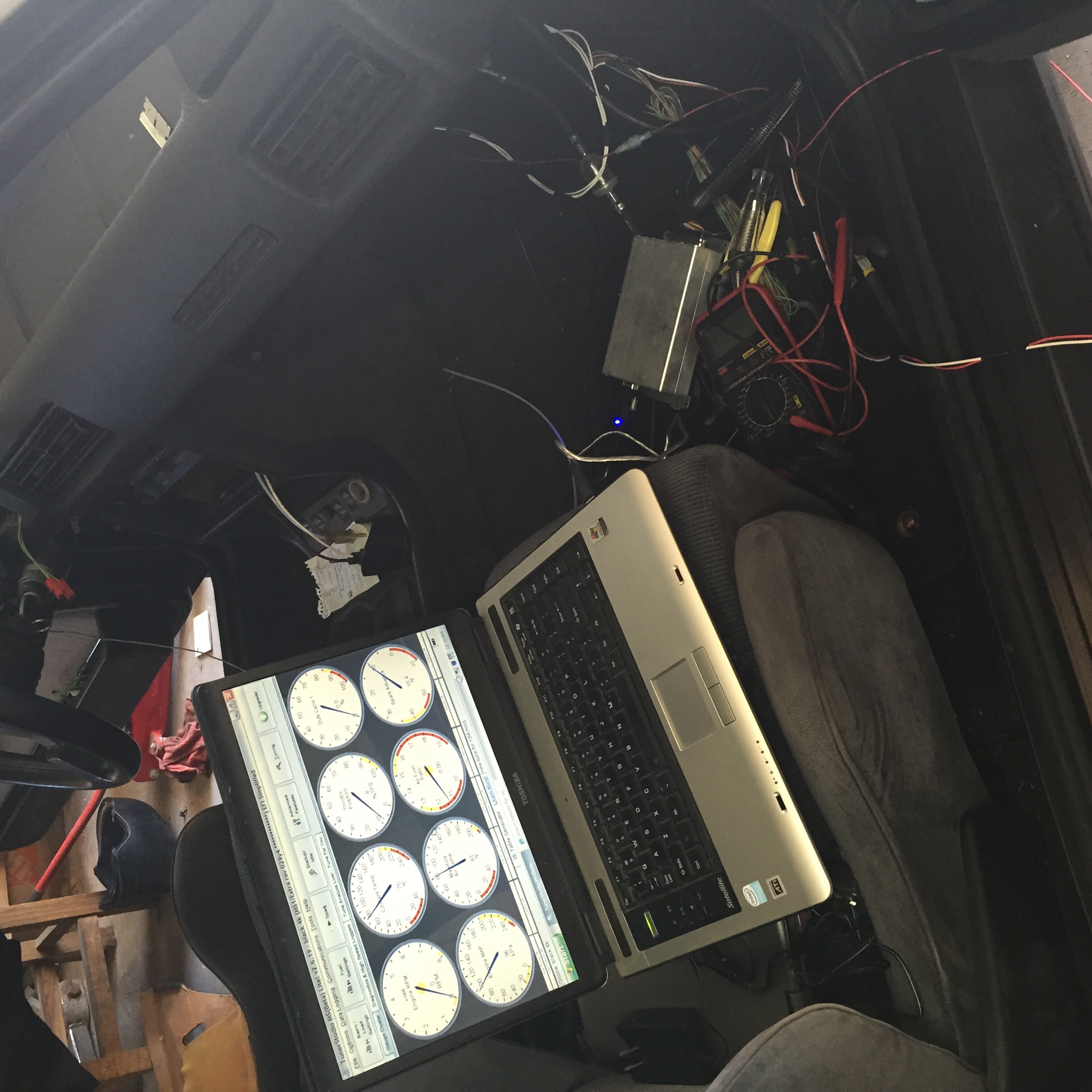

Sooooo.... This happened today! She's online! The power connections inside the car are just roughly attached and I'll go back through and finish up after I get it started and idling. Everything seems to be working just fine. Went through and tested everything that gets power and they're good. Pretty sure the fuel tank is BONE dry haha. I'm hoping the pumps not gummed from sitting for a decade. I had to chase around a little bit with the fuel pump relay but got the pump to kick on like it should. I still need to wire in the wideband, change the oil, put fuel in and add coolant, BUT I'm going to try and start it on Thursday! Woohoo!
I tend to have the "while I'm there" mentality to bigger upgrades westco4k lol. With my math for a new ms3x, harness and associated supplies(pins, terminals, connectors, etc), LS coils, and 60-2, me myself would def have a grand into it. Plus a bigger turbo but that's neither here nor there lol. I'm sure I could do it for less especially after selling this old setup off but I like to start completely fresh with wiring. For me it's actually a time saver vs picking through all my old shit. Aannyhow, how's your car coming along? I still need to read through your whole thread. I read through part of it the other day at work but didn't get to finish it. Cheers!
