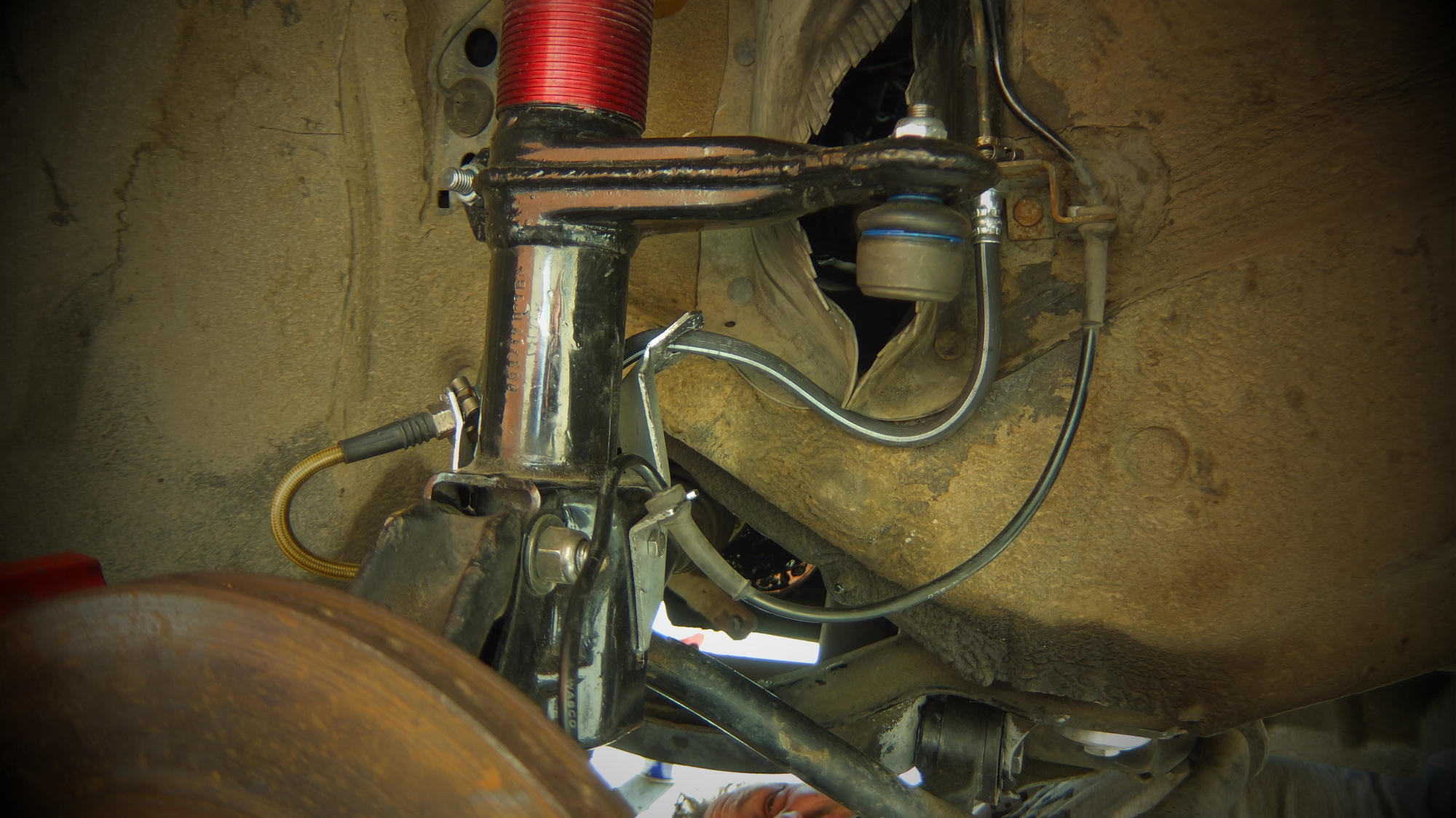

i did mine like this:

My concern is how it fits to the caliper. I do not want the line to travel straight out from the caliper as the 034 lines do. They were supposed to fit but...
Chris

here are more pictures; first i had the boxter caliper, now a different one

How long are those lines to the caliper?

The stock brake line from the strut to the G60 caliper is 160mm and is too short for the 996 caliper as the connection is further down the caliper.
When I installed mine, I used a self made hard line running from the first line around the strut to the caliper. This is what was used on an RS2. Makes it a pain changing out the rotor through.
Personally, I am looking at the rear brake hose from an UrS4/6, to replace the short coupe one. It is 205mm long. Doing a string measurement on the hard line from the strut, this should be long enough. It would make things simple. Personally, I don't think SS lines are needed.
Or maybe the outside rear caliper hose from a B4Q. It is 215mm.
Greg W.

Thanks Greg. I can do the hard line easy enough & that may be the best option. I have many left over lines from various projects so I will look to pick up some adapters to use at the rear.
