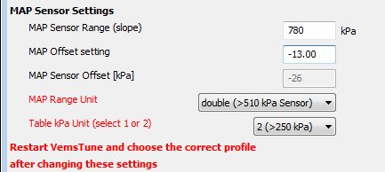

700 : set "MAP range unit"> 510 and MAP range=778 kPa --> done ans sensor is working fine - tested up to 650kPa on VEMS Gauge
Problem, now I see all map values in VEMStune are half and Top Limit in Tables is 255

Did you change "Table kPa unit" to 4? It's right below "MAP Range Unit" You didn't mention that in your description of the problem.

VEMStune help sais: "Table kPa Unit This is usually set to '2' for standard MAP sensors."
Setting it to 4 when ECU connected is limiting the MAP Sensor Range to 510kPa (should be 1020 like it is on setting it to 2)
When VEMS is connected to VEMStune - all kPa Units are shown right up to 700kPa
When loading the saved config without VEMS connected, all kPa Units are half value...

calibration
after setting map range unit to double, VEMStune must be restarted to set values higher then 510 in range (after restart, max is 1020)

short summary:
ECU is connected
Map Range Unit set to double >510
Table kPa Unit = 2
Burn
Save
Restart
Map Sensor Range (Slope) set to 778 (limit is 1020)
Burn
Save
Now VEMS can show MAP up to 700kPa on Gauge
Limit for Map in Tables is 510 --> error
Logs are shown correct up to 700kPa
Setting Table kPa Unit = 4
Limit for Map Sensor Range is 510 now
Limit for Map in Tables is 255
ECU offline
loading the saved config file to VEMSTune - ECU offline
Map Range Unit is double >510
Table kPa Unit = 2
Map Sensor Range (Slope) is 778 (limit is 1020)
All Tables show MAP values half
Limit in Tables is 255kPa
Limit in Menus is 255kPa
typing 240 in Top of VE Table
Loading this file to ECU (connected) and all values are shown correct (480) but limit is 510 in tables :bangshead:
