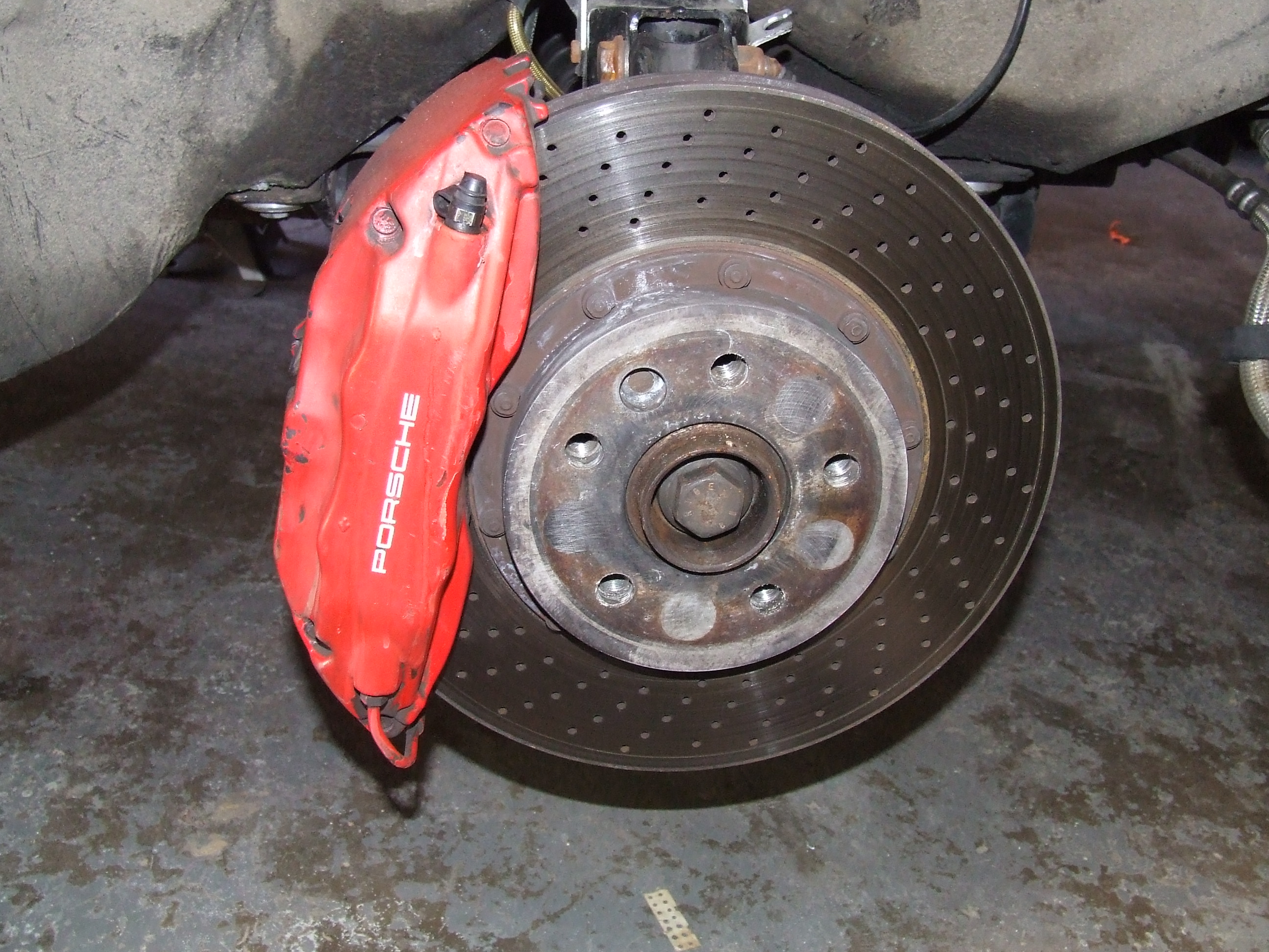

by Mcstiff
Re: Coupe 320x32 two piece rotor BBK
Posted: Sun Feb 01, 2015 8:19 pm
by Zaworek
Looks good. Who did the hats for you
Posted: Sun Feb 01, 2015 8:42 pm
by varia
Porsche 993tt/GT-3 322x32mm rotor w/ BIRA rotor hat
Posted: Sun Feb 01, 2015 10:00 pm
by Zaworek
i know about bira hats but i dont think you can get them any more looks good
Mcstiff what suspension is it ?
Posted: Sun Feb 01, 2015 10:37 pm
by Mcstiff
I'm not really sure about the hats; given the builder he could have made them. I linked to a thread back on AW where Mance mentions the setup.
More about the suspension in my build thread (link in sig).
//Ok, looks like Billzcat made the hats...aka, NLA.
