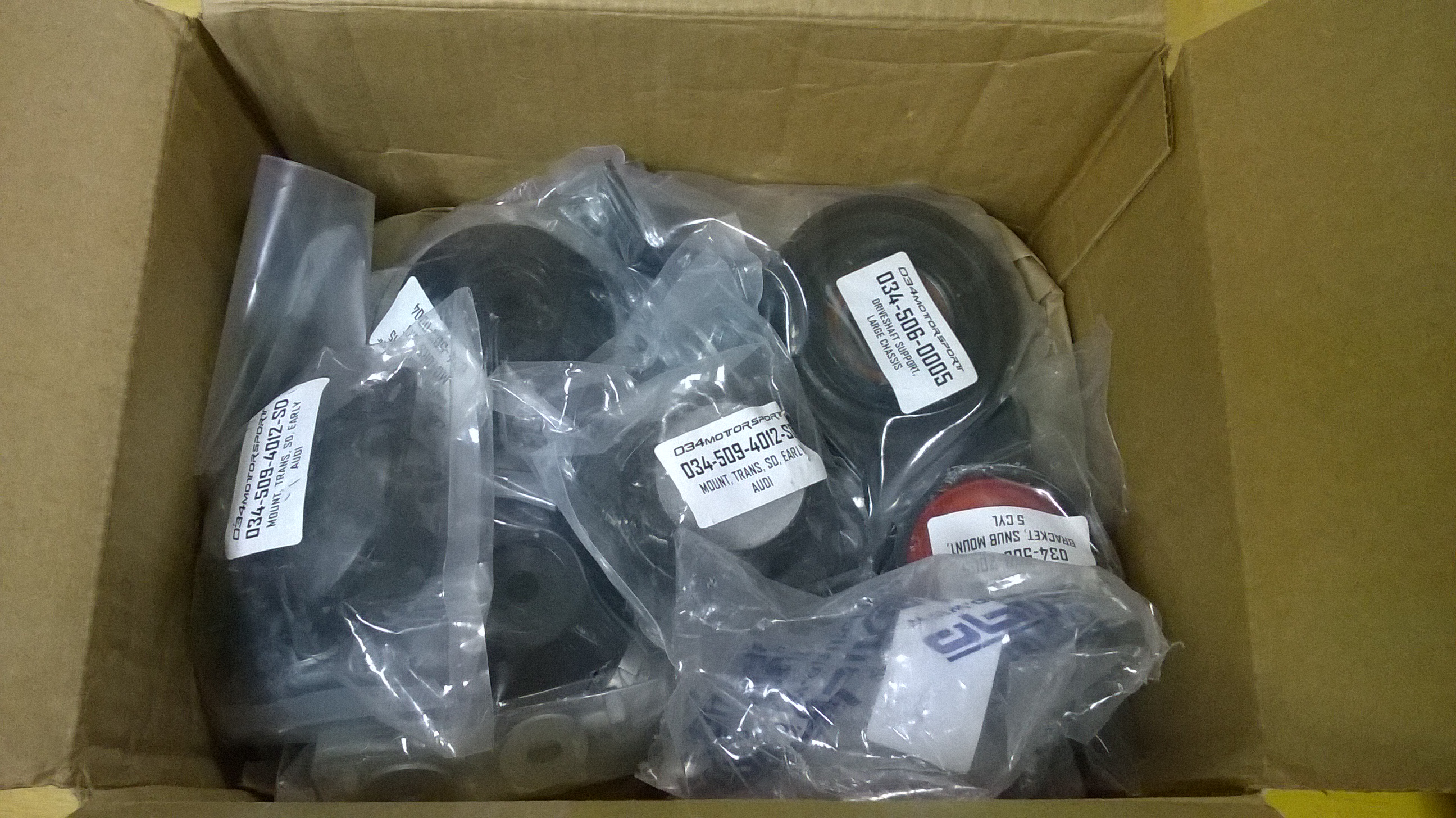

Bangs and clunks will be dealt with once the snow is gone and I get the car on lift, I already bought some aid from 034.
- 034 first aid

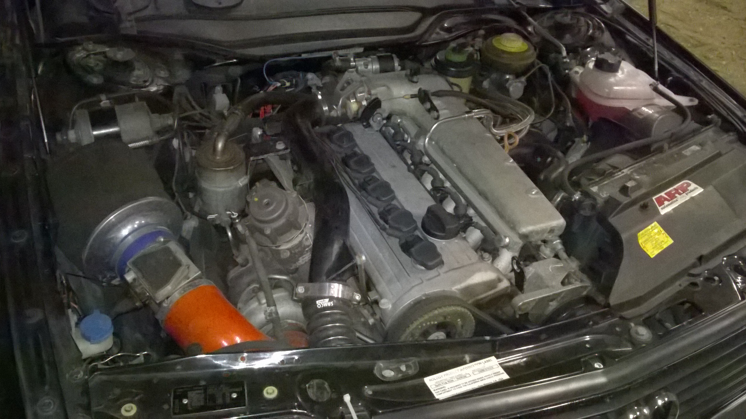

Heres one bad pic from engine bay.. Needs a clean up + something more.
- WP_20141210_003.jpg (1.58 MiB) Viewed 58575 times

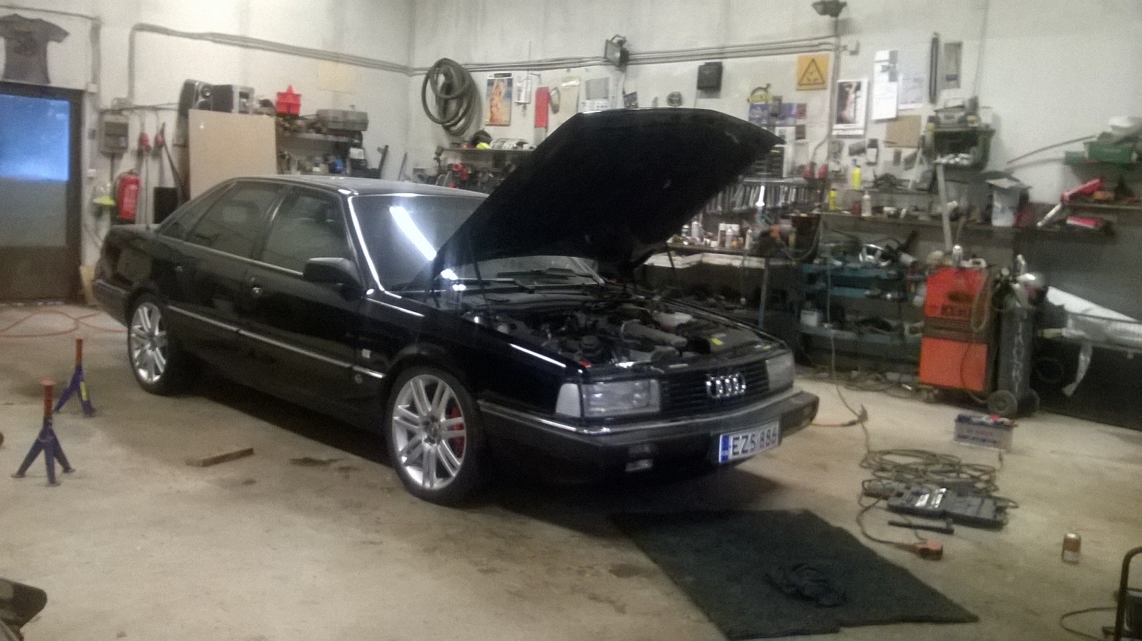

OK, so some update here as well...
Situation is as follows:
- WP_20150320_006.jpg (499.28 KiB) Viewed 57874 times
And the summer is coming fast. (D'oh!)
Painted some bits and bobs, but failed miserably.
- WP_20150316_002.jpg (464.99 KiB) Viewed 57874 times
Turns out I need to keep the hood closed from now on..

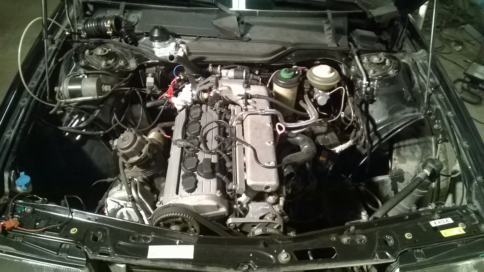

Found out that the radiator is busted and ordered full aluminium one from ebay.
There apparently is no alternative source for radiator/water hoses apart from 034 silicone set?
While taking radiator off I might have done some serious damage to the a/c cell in front of rad.. Now thinking to remove the whole a/c as it needs almost new everything to work properly.
Also need new washer fluid tank before taking this back to road.. The old one has turned into glass or some sort.

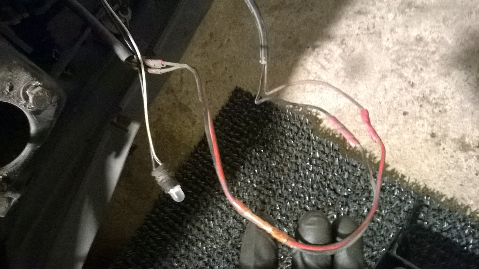

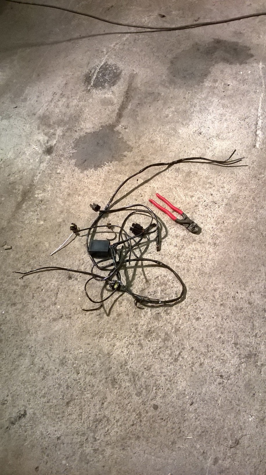

While taking everything apart I found out that this one is assembled mainly using drill screws and with electrical miracles as this:
- WP_20150320_007.jpg (421.91 KiB) Viewed 57874 times
This one has also had xenons at some point..
- WP_20150317_007.jpg (624.47 KiB) Viewed 57874 times
But never again.

Ok, so the wires are mostly sorted now.
Got rid of all of those horrible connections and made somewhat a harness for lights in bumper.
Might still redo the coil wires at somepoint as they seem a bit odd...
