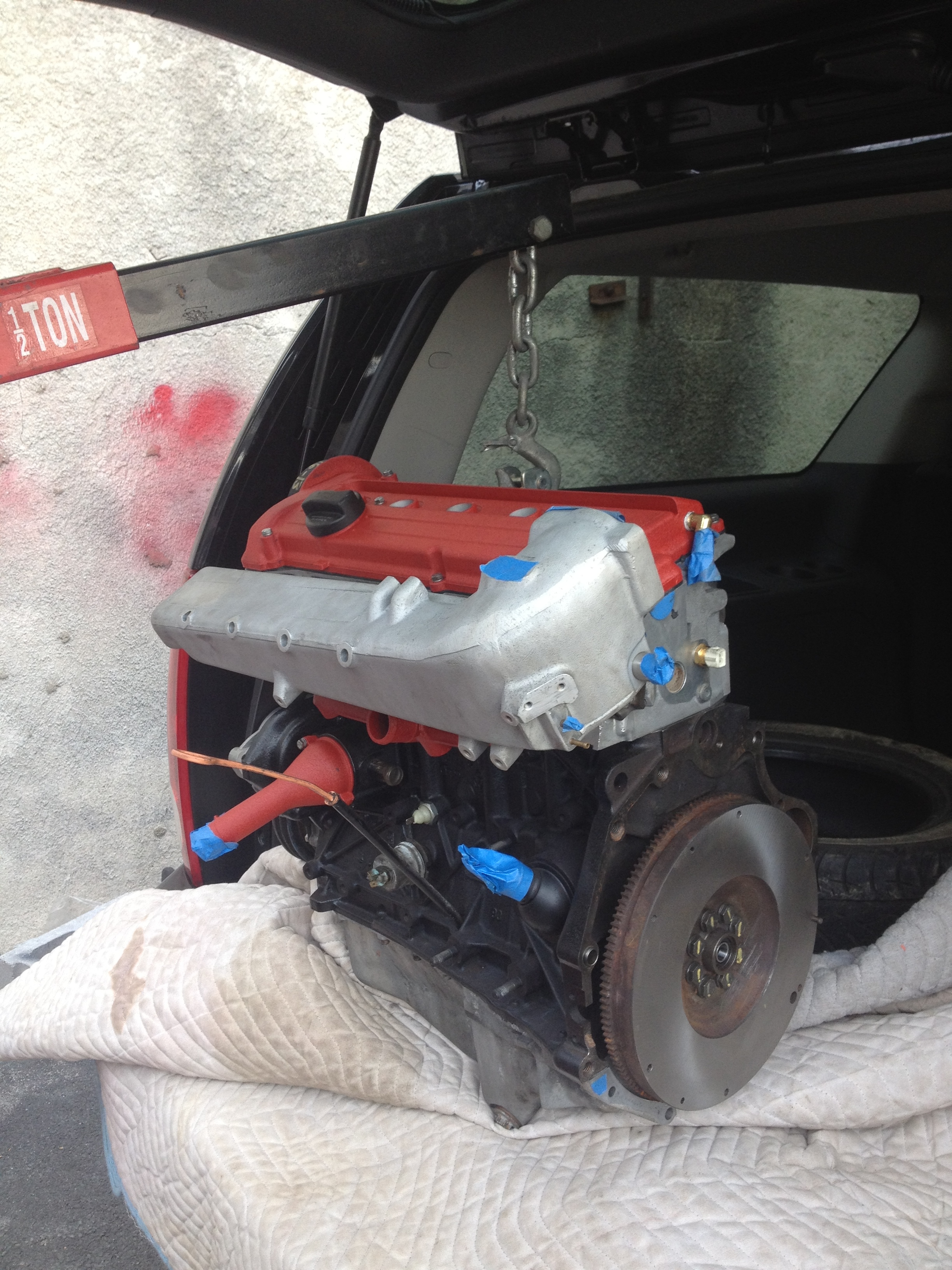

I took some photos along the progress and will start with the current photos and description and work backwards
Here are some details and i will try to upload photos of the build in the same order.

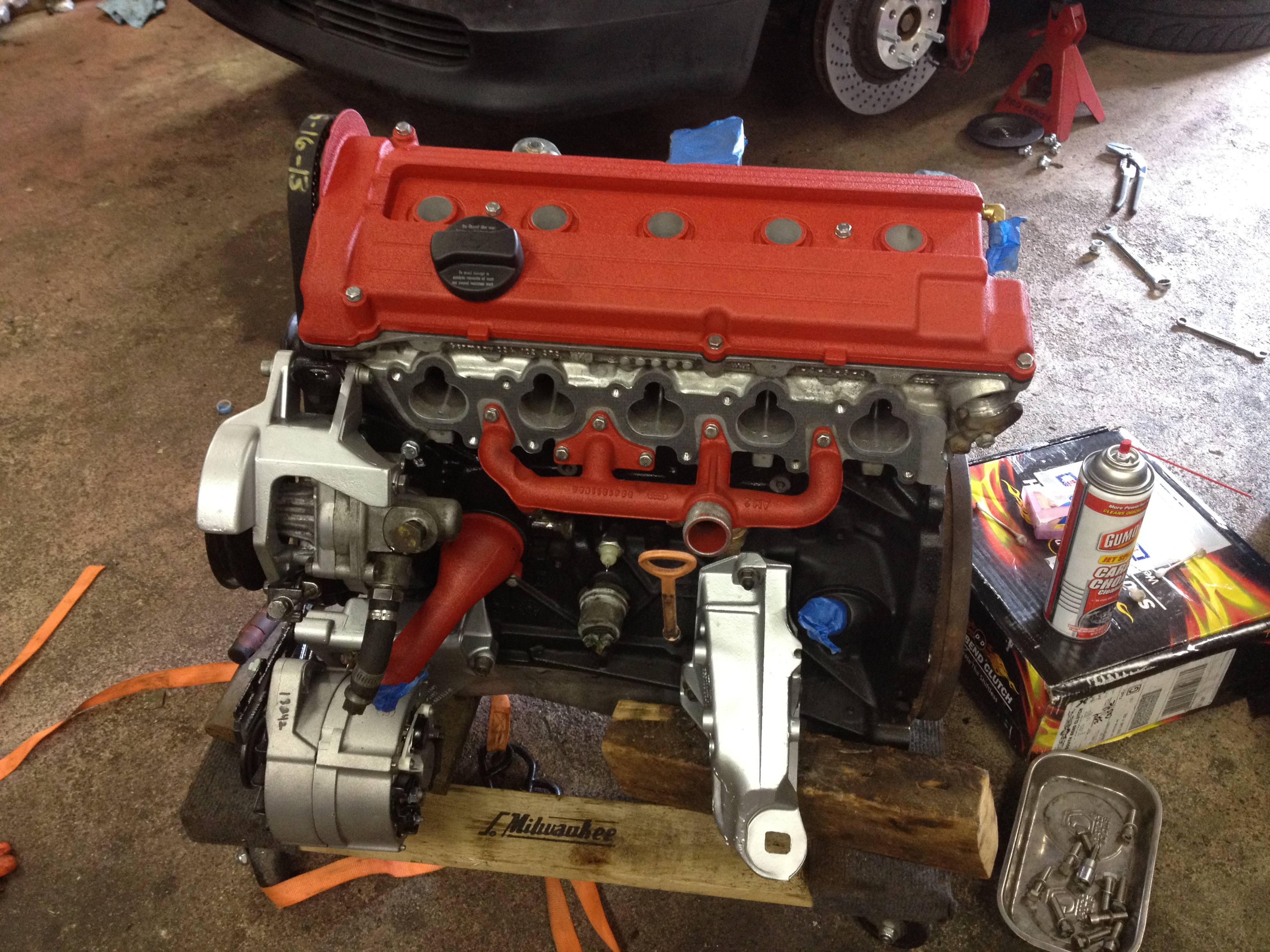

Engine

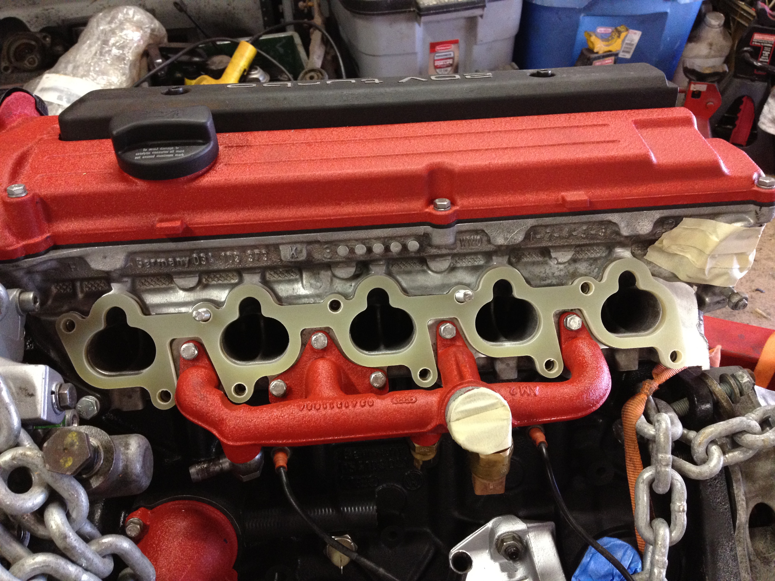

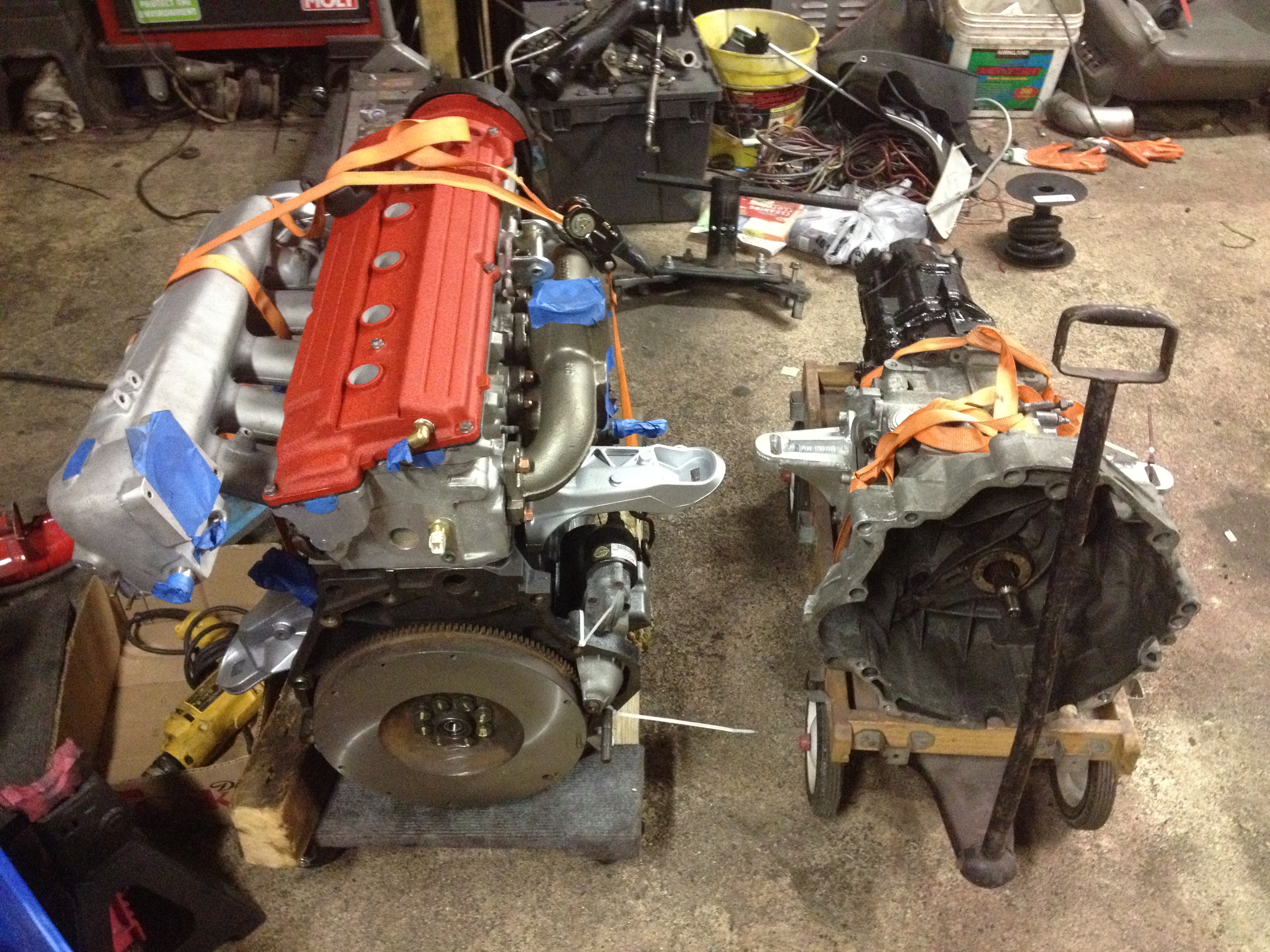

- 3b motor
- Stock pistons
- Scat rods,
- Coated bearings
- Brass distributor gear upgrade
- Phenolic spacer
- GT 3071r turbo anti-surge inlet, 3" V-Band outlet
- Fully rebuild head
- Individual coils conversion
- Replaced all coolant hoses
- Fully rebuild head with new valves (Intake / exhaust), new guides, lifters
- ARP Studs
- No AC
- all gaskets, seals replaced
- hardened timing belt cog gear
- timing belt kit , tensioner, water pump
- some carbon fiber dressing along with red wrinkle powder coated valve cover, thermostat housing and water manifold.

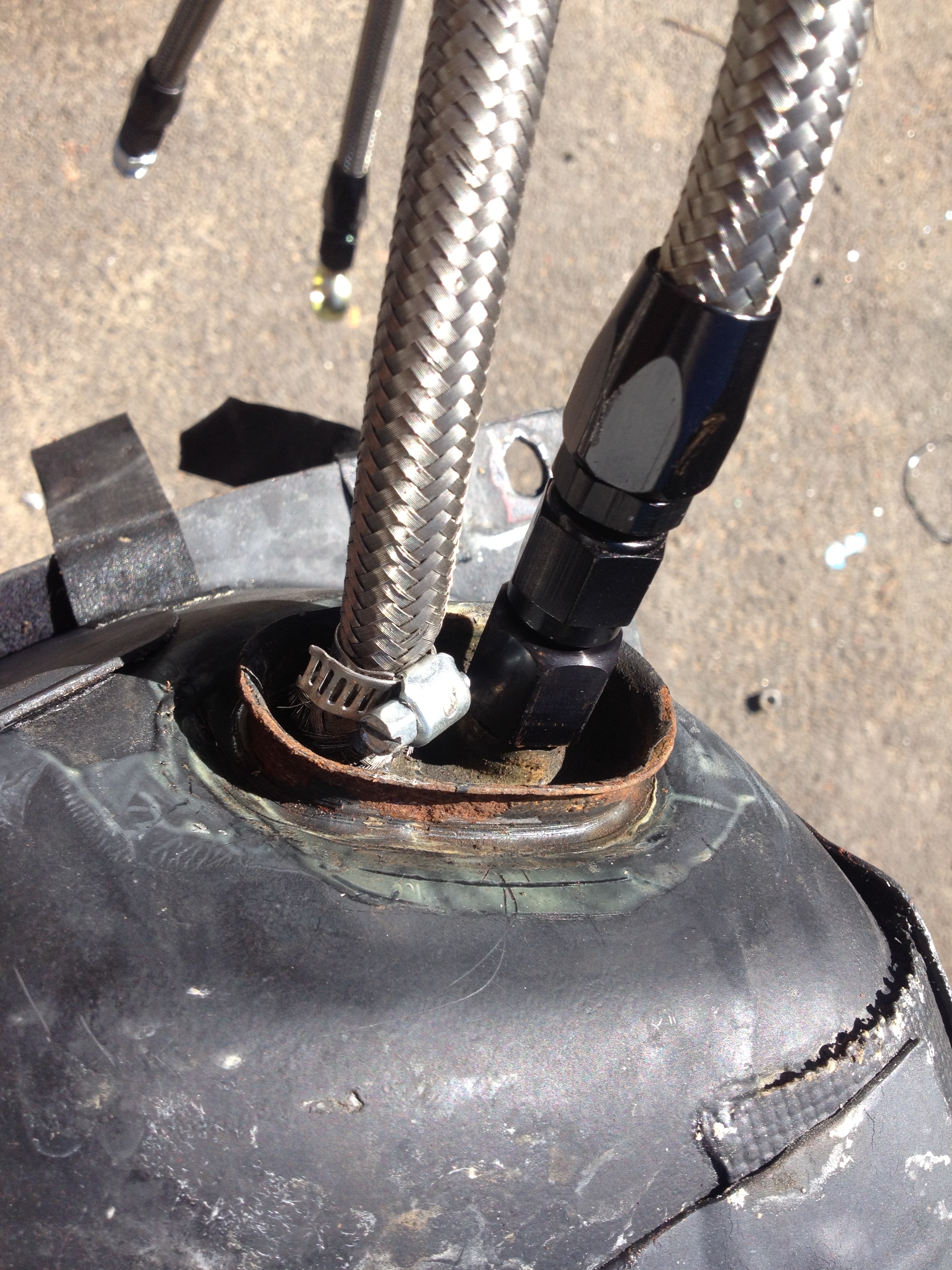

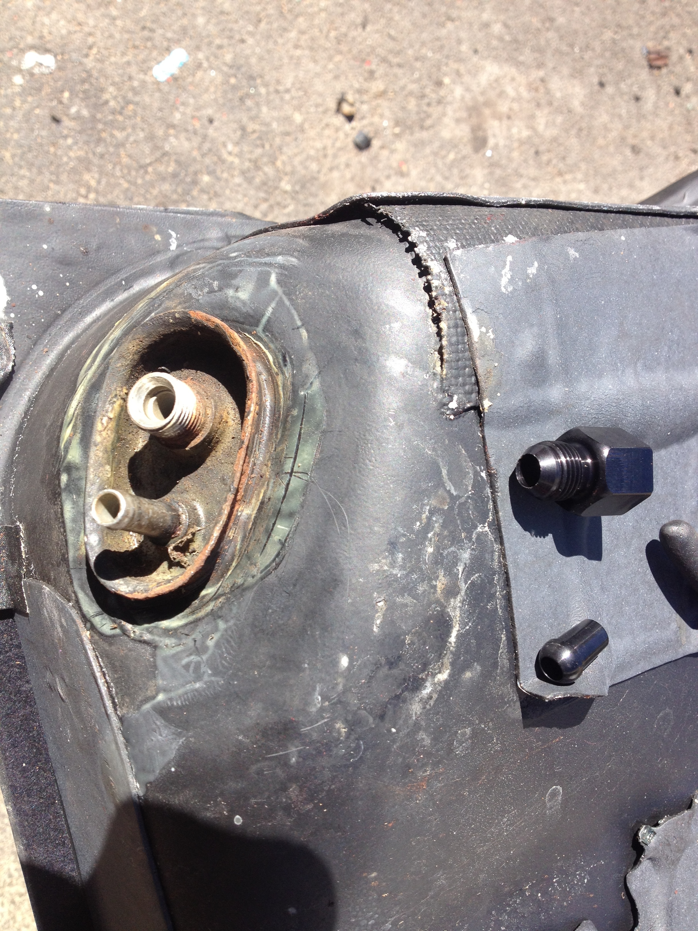

Fuel delivery
- EFI Express fuel rail -6an
- 1200cc injectors
- Aeromotive fuel pressure regulator
- ss braided fuel lines
- Steel hard lines front to back under chassis
- Refreshed fuel tank
- 93oct /e85
- Fuel tank plastic hose delete
- upgraded fuel pump

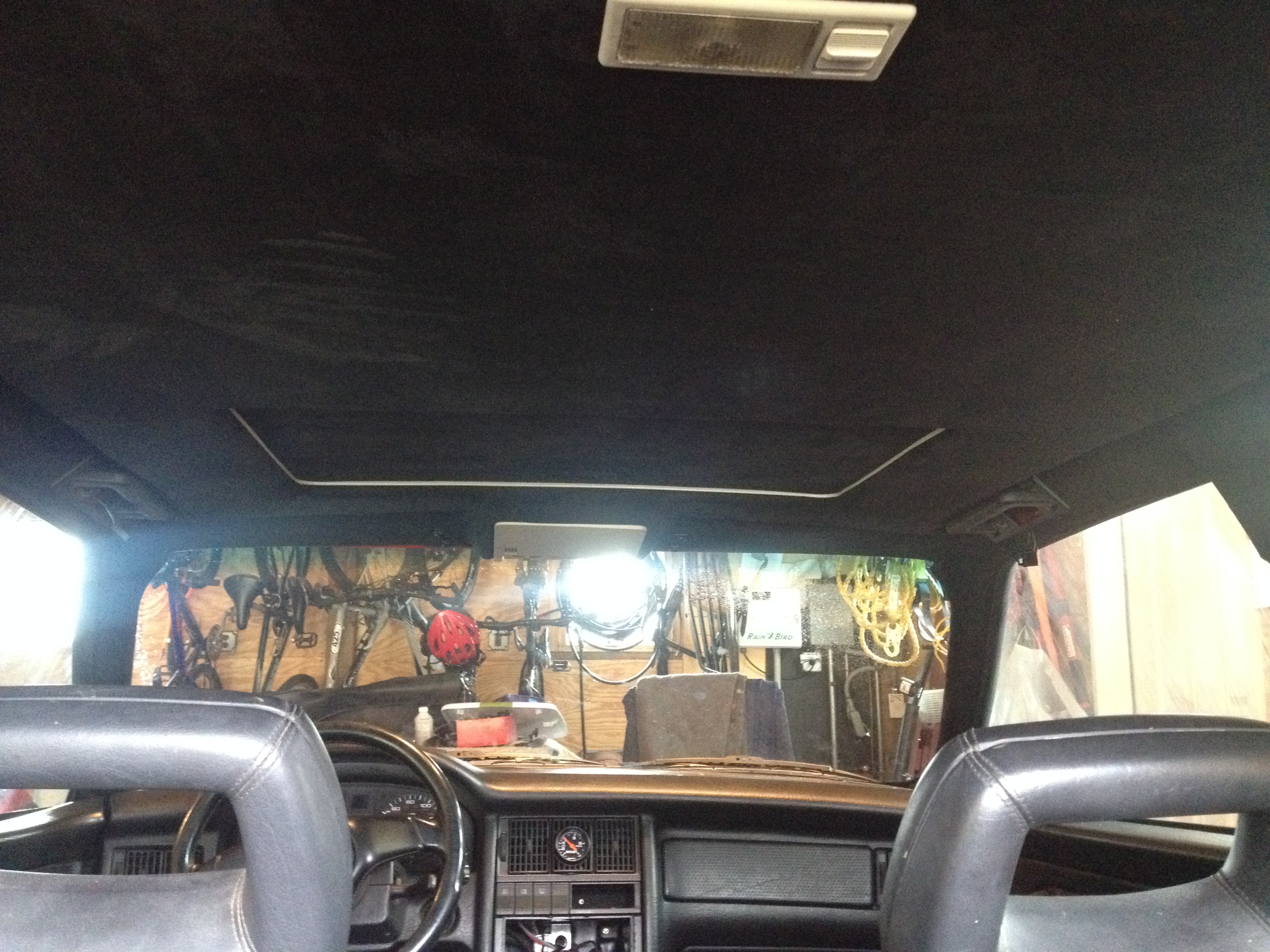

Interior
- All upper trim A B C pilars and head liner in black suede
- s2 black leather trim
- b4 manual heating unit also blacked out trim
- led lights
- s2 steering wheel
- s4 b5 shifter knob

Transmission
- 01e 6 speed
- Stage 4 + clutch 6 puck
- Audi s4 b5 modified shifter linkage
- Rebuild rear diff
- Rebuild Audi 4k prop shaft
- Rebuild axles
- EFI Express tranny brackets

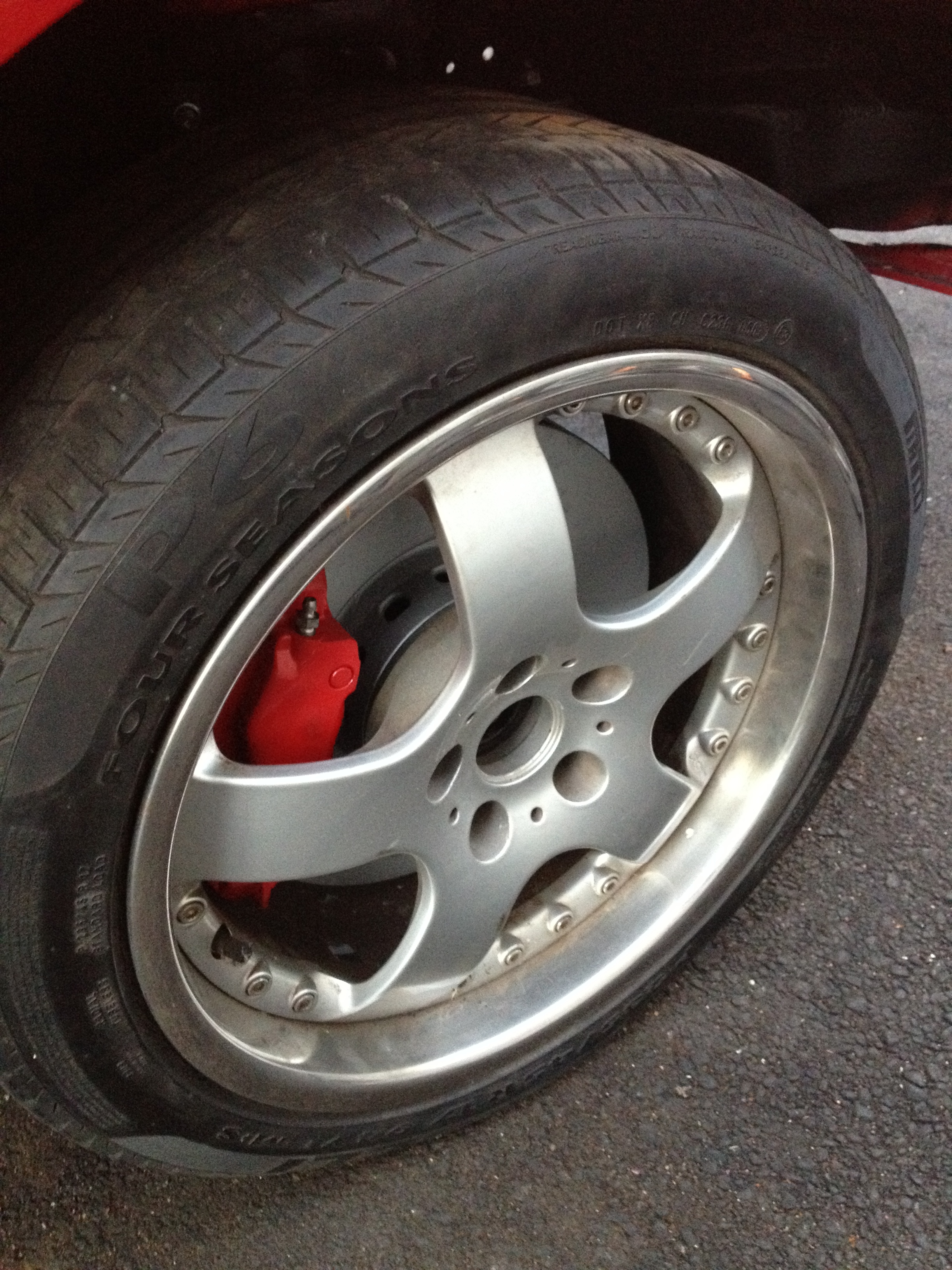

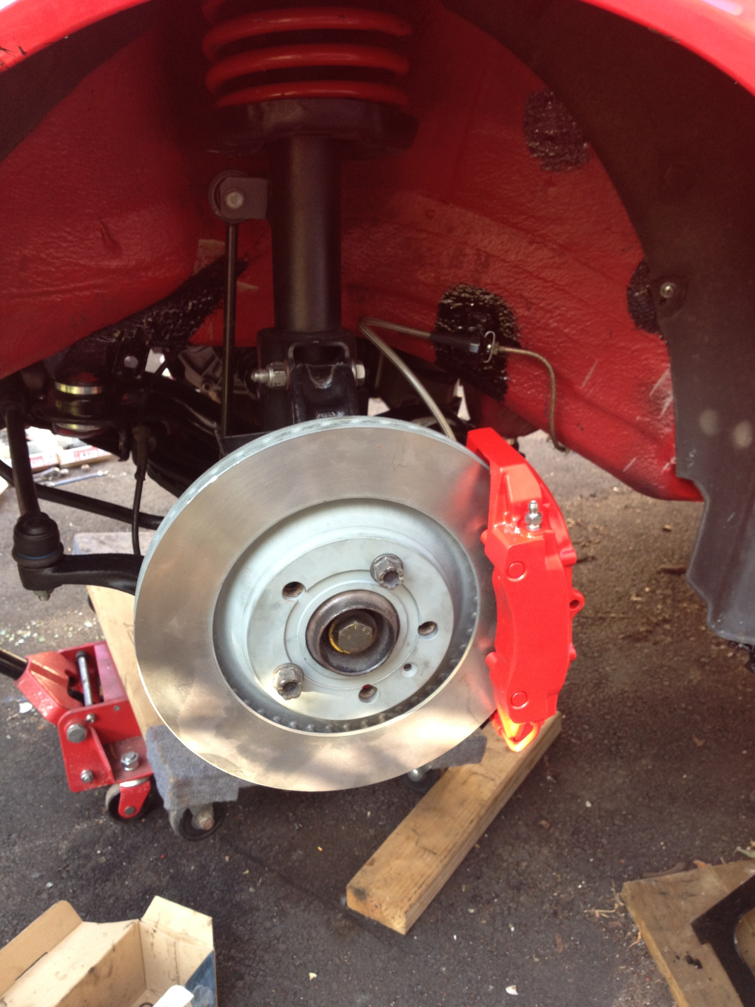

Front
- Porsche Boxter S calipers 4 piston
- Audi a8 323mm x 30 rotors
- Custom brackets
- ss braided lines
Rear
- Porsche Boxter S rear Calipers 4 piston
- Audi s4 b7 rotors 300mm x 22
- Custom brackets
- ss braided lines
- Hydraulic e-brake conversion - modified stock handle to accommodate the hydraulic cylinder under stock center console
Wheels
- 17 inch wheels wrapped with 235/45/17 BF Goodrich comp 2

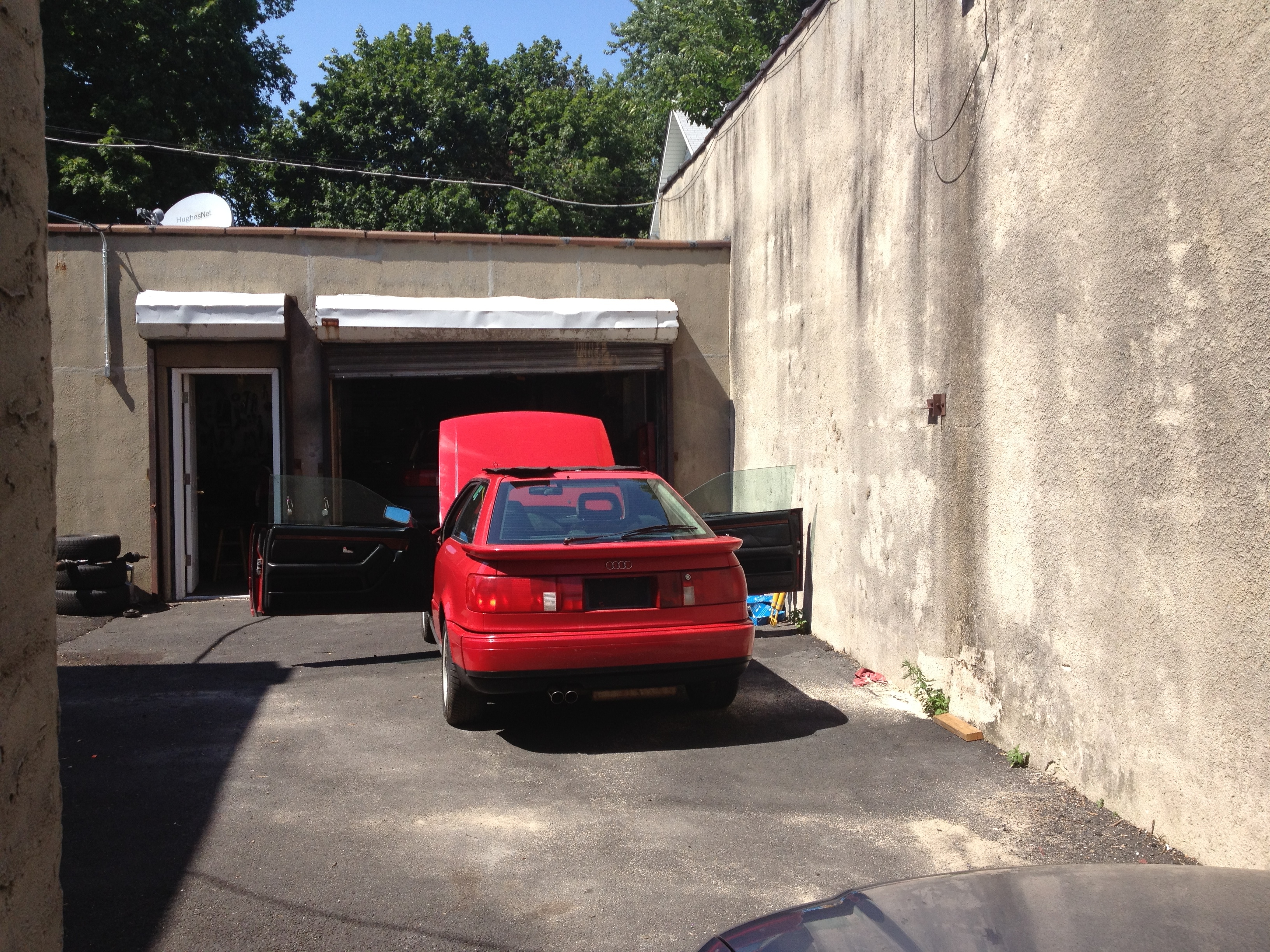

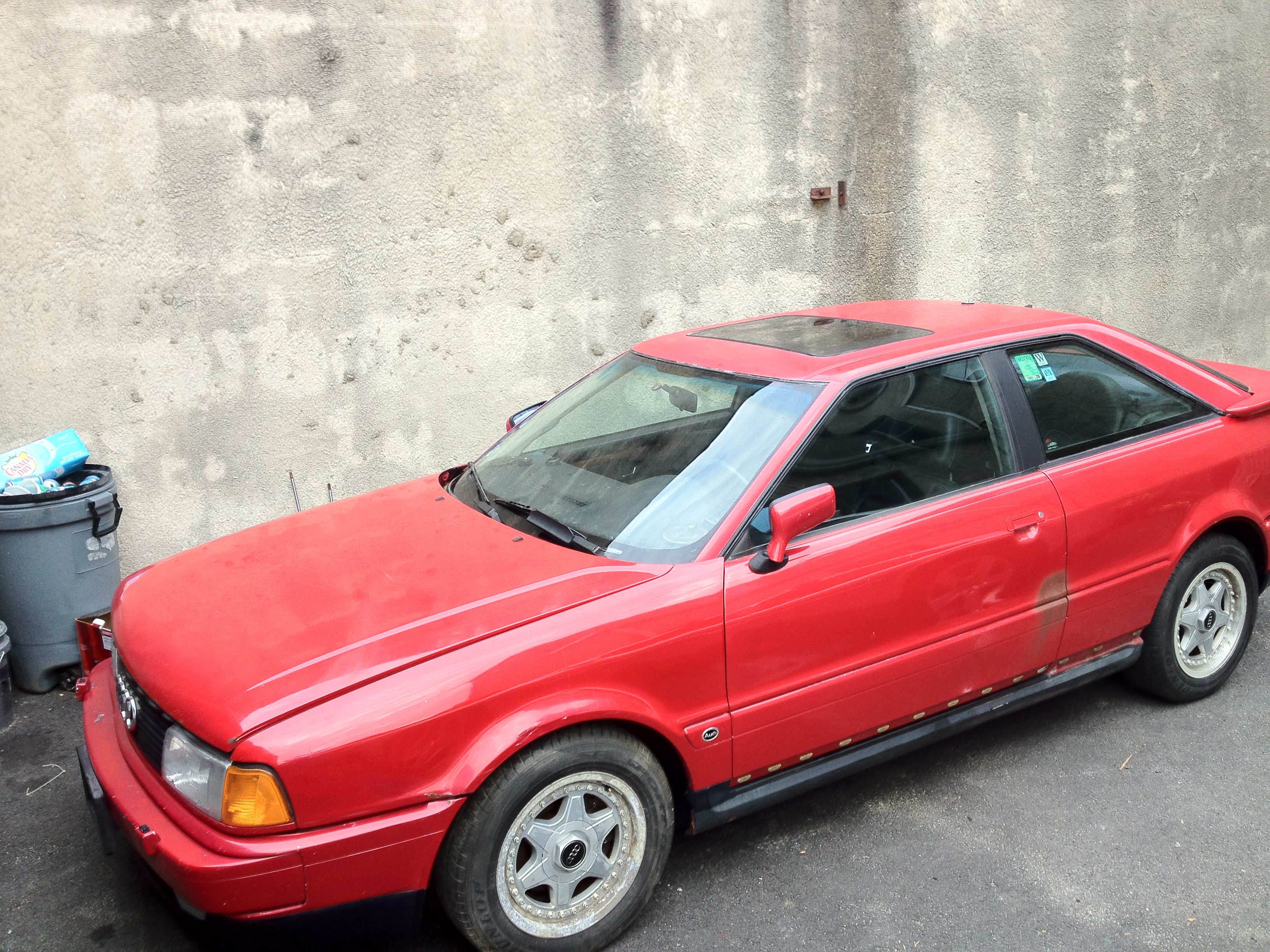

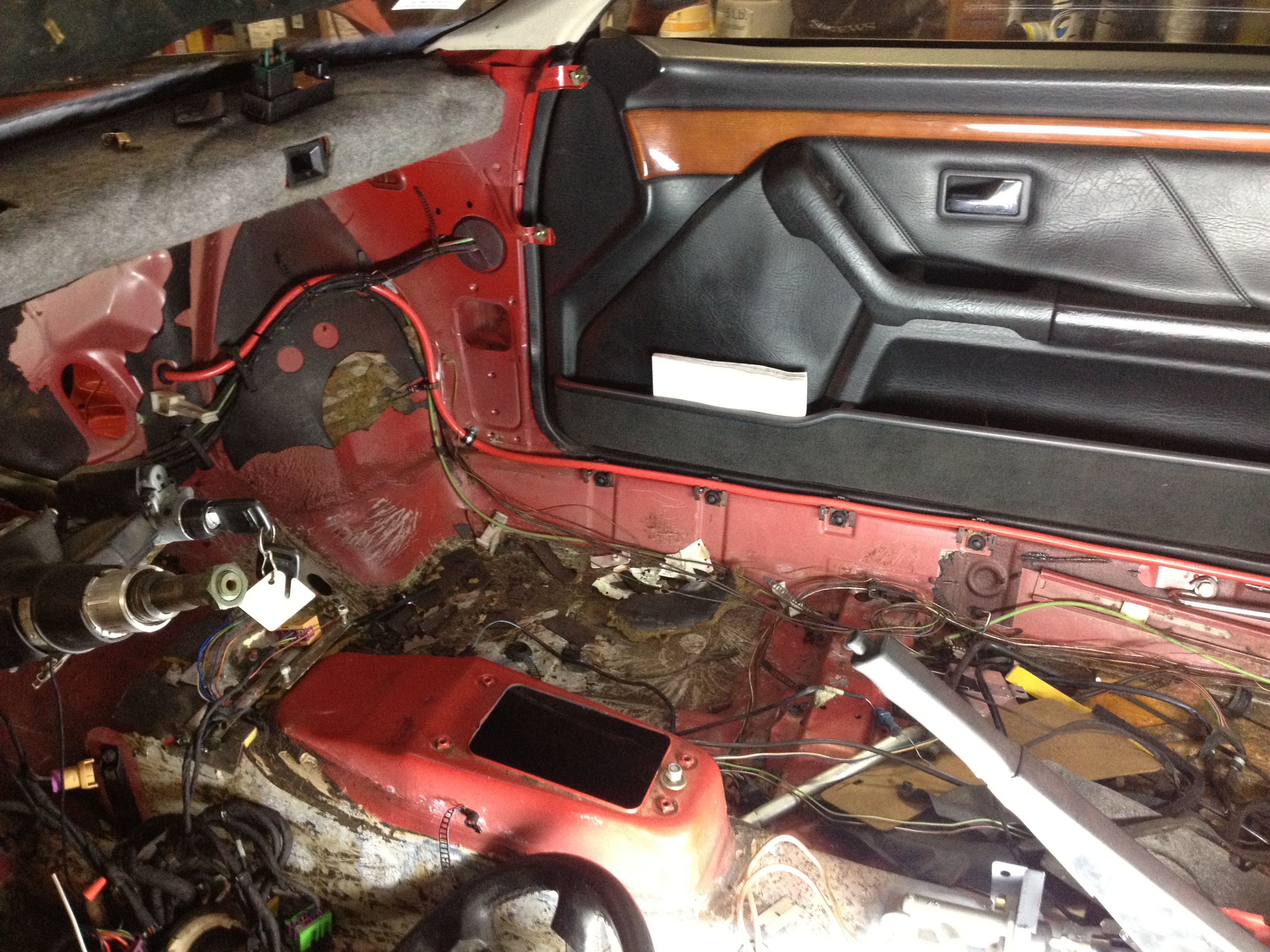

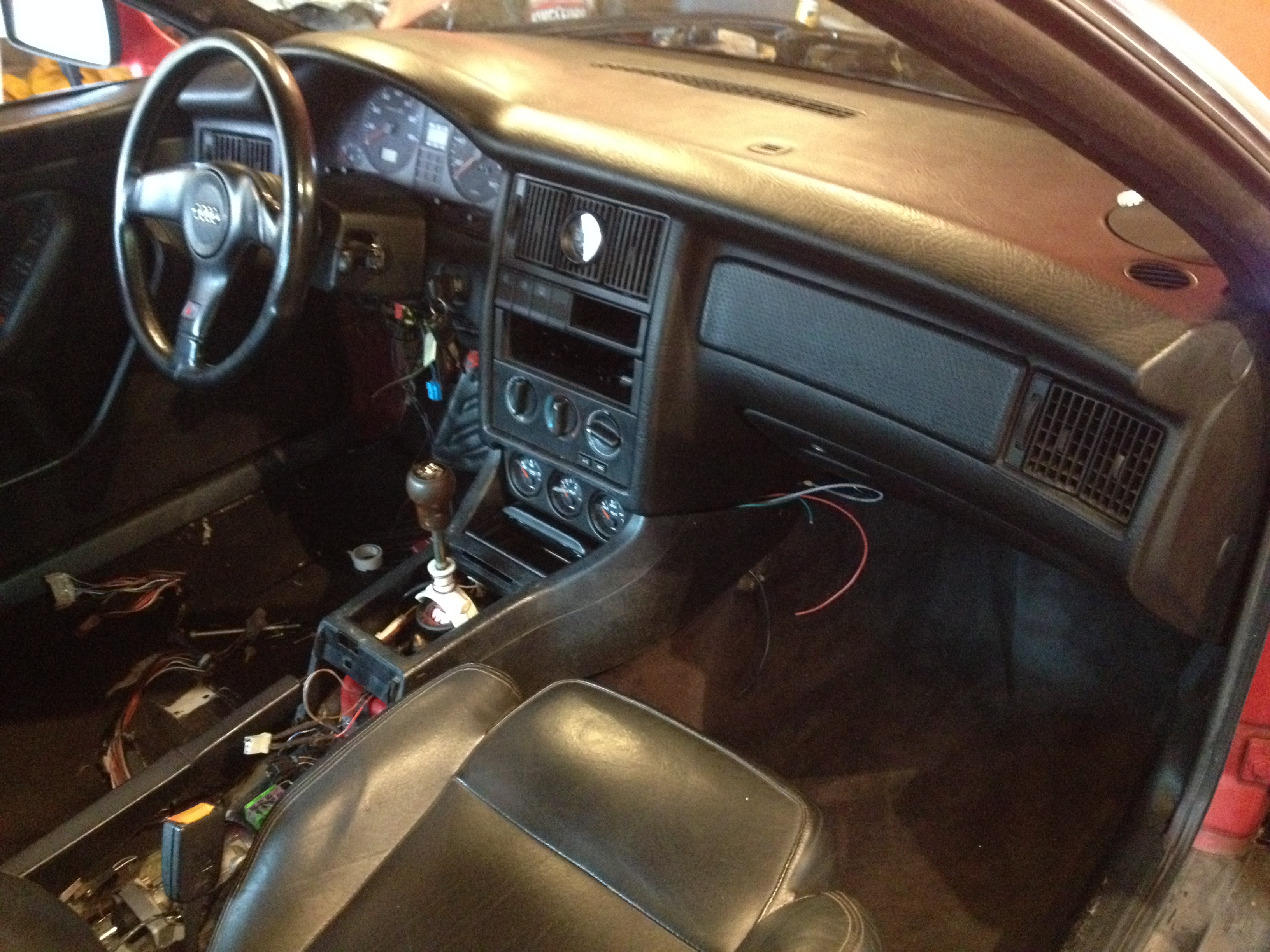

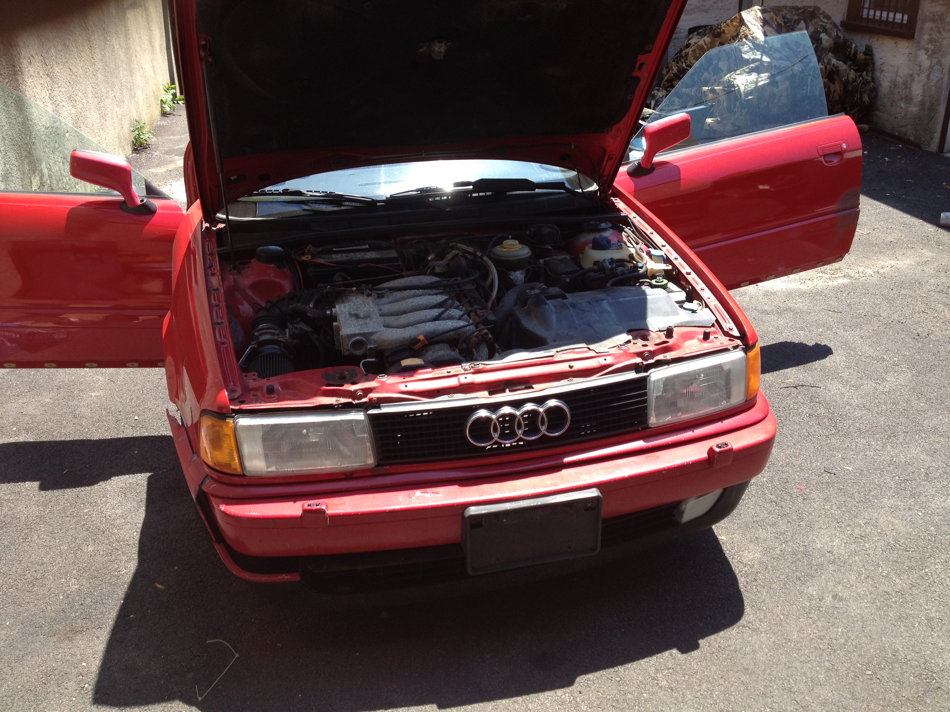

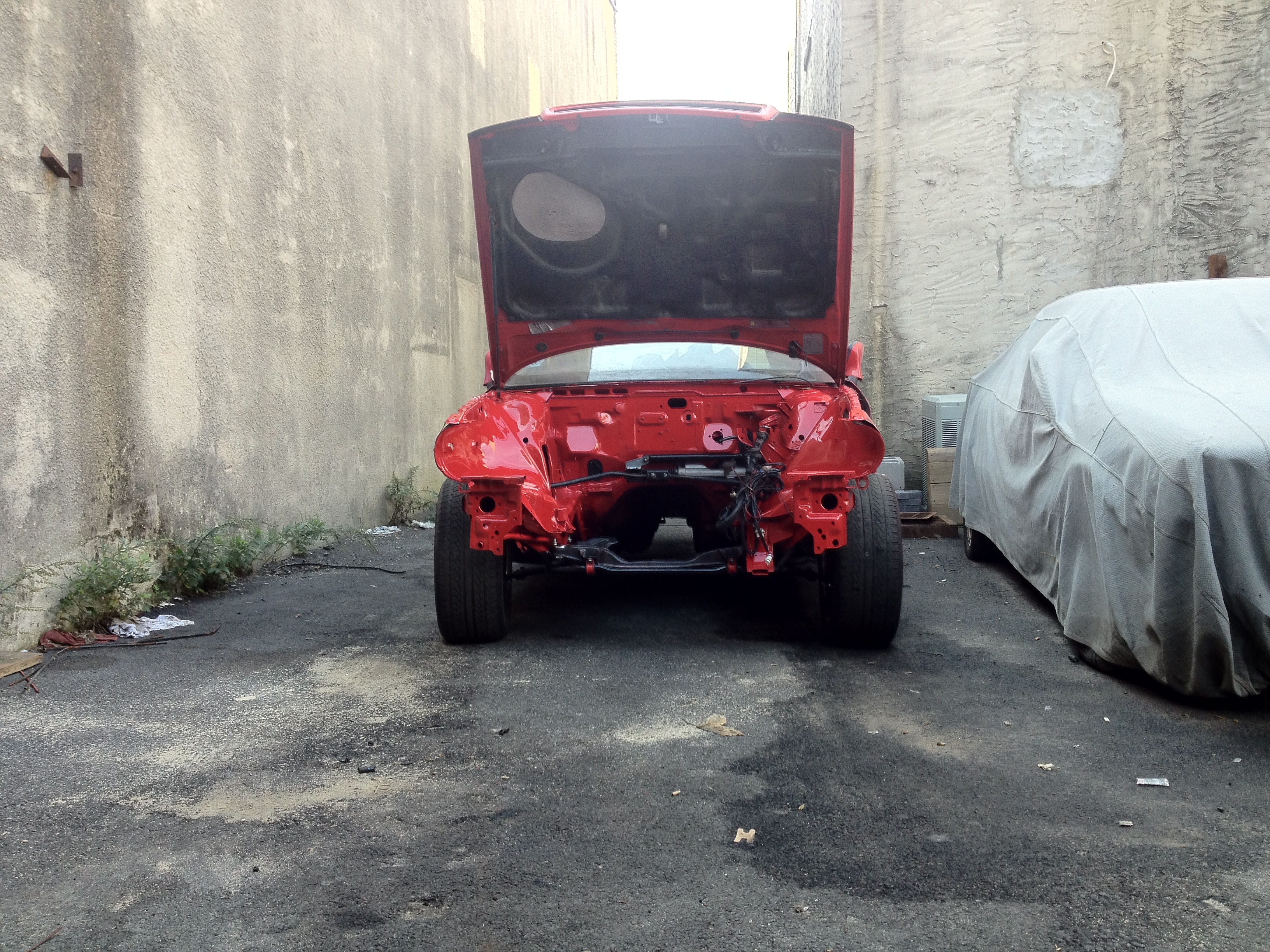

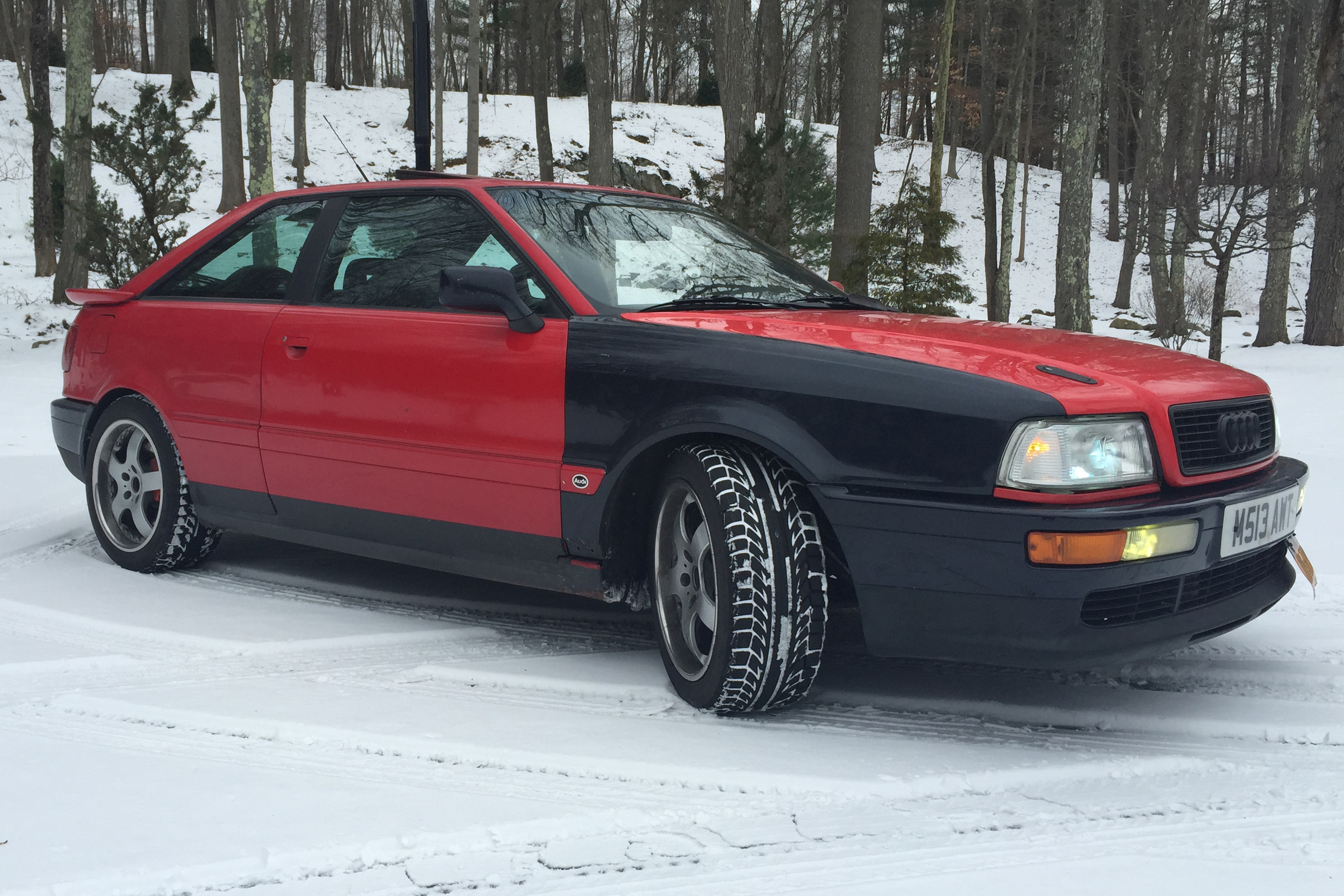

- Sebastian's CQ91' winter .jpg (2.99 MiB) Viewed 42093 times
- Sebastian's CQ91' road trip 4.JPG (2.54 MiB) Viewed 42093 times

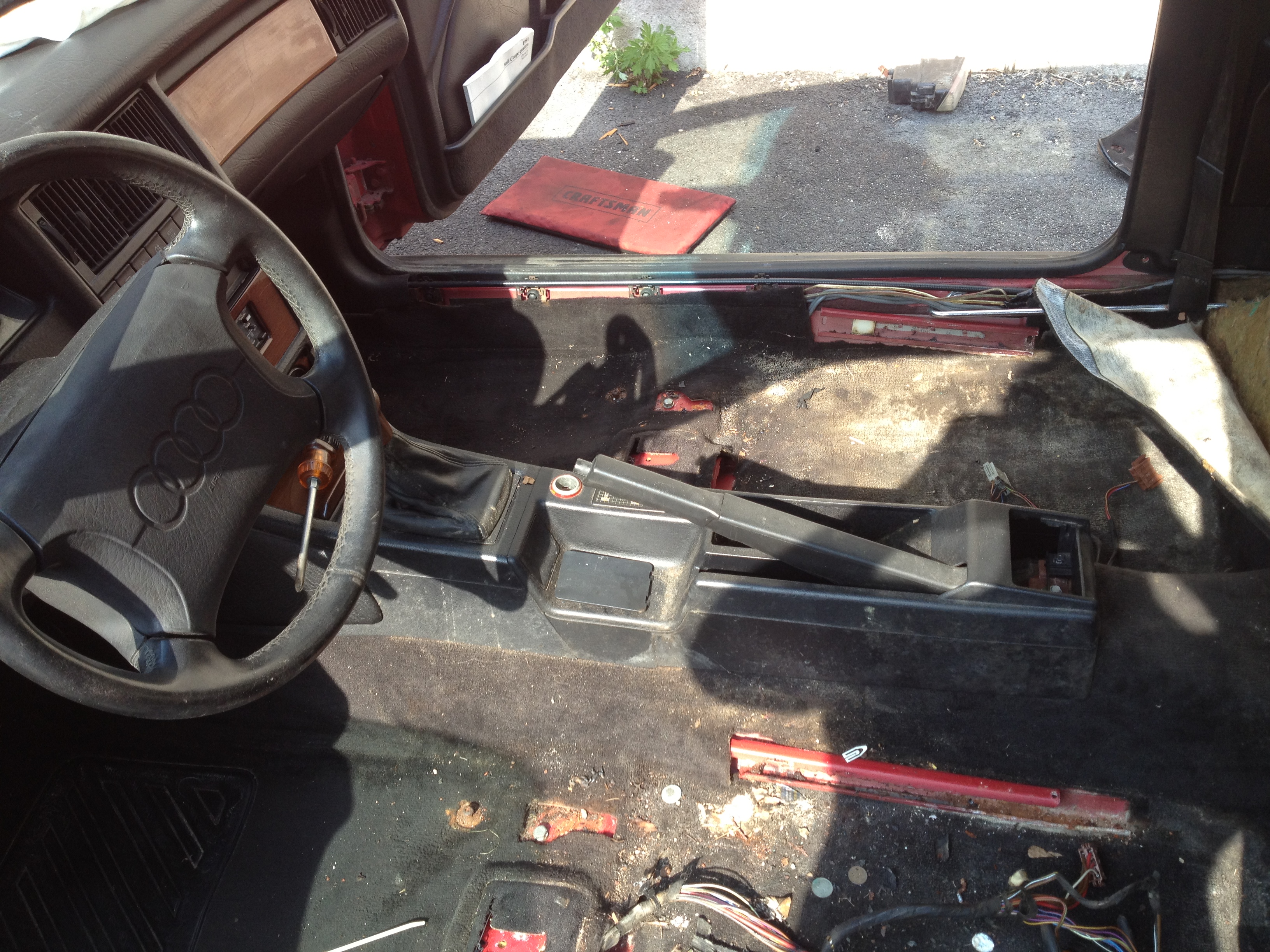

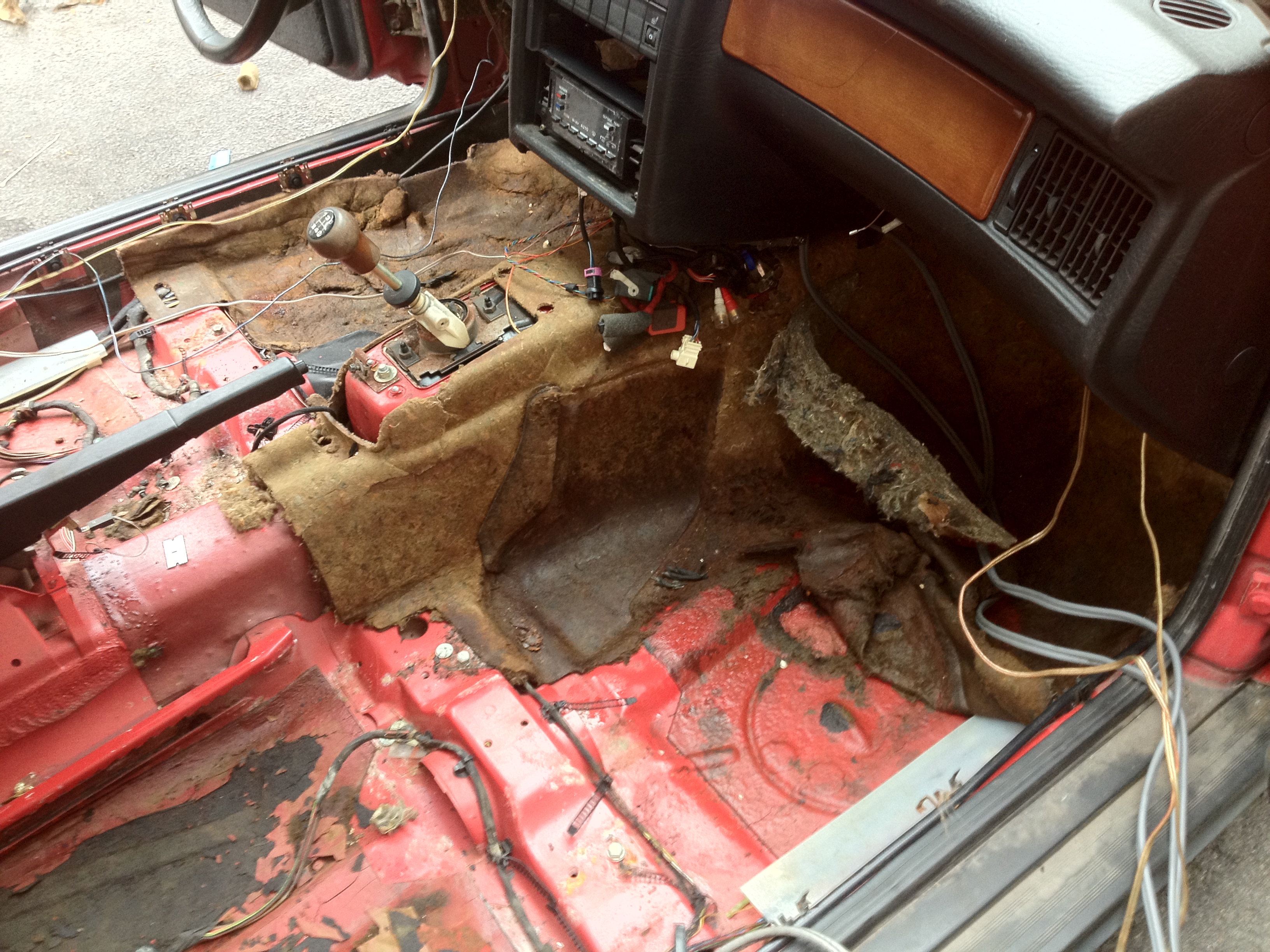

- Sebastian's CQ91' initial inspection .JPG (2.97 MiB) Viewed 42093 times
- Sebastian's CQ91' project 1.JPG (3.58 MiB) Viewed 42093 times
- Sebastian's CQ91' initial inspection 3.jpg (3.97 MiB) Viewed 42093 times

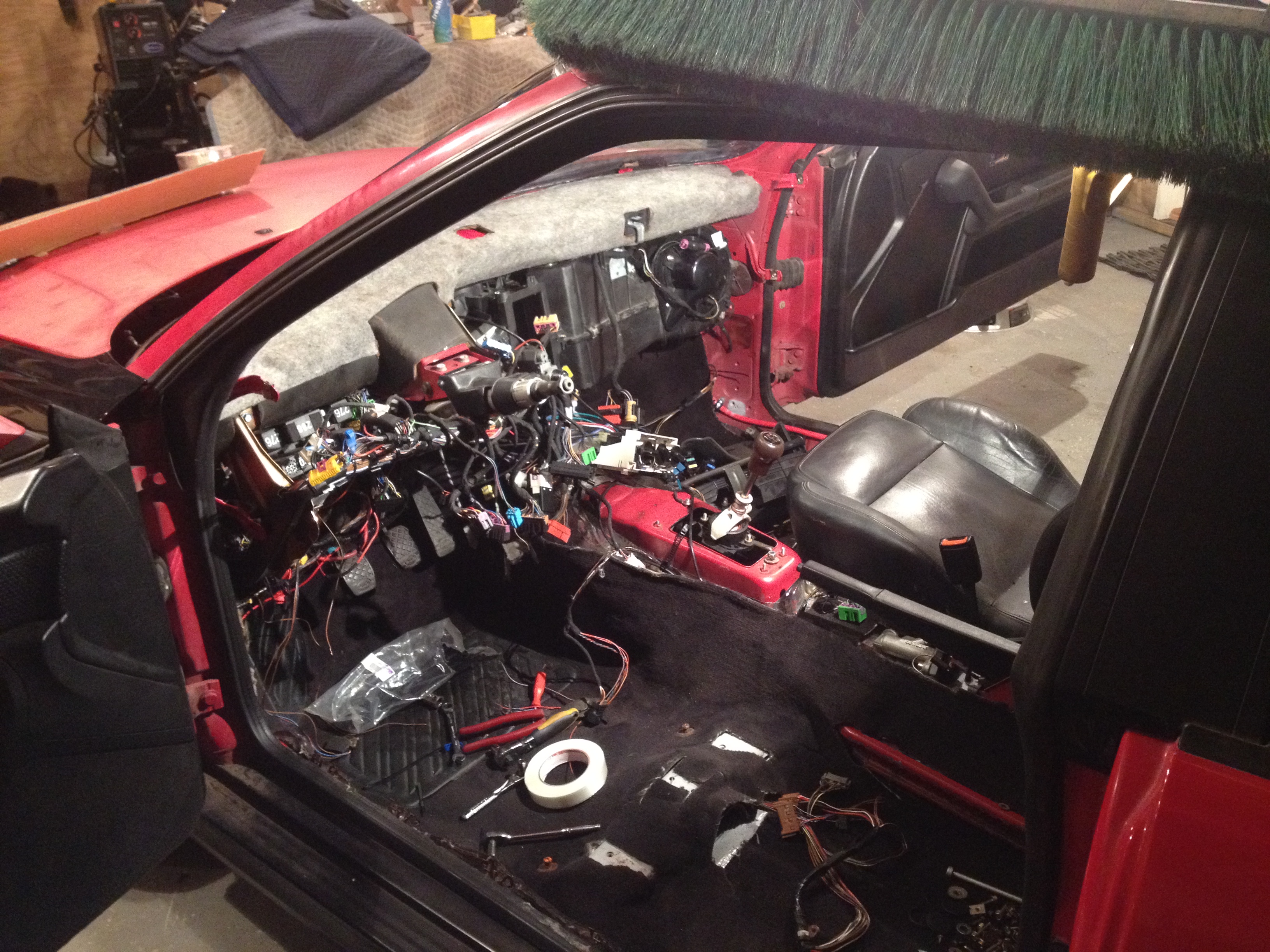

- Sebastian -

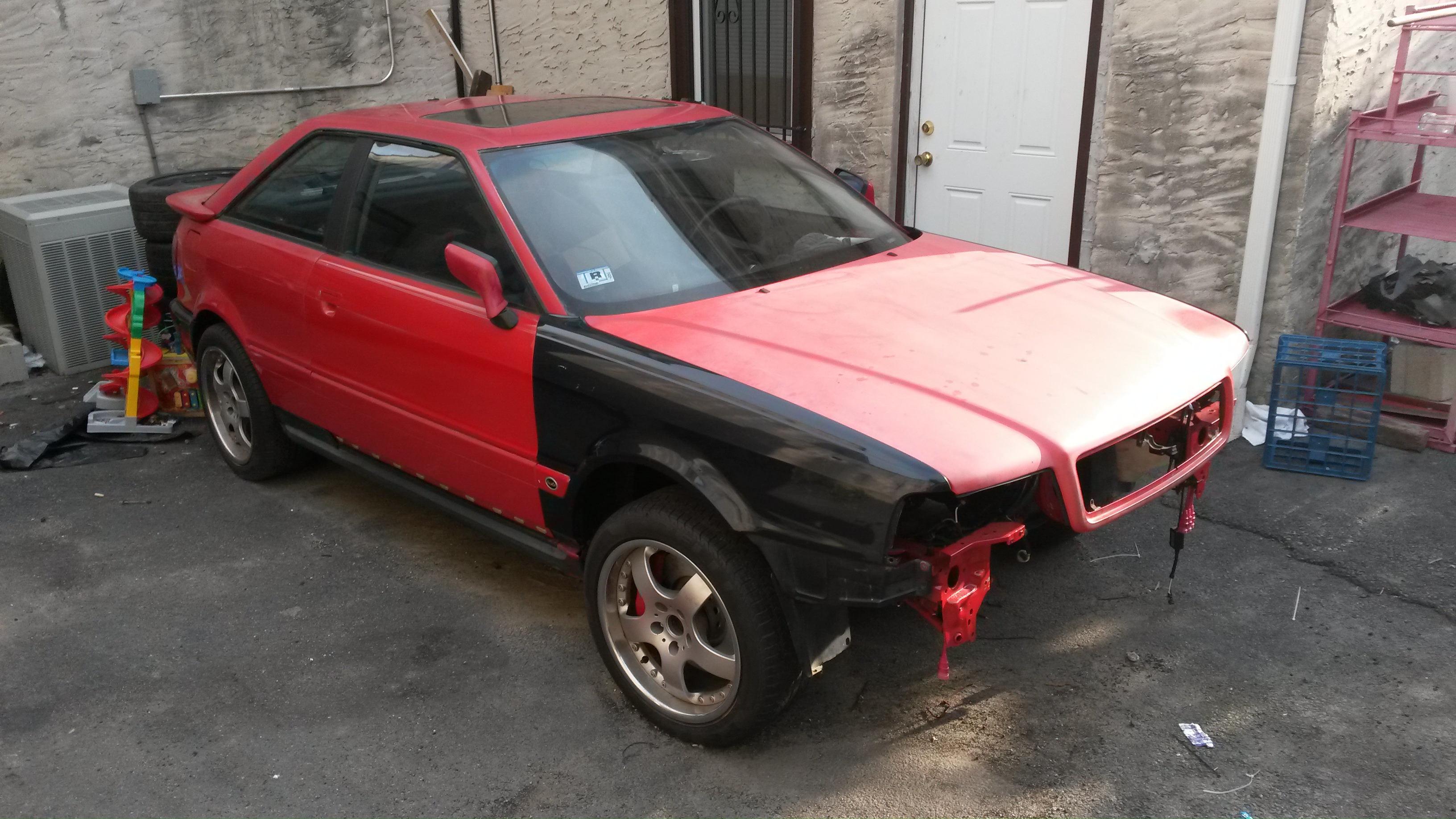

Re: Sebastian's 91 Coupe Quattro - 3b swap - Vems - e85

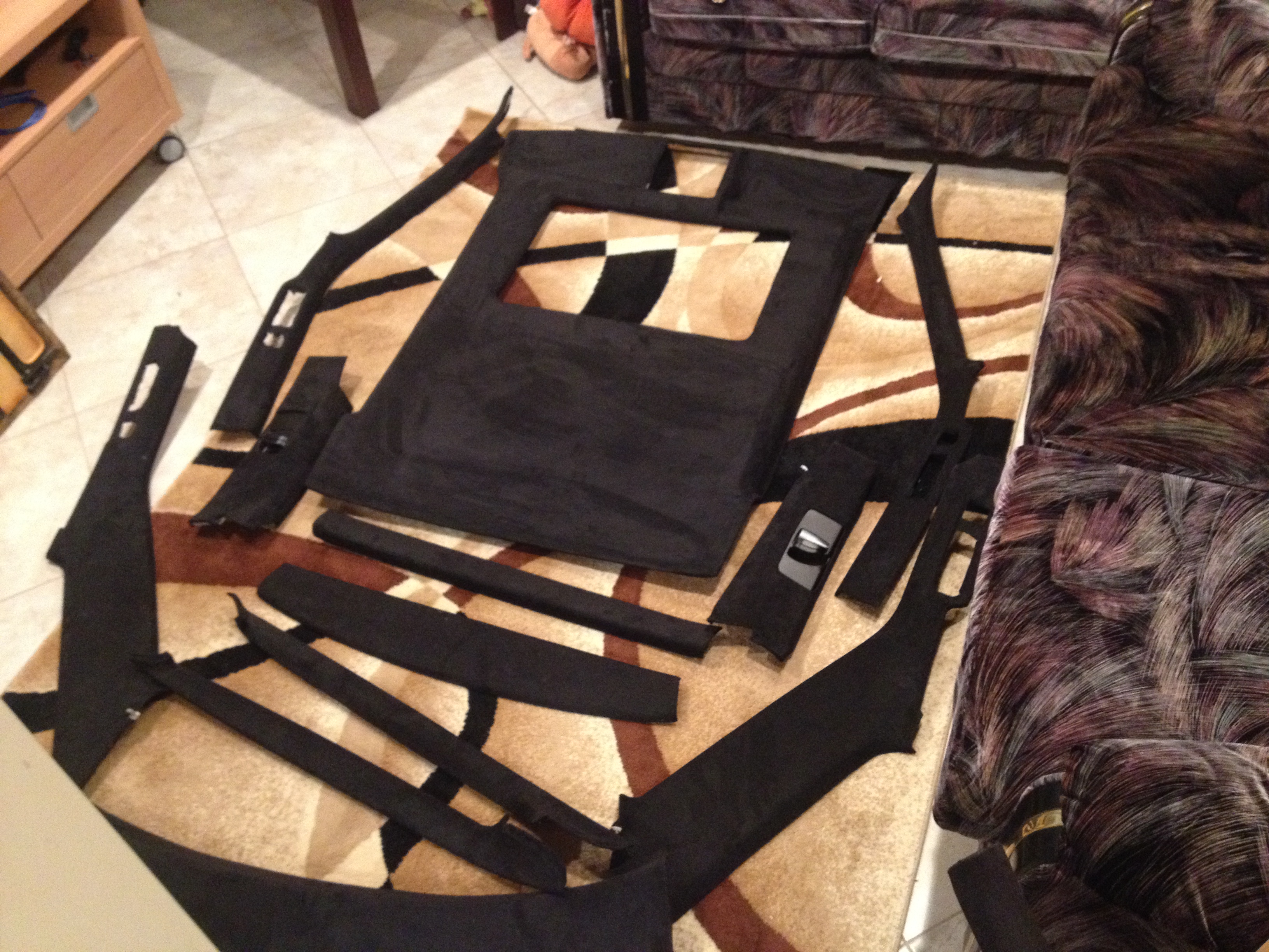

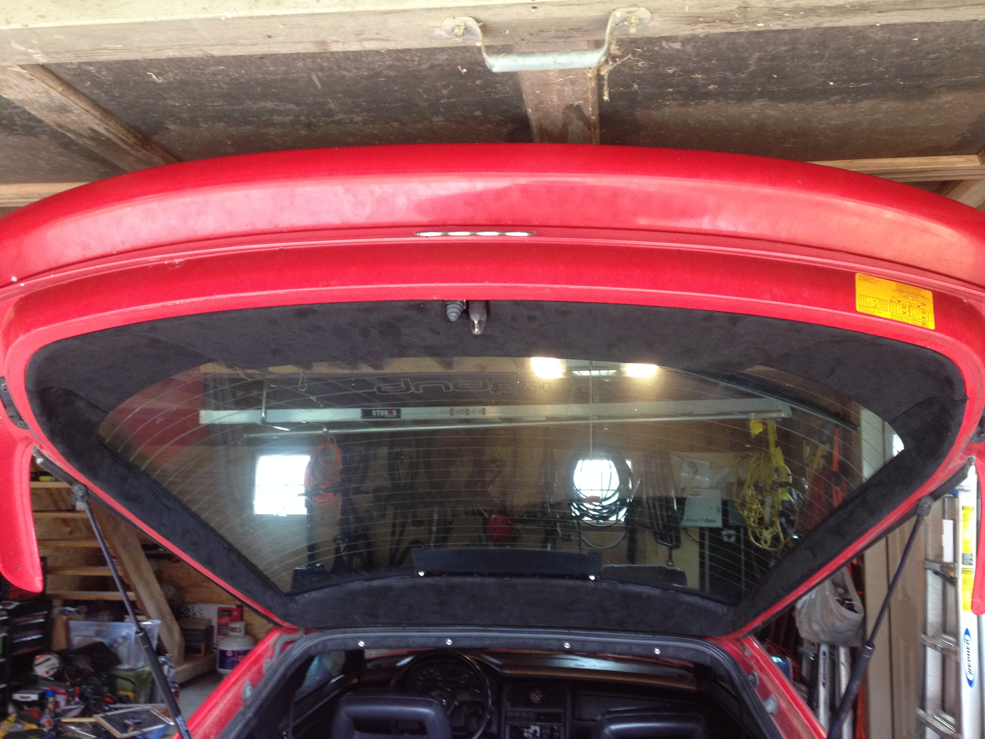

bit more of the b4 look
- Sebastian's CQ91' old garrage storage 1.JPG (3.36 MiB) Viewed 42088 times
- Sebastian's CQ91' body panels.jpg (2.04 MiB) Viewed 42088 times
- Sebastian -

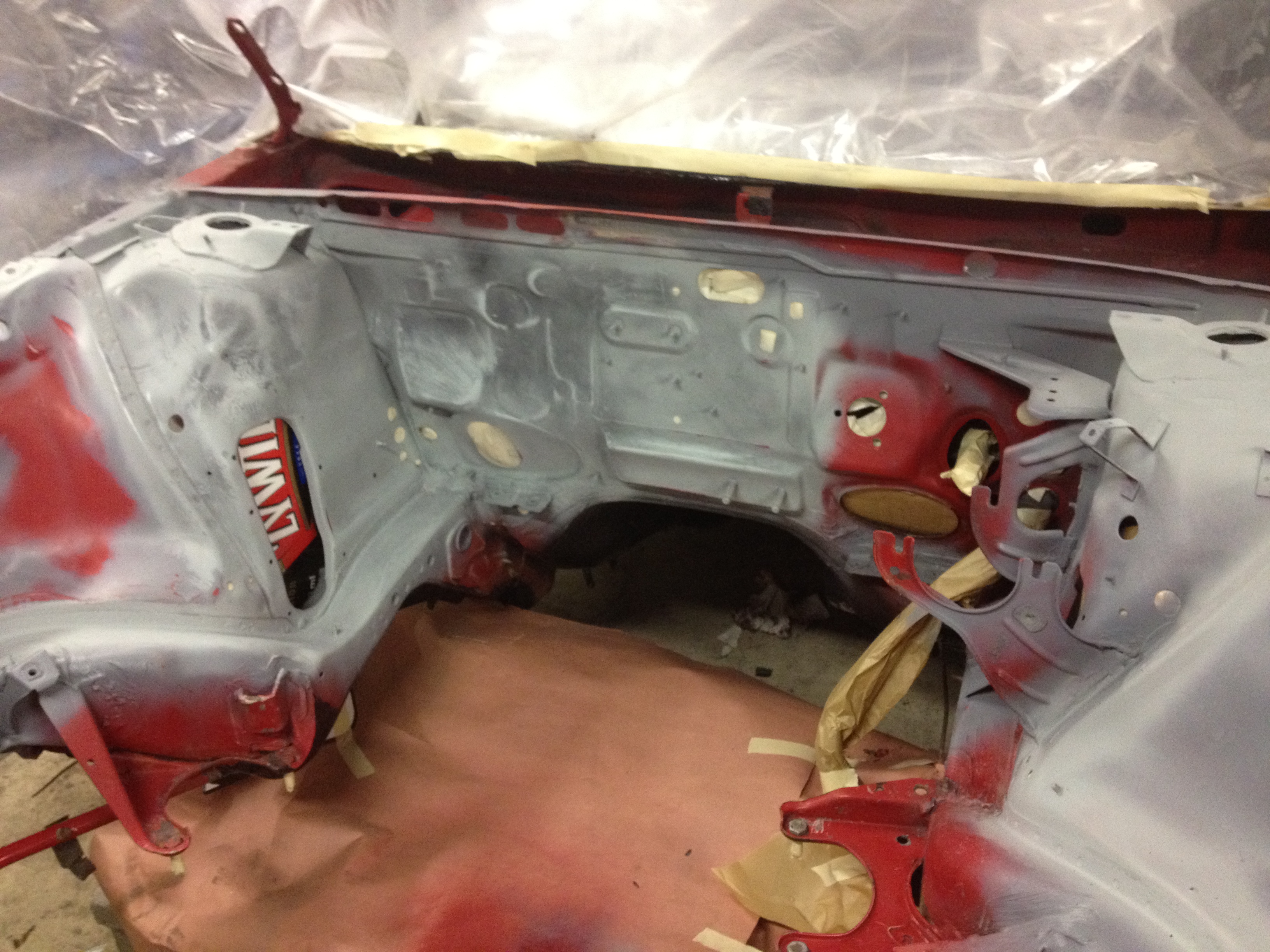

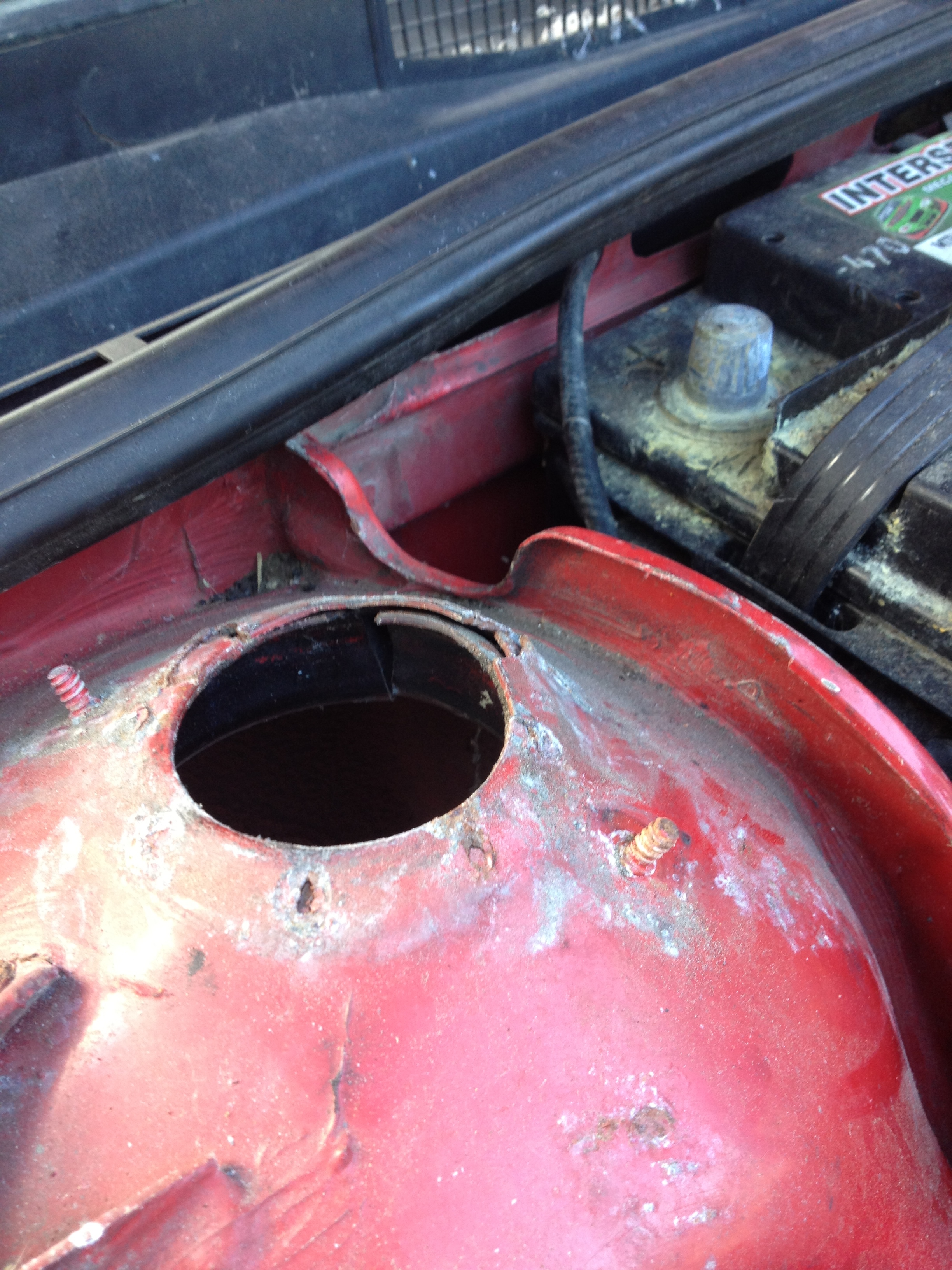

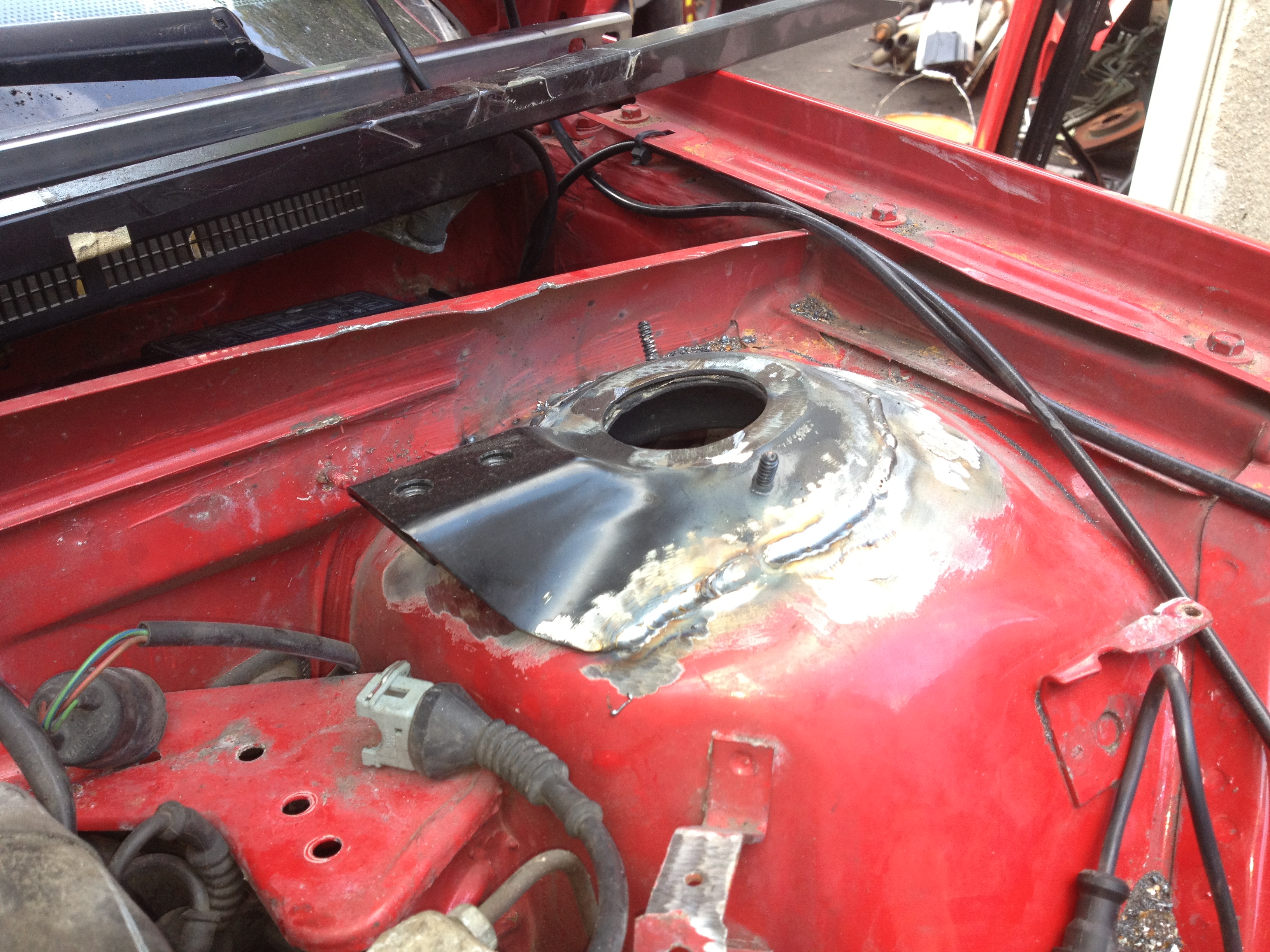

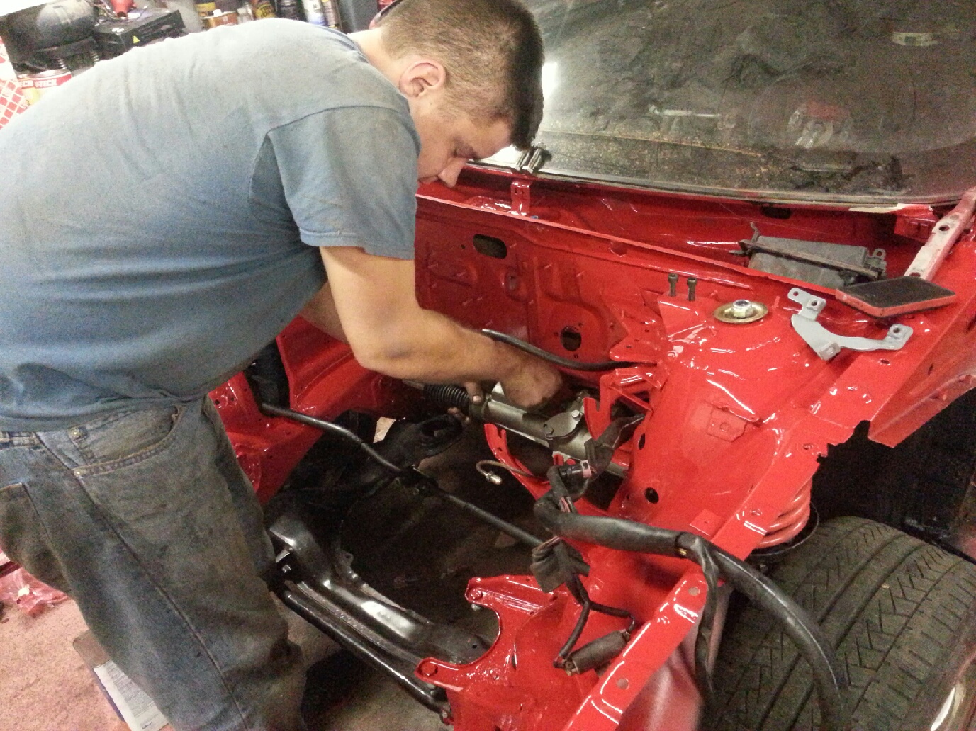

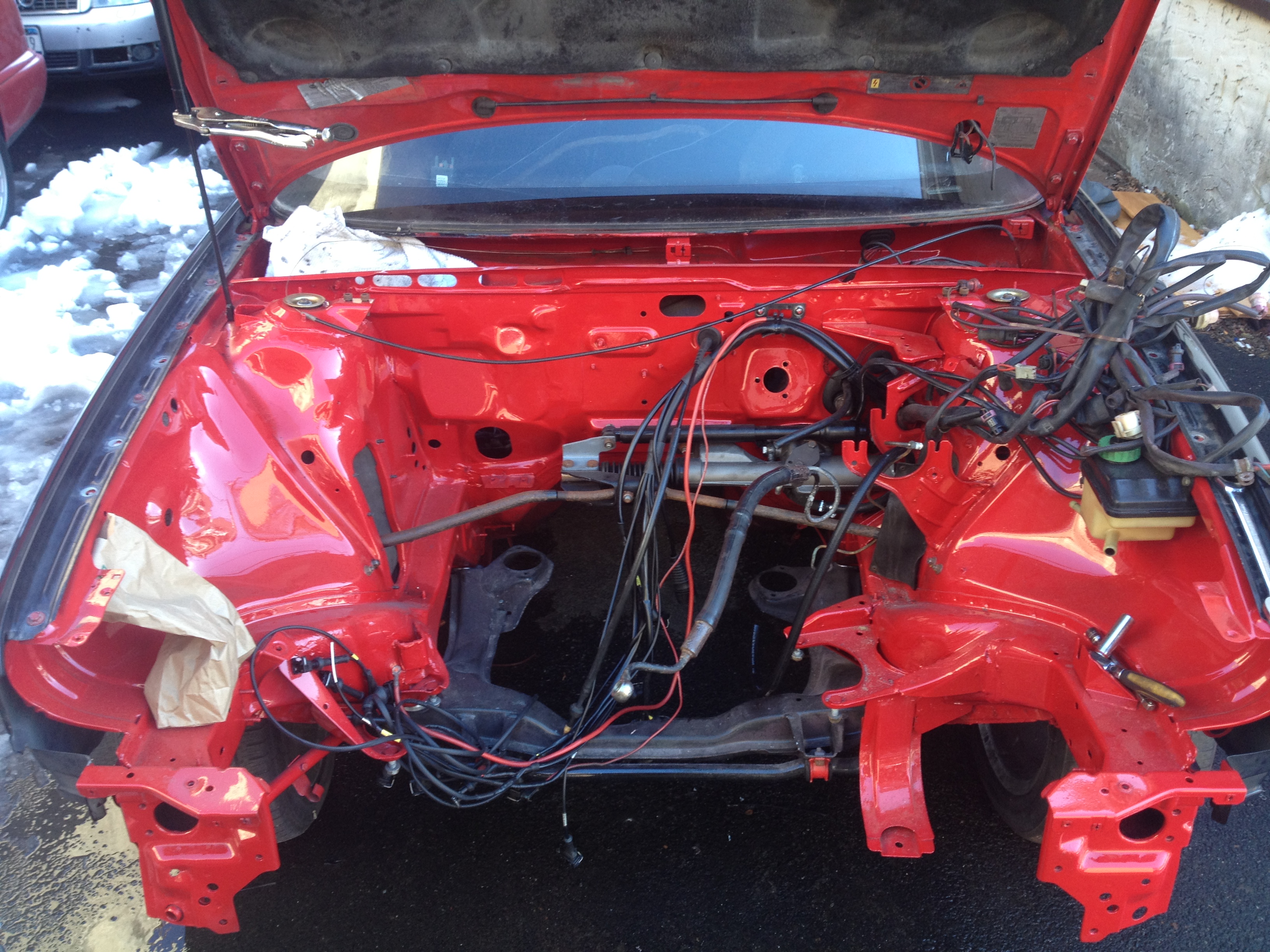

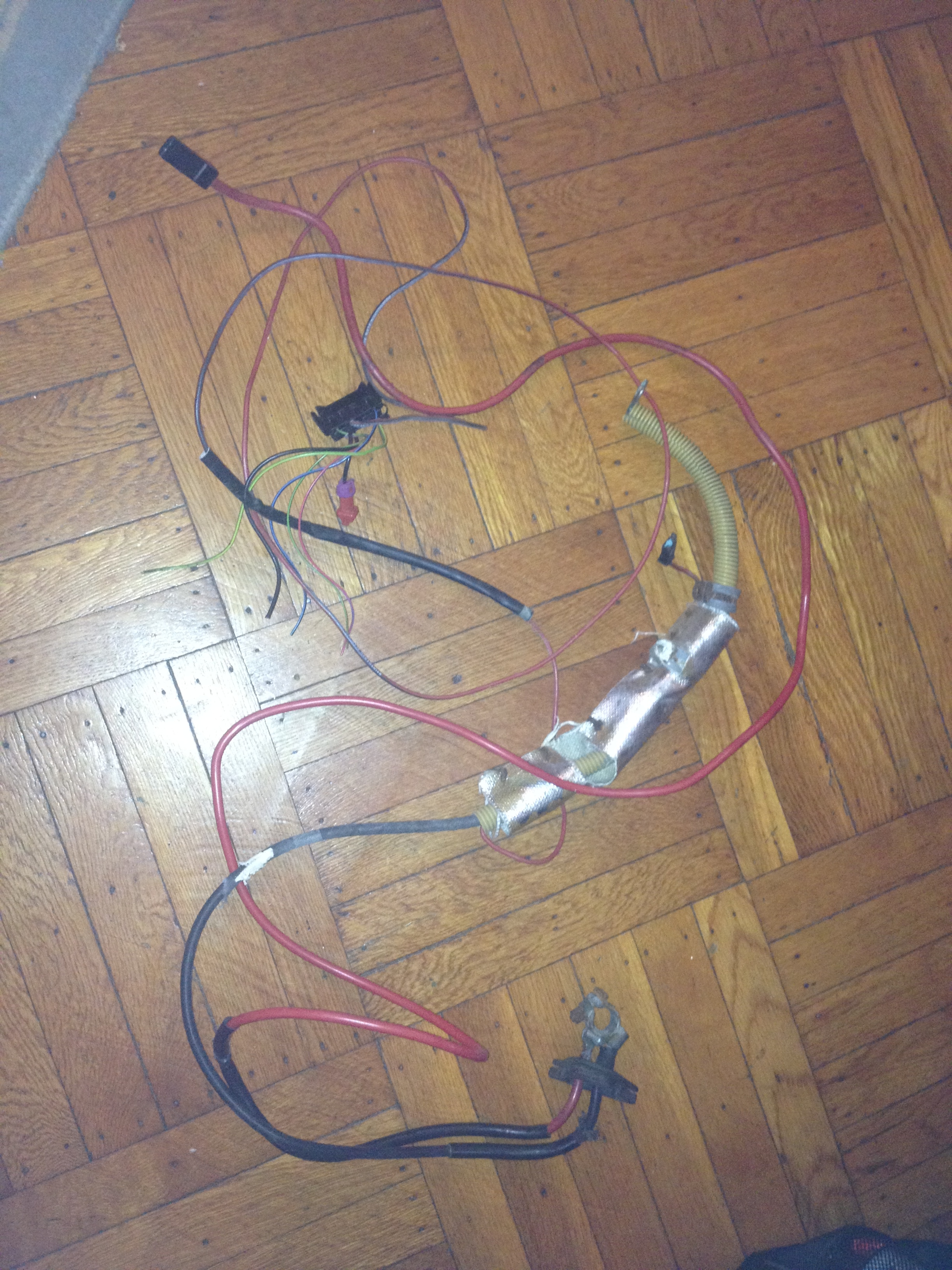

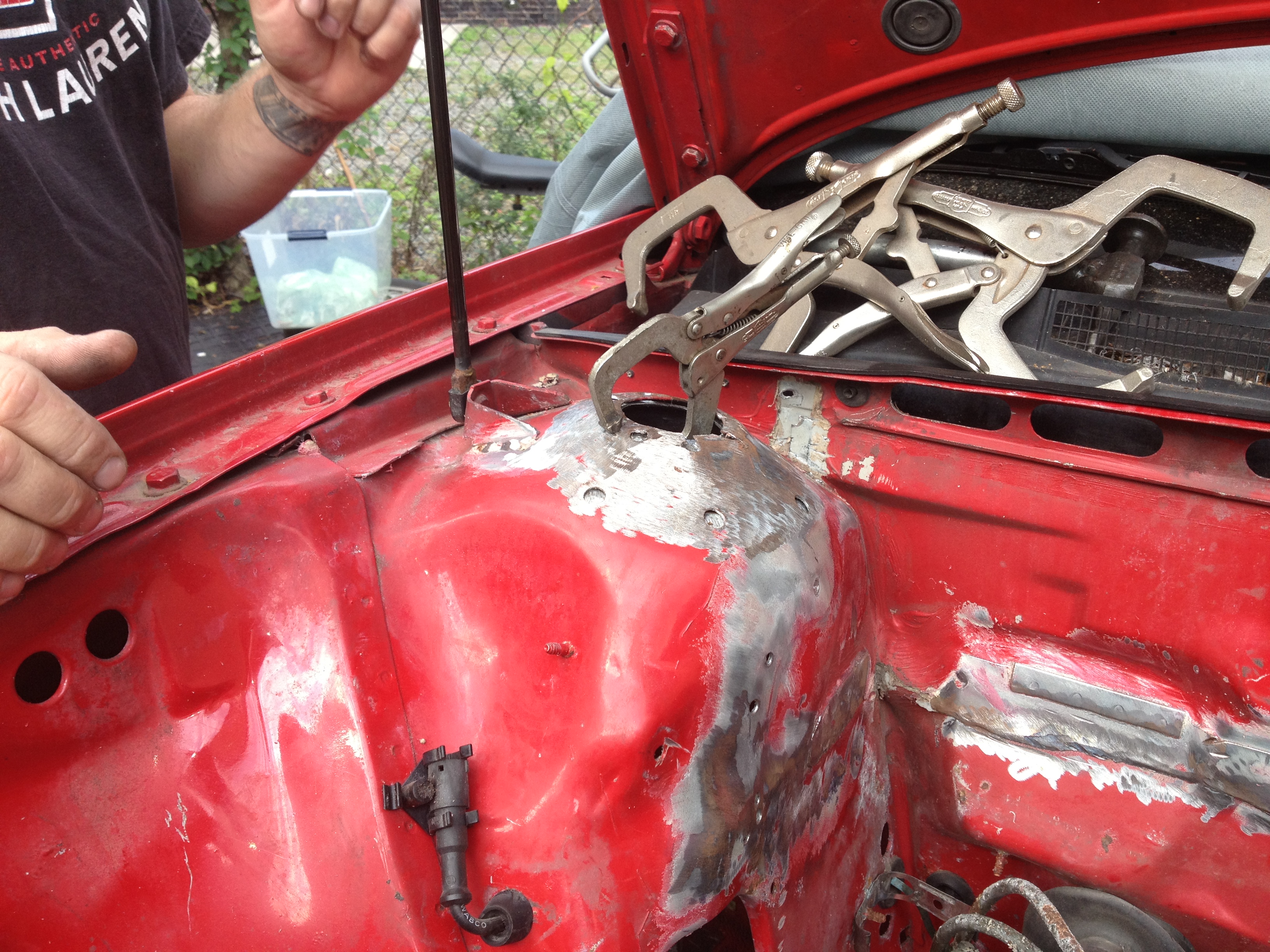

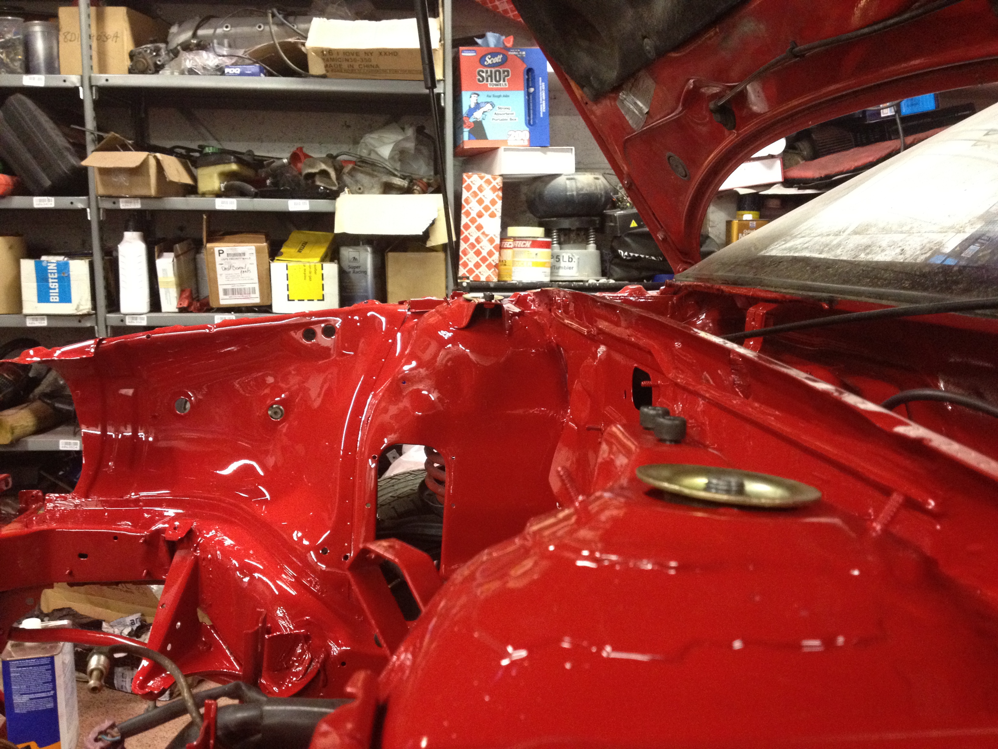

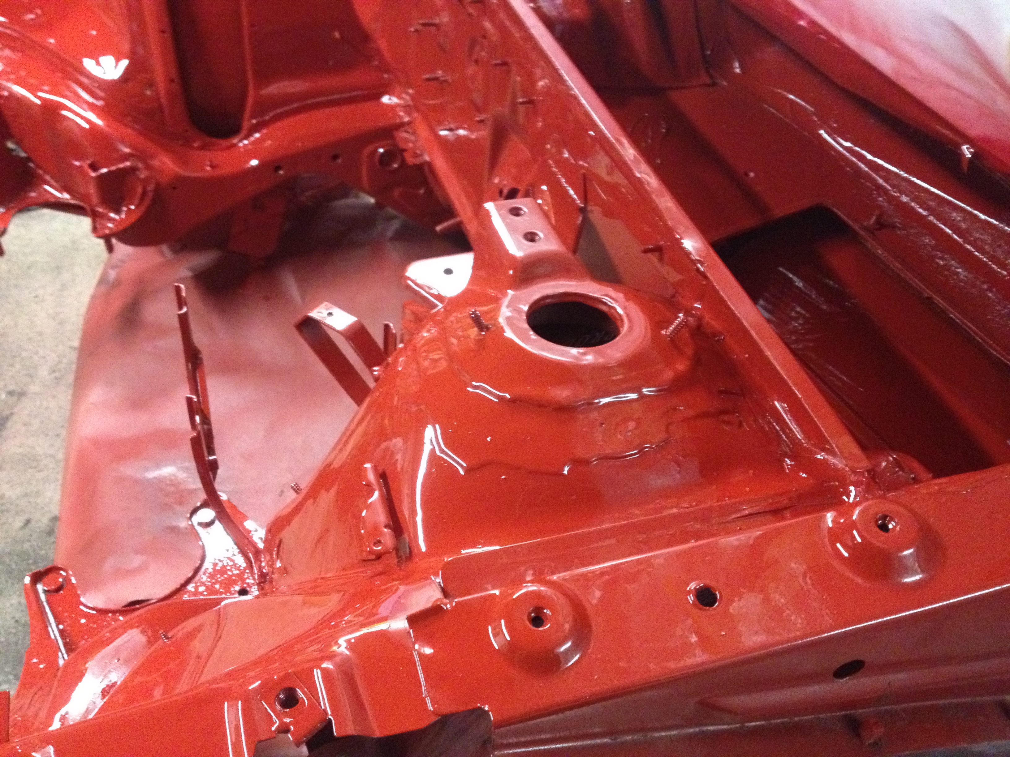

some engine bay prep work and strut tower fix and brace, battery relocation
- Sebastian's CQ91' shot towers.jpg (2.57 MiB) Viewed 42087 times
- Sebastian's CQ91' front tower fix 2.JPG (2.91 MiB) Viewed 42087 times
- Sebastian's CQ91' front tower fix and strut bar mount.JPG (2.86 MiB) Viewed 42087 times
- front tower strut brace mount.JPG (2.7 MiB) Viewed 42087 times
- Sebastian's CQ91' engine paint prep.JPG (2.44 MiB) Viewed 42087 times
- Sebastian -

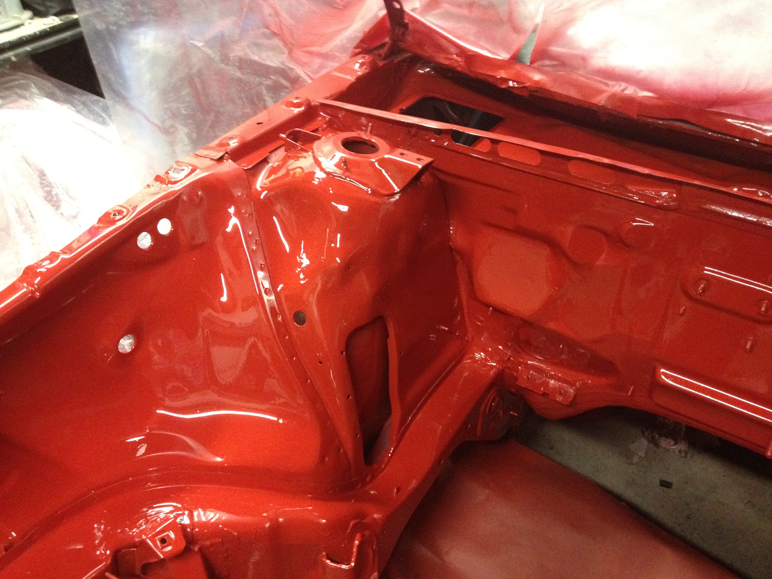

some color and steering

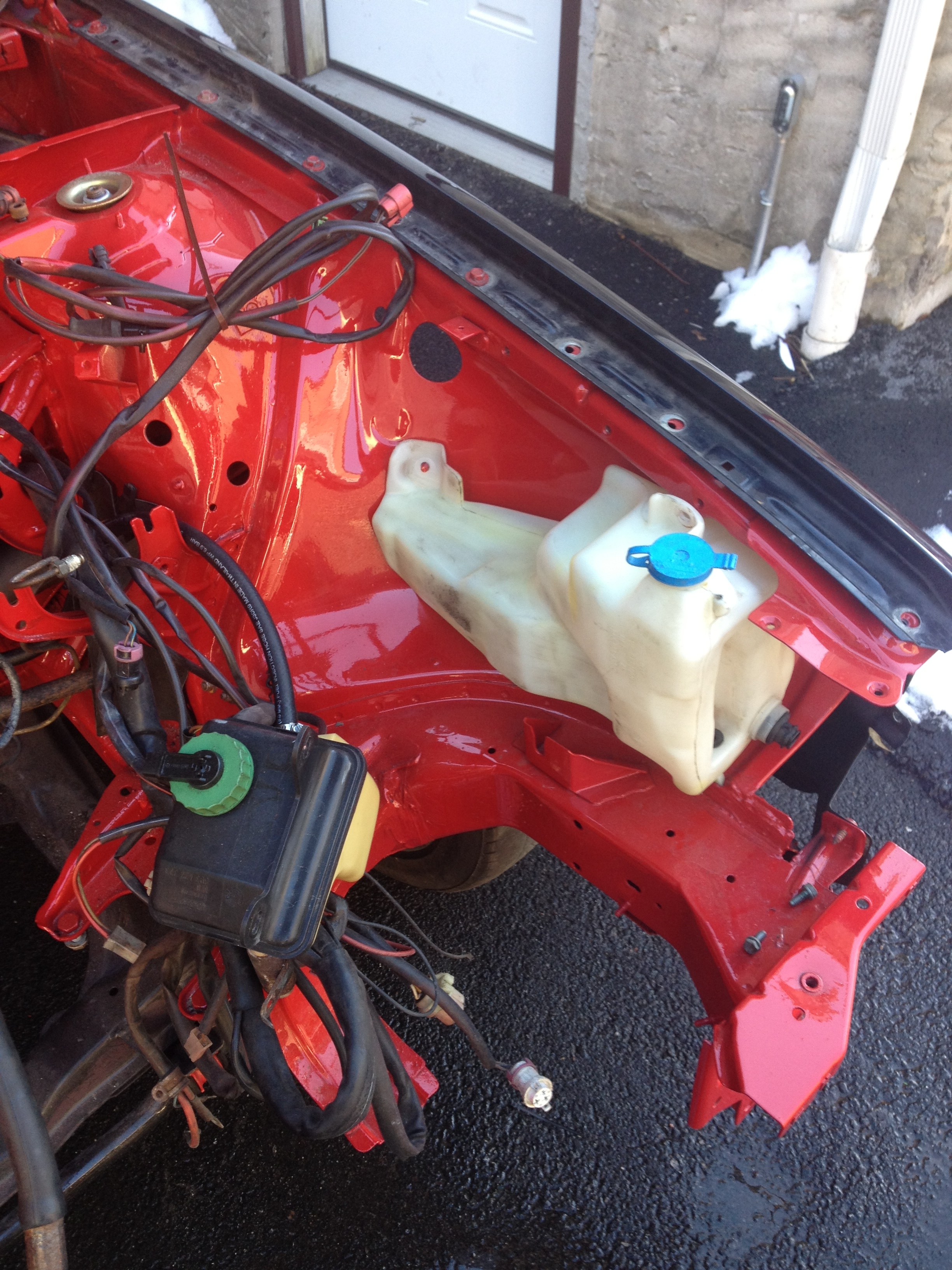

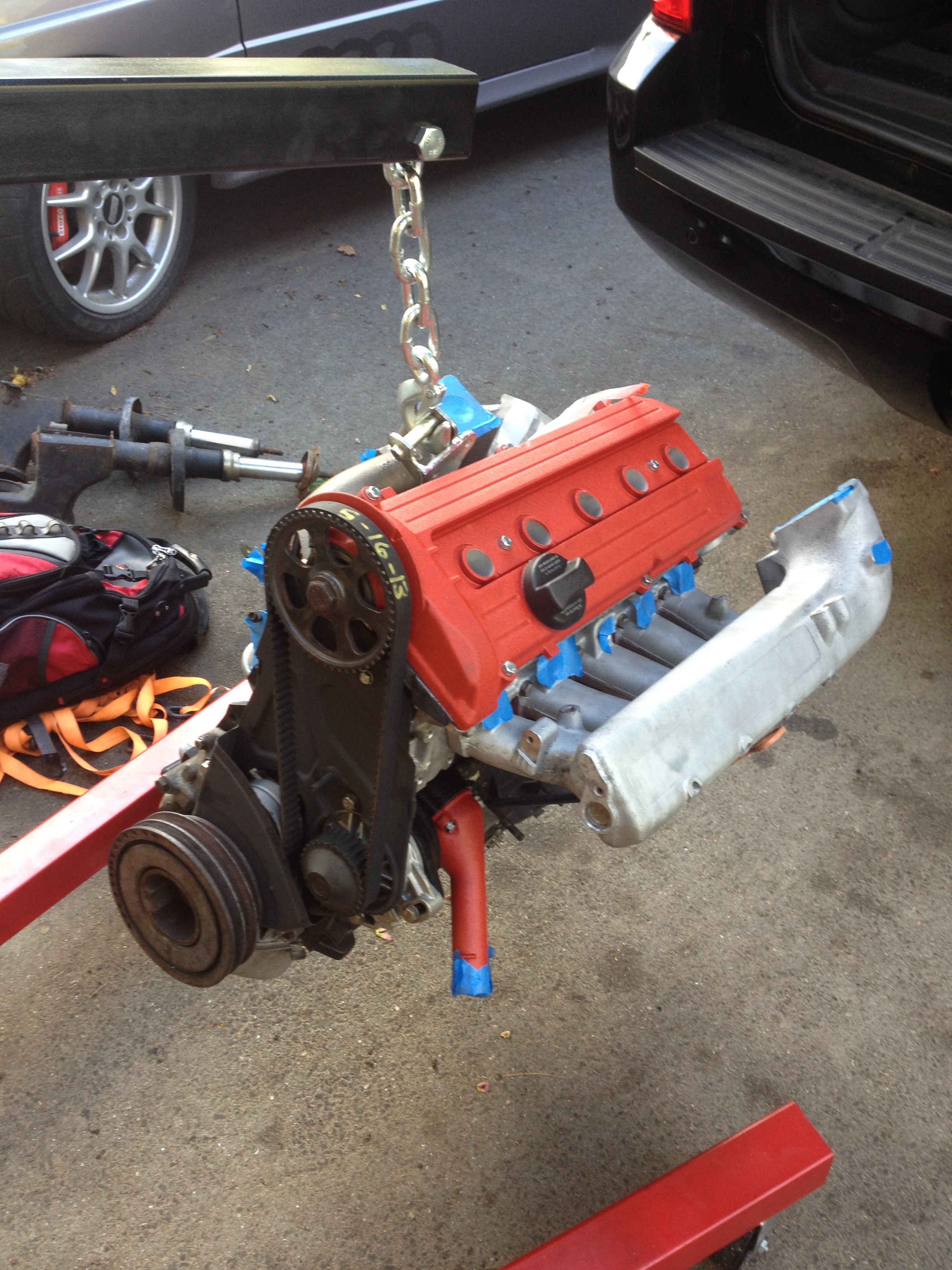

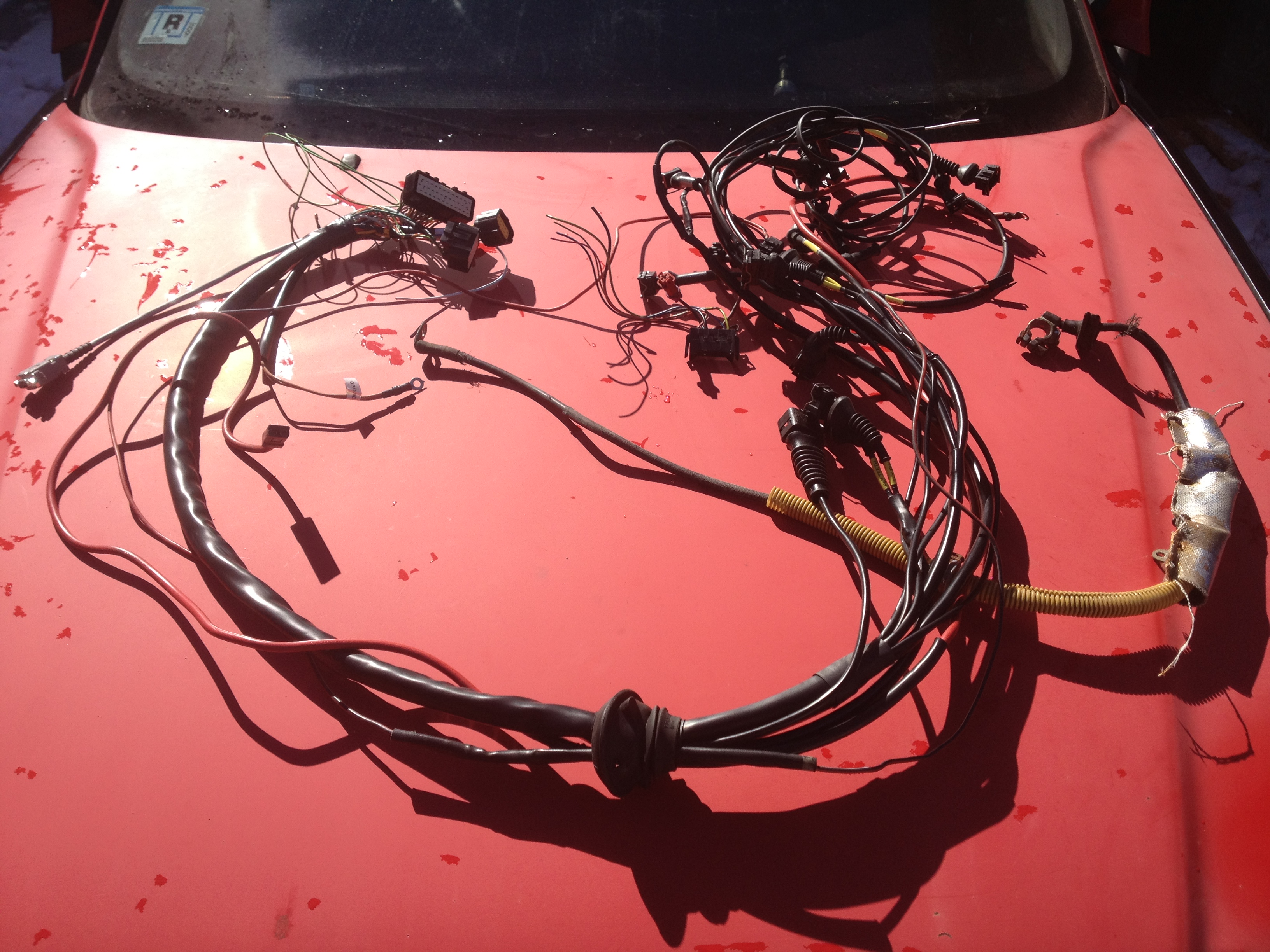

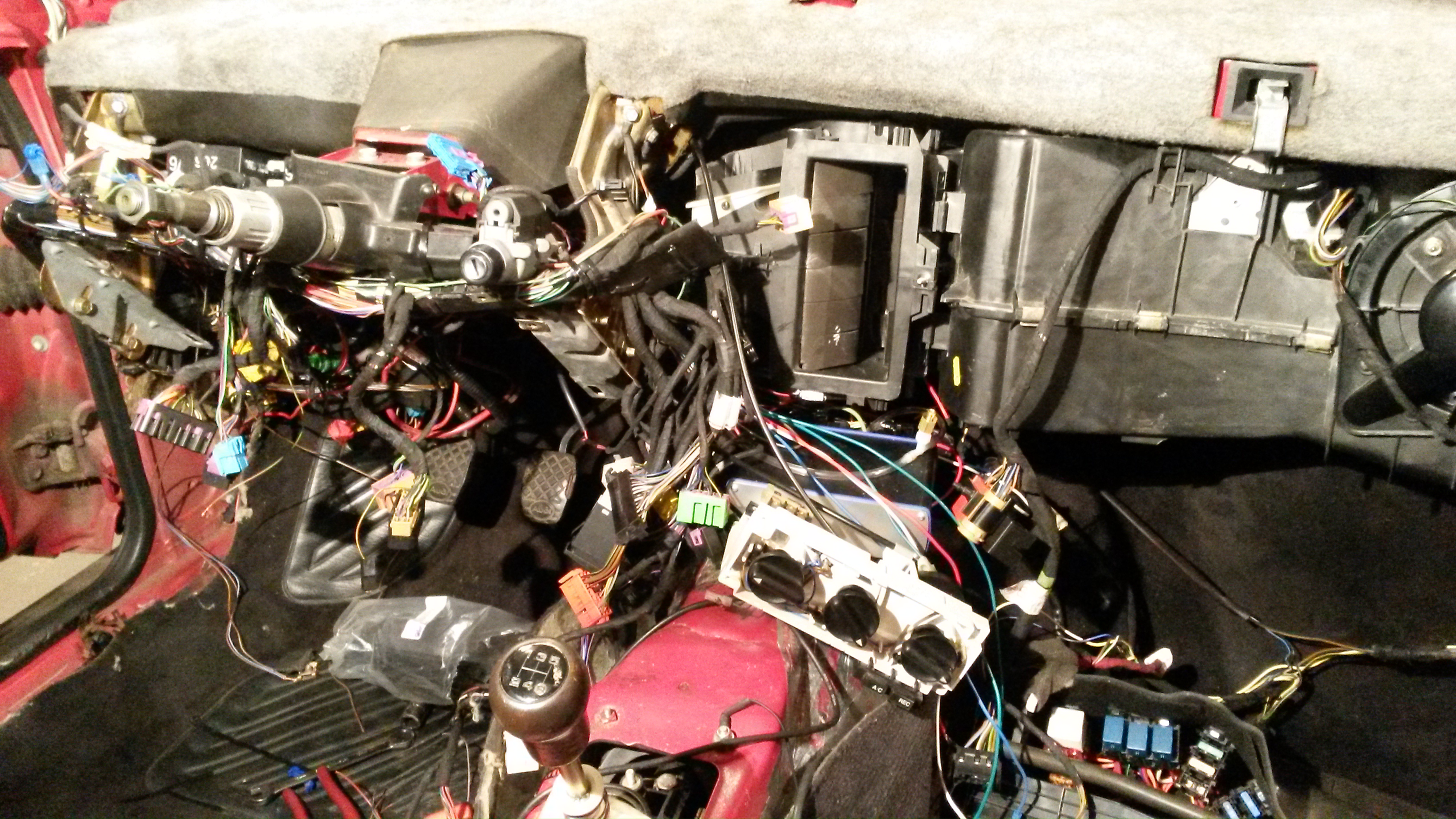

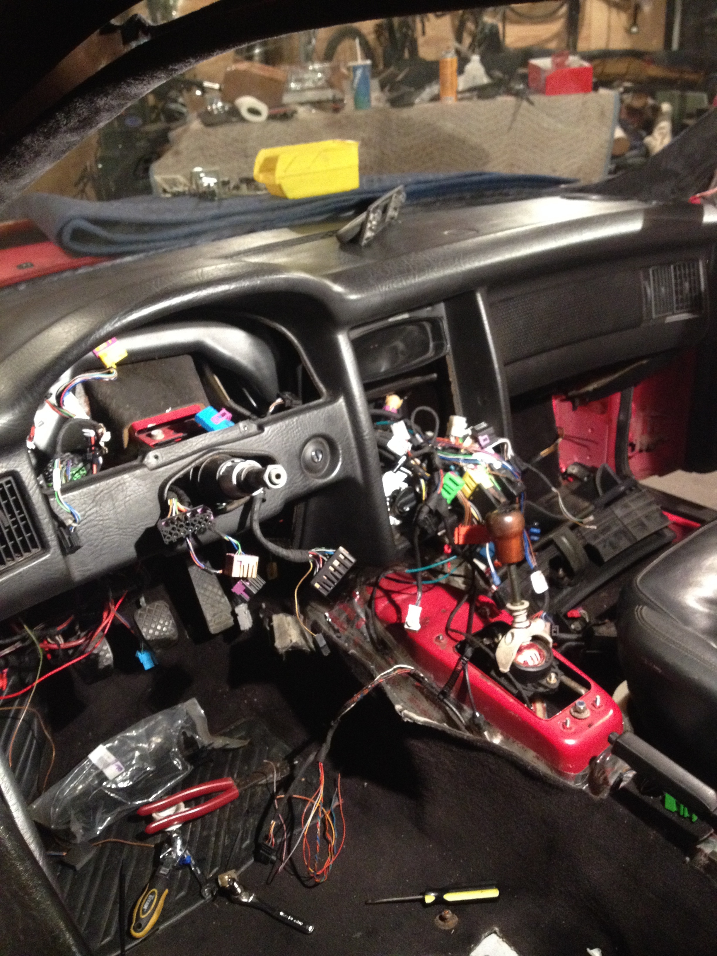

steering rack and fluid tanks installed with Vems harness and very slimmed down stock harness
- Sebastian's CQ91' stock harness slimmed down.jpg (3.04 MiB) Viewed 42086 times
- Sebastian's CQ91' vems harness EFI Express.JPG (2.25 MiB) Viewed 42086 times
- Sebastian's CQ91' engine bay random shoot 2.JPG (2.58 MiB) Viewed 42086 times
- Sebastian's CQ91' engine bay random shoot 1.jpg (2.85 MiB) Viewed 42086 times

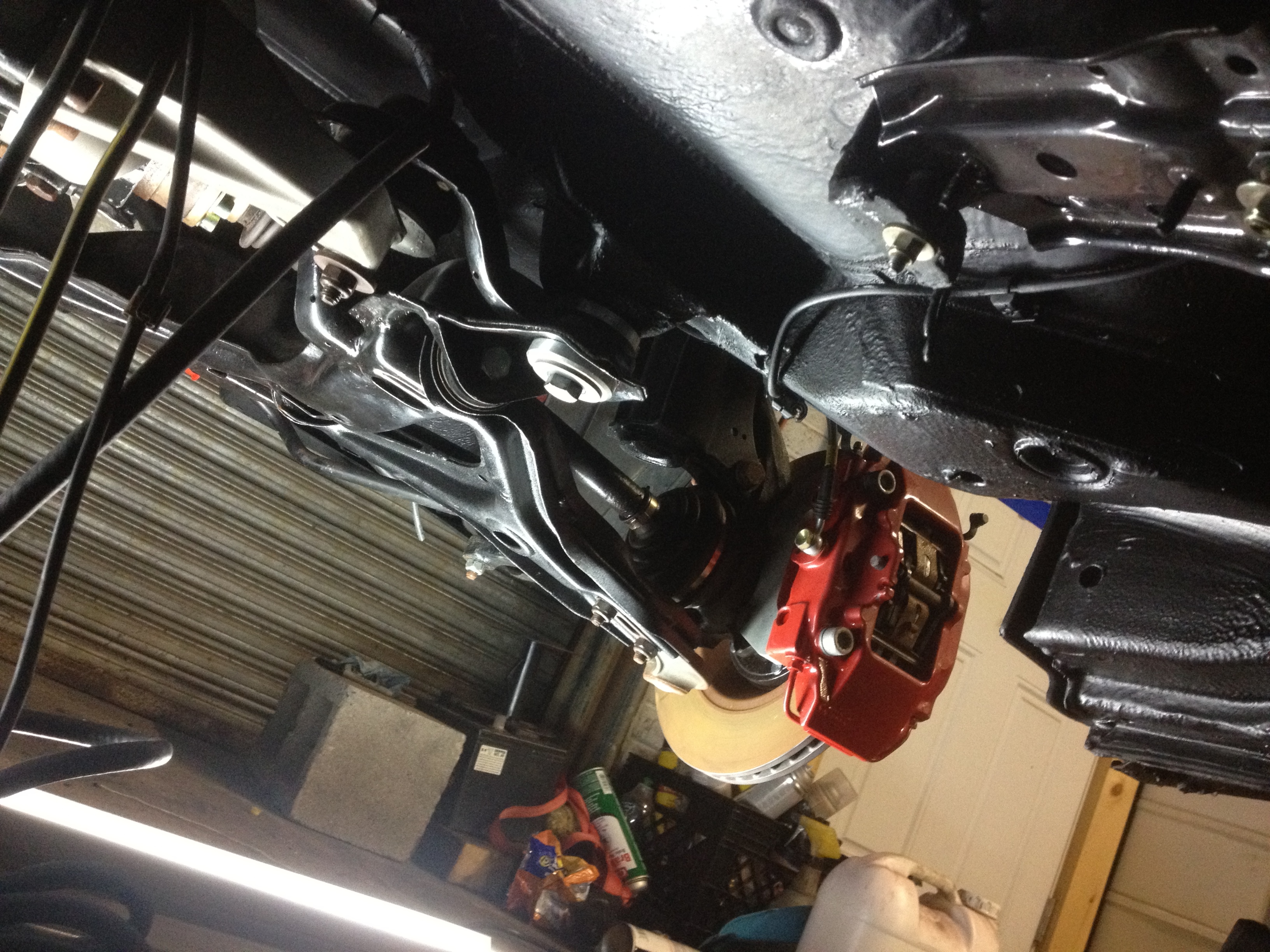

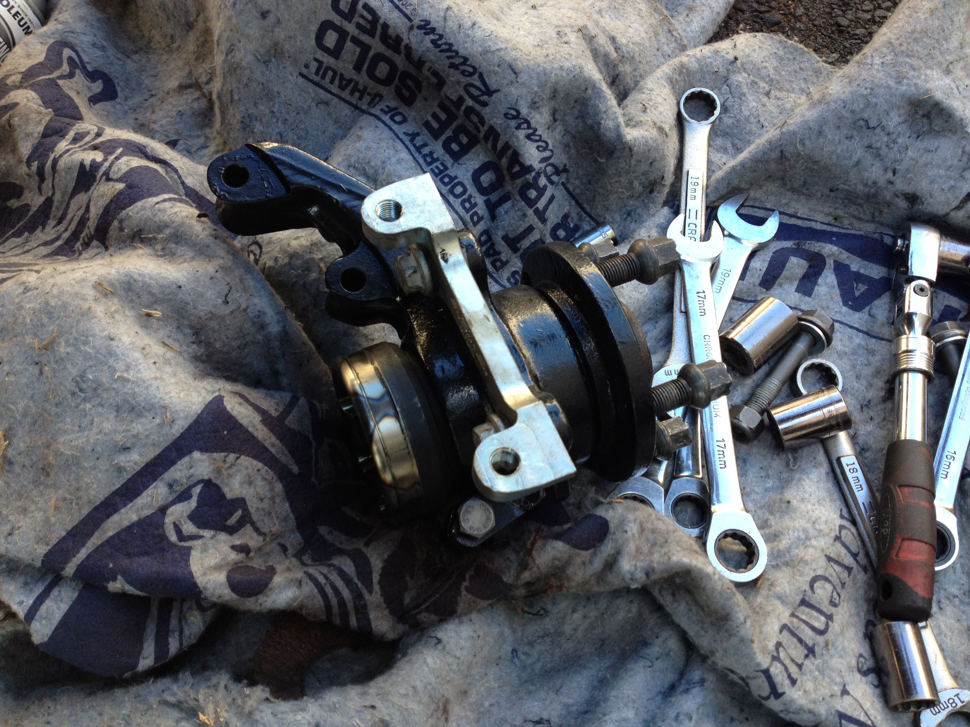

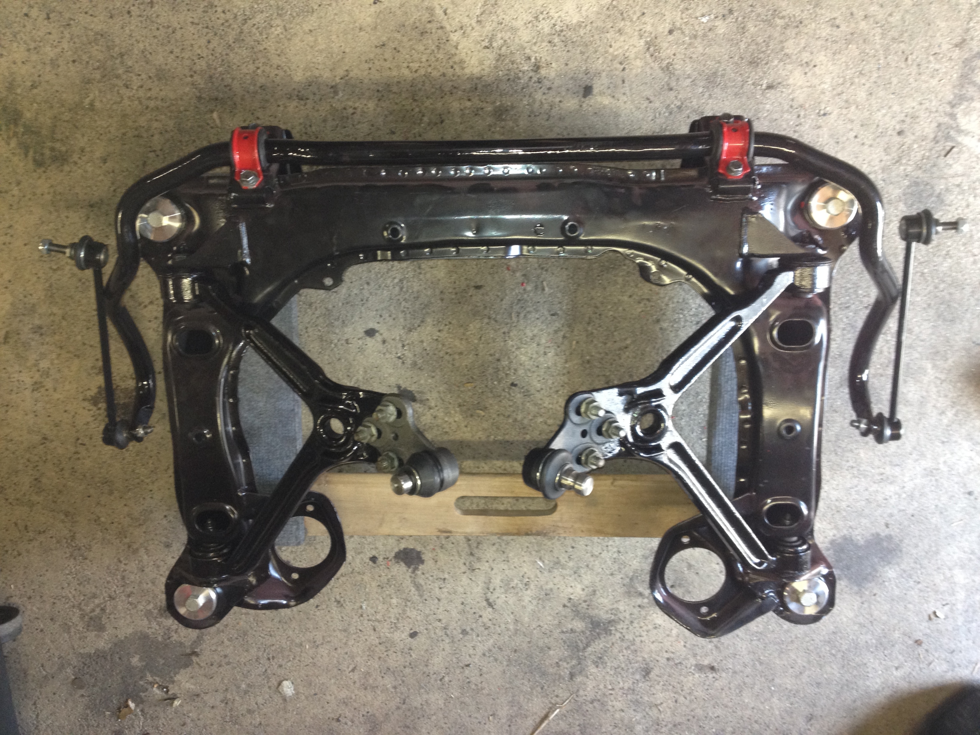

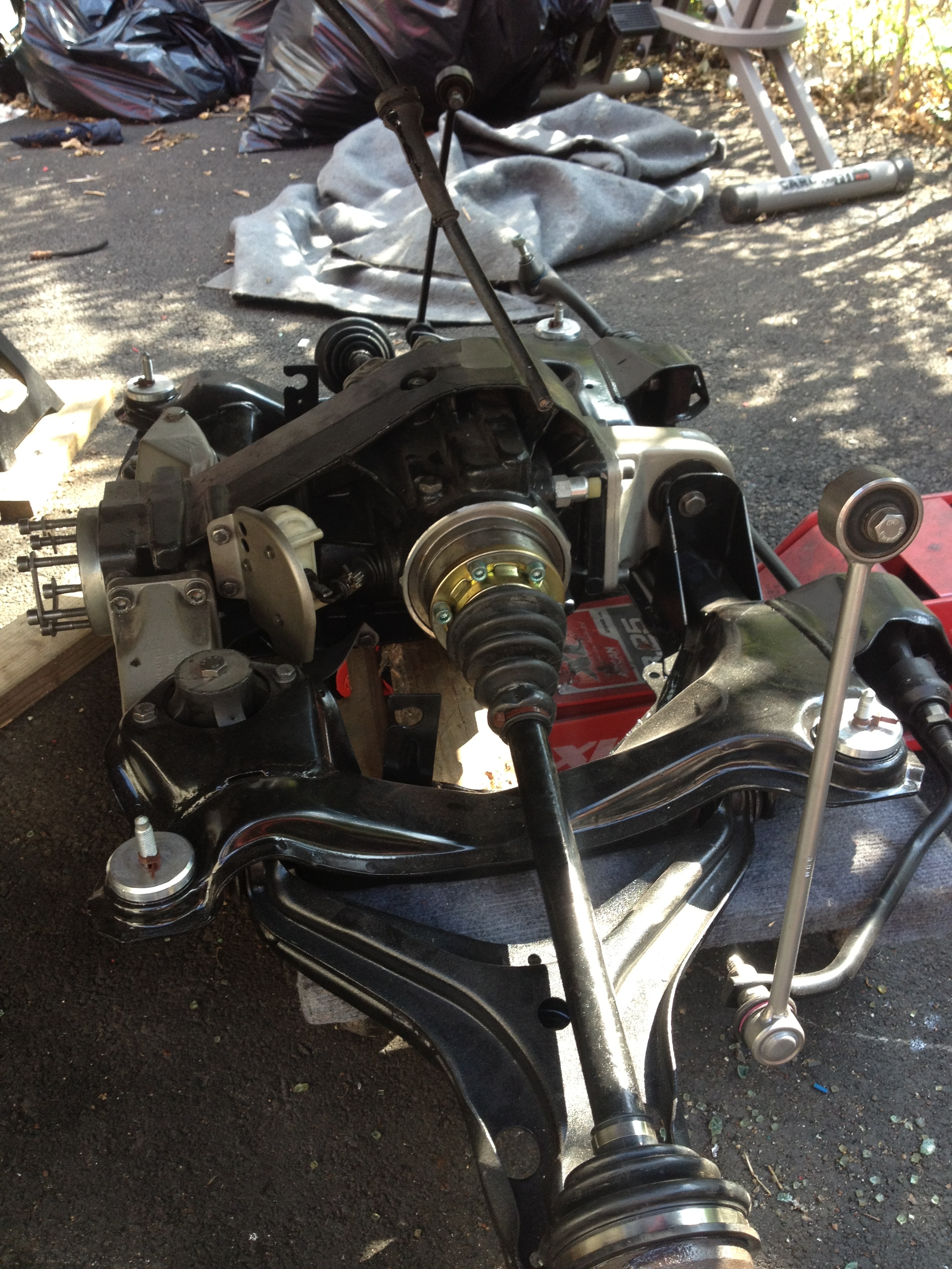

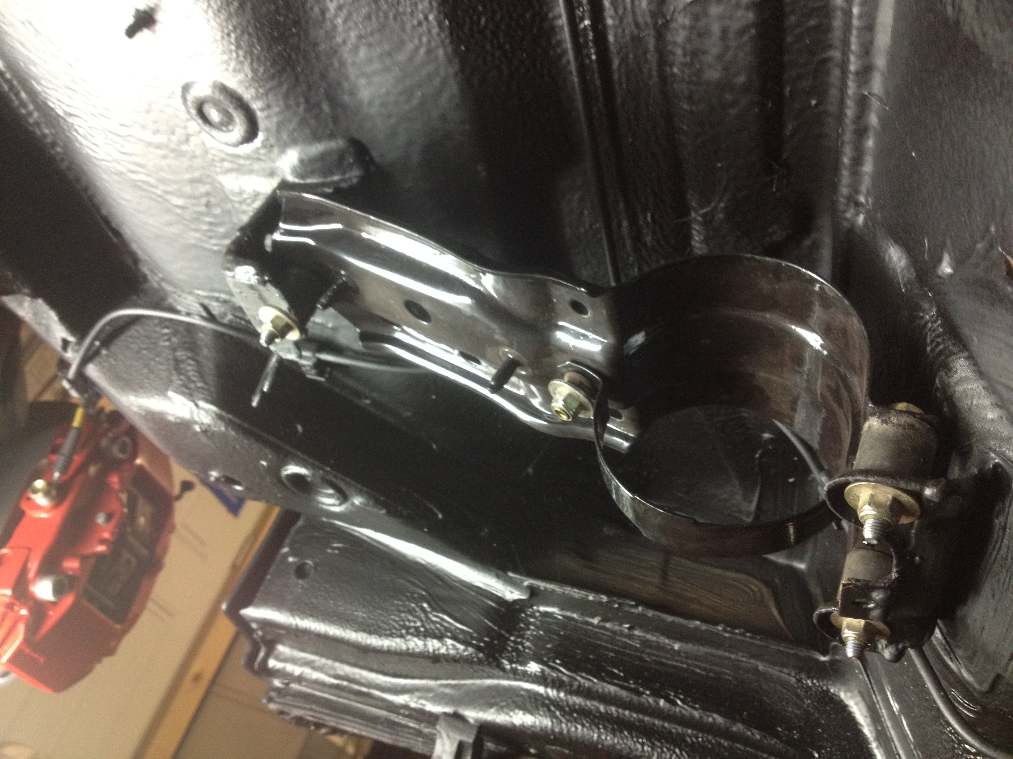

here is a bit of the under chassis and suspension work.
- Sebastian's CQ91' front suspension assembly .jpg (2.84 MiB) Viewed 42050 times
- IMG_2210.JPG (2.05 MiB) Viewed 42050 times
- Sebastian's CQ91' front suspension .JPG (2.12 MiB) Viewed 42050 times
- Sebastian's CQ91' rear suspension assembly 1.jpg (3.06 MiB) Viewed 42050 times
- Sebastian's CQ91' rear suspenssion shot.JPG (2.81 MiB) Viewed 42050 times

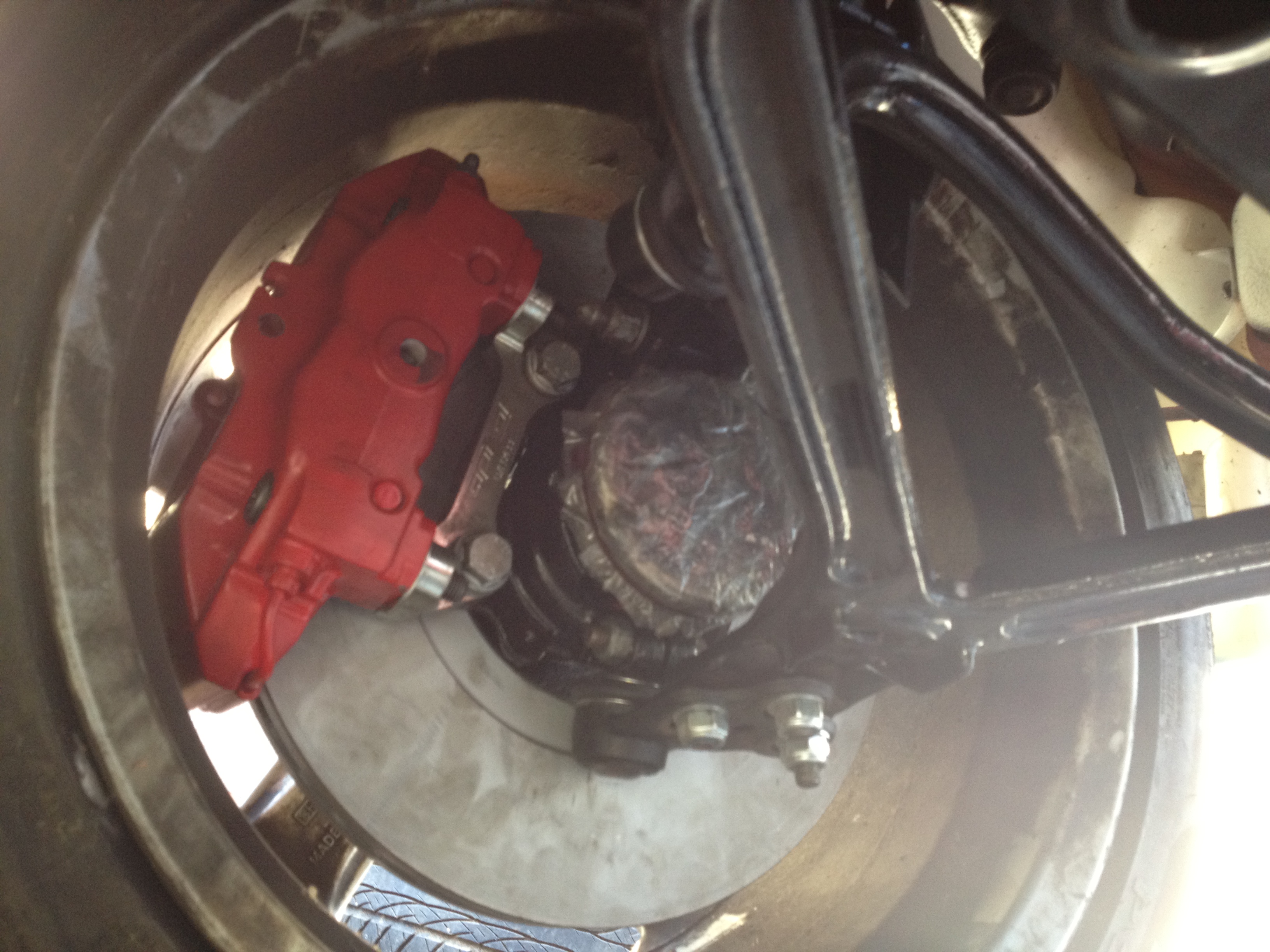

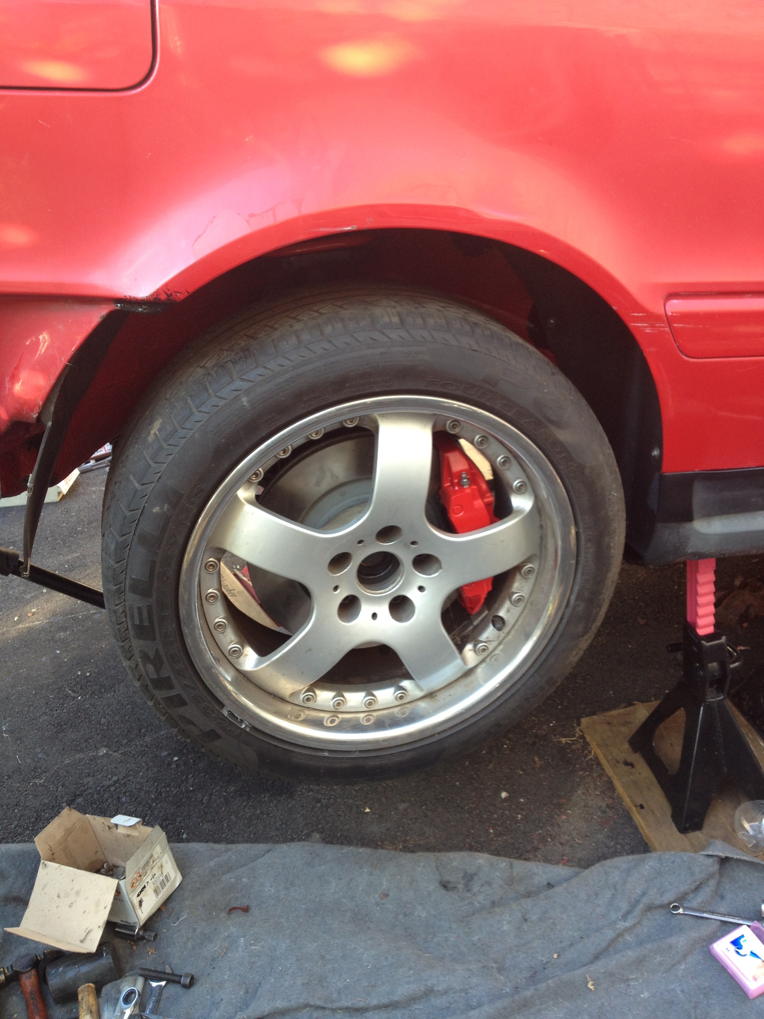

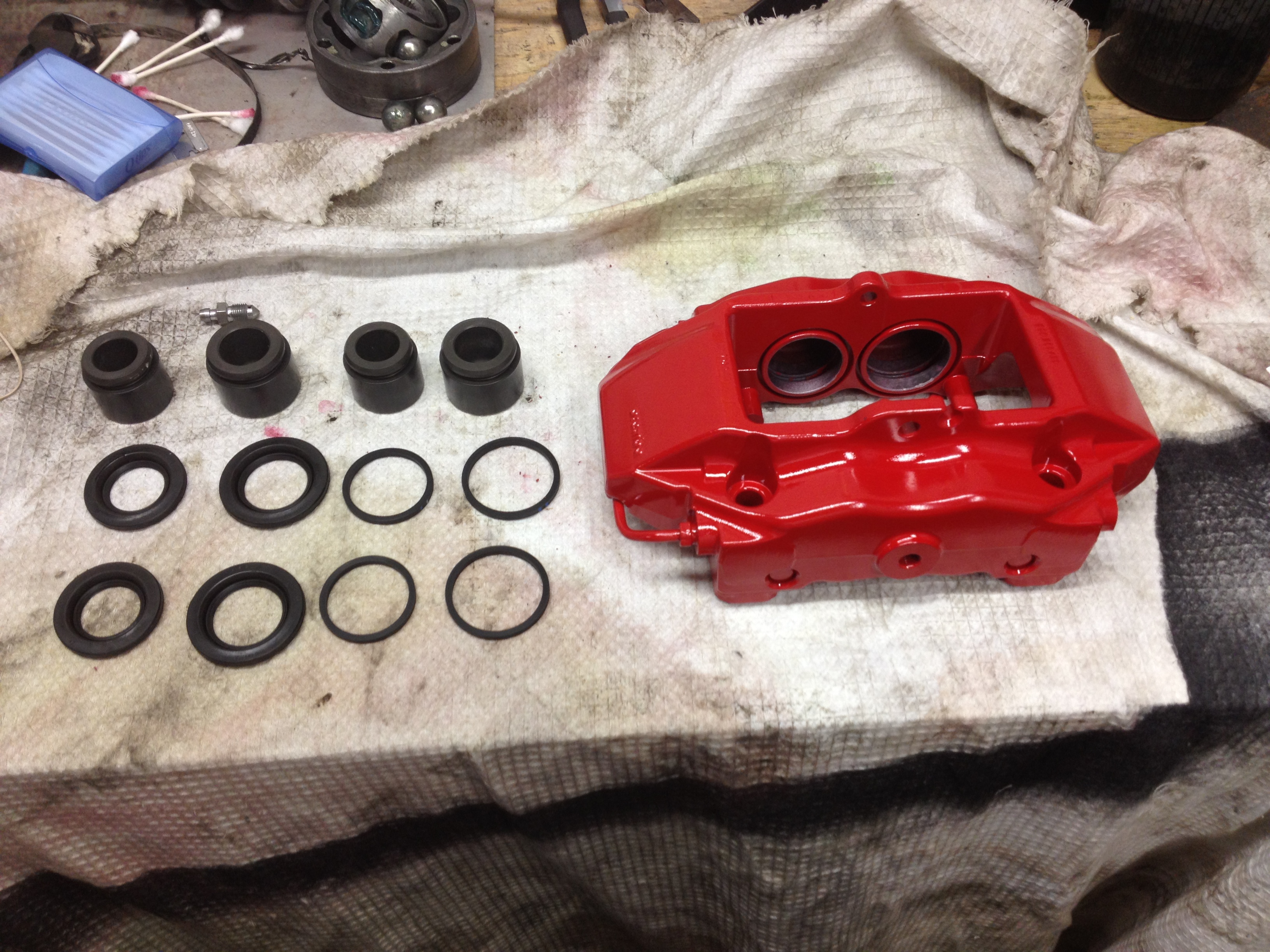

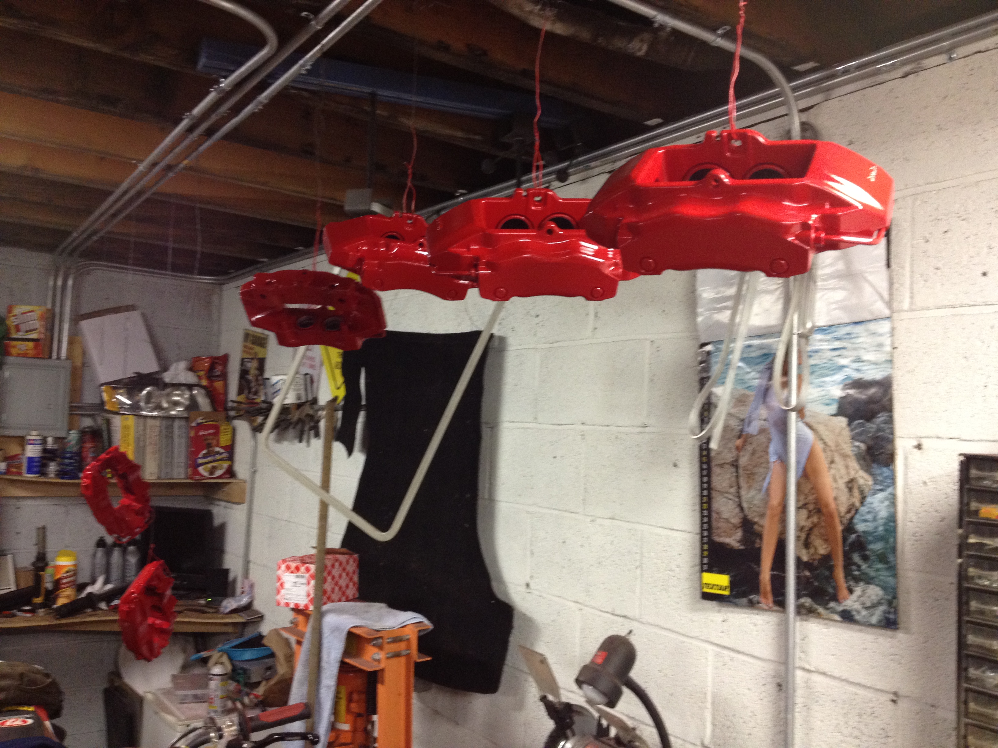

rear brakes
- Sebastian's CQ91' caliper paint.JPG (2.35 MiB) Viewed 42039 times
- Sebastian's CQ91' rebuild calipers.JPG (2.44 MiB) Viewed 42039 times
- Sebastian's CQ91' rear brakes done 1.jpg (2 MiB) Viewed 42039 times
- Sebastian's CQ91' rear brakes done.jpg (2.36 MiB) Viewed 42039 times
- Sebastian's CQ91' rear brakes done 2.jpg (2.45 MiB) Viewed 42039 times

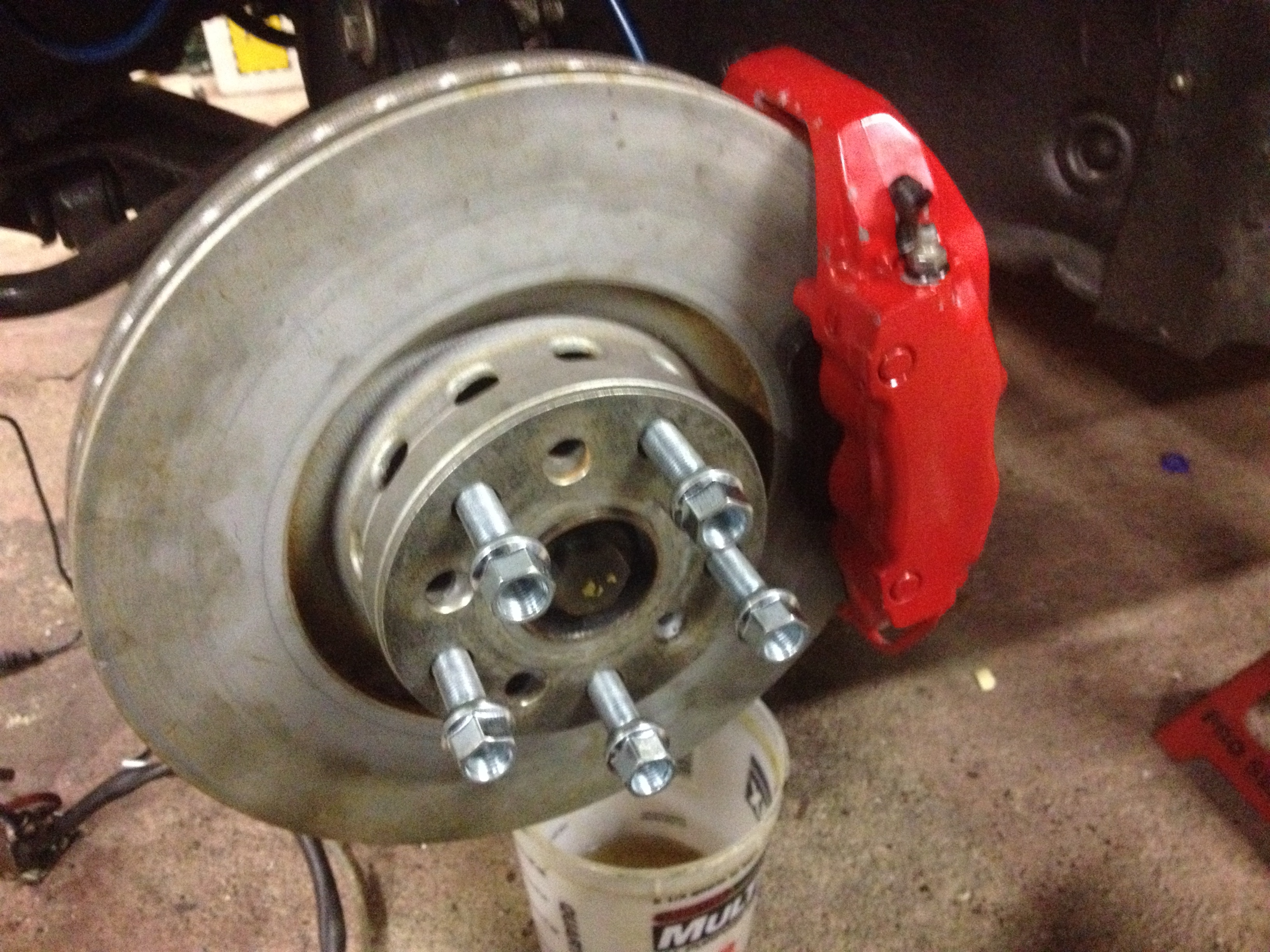

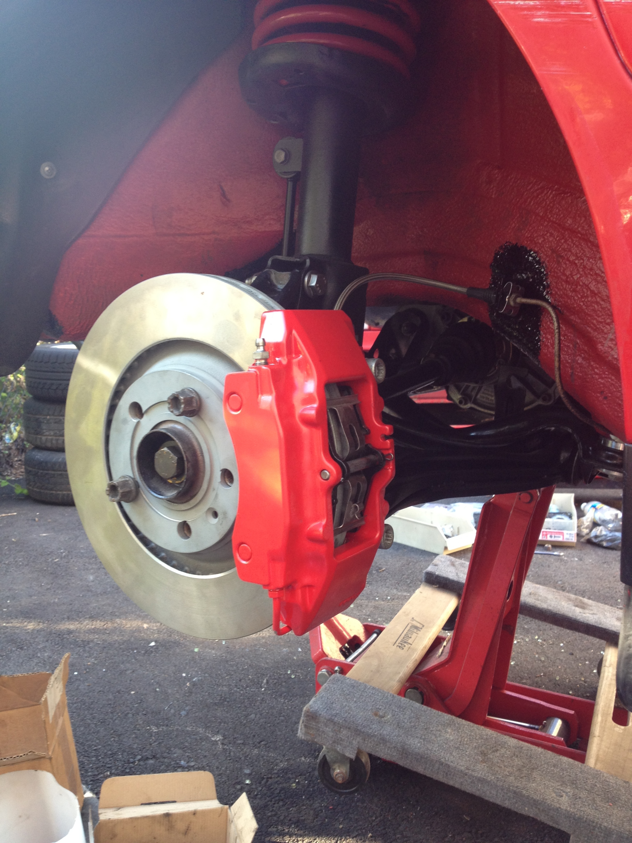

front brakes
- Sebastian's CQ91' front brakes bracket .JPG (3.05 MiB) Viewed 42039 times
- Sebastian's CQ91' brakes done.jpg (2.85 MiB) Viewed 42039 times
- Sebastian's CQ91' front brakes .JPG (1.93 MiB) Viewed 42039 times
- Sebastian's CQ91' wheels 17%22.jpg (2.98 MiB) Viewed 42039 times
- Sebastian -

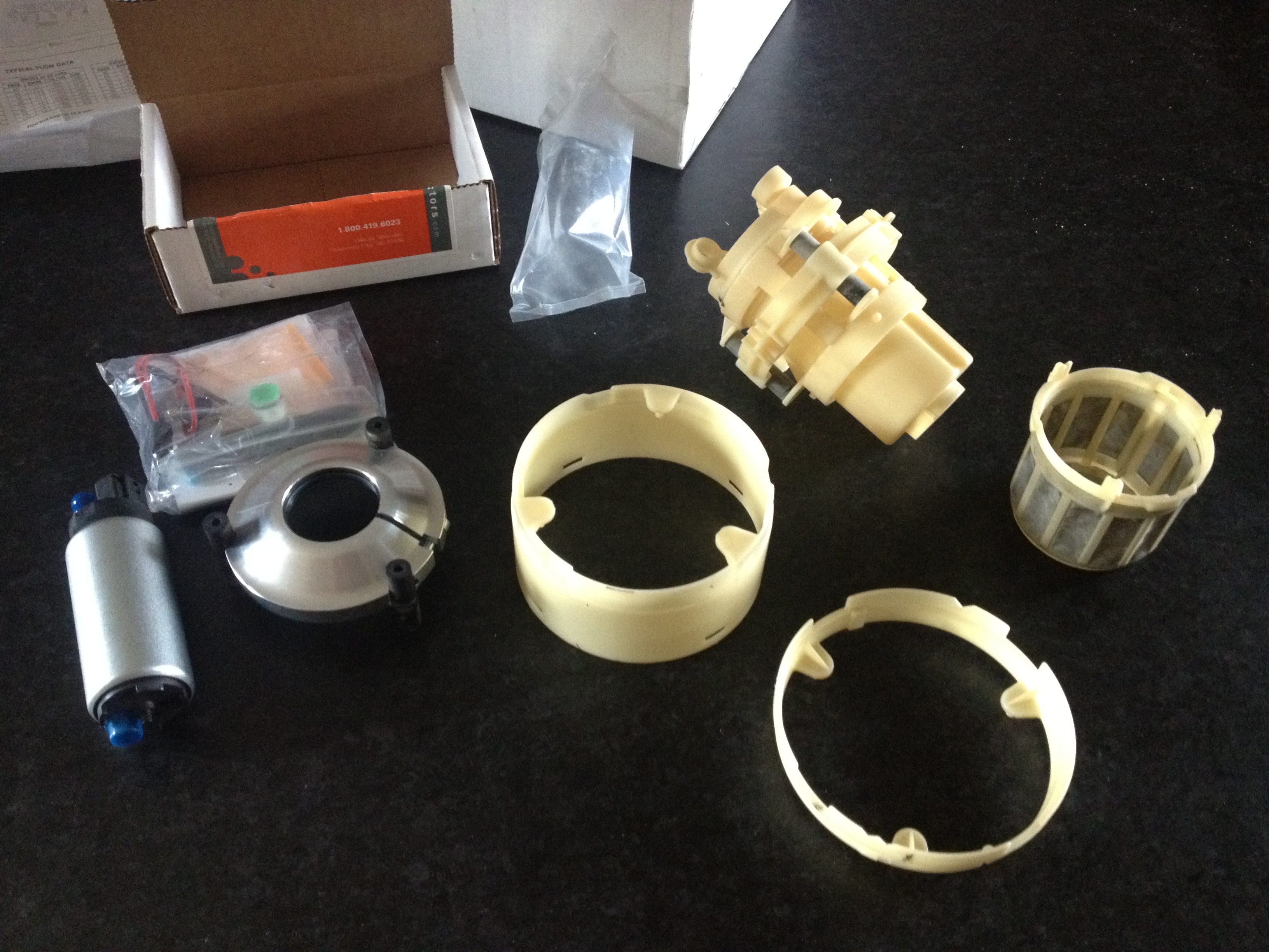

some random photos

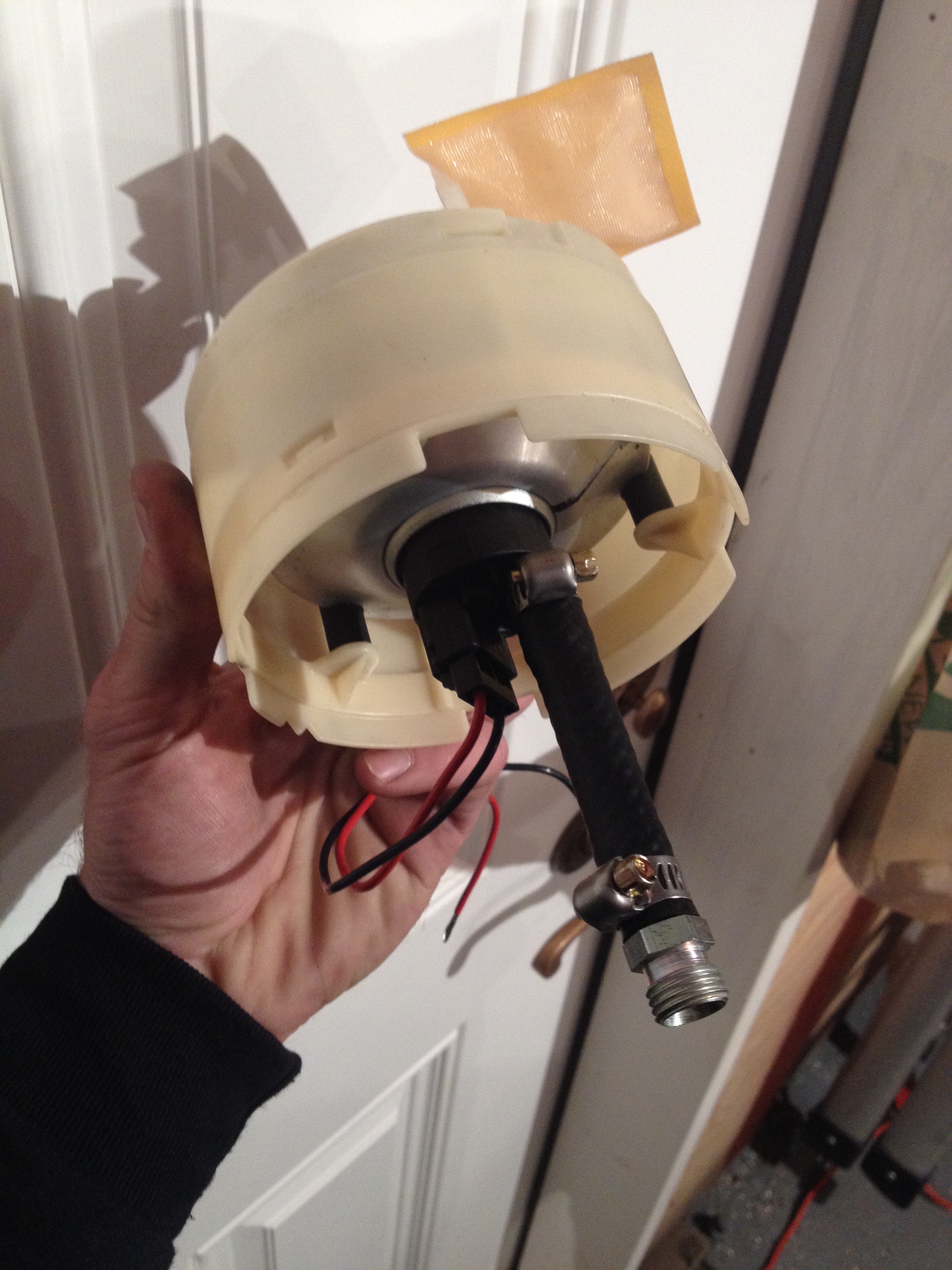

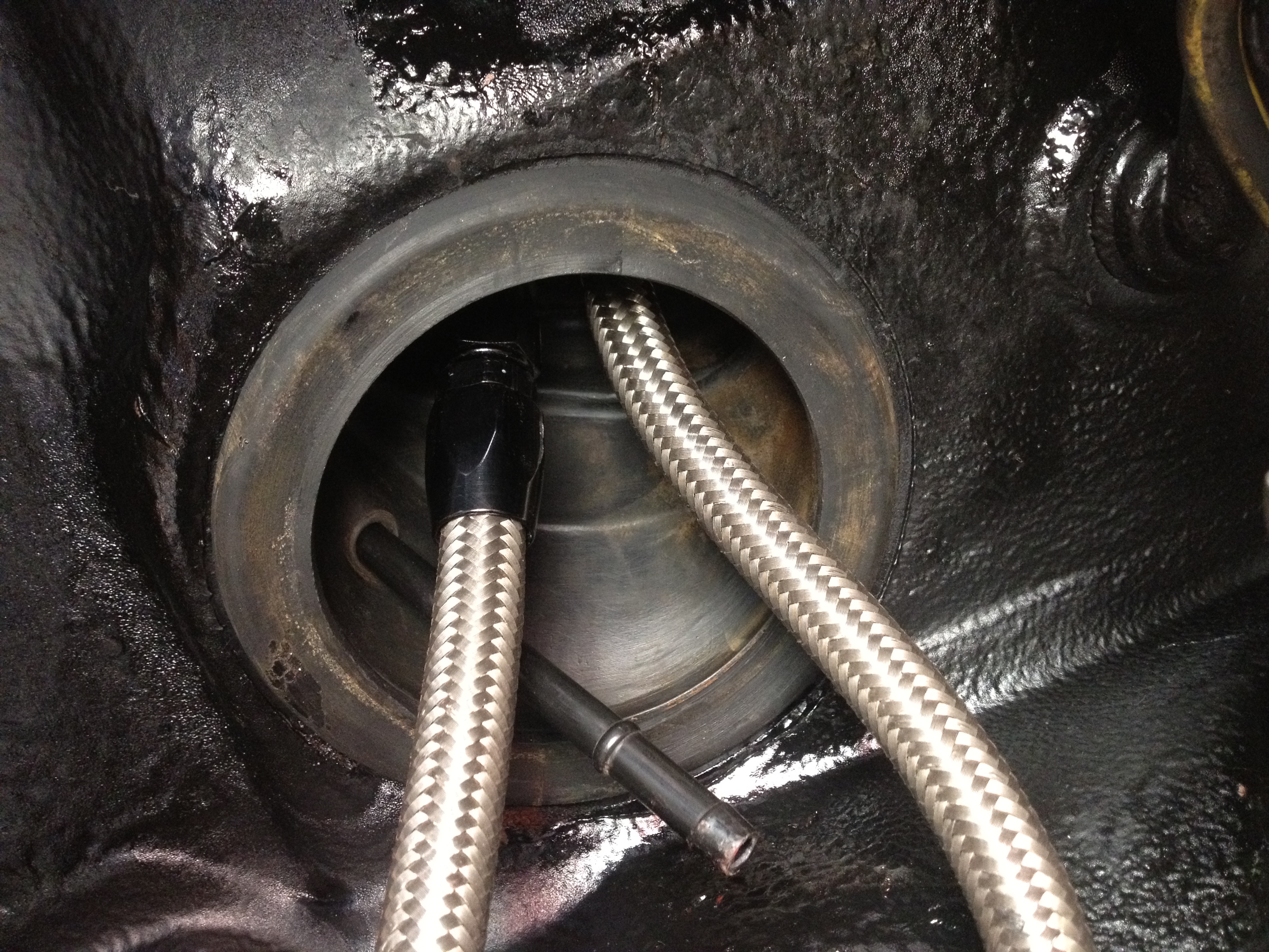

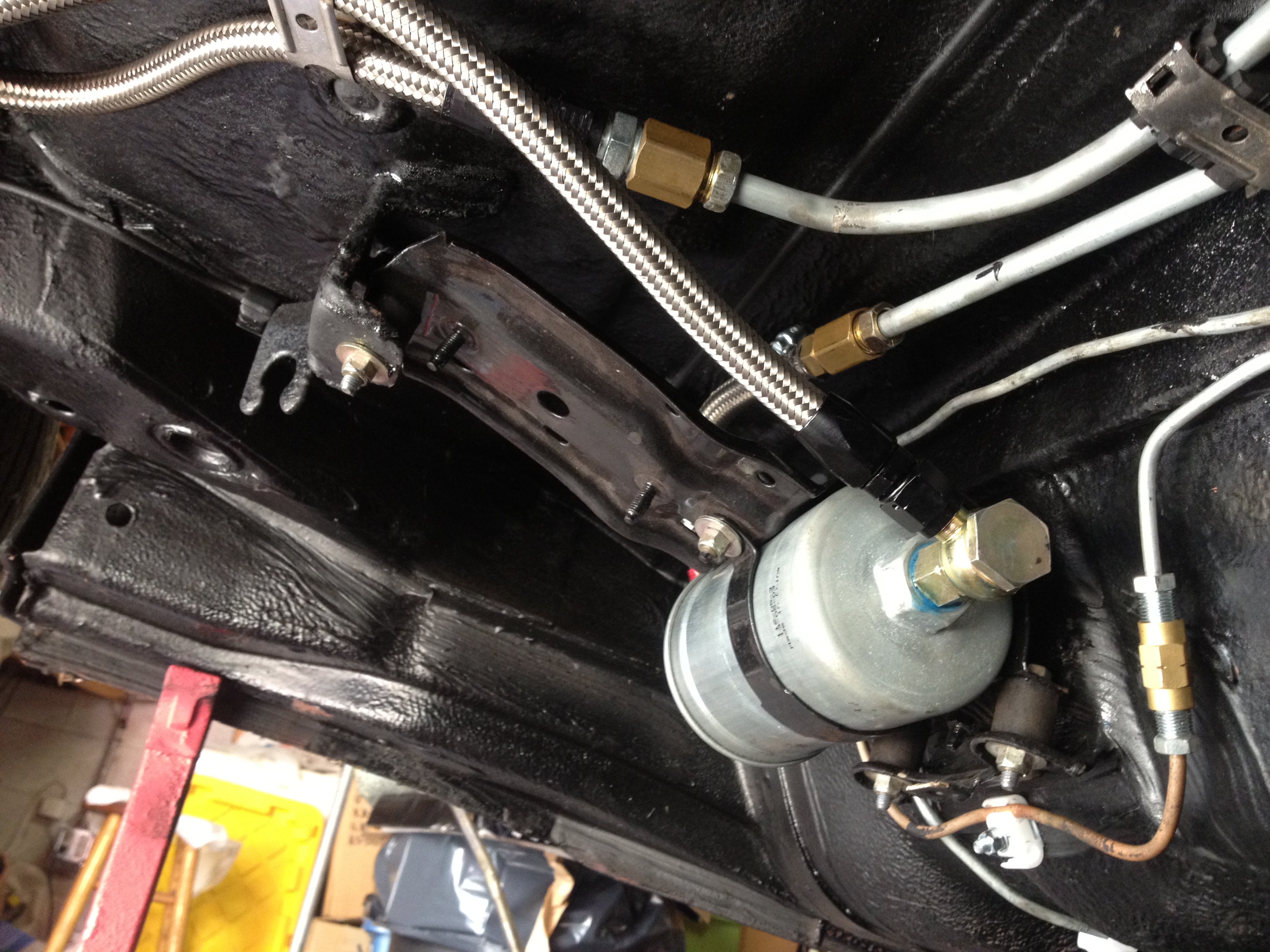

- Sebastian's CQ91' fuel filter housieng restored.JPG (2.31 MiB) Viewed 42029 times

fuel lines, fuel tank connection with -6an fitting
- IMG_4209.jpg (2.15 MiB) Viewed 42020 times
- IMG_6083.jpg (3.69 MiB) Viewed 42020 times
- Sebastian's CQ91' fuel tank plastic hose fix.jpg (3.21 MiB) Viewed 42020 times
- Sebastian's CQ91' fuel tank lines.JPG (2.94 MiB) Viewed 42020 times
- Sebastian's CQ91' fuel filter new lines.JPG (2.31 MiB) Viewed 42020 times
- Sebastian -

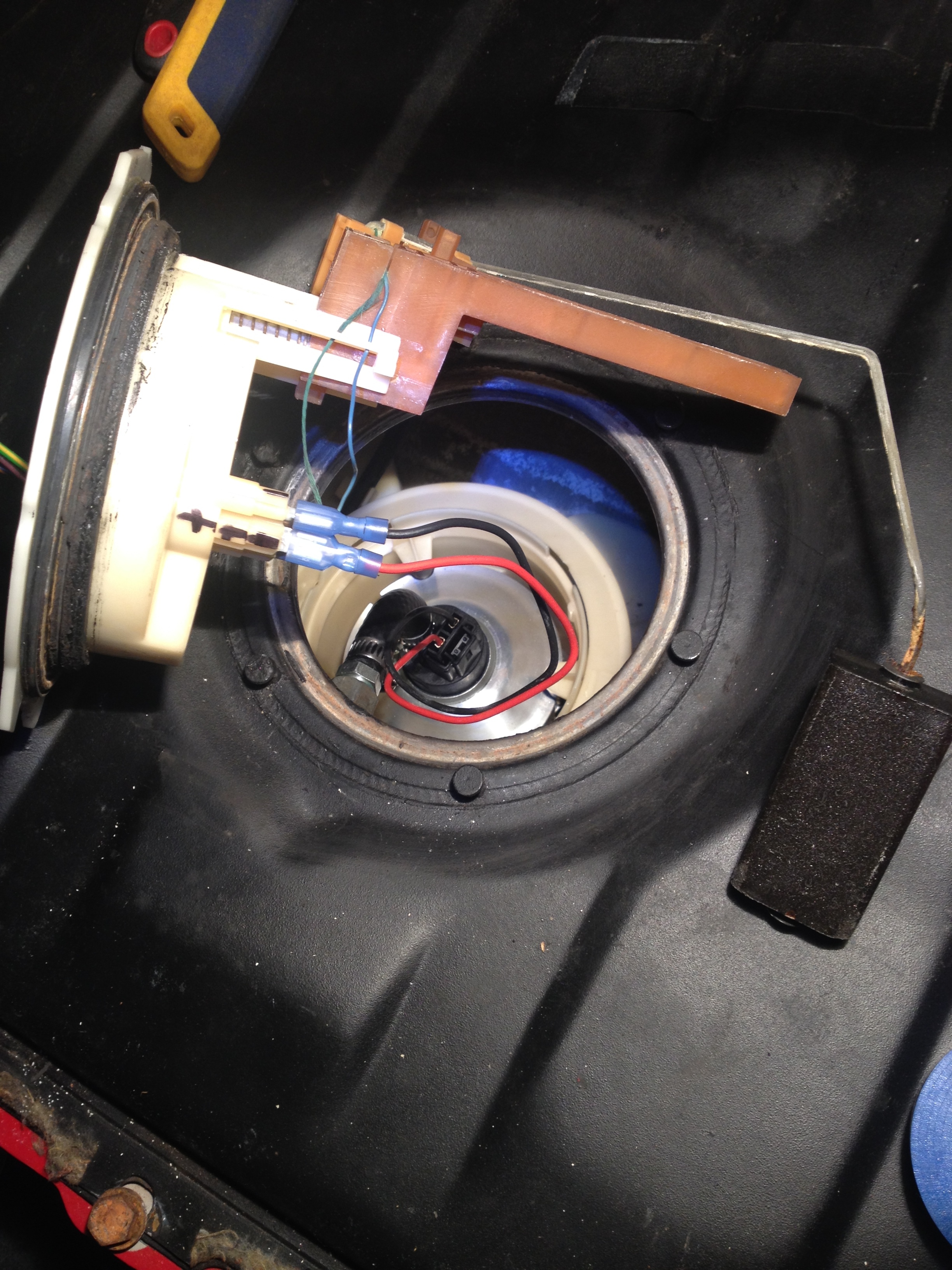

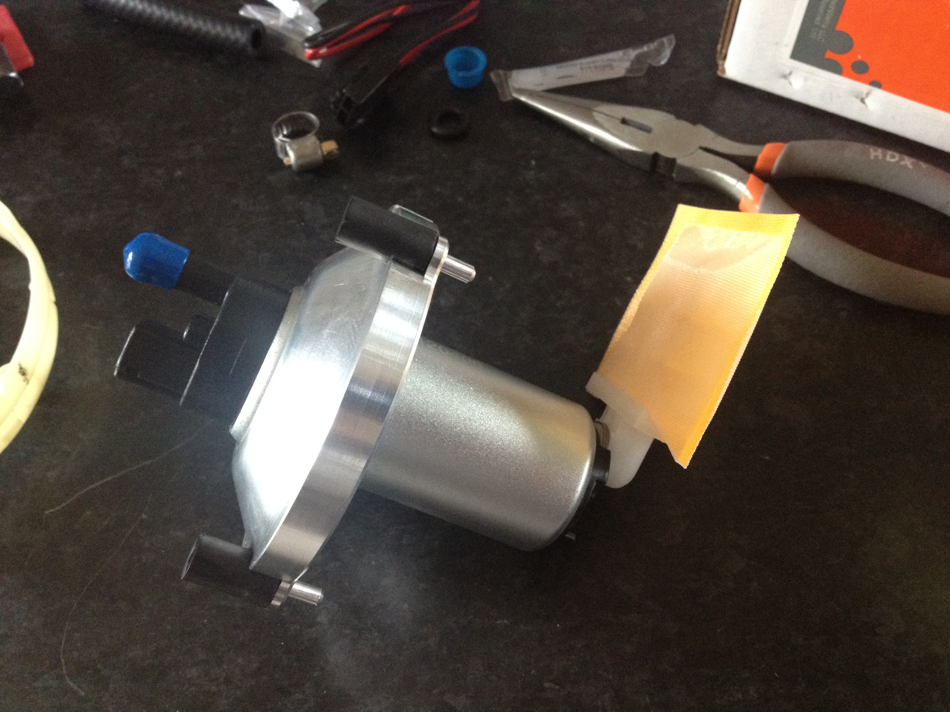

fuel pump and some wiring
- Sebastian's CQ91' fuel pump setup.JPG (2.3 MiB) Viewed 42019 times
- Sebastian's CQ91' fuel pump setup 3.JPG (2.39 MiB) Viewed 42019 times
- Sebastian's CQ91' fuel pump setup 2.jpg (2.3 MiB) Viewed 42019 times
- IMG_6877.jpg (2.39 MiB) Viewed 42019 times
- Sebastian -

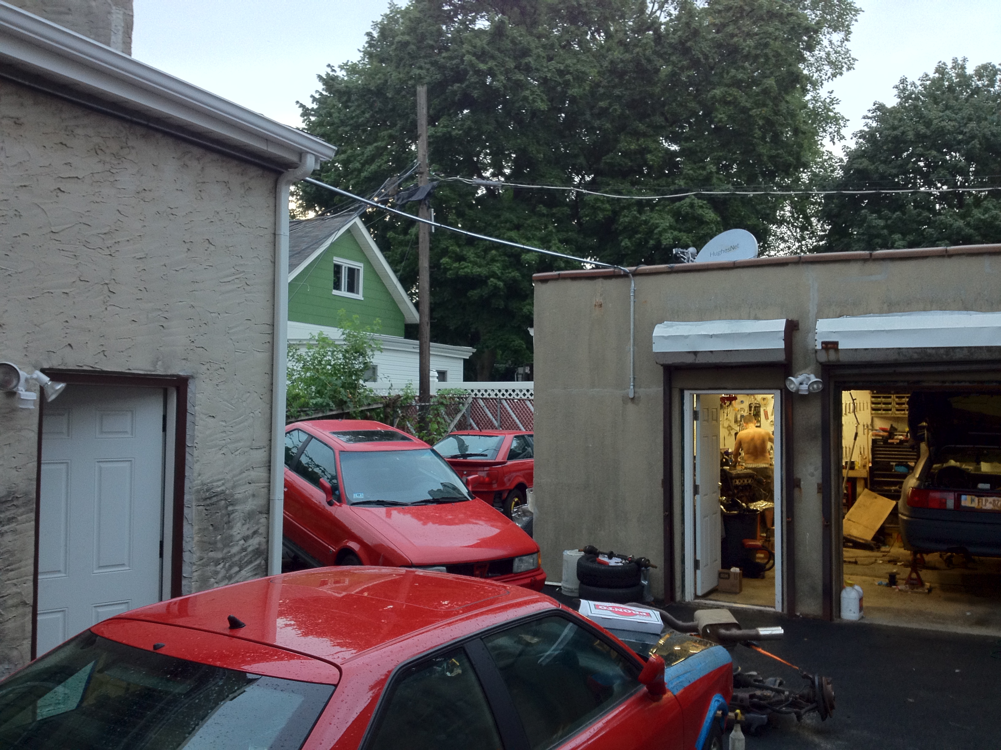

Our old shop (Mine and Adams) with two of my coupes far left, Danny's coupe with the blue tape and black primed Adam's full S2 built coupe inside.

the whole interior got stripped of old heavy sound proofing and carpet under mat.
- Sebastian's CQ91' interior strip down 3.JPG (2.83 MiB) Viewed 42018 times
- Sebastian's CQ91' interior prep 1.JPG (2.86 MiB) Viewed 42018 times
- Sebastian's CQ91' interior strip 2.JPG (2.83 MiB) Viewed 42018 times

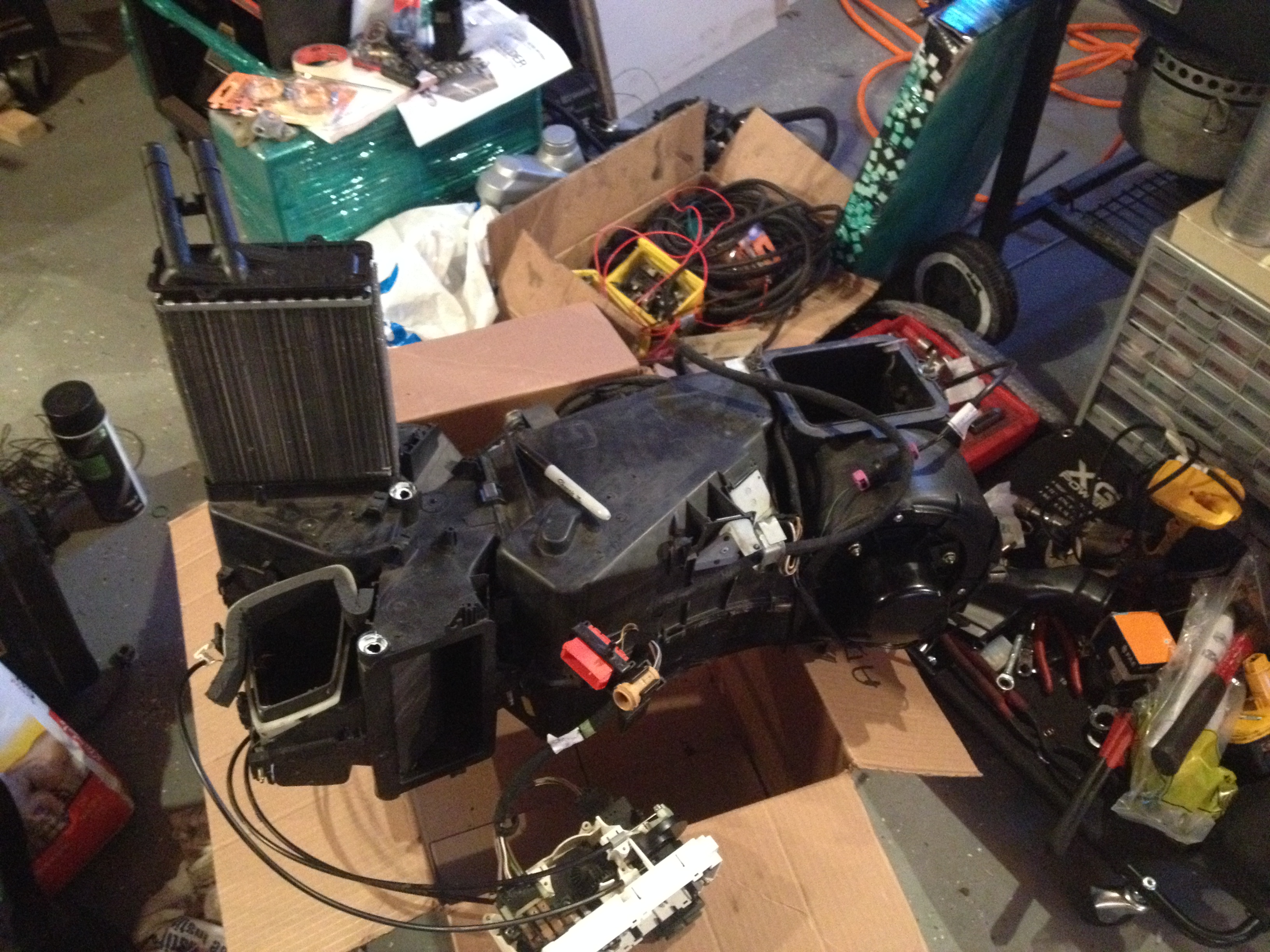

b4 manual climate control rebuild with new flapers and all black dash black leather trim also all old unused stock harness was cut out.
- IMG_7139.JPG (2.4 MiB) Viewed 42017 times
- Sebastian's CQ91' manual box swap.jpg (2.15 MiB) Viewed 42017 times
- Sebastian's CQ91' wiring 2.JPG (2.58 MiB) Viewed 42017 times
- Sebastian's CQ91' dash .jpg (2.76 MiB) Viewed 42017 times
- Sebastian's CQ91' interior black out.JPG (2.34 MiB) Viewed 42017 times
- Sebastian -

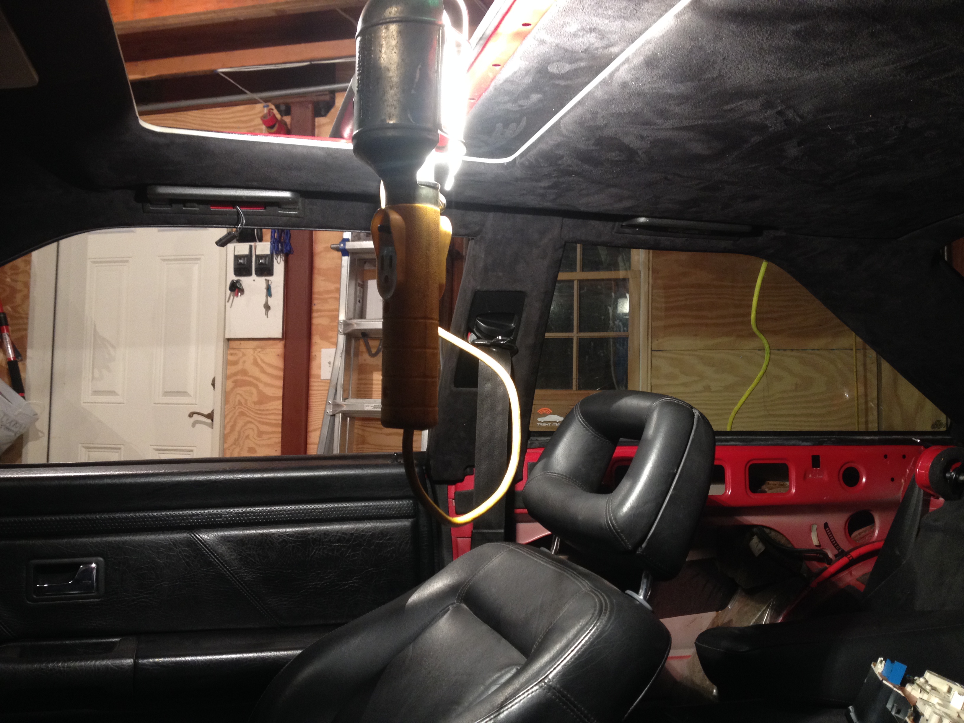

here is the upper trim of the interior that i have done in black suede it took two days to wrap it, my fiancee took snapped a picture of the material being applied
- Sebastian's CQ91' suede hard labor.jpg (2.62 MiB) Viewed 42014 times
- Sebastian's CQ91' suede complete uppper trim.JPG (2.65 MiB) Viewed 42014 times
- Sebastian's CQ91' suede interior 2.JPG (1.95 MiB) Viewed 42014 times
- Sebastian's CQ91' suede trunk.JPG (2.26 MiB) Viewed 42014 times
- Sebastian's CQ91' suede headliner 1.JPG (2.62 MiB) Viewed 42014 times
- Sebastian -

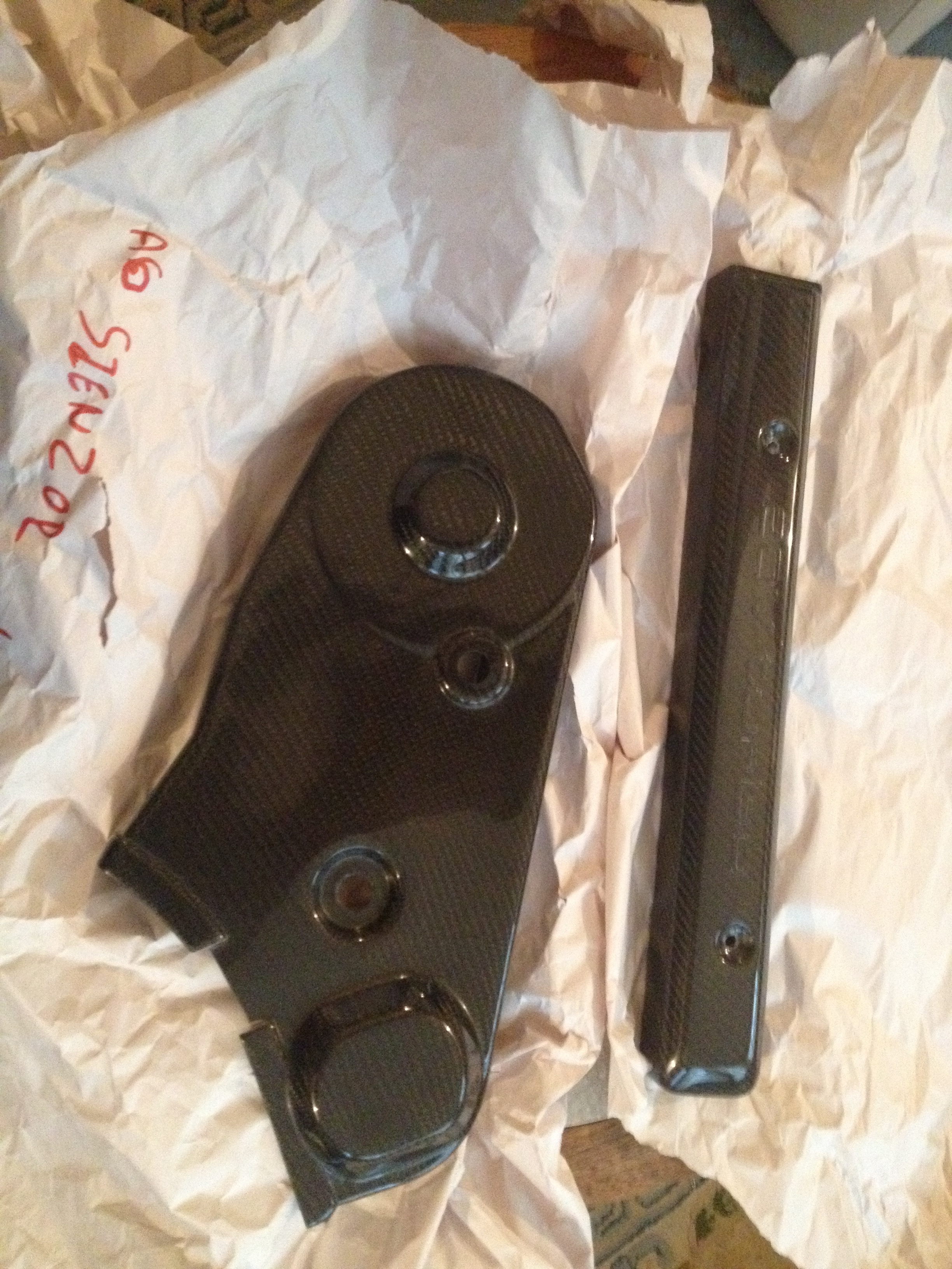

visiting Marc at EFI Express to pick up the motor
- Sebastian's CQ91' some carbon.jpg (3.09 MiB) Viewed 41923 times
- Sebastian's CQ91' Engine pick up 1.jpg (2.74 MiB) Viewed 41923 times
- Sebastian's CQ91' engine pick up 2.jpg (2.79 MiB) Viewed 41923 times
- Sebastian -

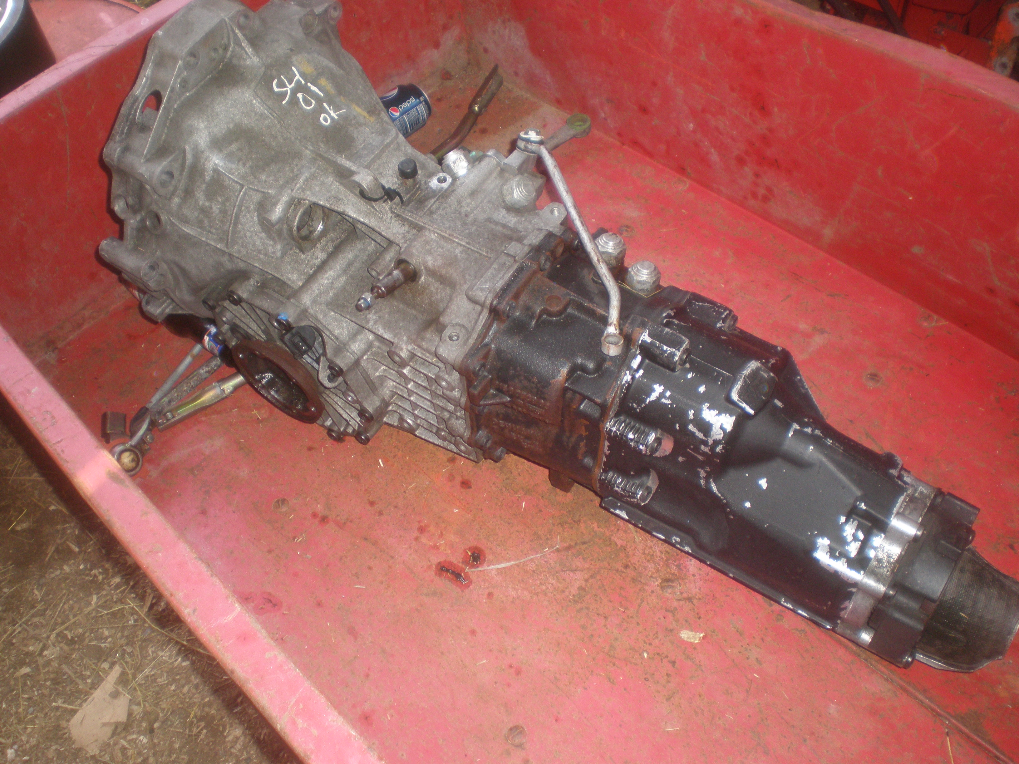

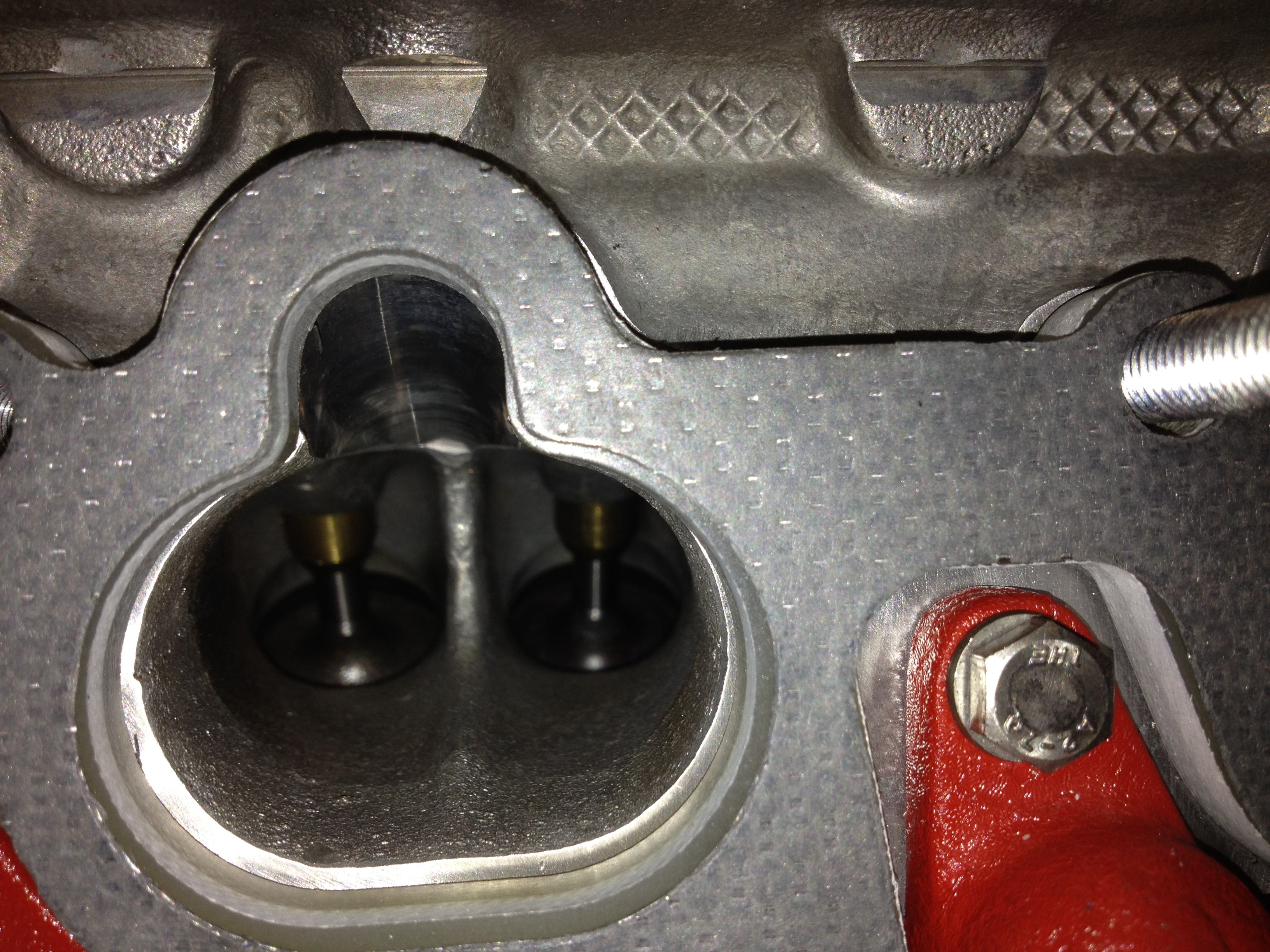

motor back at the garage and ready for further assembly along with 01e 6 speed from Dana here are some random shoots
the motor here is still with the rs2 exhaust manifold which was later upgraded to the Wagner Sport exhaust manifold.
- Sebastian's CQ91' engine head valves.JPG (2.83 MiB) Viewed 41920 times
- Sebastian's CQ91' engine carbon.jpg (2.86 MiB) Viewed 41920 times
- Sebastian's CQ91' carbon parts 1.jpg (3.4 MiB) Viewed 41920 times
- Sebastian's CQ91' 01e 6 speed.JPG (1.61 MiB) Viewed 41920 times
- Sebastian's CQ91' motor and tranny stored.JPG (3.06 MiB) Viewed 41920 times

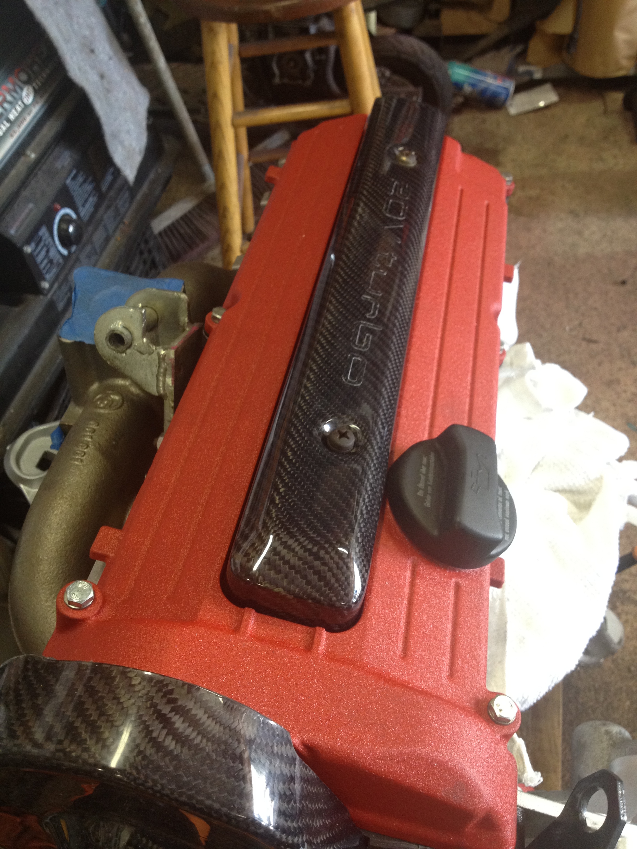

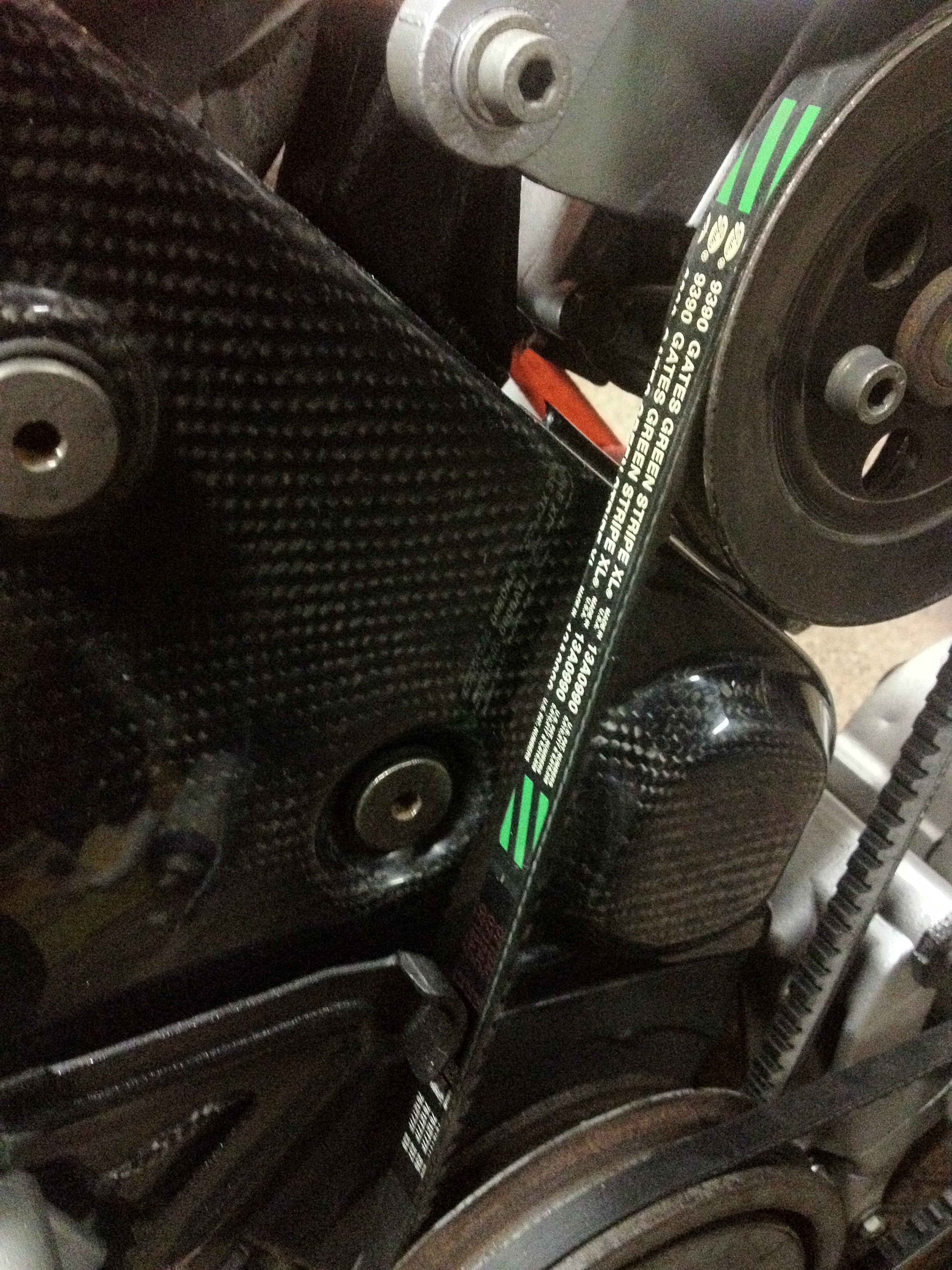

some red wrinkle powder coat with some carbon fiber trim
- Sebastian's CQ91'engine random shoot 9.JPG (2.64 MiB) Viewed 41918 times
- Sebastian's CQ91' engine random shoot 6.JPG (2.75 MiB) Viewed 41918 times
- Sebastian's CQ91' engine carbon 2.jpg (2.44 MiB) Viewed 41918 times
