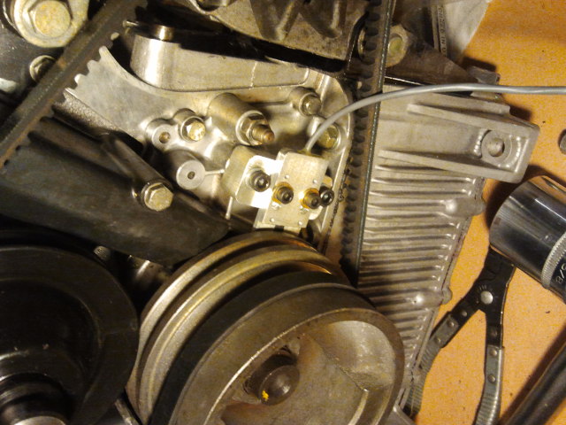

This is an SDS hall sensor with trigger magnets embedded (epoxied) into the back of the crank pulley which I am going to use with MS2. http://www.sdsefi.com/EM5E20.pdf

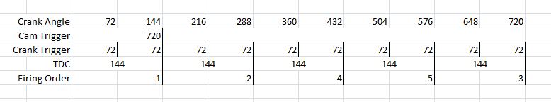

Ok, so please educate me if I am missing something and not thinking about this correctly but I think that it would work if used with a cam sensor. I also think that it would work without a cam sensor with wasted spark ignition and two injector pulses per rev.
