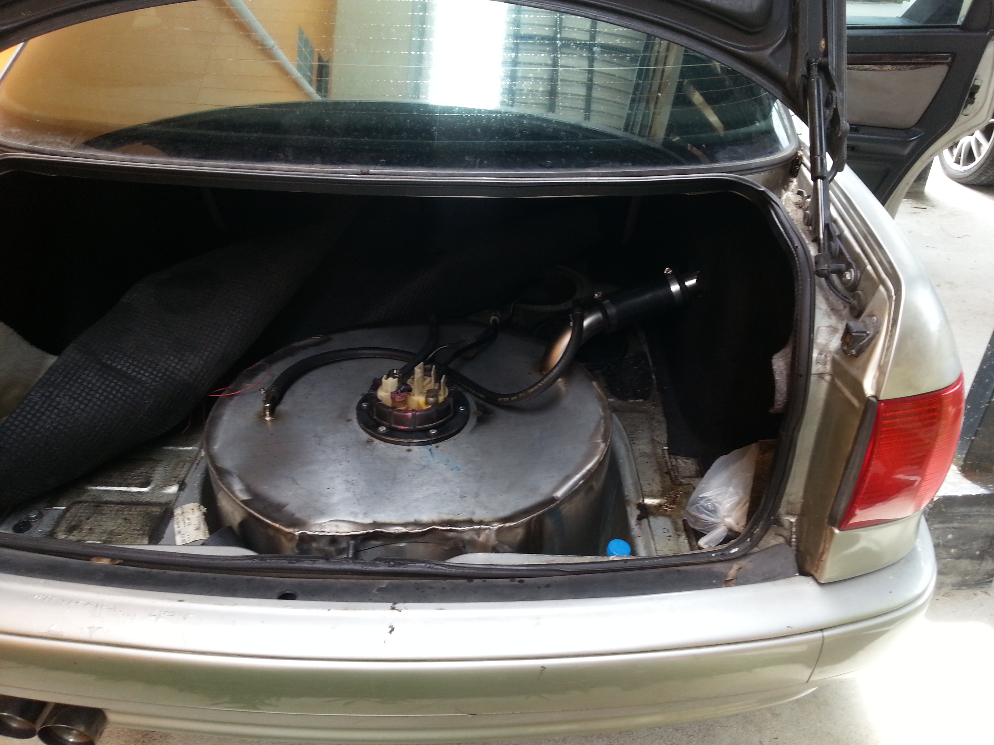

Some might have seen my fuel tank set up. It is a SS tank in the spare tire well. See picture. Not optimal I know, but it was the only viable option here. B4Q fuel tanks do not exist in Thailand.
The weather gets real hot here and the tank does not get cooled while driving. It is hot to the touch as in body panel in the sun hot.
I running E20 now, but will switch to E85 after the VEMS switch.
I am worried that the ethanol is evaporating fast and having a hot fuel tank.
Would having a small cooler with fan in the return line be a good idea? I would mount it under the car in the space where the old tank was.
Having a hot fuel tank in the trunk is not a comfortable thought.

Cooler sounds like a good idea (it probably would not have to be very large), putting it in the return (vs. the supply) line sounds like a really good idea, putting it under the car... not so much. Airflow won't be great, the air that reaches it will likely be warm/hot, and there's the possibility of it getting damaged (with really nasty consequences) by a stone thrown up by a tire or something like that.
Is there any chance you could find room in the front of the car behind the grille?
As a side note, make sure your tank is properly vented! You probably know this but in fuel-land, with heat comes pressure...

Good point about the positioning. I would add a small fan to the cooler if positioned in the back. There is not much room at the front behind the bumper. It is the Euro 4cylinder bumper. Not even room for a FMIC without a lot of cutting.elaw wrote:Cooler sounds like a good idea (it probably would not have to be very large), putting it in the return (vs. the supply) line sounds like a really good idea, putting it under the car... not so much. Airflow won't be great, the air that reaches it will likely be warm/hot, and there's the possibility of it getting damaged (with really nasty consequences) by a stone thrown up by a tire or something like that.
I should add an EVAP vent. True

I don't see how a cooler could be a bad idea. Return line would be ideal since it is easier to remove heat when you have a bigger delta in temperature. You're sure it is hot because of the fuel alone, or is it more because of the hot climate?
Re: My fuel tank is HOT; Fuel cooling?
Yes, especially if there isn't enough of a reservoir for the fuel to go back into and/or if the pump is causing too much fuel to be bypassed at idle.

Get a vent in that tank! You can run it to the N80, just like it was run from the stock tank(if your 80 has that system). When you get VEMS, it can control it also.
Also, even if you had room, I wouldn't run a fuel cooler to the front of the car. Get in a bad enough collision and, uh, boom.

I am sure the climate is a large contributing factor.loxxrider wrote:I don't see how a cooler could be a bad idea. Return line would be ideal since it is easier to remove heat when you have a bigger delta in temperature. You're sure it is hot because of the fuel alone, or is it more because of the hot climate?
A vent will be installed. I need to tee into the hose you see at the top of the tank. Since the stock tank is gone, I think a small cooler with fan somewhere in that space might work, small stones notwithstanding. It would be exposed to more junk at the front. Collision danger is a good point.

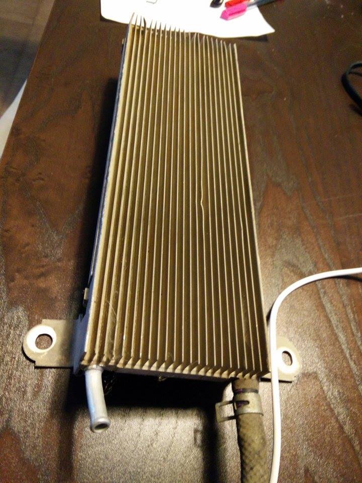

Got this fuel cooler from a buddy of mine today. Don't know what its from, but it is meant for fuel cooling.
Will instal it soon in the cavity where the old fuel tank was, close to the access cover and see what happens.

Nice score!

Thanks, I thought so too. It kinda looks like of of those PC heat sinks. I might attach one of those small PC fans to it (or 2), if I can find a 12v version.loxxrider wrote:Nice score!
Patch it into the fuel pump power lines.
