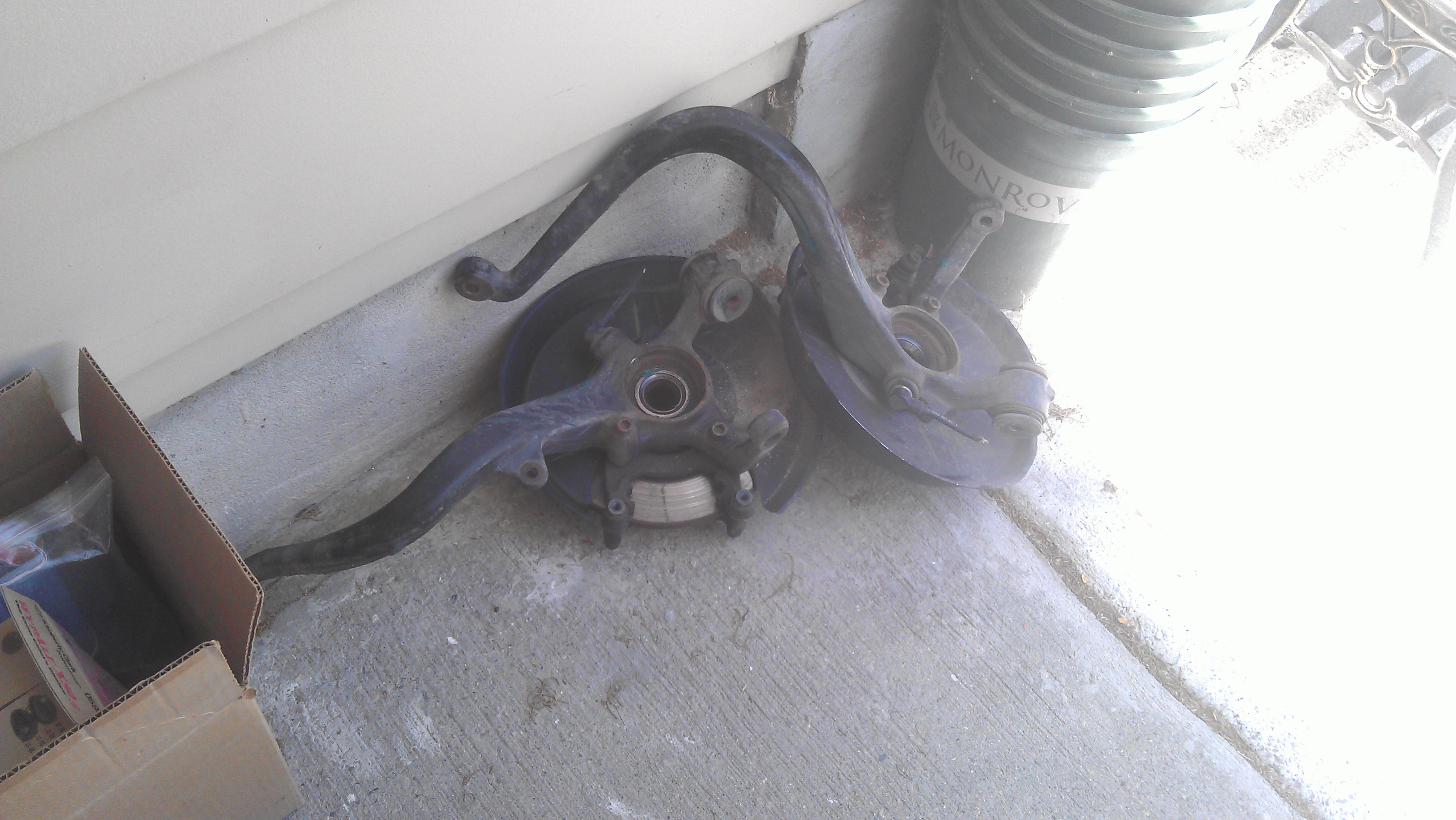

So I went to the junkyard today since it was half off Wednesday. picked up the rear knuckles off an A4q to get me started. I still need urs front hubs to finish off the conversion, so if anybody has some they want to part with, I may be game.

Posted: Tue Jul 22, 2014 1:57 am
by scubadave
So sunday I finally got the front machined hubs from Bryden. I spent from 2:00 till 9:30 doing the swap, and as I got home, I was thoroughly exhausted and quite dirty. Even though I dont miss fixing cars for a living, I need to find a house with a workshop that will accommodate a lift, and buy it. Im soo far out of shape to do repair its a joke. I like my current position as an electronics tester, but its killing me slowly sitting in an office chair for hours on end. Not even close to the physical demand I was used to before.
Anyway, I fought the bearings tooth and nail, and won eventually. I could never have done it without my hub tamer. What a great tool, and was worth every penny at the time. It really does pay for itself in no time. I shimmed the hubs out to take up the slack and did not have to shim the caliper. I would not have been able to bolt up my wheels otherwise and would have been rubbing on the tie rod end. The rear knuckles I got from that A4q bolted in with only the antilock brake sensors giving me trouble.

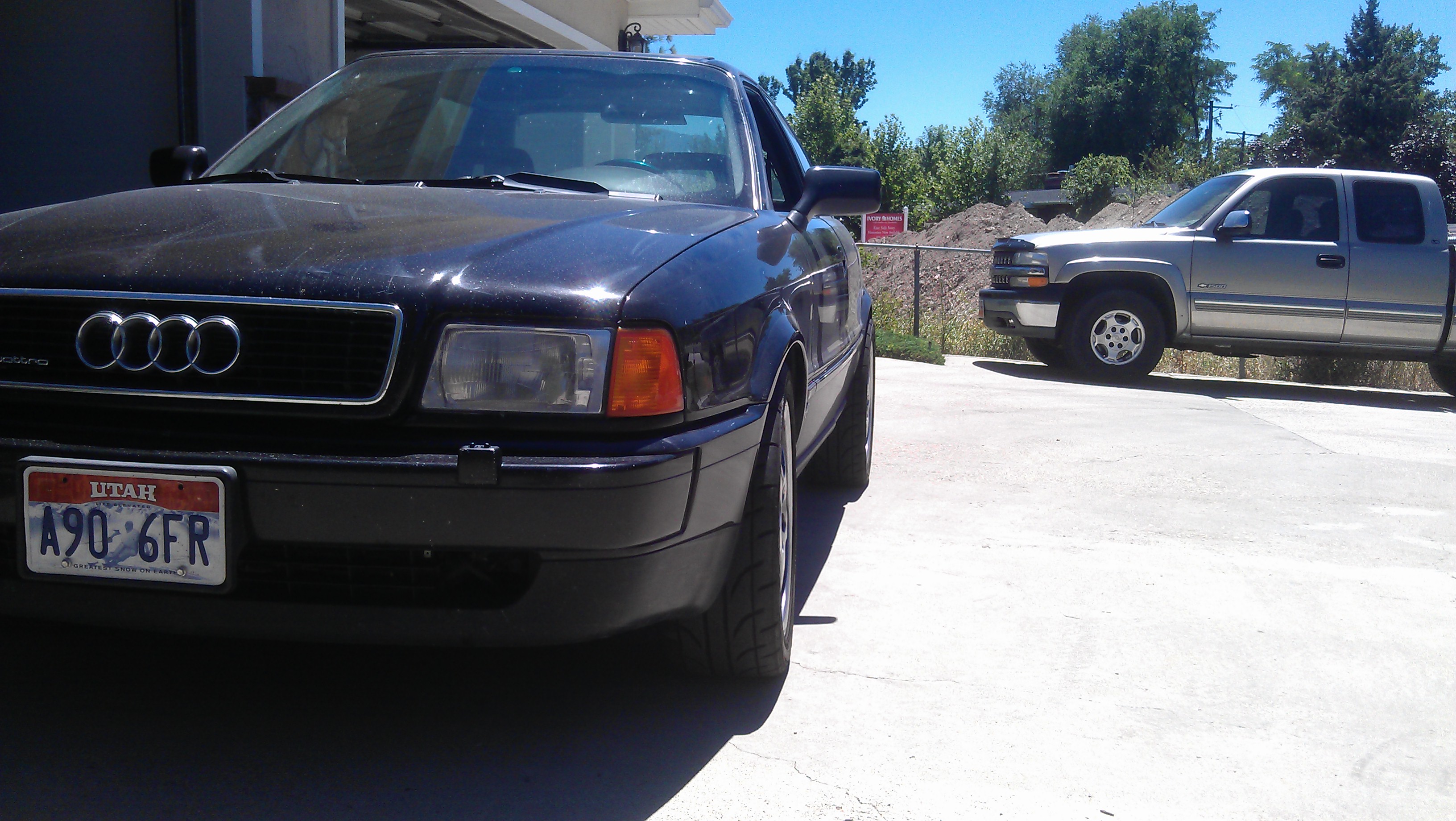

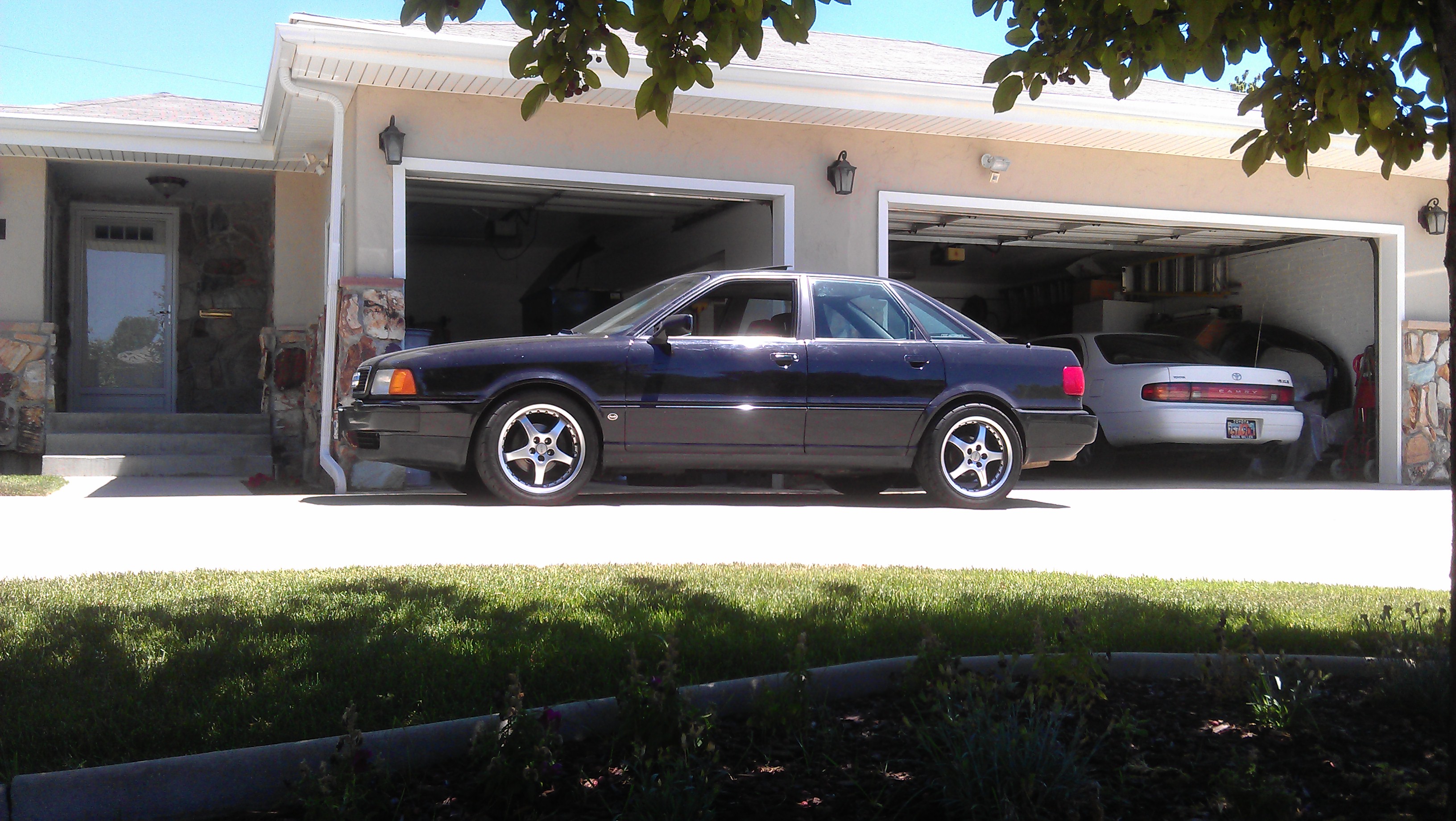

Posted: Tue Jul 22, 2014 7:55 pm
by scubadave
It looks like these wheels fit better on this car then my coupe. they sit further out then on the coupe.
