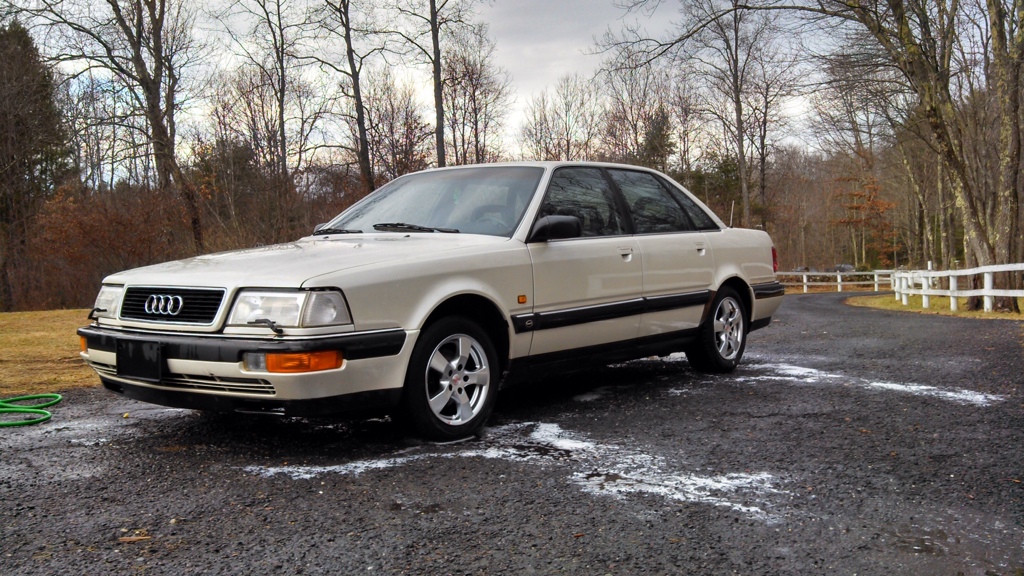

Just picked this up, going to start spending $ on it.
I'm looking for better front seats, sport or urs...heat power memory, if anyone has anything kicking around let me know. Needs valve cover gaskets bad, doing that and rear wheel bearing this week. Radio is stuck in safe mode, but I can't enter the code, it's a Bose I've tried holding fm1 and am and it's not responding. Any ideas on that?

I like the ride! I love the V8's... when I was looking for my car I also kept an eye out for V8's. Good luck...
Re: New V8
Damn that looks CLEAN, but those wheels have got to go!

Which there are two sets pictured, 5 spoke Allroad 17's and old 15" milli's.
And the paint is pretty haggard, over all it's in good shape.
