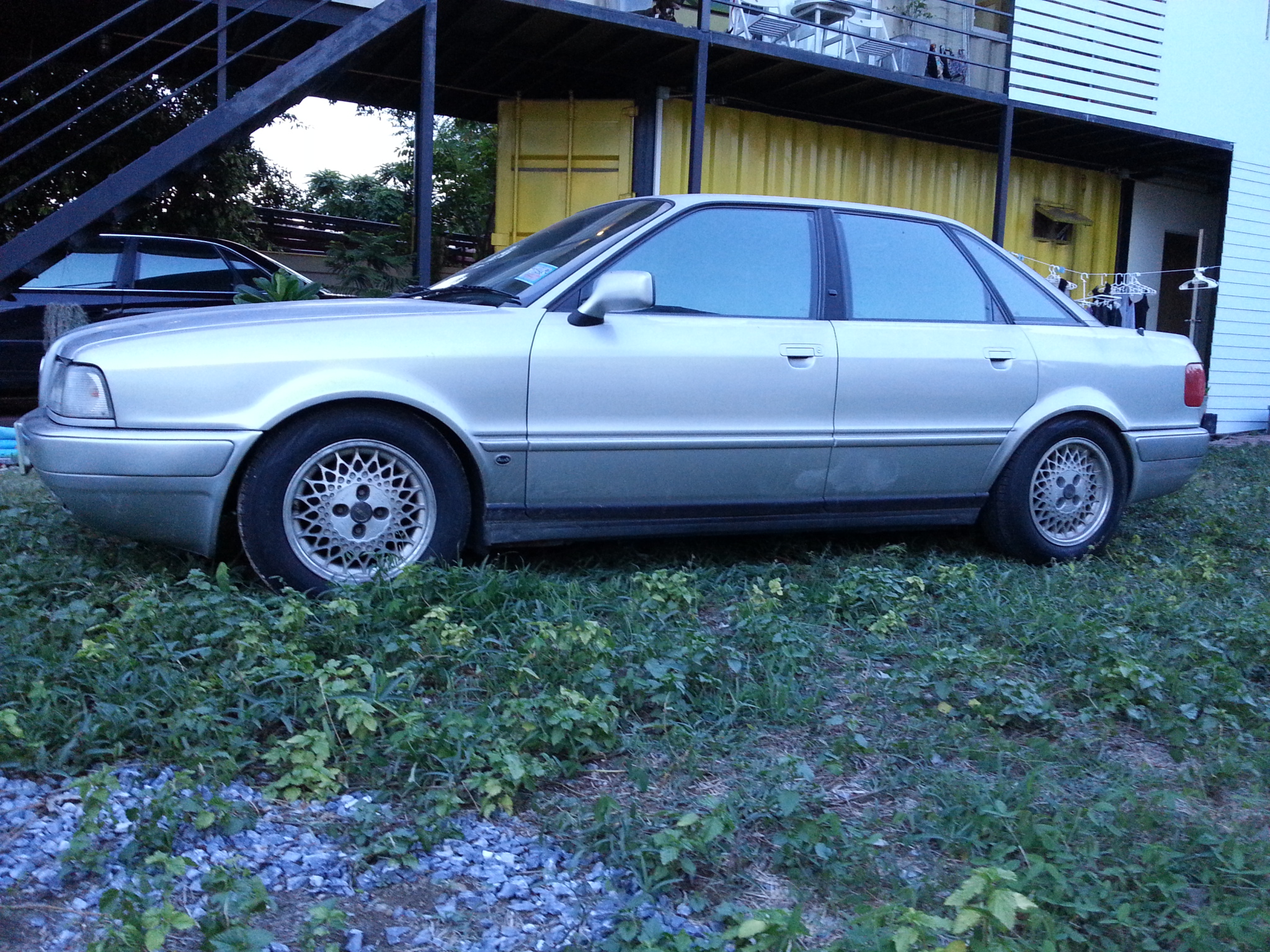

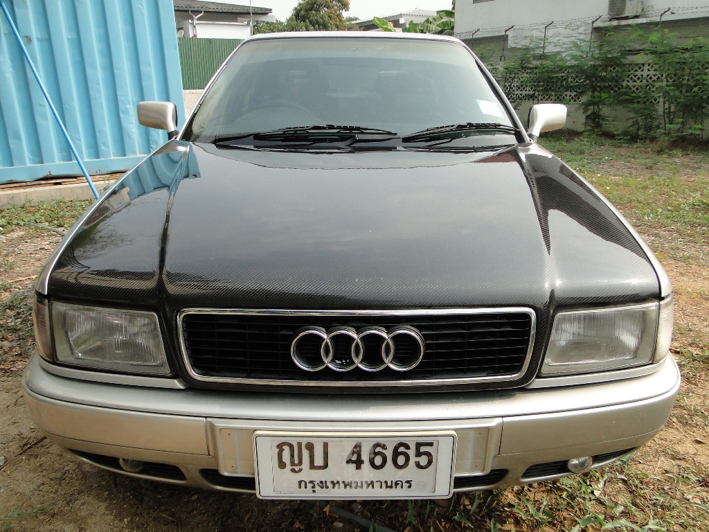

Finally, I will be able to post up a project thread after living vicariously through others for many years.
Living in Thailand severely limits the available Audi / VW cars with cool engine, trans and driveline options.

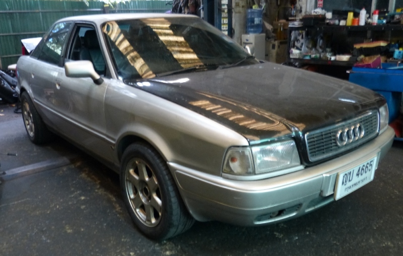

In 2008 I bought a B4 80 so I had a car to test fit the carbon hoods I was having made. Some of you probably know I am still trying to get these sold and exported.
The car is a 1995 80 2.0E automatic. Bought it for 100,000 baht. About 3 grand US. Yeah, I know. That's just how it is here.
It was in worse condition than I thought. Shocks where shot, bad VSS connection, would run on only 3 cylinders, shit tires and an inop LPG system.
Fast forward to end 2013, early 2014, I decided It needed something more. Switched it to E85, did a flap MAF elimination with a piggyback MAP-ECU3.

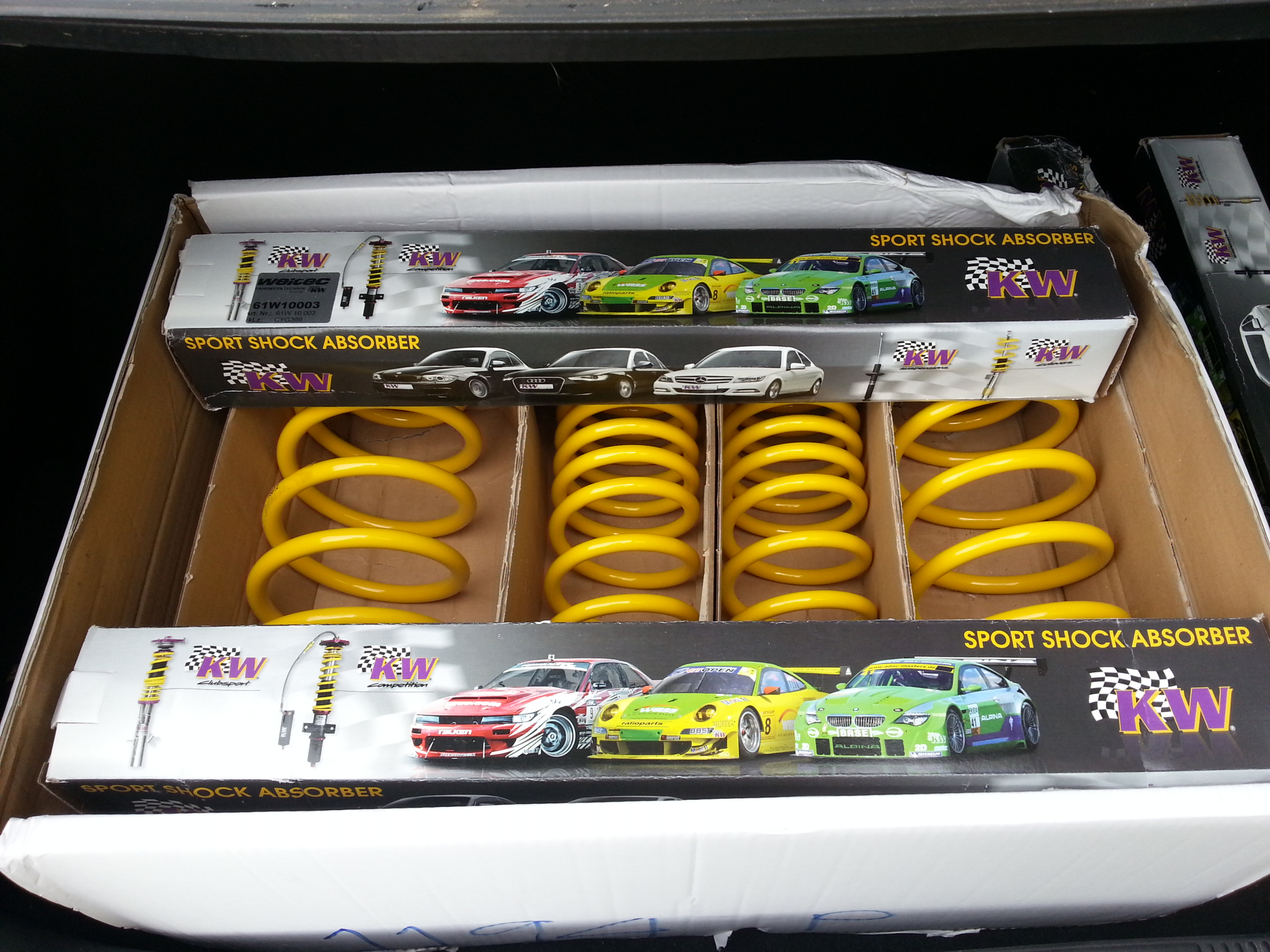

It already had a Weitec cup kit on it. Made by KW, but the low budget stuff. 40/40mm.
After coming into some money, I decided to get a little more serious. A buddy of mine in the Thai Audi club has a complete B5 A4 quattro rear subframe with 4.11 diff and rear struts. After seeing NiTeC's Quattro conversion of his 80 Avant, I decided it was time. I wanted to go 5cylinder, but finding a 20vT motor here is very tough. Only 50 S6's were ever imported and a lesser number of S4. After pondering all the mods needed and talking with my Audi buddy, he convinced me to go AEB. He found a B5 A4 AEB with quattro trans half cut from Japan! Paid a deposit on that yesterday, including a B5 quattro fuel tank. This can be made to work. That guy also had a real nice set of Recaro black leather seats from an A3. These just happen to have the same track width as a B4. Bonus. Made a deal on those too. In the pics you will see a dirty ass set, but he had near new ones in a storage room.
However, because I have no fab skills like many here or the tools, the swap will be done by a local shop which has already done several AEB to B4 swaps, including a 2.7TT Quattro into B4. Labor costs are very reasonable in this country. The swap will start August 2nd.
While collecting parts for the swap, like the pedal assembly, clutch line, MC and reservoir from the UK and a bitchin' steering wheel, I found a guy on the 'Tex still trying to sell his Lugtronic VEMS ECU including harness, 630cc injectors, new 06A coils, boost controller and WBO2. Made a deal. That will be here Monday. Still want to find a K04-015.

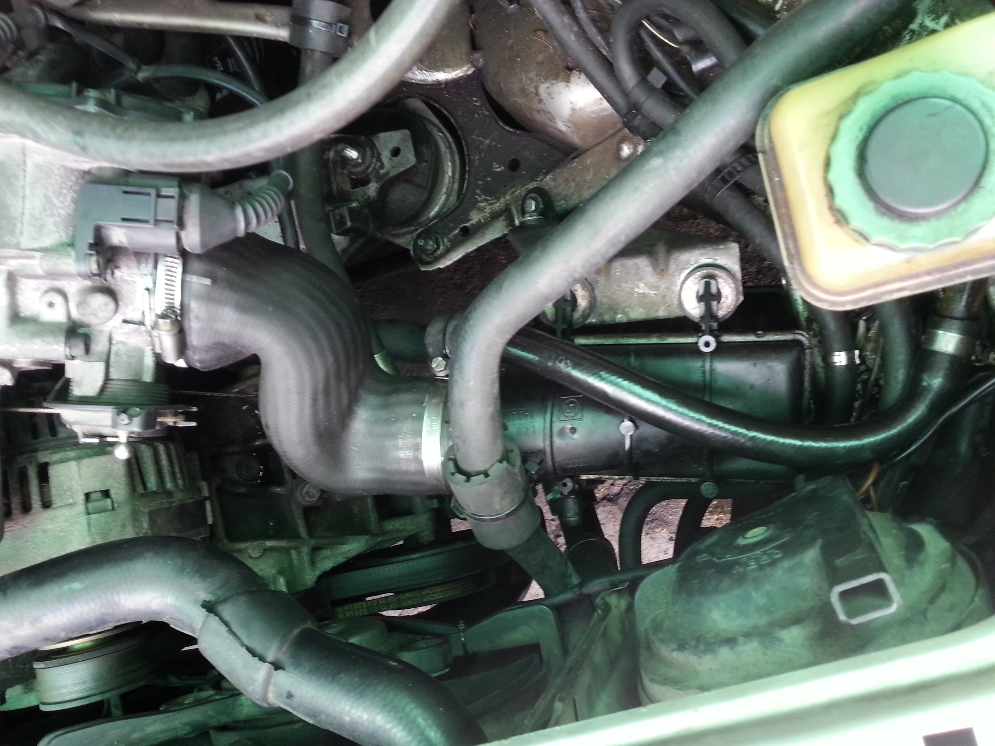

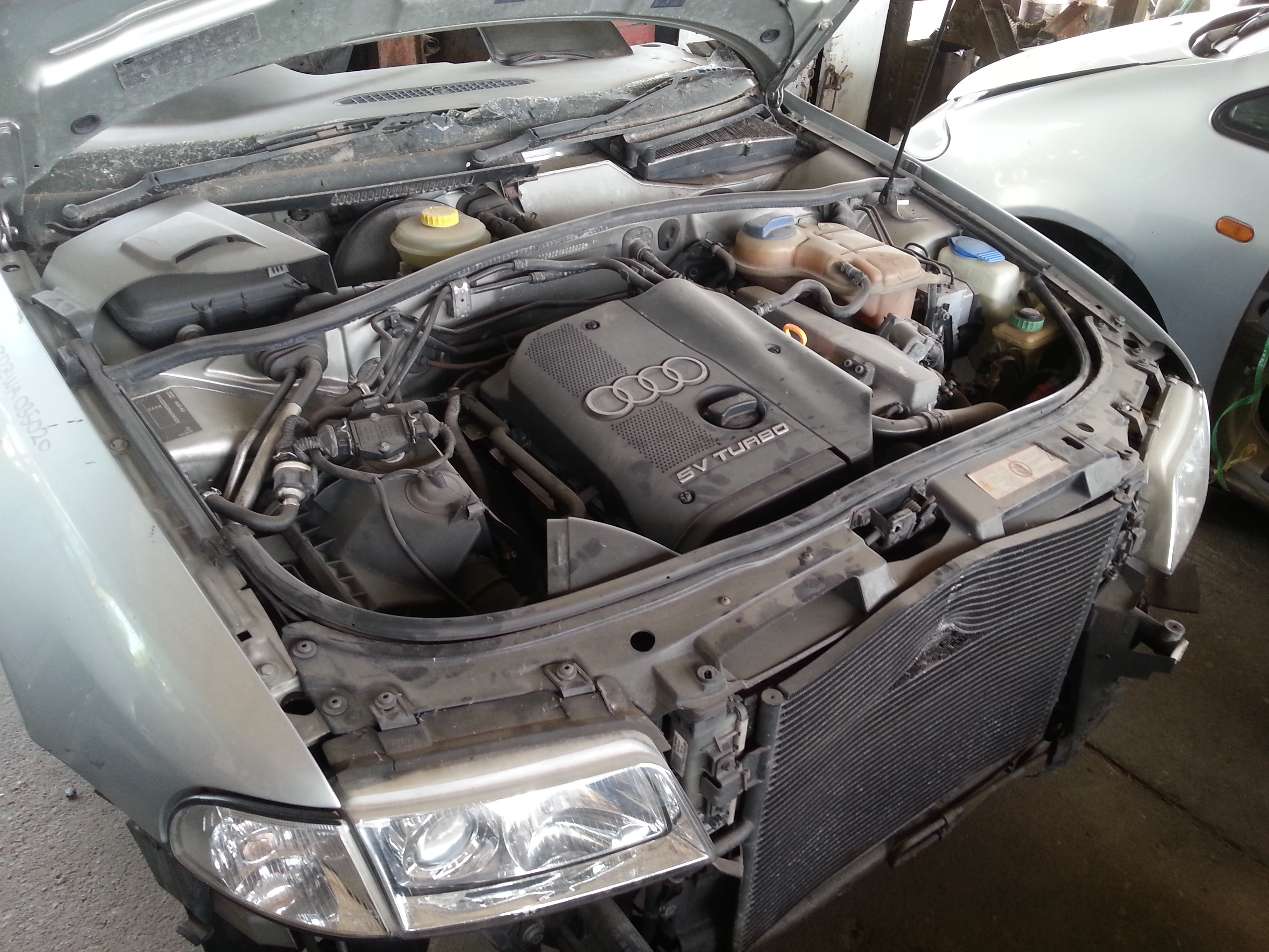

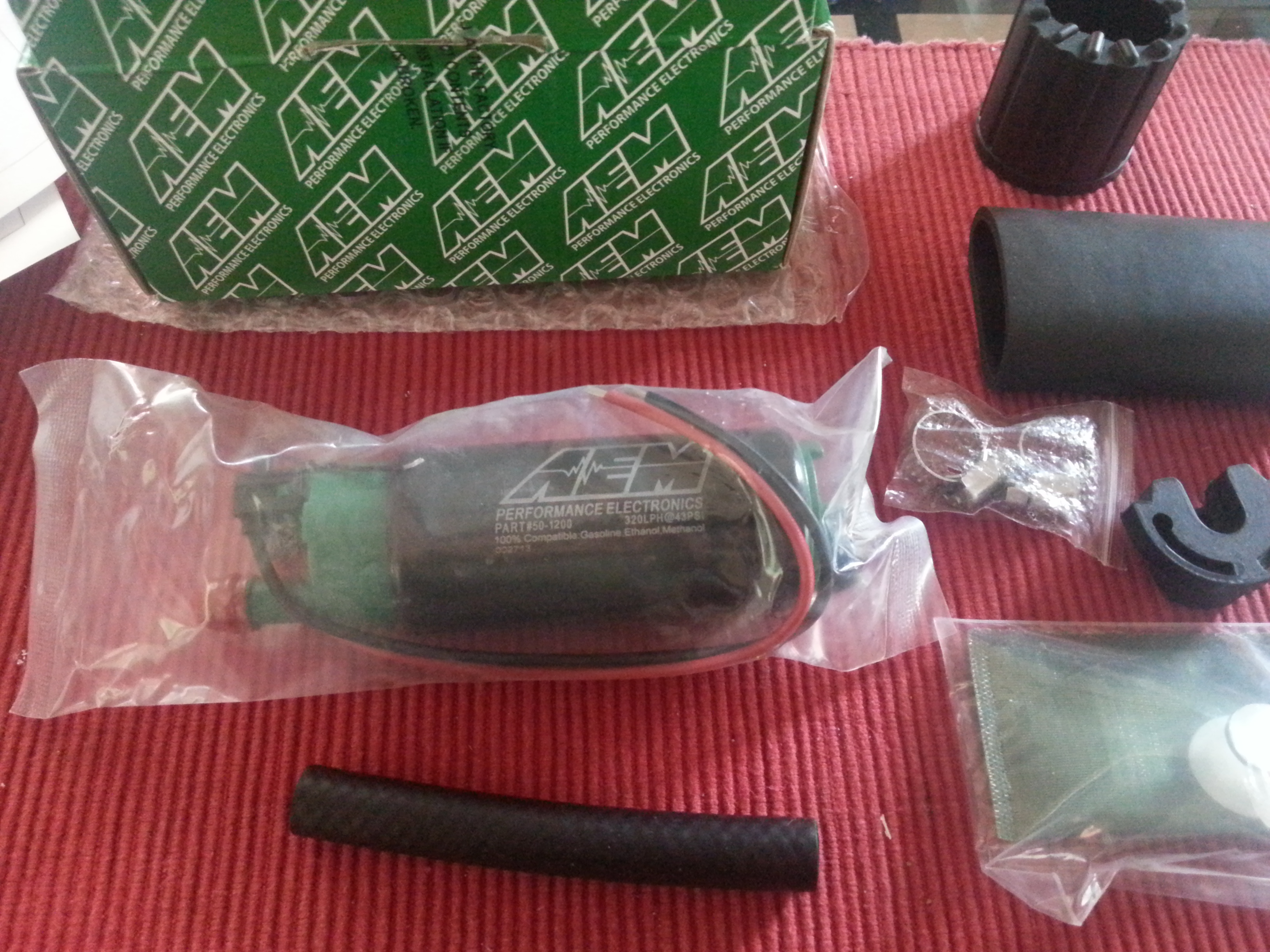

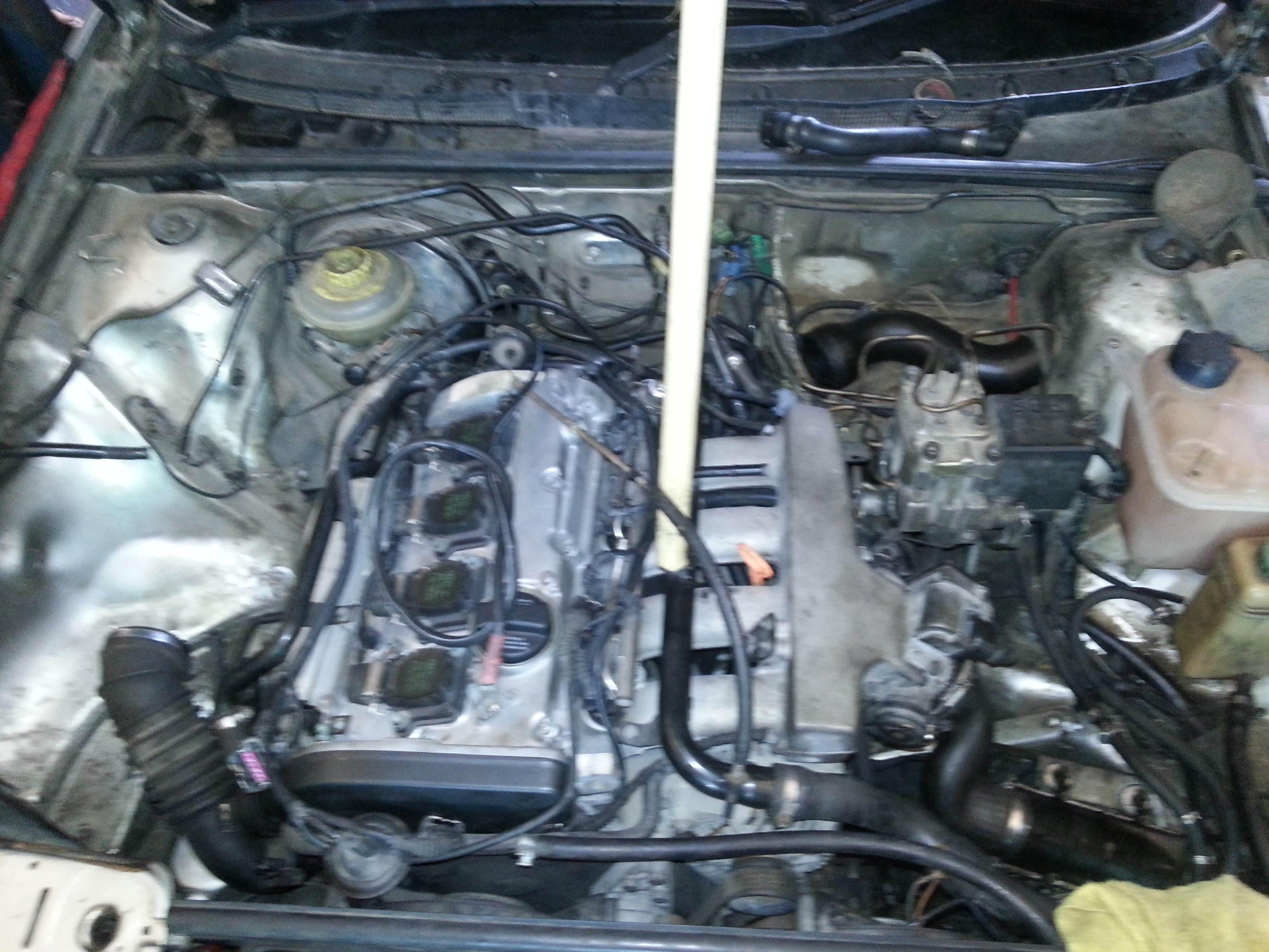

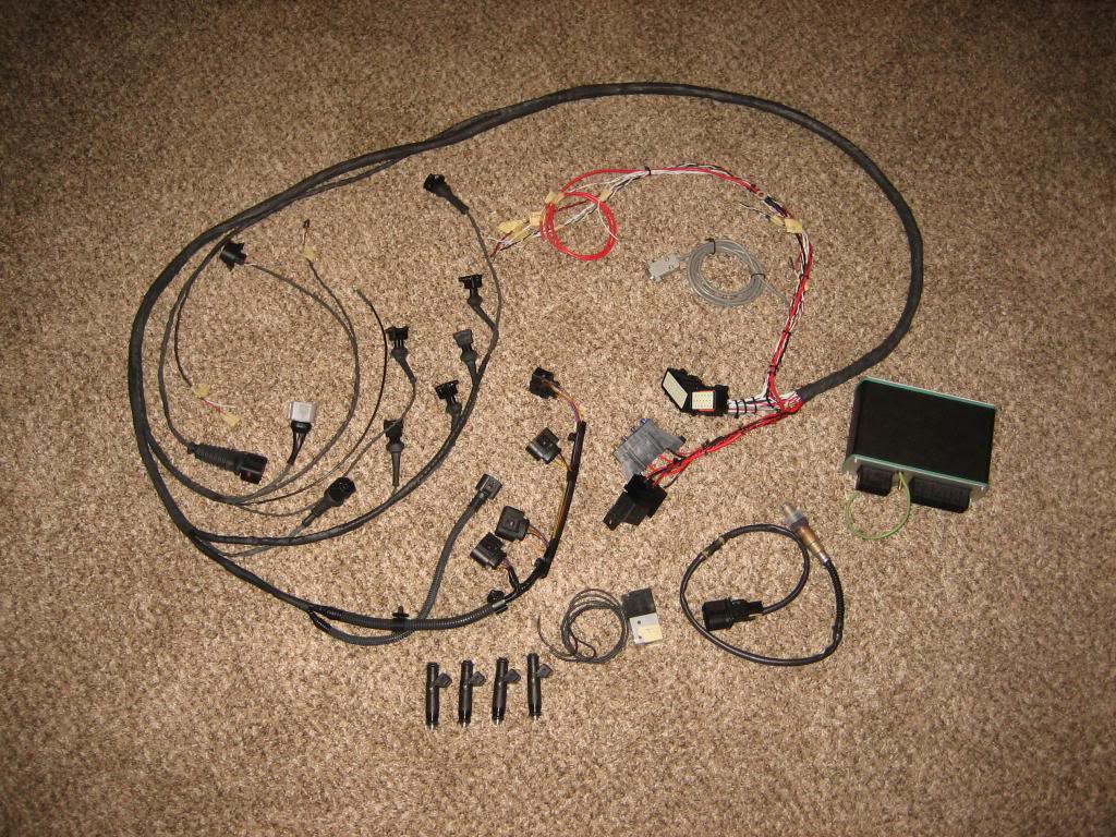

I also have an AAN SMIC and would like to use that instead of the crappy AEB SMIC. Because this car is Euro spec bumper and I don't want to buy a decent FMIC right now, anybody have a good idea how to mount the AAN SMIC? I don't mind getting it modded. Some cutting of the bumper might be needed, but that's OK.
So the set up planned is first get it running with all the stock AEB harness and ECU, later switch to wire-in VEMS and K04-015 on E85.
The VEMS system was originally bought from Lugtronic, but they did not respond to the seller email regarding updating the harness to hook up the IAC in the TB. My Audi buddy runs VEMS in his S6 and knows a fair bit about it.
If anybody happens to have an AEB, 630cc, E85 base map, with K03 or K04 turbo that would be a big help.

I dont think there is a good way to use the stock TB to control idle. I am running MS3 right now and haven't been able to find anything on it. Do you want to see what the inside of a cable driven Audi TB looks like from that era?
Id be interested in figuring out how to make it work, it just hasnt been a priority right now. Cool project!

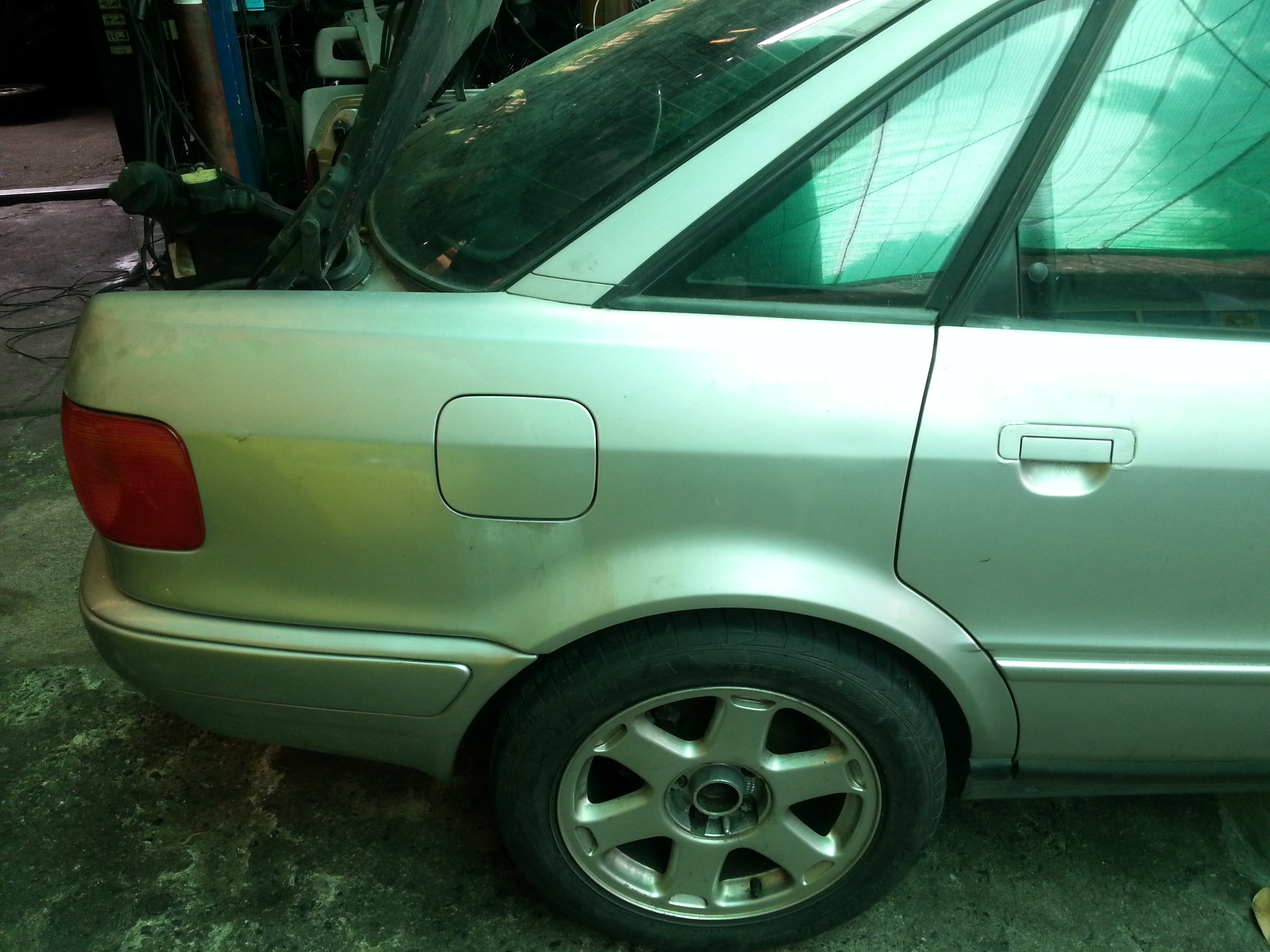

Apparently, the B5Q fuel tank fill nozzle will not line up with the B4 fill nozzle. Anybody have an idea how to fix this? I kind of want to avoid getting a fuel cell. More money.
Modifying the tank is out, since it is plastic. Can the fill door and nozzle be relocated?

I'm assuming finding a b4 quattro tank is out of the question?

In this country it is unobtainium. Importing one would very expensive. And it has to go by sea freight because it is a used fuel system.Dave wrote:I'm assuming finding a b4 quattro tank is out of the question?

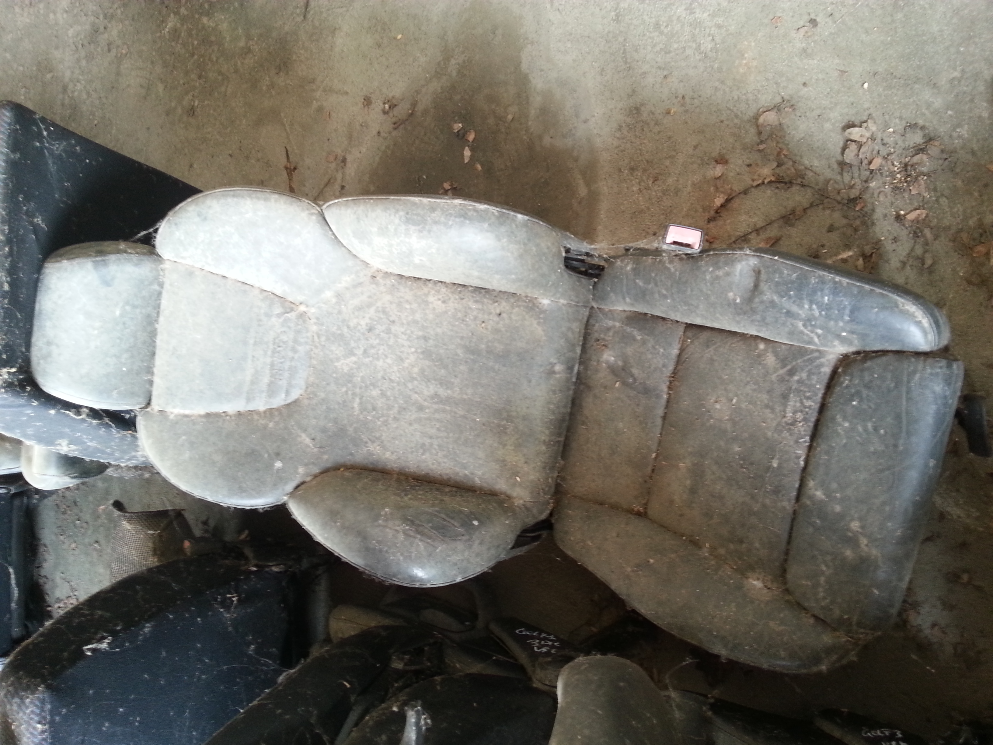

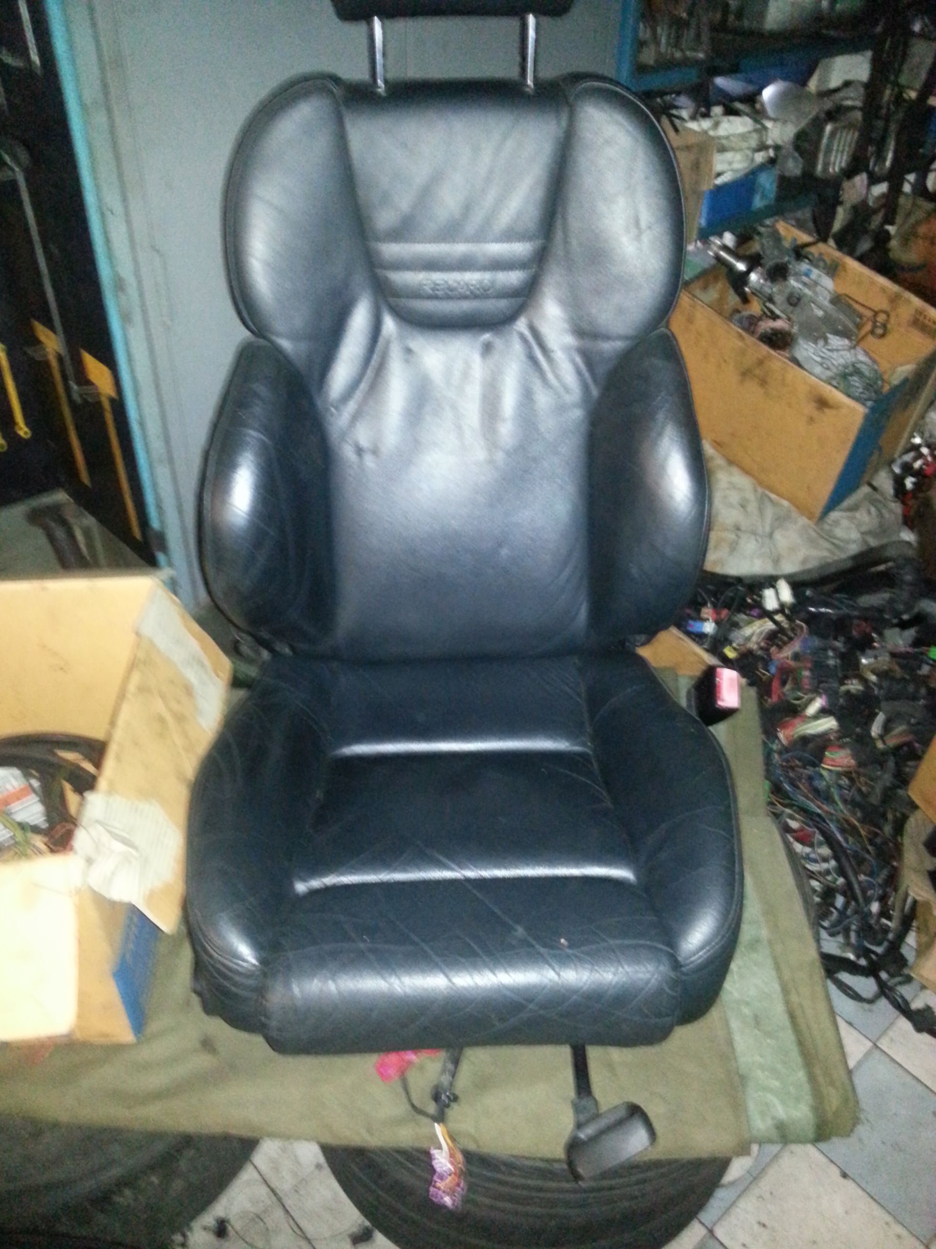

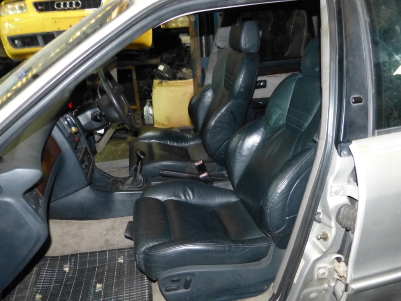

Went for a look yesterday. Talked with the guy about the fuel tank. He said we could take it t a body shop to relocate the nozzle and door.
Those seats are going be sooo good.
The engine and trans is in. Working on wiring.
PICS!
PICS!

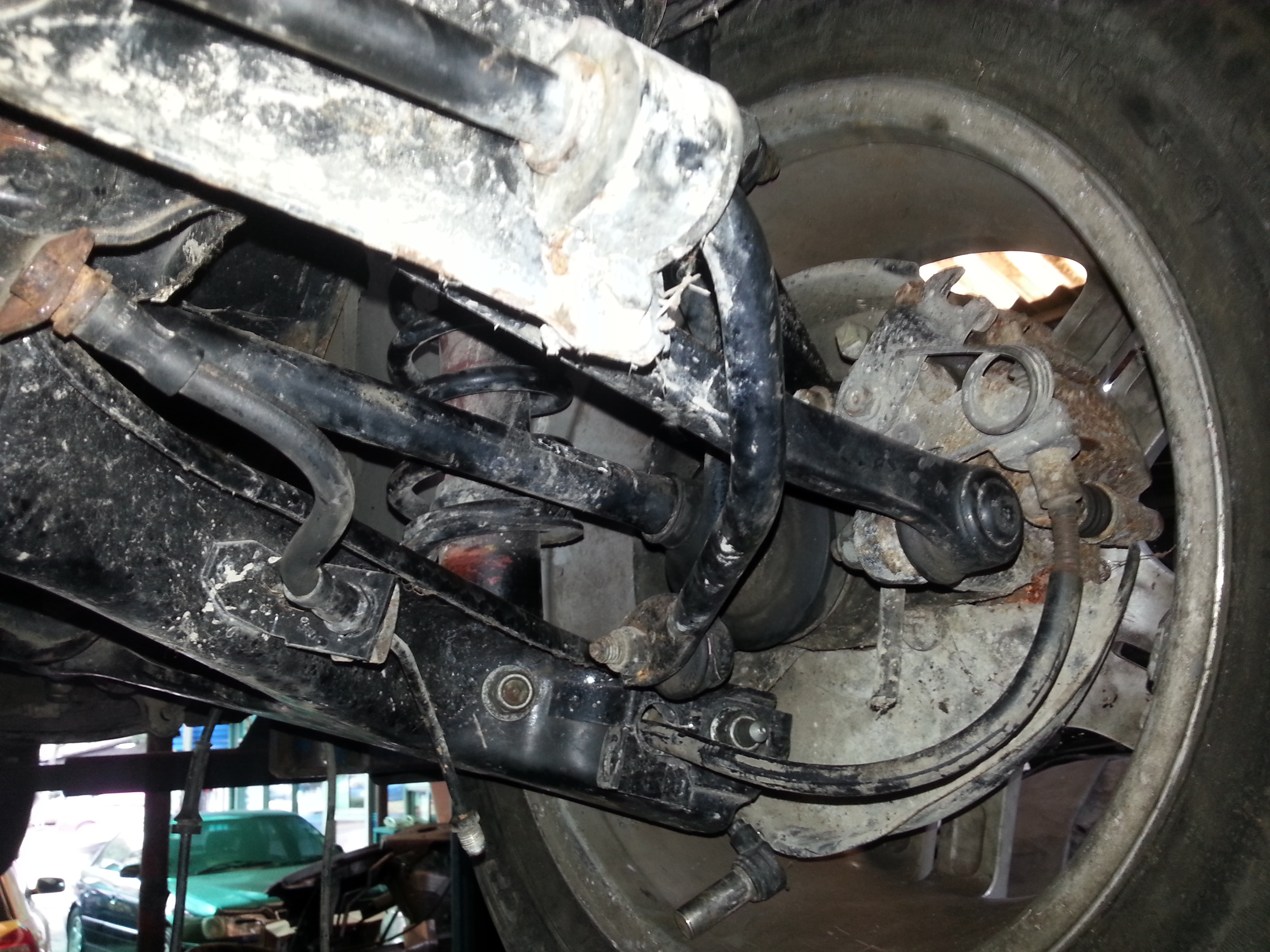

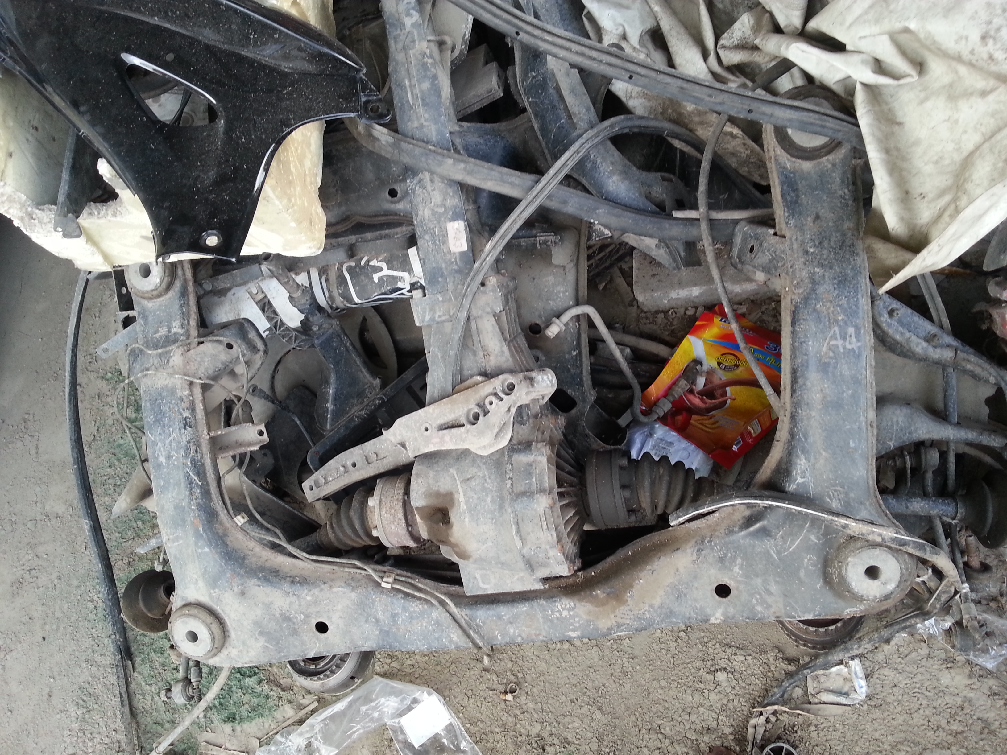

Went to check out the progress today.

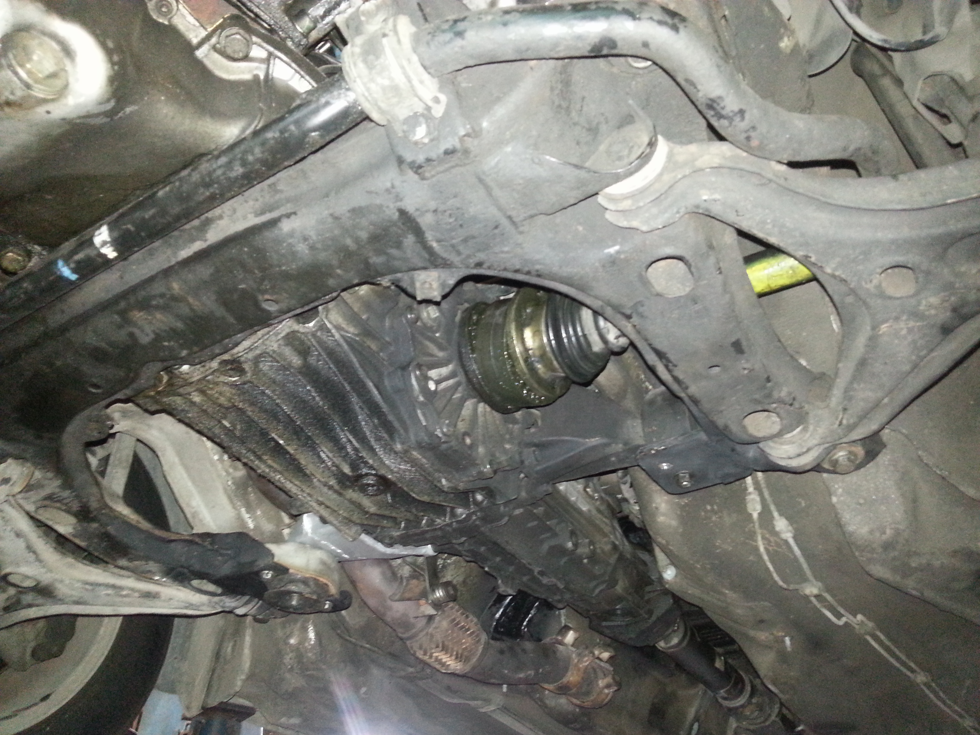

Rear subframe, rear struts and axles is in, motor and trans, driveshaft is in, IC and crossover pipe and wiring is ongoing.
They were working on making one of the front axles when I was there.
The dude I got the pedal assembly, clutch line and brake stuff from did not include the clutch MC first time around
, but that is now on the way.
Looks like I will have to go fuel cell on this after all. Will probably put it in the spare wheel well.
Would like a 70 liter tank, but we will see.
PICS

The car is now done at the shop. Just need a 2.5" DP and exhaust system and fuel tank/cell.
The 5 lug front hub conversion was done with the A6 2.3 hubs. The A3(S3?) Recaros are in! Electric seats in the B4. I heard that others here want to do the same conversion.
However, the Weitec cup kit springs on the front had to be swapped out for stockers. One of the springs is worn out. An inch shorter than the other front. WTF? Might cut a half coil off the springs.
Will post up some new pics soon after the exhaust and tank is done.

PICS
- VyqUvR.jpg (252.52 KiB) Viewed 100666 times
- 20140829_103322.jpg (2.03 MiB) Viewed 100666 times
- VnUTcI.jpg (215.46 KiB) Viewed 100666 times
- Posts: 875
- Location: Bangkok, Thailand
Re: B4 80Q AEB 5sp conversion done
I am not so sure what to do about this IC set up. Should I try to stuff a small FMIC in the front bumper (might have to cut) and lose the crossover pipe made or try to go AWIC? AWIC with HE, fan and water res?
- 20140829_103347.jpg (1.86 MiB) Viewed 100661 times
