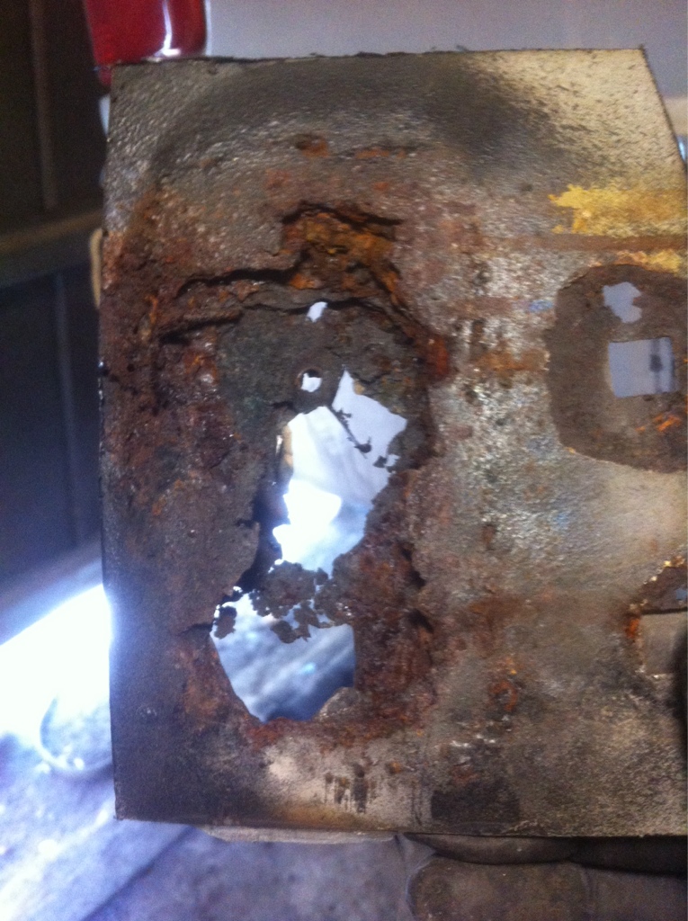

I've been plugging away slowly, I really hate body work. Found an old patch Panel today, body work done wrong.
There was rusty mig wire sticking thru the panel and a 1/4 of bondo on top, never sealed at all.

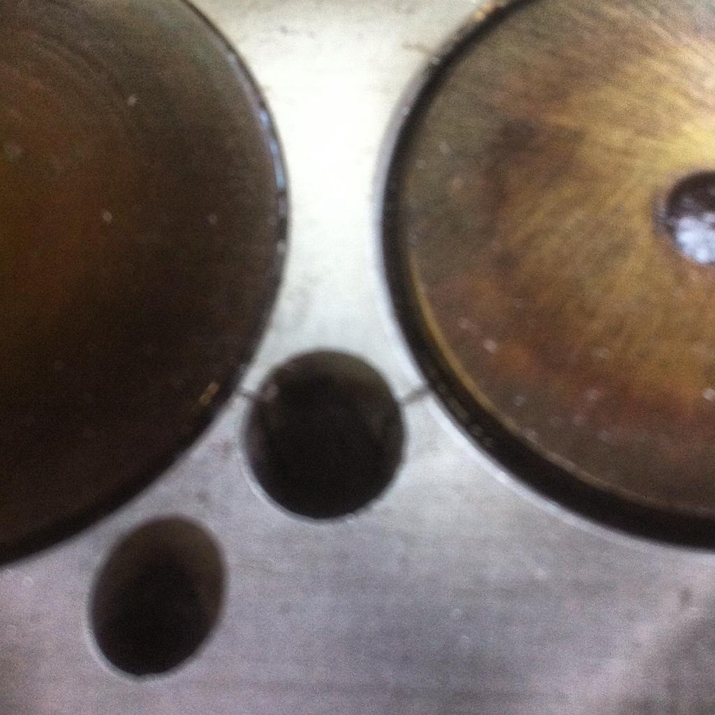

I started cleaning the head in prep for port and polish, found this.
All 4 are cracked, 1-2 are the worse I'll be pulling the valves to see if I need a head.

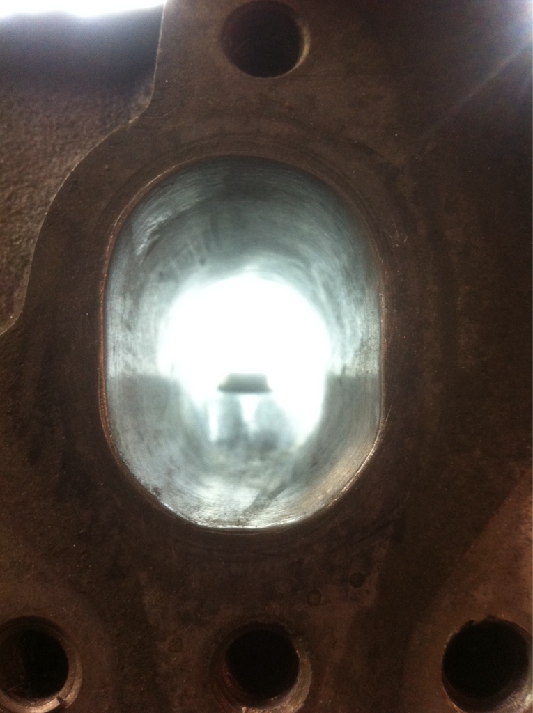

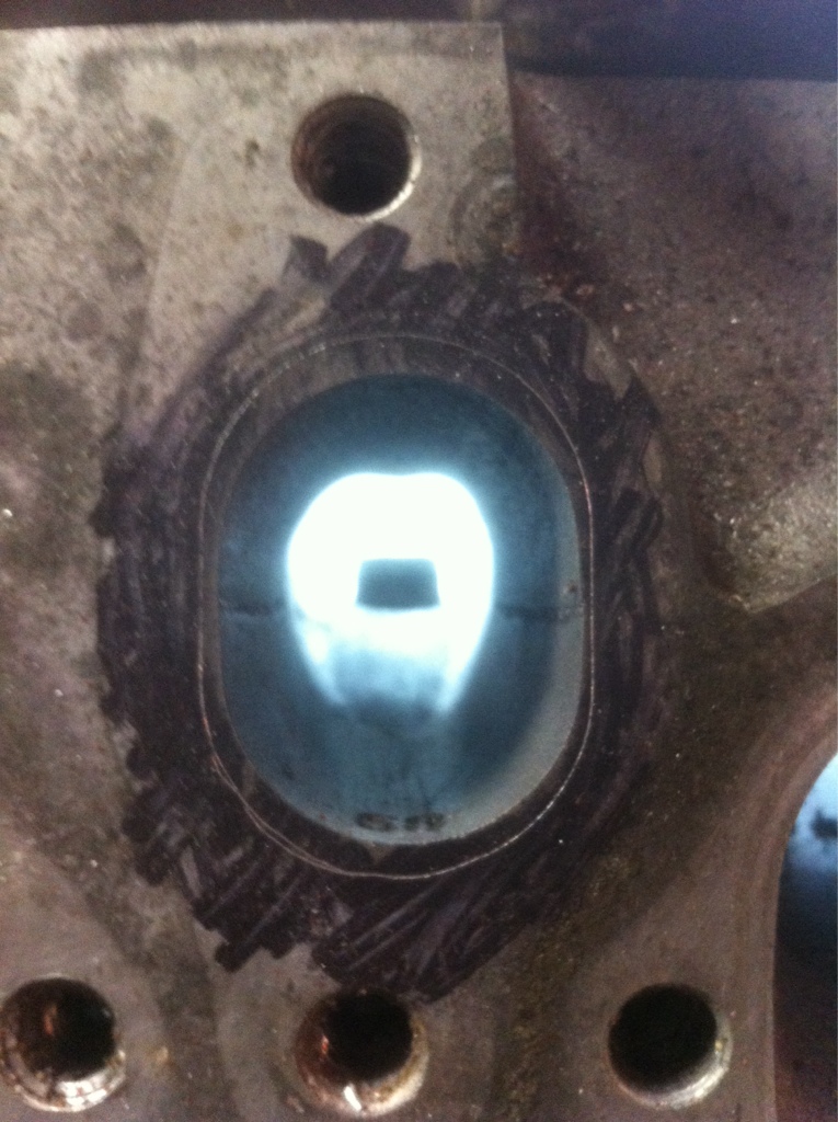

Practicing on the broken head.
Stock exhaust port
Rough gasket match lots more work to do on it.

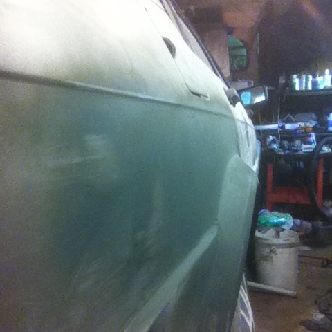

Pass quarter almost done, some detail sanding and final coat of plastic should finish it off. Next I'm going to tackle the rear pass door handle...

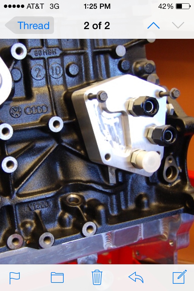

Ordered oil filter relocation plate from Ina today, it will allow me to use stock motor mount location.
Re: Steve's 86 4kqTdi
Posted: Wed Sep 10, 2014 11:38 am
by scubagli
It arrived today, very nice piece, has oil in/out, crankcase breather as well as turbo feed and oil pressure ports and a one way valve to prevent turbo feed from draining back.
