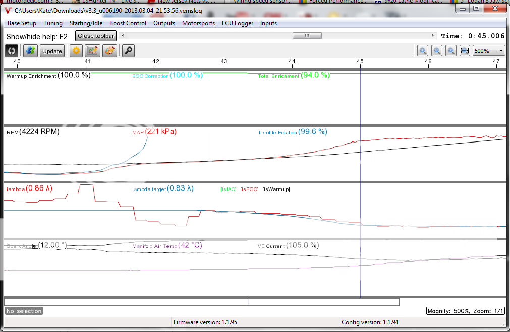

So tonight I spent the evening remote tuning with Hank and things are turning out really really nicely. This thing is pretty awesome now... well... just watch the vids, even though they are short, you'll see. :D
Sorry they where so short, I will try and get better ones here soon! OH and again, Thank you Hank! Your the man!

Does remote tuning involve tethering and remote assistant? Just curious how that's accomplished. Looks awesome though man!

I just record logs and send them off, the tuner (Hank in this case) reviews what the engine is doing and makes adjustments to the config file based off of what he sees. If I was at an actual dyno, he could watch live data over my laptop and make changes that way too.

Ok got ya. So tuning based on logs. Makes more sense then. By remote tuning, I though live tuning as-in on-the-fly or real time.

Oh, and looks hella tyte Ben. So when would you say you're getting full boost? Care to post up a screenshot of a log (roll in 3rd from 2500rpm say)?
Re: Ben's Oceanic H1C/K26 AAN 4kq - 20+ PSI >D
and 4th gear if possible (I think most people quote spool in 4th as that is what gear most people also do dyno runs with).

Thanks guys! And ya, I can post up some screen shots and such! I will do that tonight. Talking to Hank, my spool is about 400rpms behind his billet ones. So anyways, Right now my limiting factor is my clutch, so no more boost than this until that gets changed.
