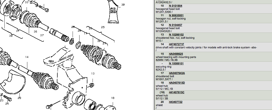

Not that this is the greatest indication but napa lists left and right identical part numbers: http://www.napaonline.com/Catalog/Resul ... 002+502999Hank wrote:You sure about that Nick?
Etka doesn't mention left of right, like it does for other models:
- Screen Shot 2013-03-08 at 2.06.52 AM.png (81.67 KiB) Viewed 24747 times
