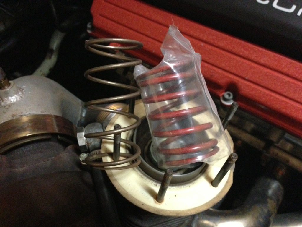

Time to wake up from your winter slumber
This should help me find more boost
