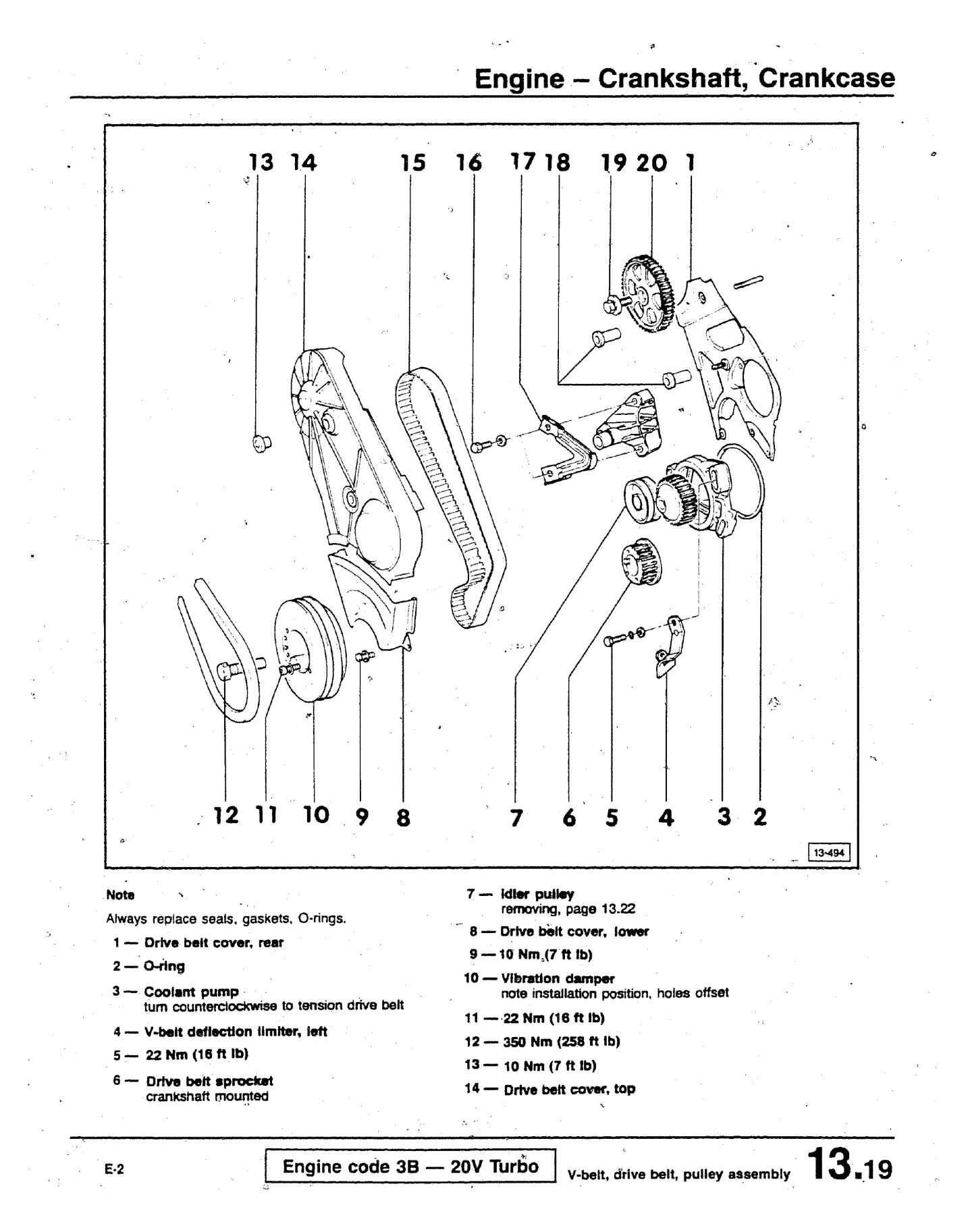

I have the timing cover off and the belt is loose AGAIN. Been having this problem since a few months after doing the belt job. Anyone thing they have a sure-fire fastener fix? 7 ft-lbs ain't jack! Maybe use copper crush washers?
Really? they call for 7 ft-lbs? I'm bad at using torque wrenches. When I tighten my water pump i probably tighten it to at least 20 ft-lbs.
Is that a bad idea? probably. Do my belts come loose? No.
I never even looked for a torque spec when I tightened the water pump. 7 lb/ft seems pretty low though.
Hah and that's for stock power levels too. I know logically that that tension only keeps the timing belt from doing exactly this, but can anyone see this affecting timing? I WILL be checking it don't worry. This weekend I think.

Chris you're saying that the three 7 ft-lb WP bolts can handle 20 ft-lbs? Maybe I'll see if the DLR has them today. I'm sure the bolts at the hardware store are a different Rockwell hardness
I never checked mine, but I'm willing to beg mine are between 12-15 lb/ft.
Ok thanks. I will do the same tonight when I get the new bolts.

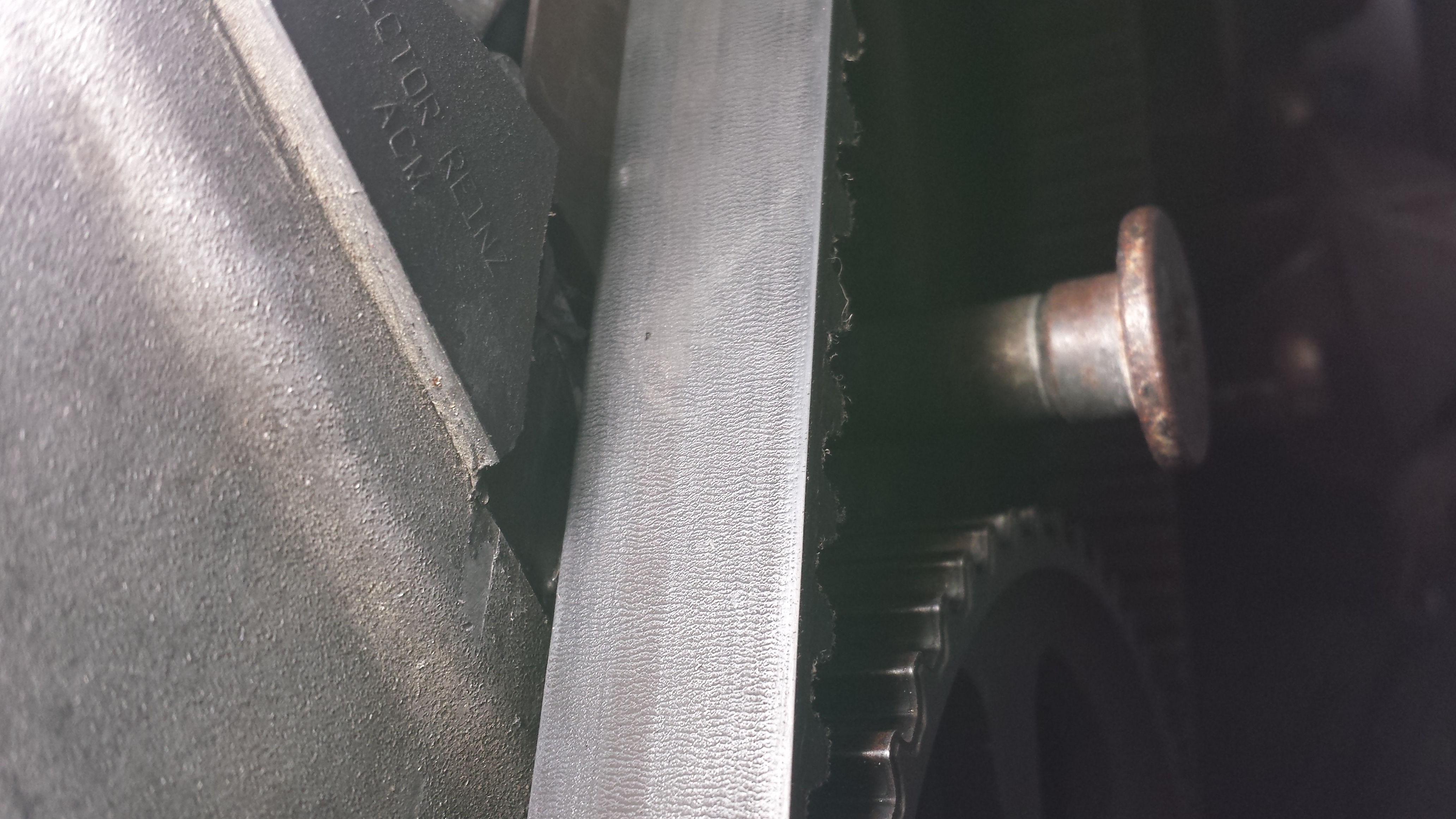

Is this wrinkly look okay?
Yes, that's a microscopic needle hole in just the surface of the T-belt.

I did 19 ft-lbs. 20 seemed tough on the bolts but they were almost 9 rated. I guess I was more worried for the threads.

And yes that wrinkly look is pretty normal.

Also, water pump torque spec is 16 ft-lb

Lol ya I had everybody up in arms with my guess of 7. I was thinking of the lower pulley protective cover. Sorry guys hahaha. If you're a harbor freight guy and gave their standard torque wrench, it's fine print says it's only accurate from 25 and up. I invested in an autozone in-lb torque wrench specifically for the lower range.

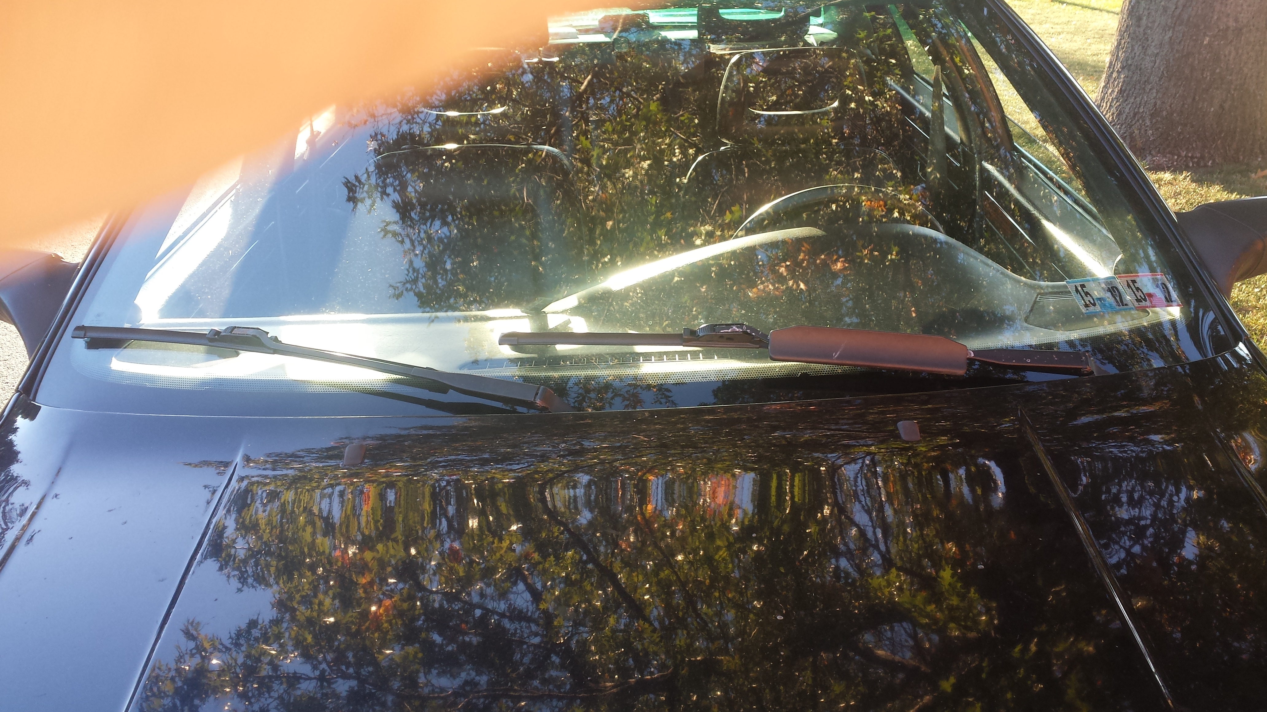

Is this about how low your guys' wiper arms are adjusted also? If I lower them anymore they get pinned under the hood. ??
My spare DS 5k arm is too low profile to even bolt in

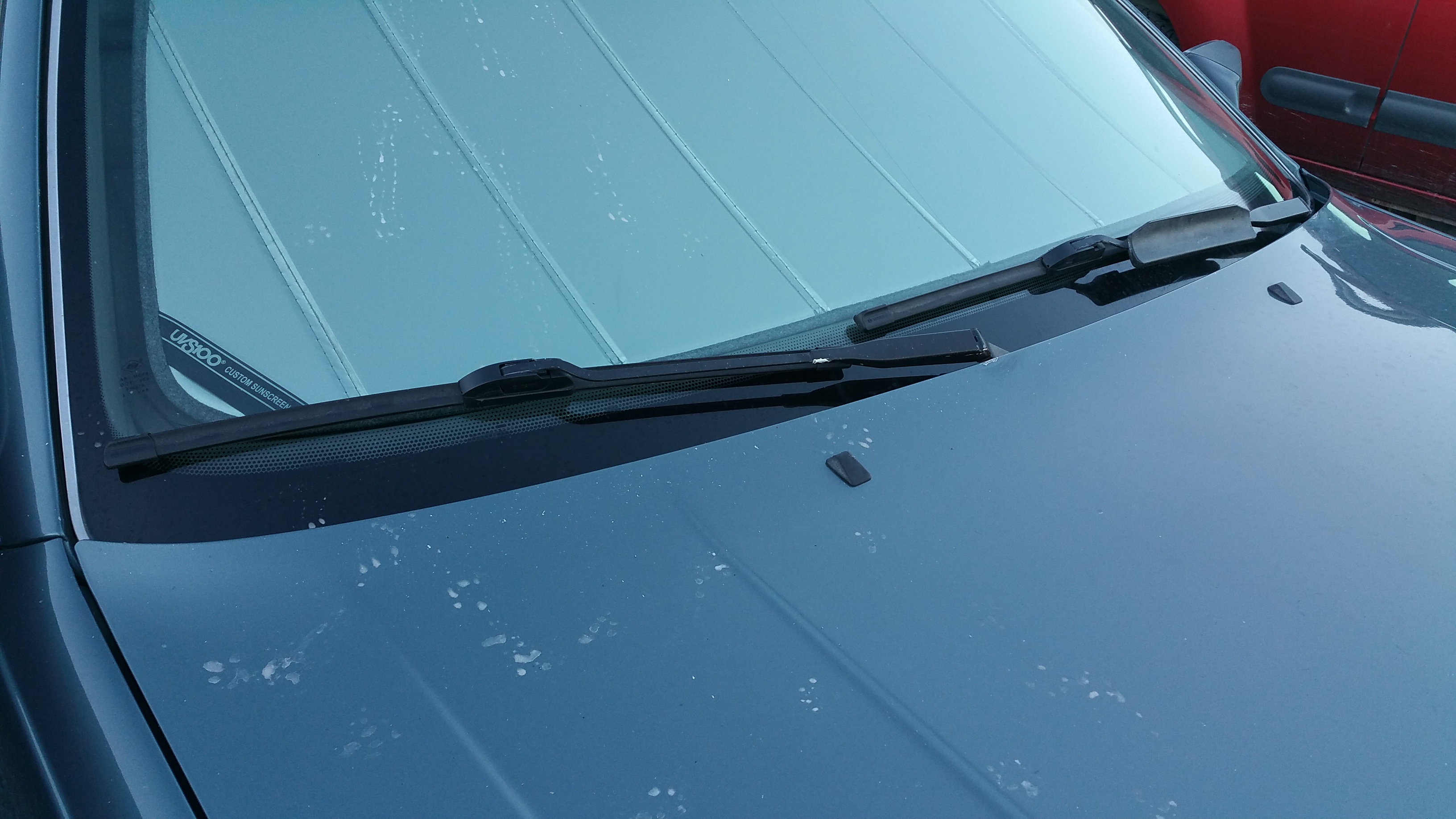

Ha, I just had to adjust mine because of the hood thing too. The Bentley shows how far they should be from the black part of the windshield. Is yours aftermarket? It looks a little different than my windshield. Anyway, I will post a picture of where mine are. (Damn the animal that got my hood dirty out at the rig!)
Here
- 20151011_183313.jpg (1.6 MiB) Viewed 25831 times
