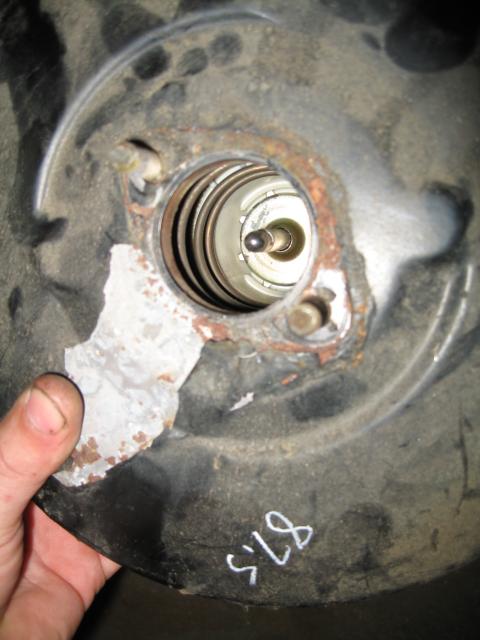

Marc
Posts: 1586
Post by Marc »
Yep. That'll do it.
"old"/not working
"new"/working
I've never stared down a vacuum booster before so wasn't sure what to expect when putting it together. I guess the answer is, one of those pointy rod thingies should really be in there... :bashtard:
Derracuda
Posts: 264
Post by Derracuda »
haha, yeah! good find :D

HT Motorsport
Posts: 350
Post by HT Motorsport »
Yup - that woudl definately do it!!!!
