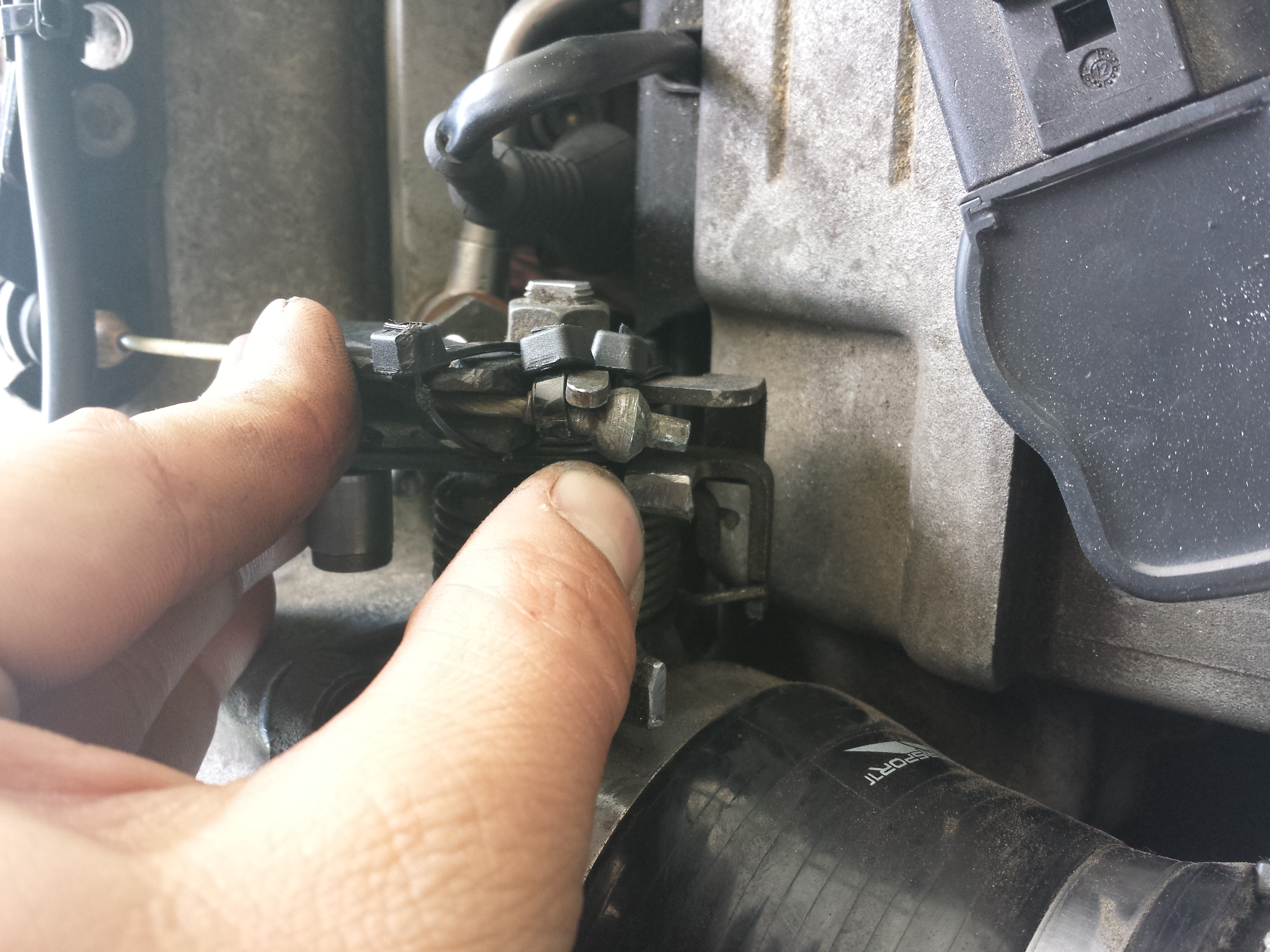

Okay since not many of you may have deleted your IAC valve on the 3b, I figured this would be interesting. I was getting a bit of a drop-off feeling in power up top and the inability to hit my target boost since removing it. I looked at my logs and saw my tps was only hitting 98 max. I adjusted it and it was a little better after seeing 99%. I decided to take like .001 off of the surface shown below and now I'm hitting 100% again.
This occurred after adjusting the throttle open slightly at rest to raise the idle with the IAC valve gone. It was apparently enough to make seeing 100% physically impossible so I had to get creative...
- Shiny surface right under my thumb nail
- 14427715693901733480483.jpg (3.76 MiB) Viewed 24604 times
It shouldn't matter if it's not exaxtly 100%... You can just adjust it in VEMS anyway lol
Oh well. Today I managed to do the driver side motor mount at least. Lol part of me wanted to ask you about that tps thing first too, Chris.
Still seems quite odd with the power feeling off at 68 F vs 74. I can't place it but it seems to have started after deleting the isv.

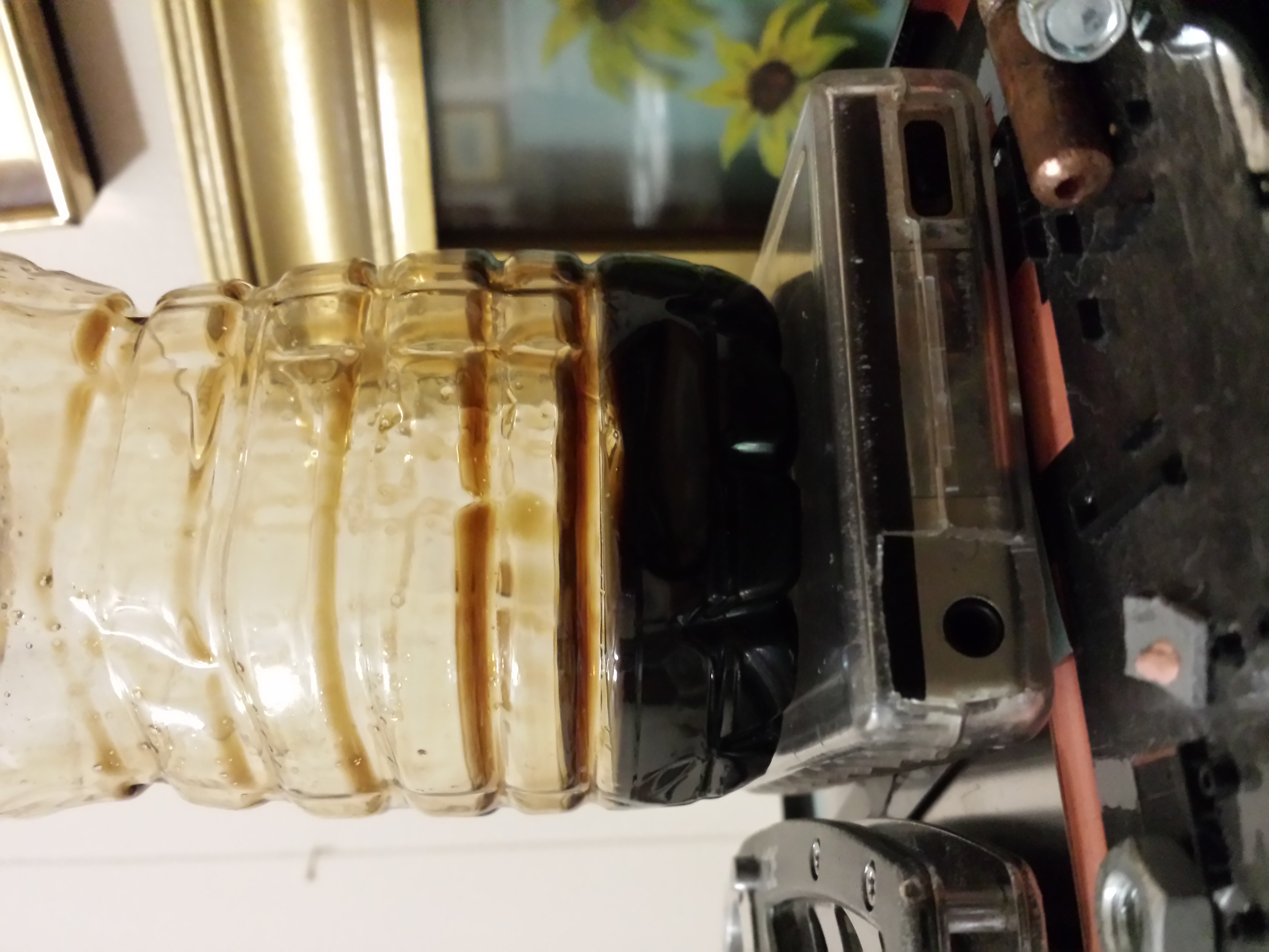

Still not ready to look any harder at this issue. I may have found a completely FULL catch can that had my entire car smelling of CC oil and shit while driving. I keep trying to figure how excess oil in the CC could cause my weird power issues. I mean I did settle the hovering rpm issue by getting 2 new bolts on those sensors but there might still be a low power scenario going on at WOT & high rpm. I reverted to my IAC tune and threw the valve back on. Strange getting used to driving with it on there in traffic.
Maybe ill change my plugs for kicks tomorrow and take a look under the hood again. I had a panic attack nearly when I started thinking maybe my clutch was slipping lol. I also will try venting the CC in case theres massive blowby or something crazy behind all this weirdness. Shit my birthday is the 27th and I hate when my cars are f#cked up for it lol
I just checked my catch can vac tube off the intake and I put my finger in it to plug it while revving the motor in neutral (of course lol). I got ZERO vacuum off of it. I need a better place to tap into besides right before the huge k&n.
What prompted me to test the vacuum was I cleaned the CC with brake cleaner and left it vented. Then when I saw steam coming from there with the hood closed I began to panic
because I wasn't sure if it was exhaust or steam which was likely exaggerated by my hard pull right before that and using w/m all the time. When I put it back on the intake tap point I checked vac. IVE always suspected it wasn't doing shit there!
Have you ever done a comp. test? That's a lot of blow by to fill that can.
I agree. I could swear I did the test on 3 separate occasions. I remember once when I bought the car (below zero out and no oil in cyls., all between 170 and 215 psi) and again before blowing the HG. I thought I'd done it again since the head came off but the last time the numbers were between 160 and 180 IIRC. Seemed "stellar" to me at the time
I don't think I want to know what the #s are right now hah. I haven't had anything bad happen since those tests besides the HG going out. I use great oil and it's never looked bad on the dipstick. I even started using a magnetic drain plug. Even talking about it being a problem is making me sick.
Isn't it true that the rings could stand to benefit from a higher vacuum on the crank? Better seal and such? I really need to get that worked out.

This is how much oil was in the CC tonight after 2 days and heavy abuse in 1st through 3rd gears.
Things I've noticed:
First gear usually pulls quite hard all the way through.
Seems better when coolant temp is down to the 1/4 mark.
Low MAT seems to improve the issue.
Rpm's below 5k pull really well. Good power.
All low power symptoms occur above ~5500 rpm I believe and in 3rd gear IIRC.
Is this the rings? I will do a compression test on my birthday
