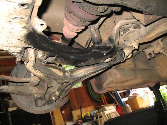

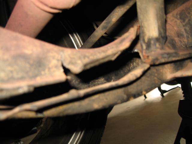

anybody seen this happen to an audi rear subframe on a non-rally car???
Looks like the spot welds busted open and it just started opening like a tin can :-o
I had some new rear tie rods to put in so I welded it shut and painted it up while I was in there, as well as seam welded the other side for good measure...
I need to take the subframe down later anyway once my suspension arrives to do the subframe bushings so I'll powdercoat it at that point..
yikes.
a_CQ
Post by a_CQ »
Hmmm, should of welded mine when it was out last year. I'll be watching it.
owdlvr
Post by owdlvr »
Seems to be more common the coupes for some reason.
Weird that I've never split one...knocks on desk...
-Dave
Corey
Post by Corey »
Very often :tard:
on Torsen/turbo equipped cars. It is to do with the twisting motion, all high bhp ones we do require seam welding to prevent this.
