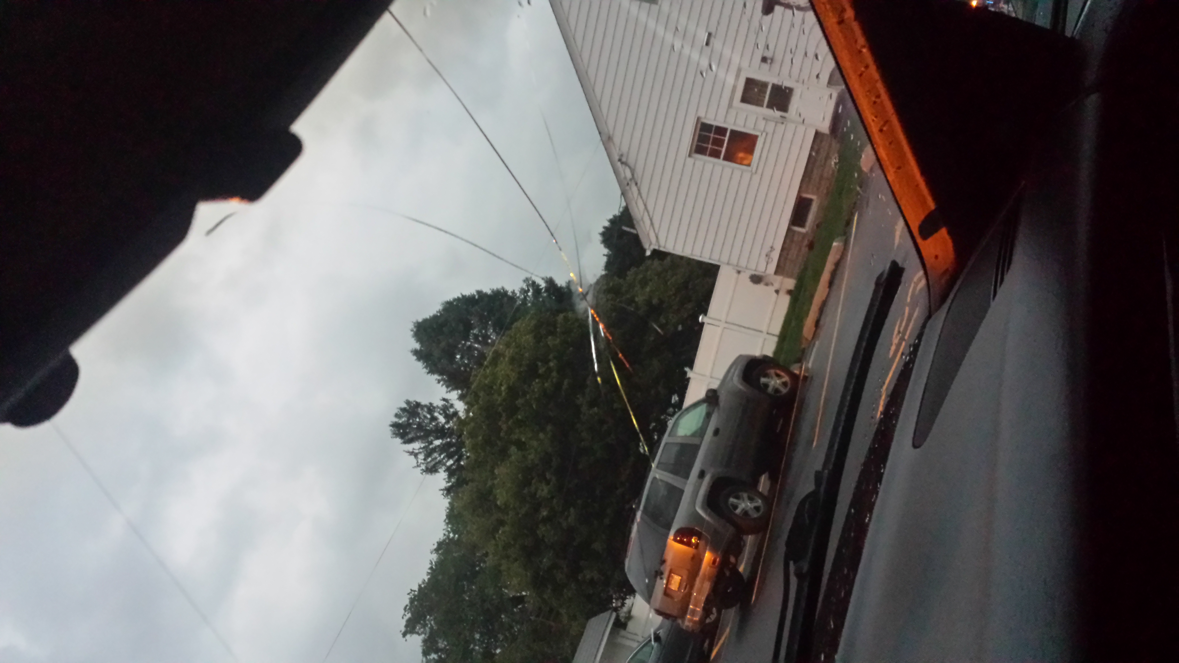

Everything all the time... my cell bill is due in 4 days, I need gas, I didn't put the 5k's shifter back in, it's freakin battery is f#cked even with it being on a float charger for a month lol, my data plan only has 100 mb left until Sept 7th bahaha, and my insurance payment is due on the 5k end of month.
Heartbreak is all relative
Heartbreak is all relative1991 Audi 200q Holset
When it rains, it poor's! I'd say your about flooded out!
I was nitpicking on those things. At least they're routine problems.
Now for the potatoes of this whole thing. Am I going to have to search the earth for a replacement windshield? NLA?
Safelite had one in their warehouse. Everyone in the office that heard the p/n asked "wth is that for?" Lucky me

Now I'm ju$t concerned about whether my chrome accent around the glass will be salvageable. BTDT's?
