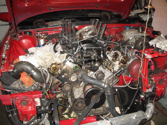

Pulled the front end apart on the v8 last night to get to the bottom of a nagging issue regarding the tensioner for the serpentine belt. The belt squeals under load from the alternator and I've discovered that the reason is because the tensioning arm isn't tightening up like it should.

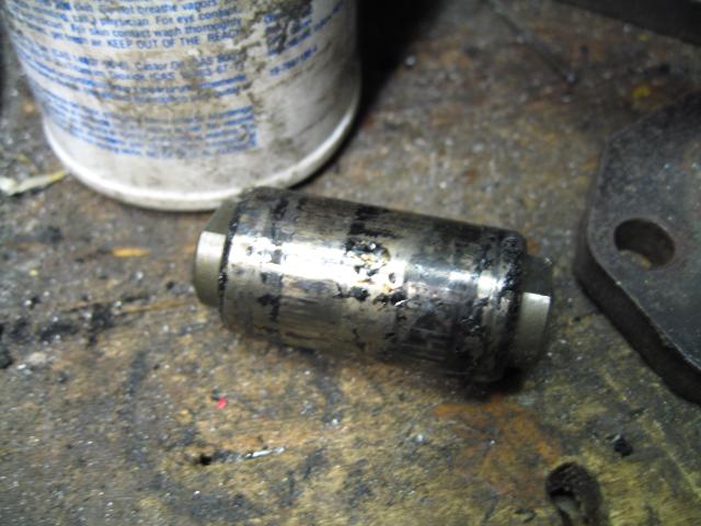

Further investigation reveals that you can disassemble the mechanism leaving two needle bearings inside the TB cover that a little keyed cylinder is supposed to ride on. Those two bearings are seized on both my covers and a spare cover I got from Haydn (thanks!). Anybody BTDT? Part number? Etka only shows a full replacement TB cover :(

So the problem isn't the tensioner damper shock? I've been through that twice now.
But
a break down CAN be found on the ETKA.....illustration 152-10.

But from the pic he posted of the front of the motor I still think it's a tensioner damper....it looks all rusty, & such. But he's got it in front of him...& if he says it's the bearings...then it must be the bearings.

pics of those bearings I mentioned before:
and the corroded bit that is supposed to roll in the middle
I've got "while I'm in there" itis:
Decided to do the cam seals as I had a nasty oil leak coming from that area.

Ok, more on the serpentine belt saga. After fixing the bearings and getting the new $$ timing belt parts on (tensioner shock, $30 adjuster plastic bushing, etc) and timing the cams up I discovered that at the limit of adjustment the serp. belt was still too loose.
I called Napa and they only had a belt that was an inch shorter, nothing inbetween. I went out and bought it anyway but of course I needed something about .5" shorter :(
So after sitting and staring at the front of the car for about half an hour I finally decided on modifying the pivot arm to get the job done. I had a spare arm from the timing belt cover I got from Haydn (:thanks:). I welded more steel onto the bottom portion to provide plenty of meat for the threads I was going to need and I drilled a new hole for the tensioning roller that was ever so slightly further away from the radial arc of the pivot bolt.
Naturally I didn't get it on the first try, but after a second attempt its right where I want it. Everything goes back together tomorrow :woowoo:
