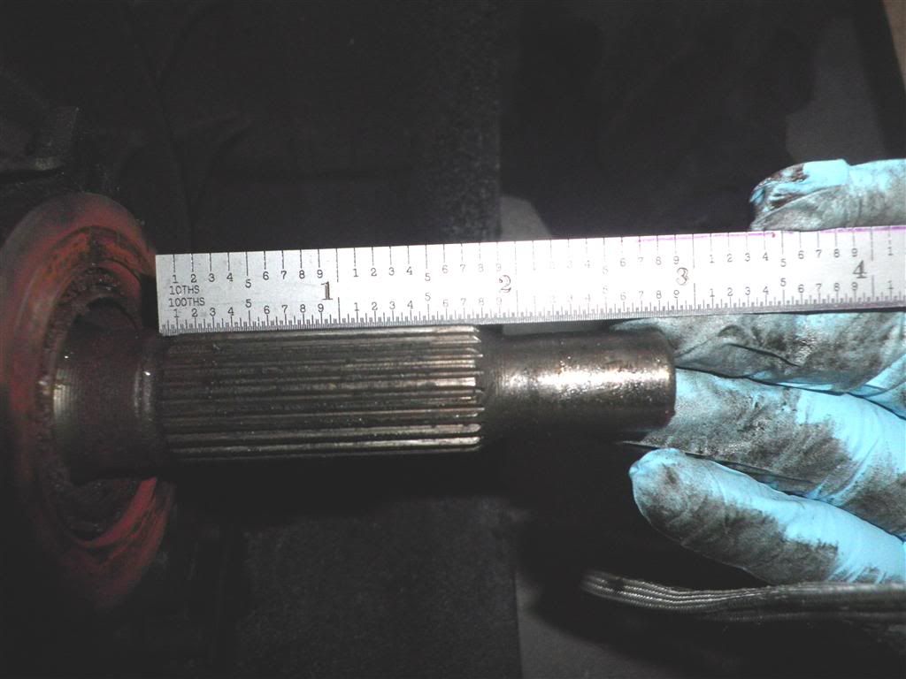

The machined side of the hub faces the tyranny. The input shaft isn't splined far enough to not bottom out on the hub so as bolts are tightened it pushes the hub towards the flywheel distorting the disc in the process. The spec flywheel side sticker is still on the other side so its installed correct.

A potential clue to the mystery...

If it's any help my setup is flat flywheel, southbend clutch & pressure plate for the flat flywheel, urq 016 trans, urq throwout fork and bearing. Input from the local CO urq guys said the t/o bearing needs to match the transmission. I had a 91 200 t/o bearing and fork along side the urq parts and they were different. Sorry but I didn't take measurements. I think you will have this one figured out quickly.

Thanks for the input guys. I'll have to do some measuring and comparing tomorrow and see what I've got.
Chris, Thanks for the picture. I'll have to see what the Urq 016 length is. Measuring from the bottom of the pilot hole out to the outside edge of the disc hub is ~3 1/8", but I doubt if the shaft bottoms out in the hole so your picture might be just about right. Question though.....you like those blue gloves? I only use white gloves if anything.

dbldmnd wrote:If it's any help my setup is flat flywheel, southbend clutch & pressure plate for the flat flywheel, urq 016 trans, urq throwout fork and bearing. Input from the local CO urq guys said the t/o bearing needs to match the transmission. I had a 91 200 t/o bearing and fork along side the urq parts and they were different. Sorry but I didn't take measurements. I think you will have this one figured out quickly.
Agreed.
The throw out bearing and arm is completely different on torsen cars (MC2 and 3B, read flat flywheels)
as opposed to non torsen cars (Ur-q and MC1, read dished flywheels)...
my feeling is that you need a new style arm and throw out bearing.
Hope this helps in some way.

I'm sure Martin will correct if I'm wrong, but I think the way the parts match up regardless of the flywheel/clutch:
016 locker -> urq t/o bearing and fork
016 torsen -> torsen t/o bearing and fork
You do need the correct pilot bearing for the trans, I remember needing to get an urq pilot bearing because the 20vt pilot bearing didn't fit the end of the 016 locker main shaft.
Re: Her Mars Red 83 Urq ..Tranny is out for inspection.
That is pretty much how I thought it should work. I kept the Urq arm and throwout bearing. Since my block and crank were out of an AAN the the crank didn't even have a pilot bearing in it. It has to be the smaller pilot to match the 016 input shaft. Thanks for the input.

dbldmnd wrote:I'm sure Martin will correct if I'm wrong, but I think the way the parts match up regardless of the flywheel/clutch:
Actually I think it's more dependant on the flywheel/clutch you use.
Flat flywheel, use torsen fork/to bearig
Dished flywheel use locker fork/to bearing.
Mike H had MC2/3B flywheel/clutch in his Ur-q with locker 016 and had used the matching fork/to bearing (new style) with good result.
He just wanted the WX to rev up quicker..
I also used that setup on the 7A 4kq... locker gearbox, 3B flywheel and clutch with new style fork/to bearing.
HTH

Datapoint FYI - my setup:
3B motor
016 locker transmission
3B flywheel
3B Southbend clutch
016 locker clutch fork (urq/5kcstq)
016 locker t/o bearing (urq/5kcstq)
016 locker pilot bearing (urq/assume same as 5ktcsq)
I've used this setup on both the original urq locker transmission and, ahem, a few 5ktcsq boxes.

Well just to confuse things a little more, let me throw in another data point.
My setup is AAN engine, 3B FW + disc + PP, 016 locker (code AGD from a 5000 quattro) and the correct fork & release bearing for the transmission.
The setup absolutely works - there are no shifting issues and the clutch holds with 20 PSI boost. But... the clutch engages with the pedal *very* high off the floor. It's drivable but definitely doesn't seem right.
The funny thing is it originally wasn't so bad, but recently I replaced all the worn-out hardware that was causing a ton of slop between the master cylinder and the pedal, and that made things worse! :(
