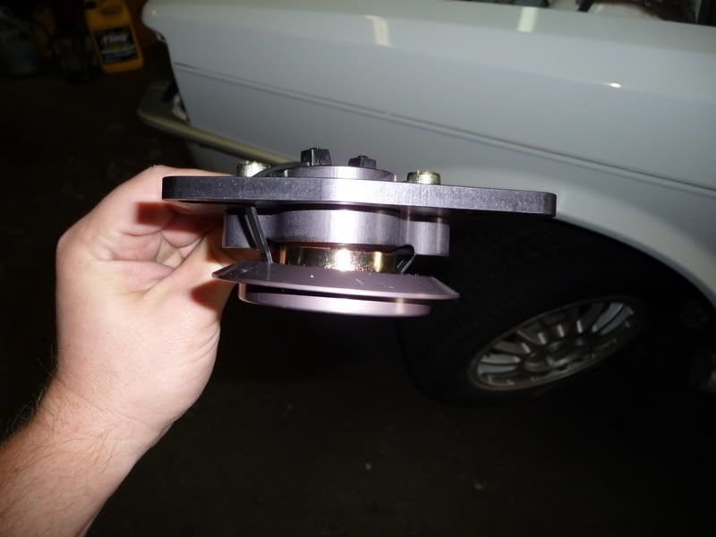

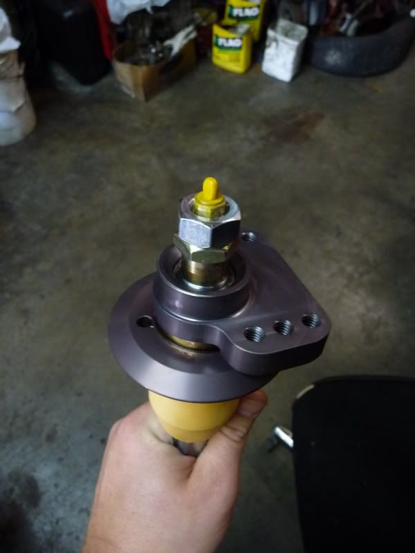

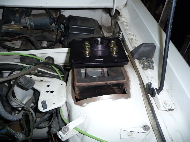

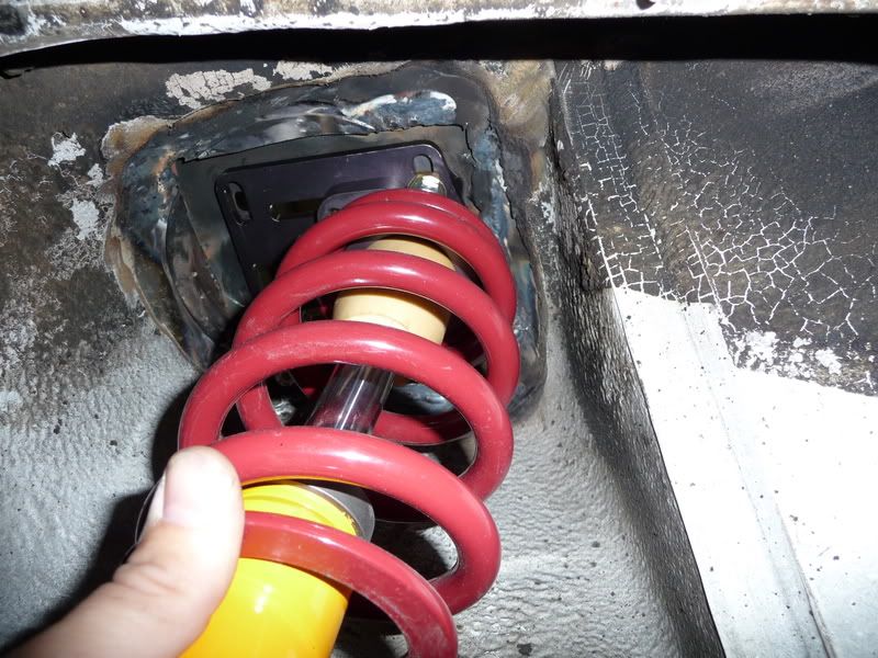

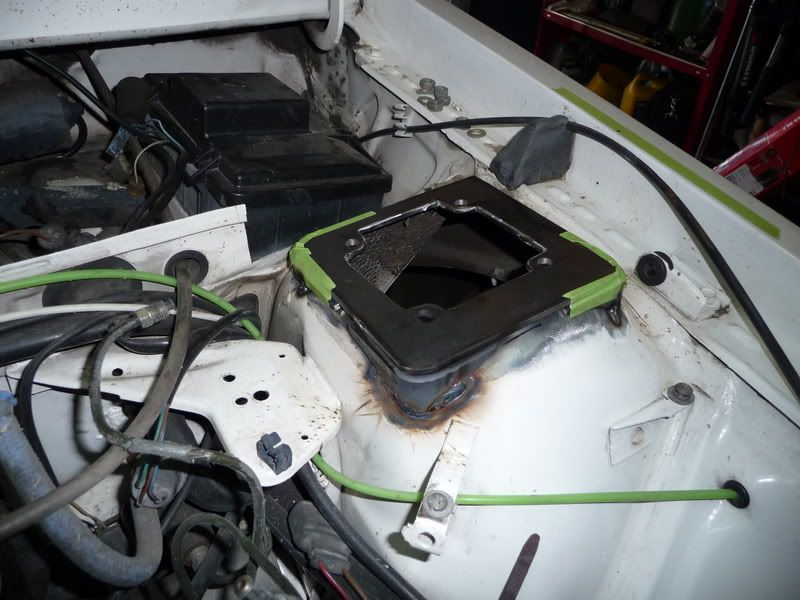

time for another little update. i've been super busy over the summer and my trips to CA have been short, so hence little to no work on the car. i got tired of looking at my upper strut mounts unfinished, and not as adjustable as i'd like... so i went and bought some ground control camber plates and went to town.
started off with this...
these are the new toys

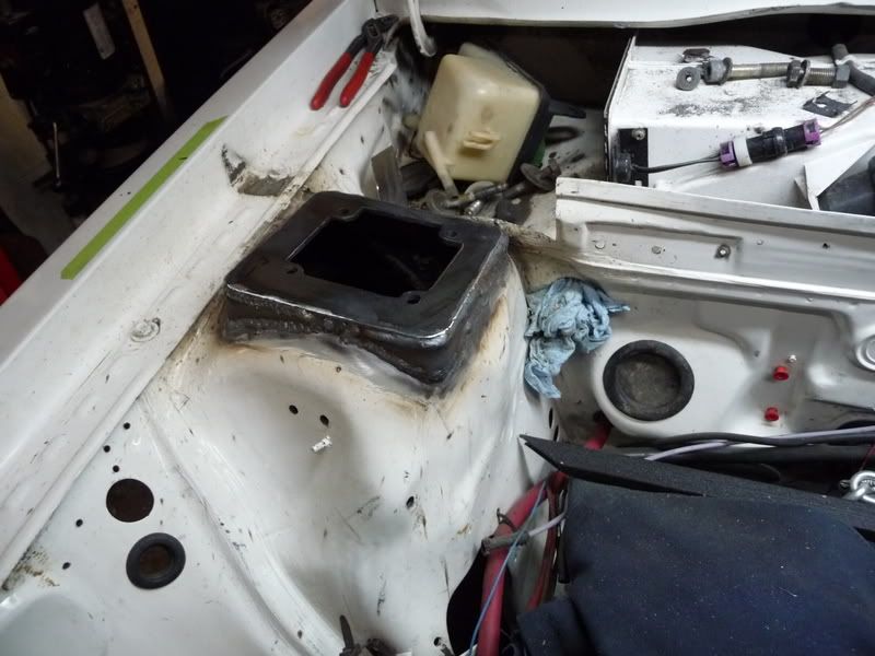

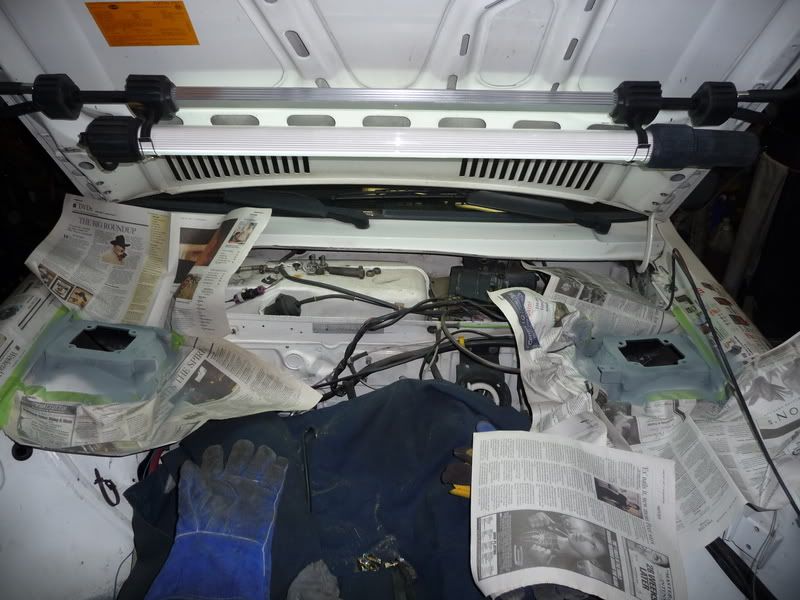

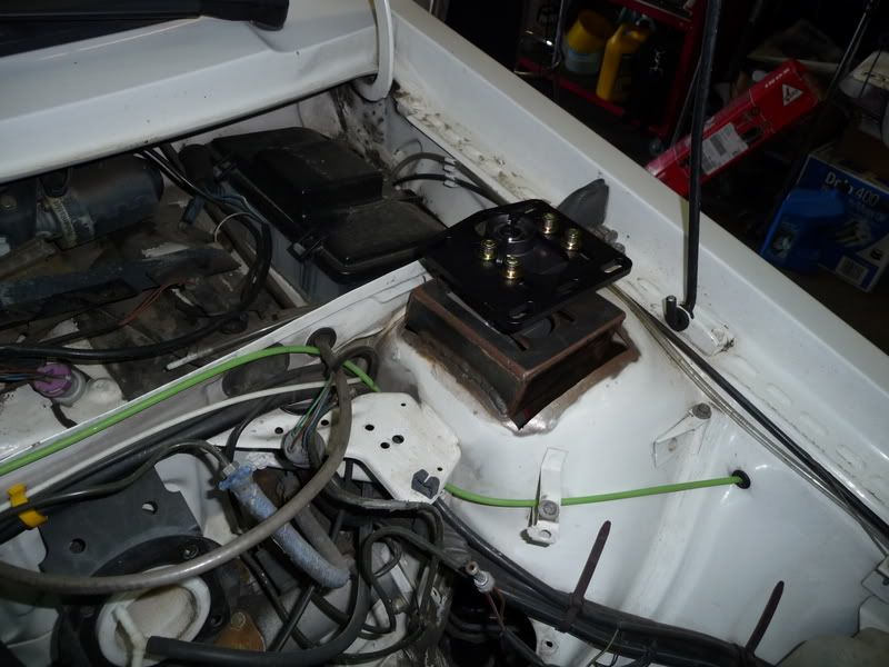

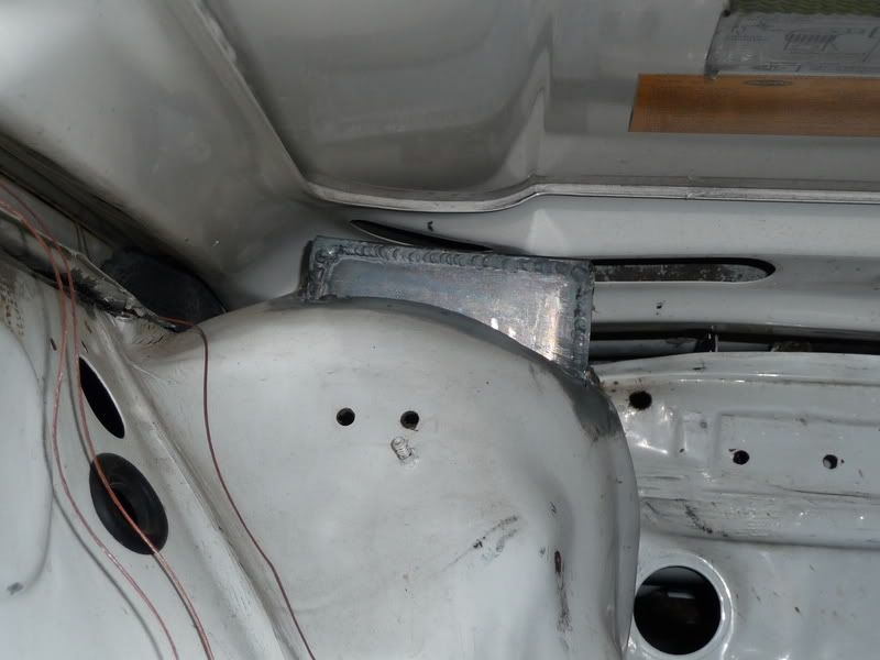

i started off by cutting the old plates i made out and made new mounting plates for the camber/castor plates
they sit a bit lower than the old setup, but it's a bit thinner, and with the shorter shocks, i'm not worried about it
comparison

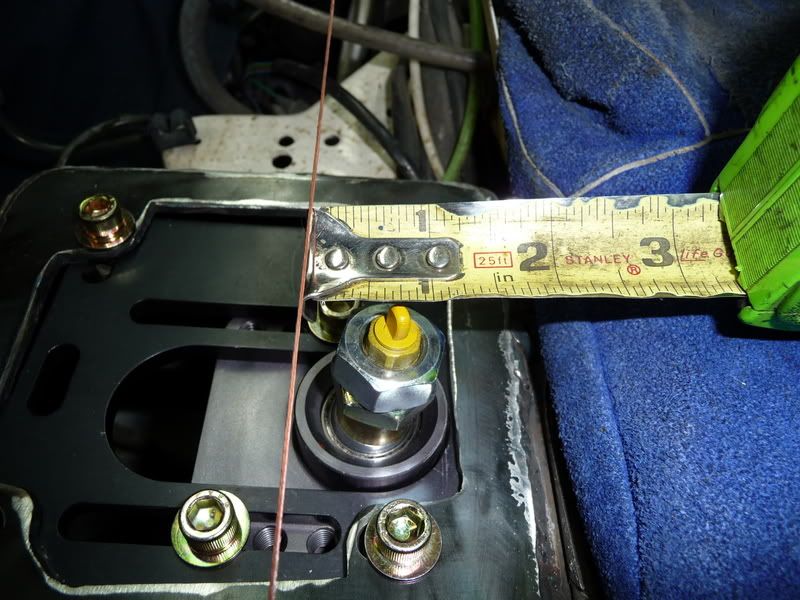

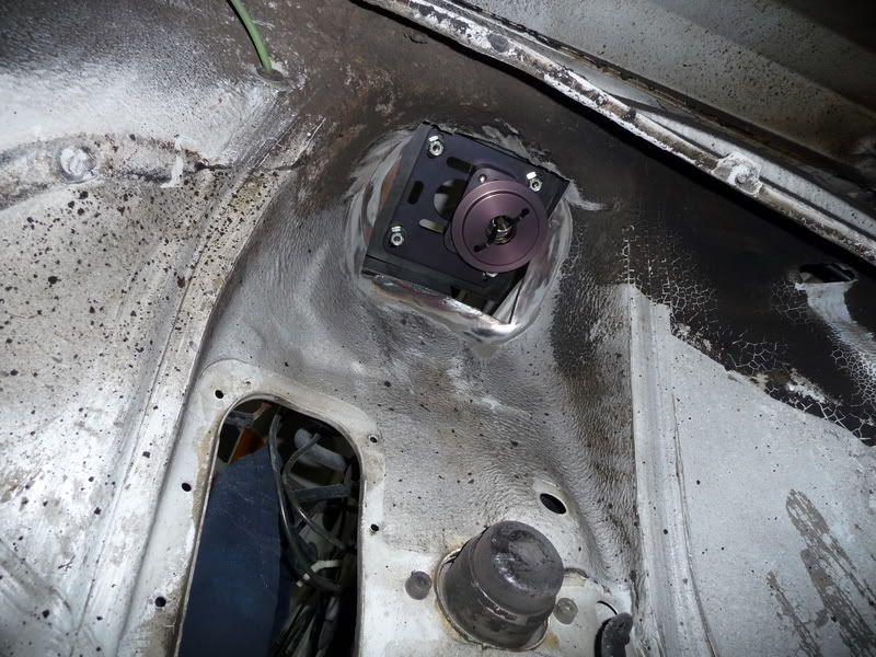

i also gained another 3/4" of rearward movement to add to my castor 8)
this makes for a total of 2.5" rearward movement of the strut tops.

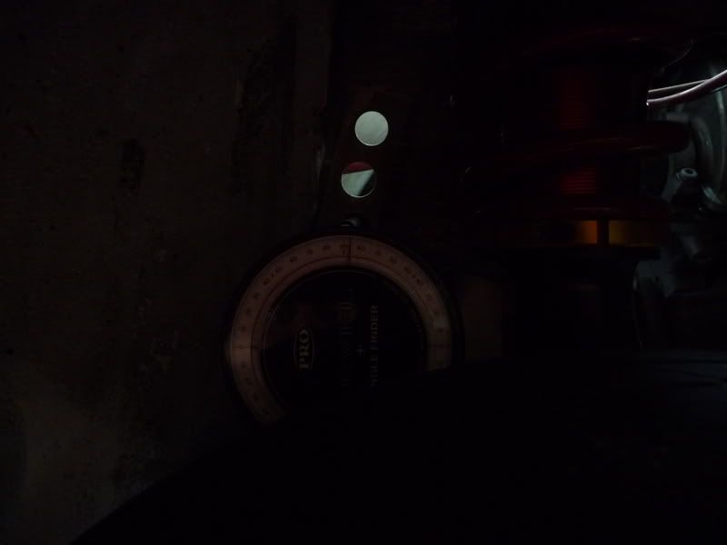

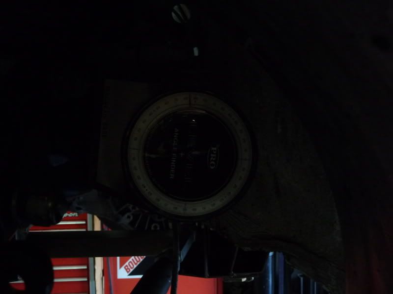

it was hard taking some of the castor measurements outside with the angle of the driveway, but now i'm flat, so... static castor i'm up to 6degrees.
it was at 4degrees with the other plate setup
getting there...

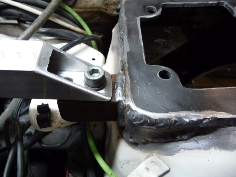

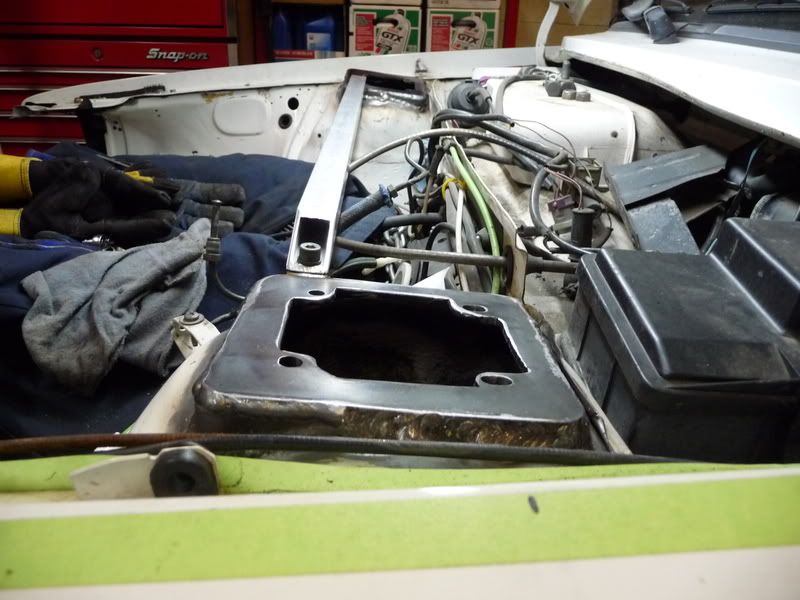

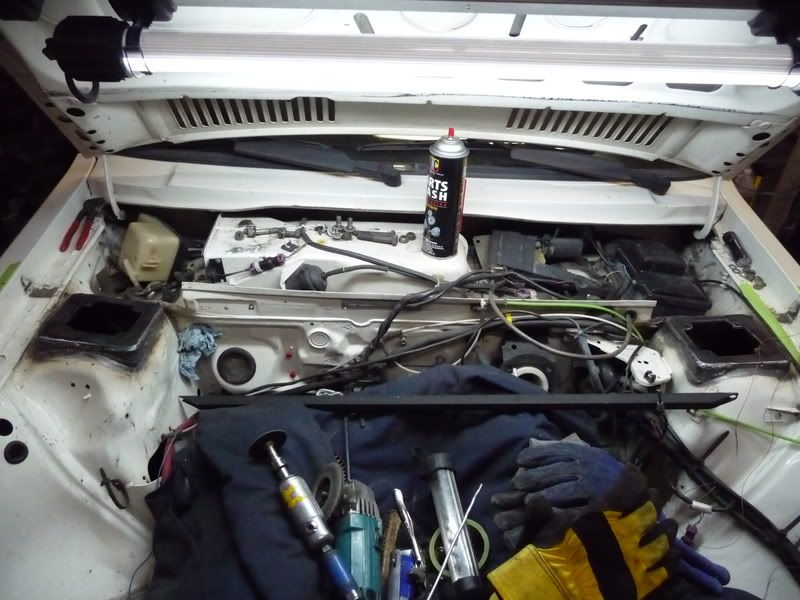

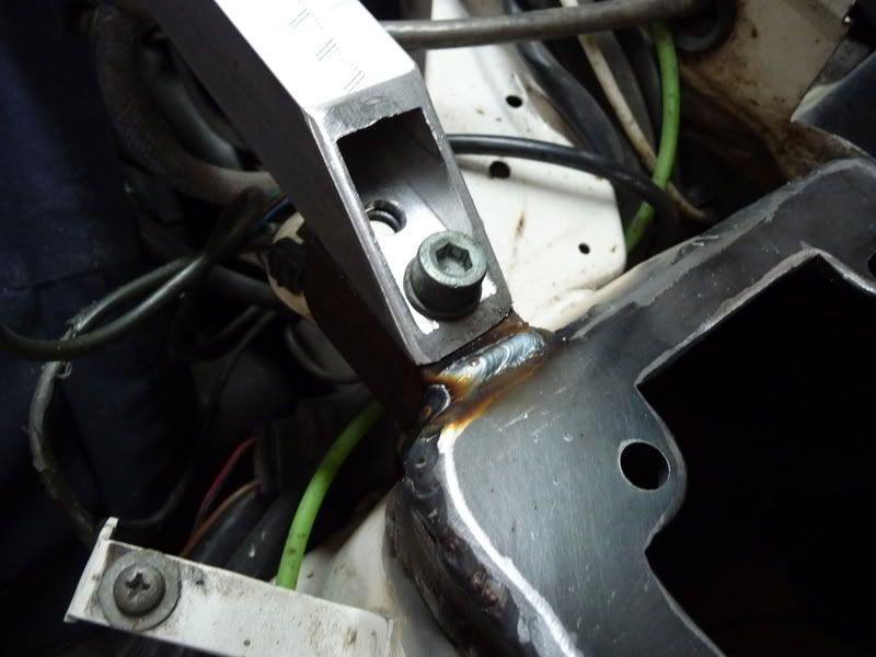

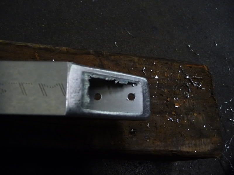

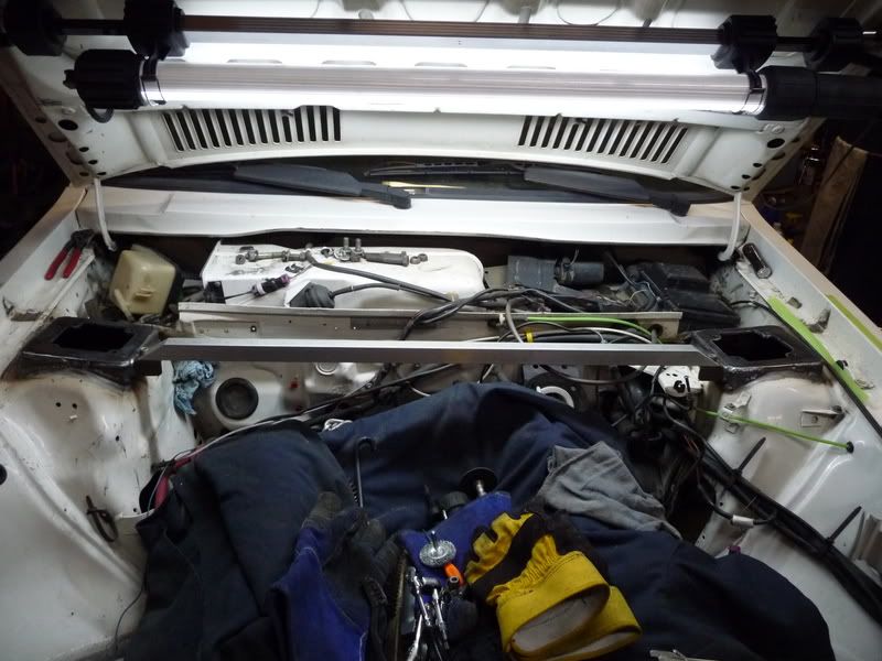

once everything was welded up, before i could throw paint on anything, i remembered i want a strut bar, so, welding some brackets on now is the thing to do.

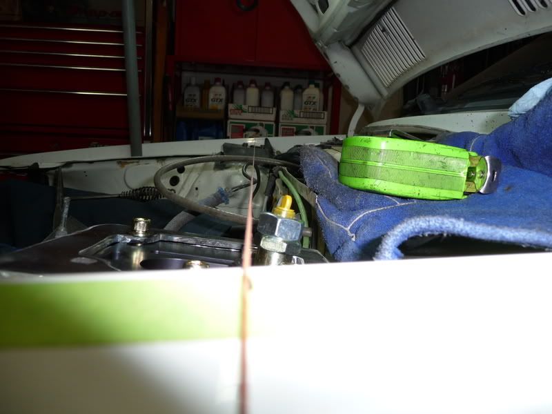

measured up

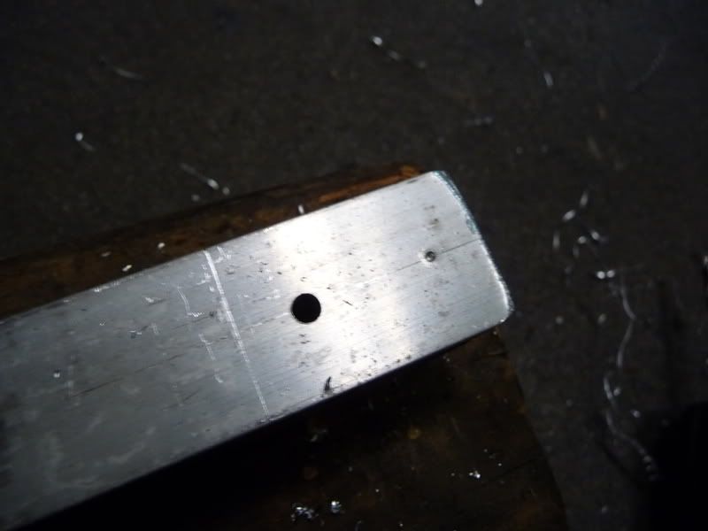

after cutting it to the right length, i had to drill some holes. i was reminded yesterday that drilling a small pilot hole is an excellent way of making sure your bigger bit doesn't wander off path.

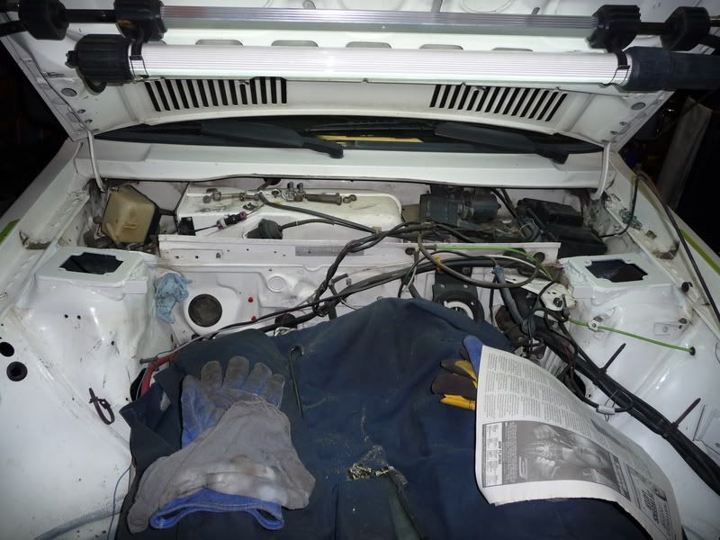

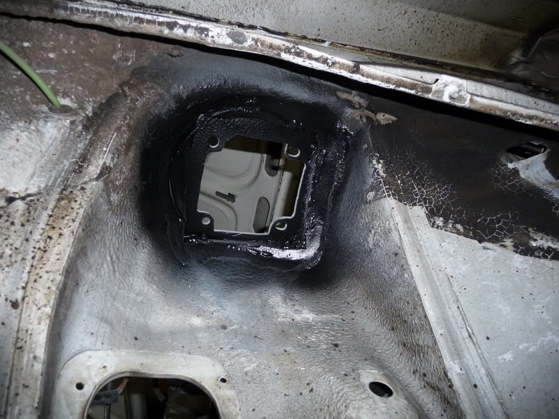

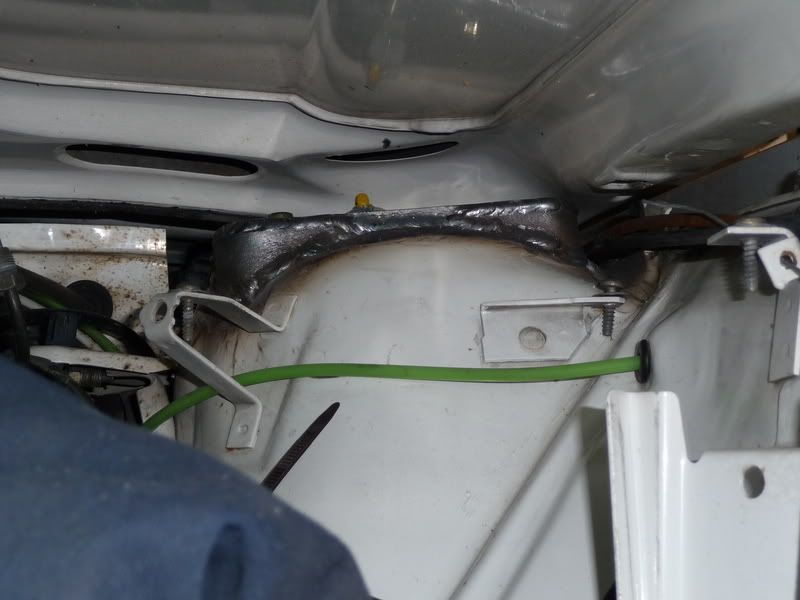

then it was time for some paint! cold galvanizing primer shot in underneath and just loaded in the area's i was worried about
then up top
i still had a couple cans of L90E alpine white factory spray paint from back in the day!!
and then some black 3M undercoating underneath

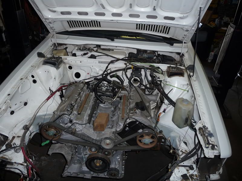

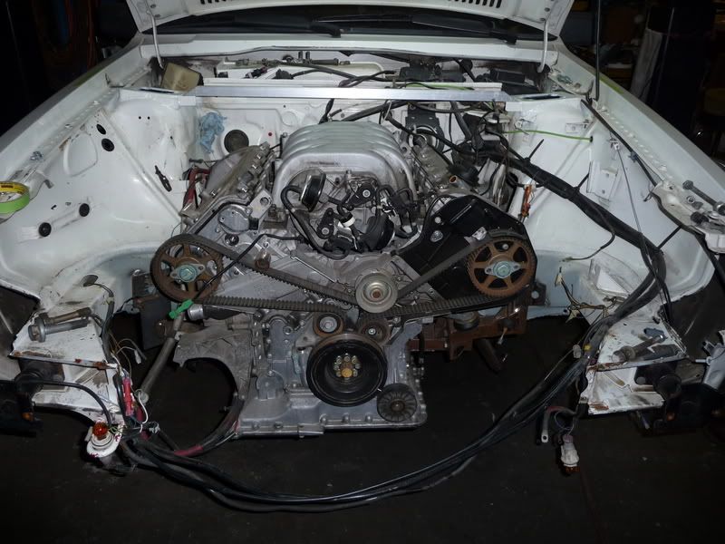

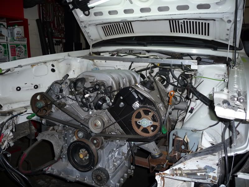

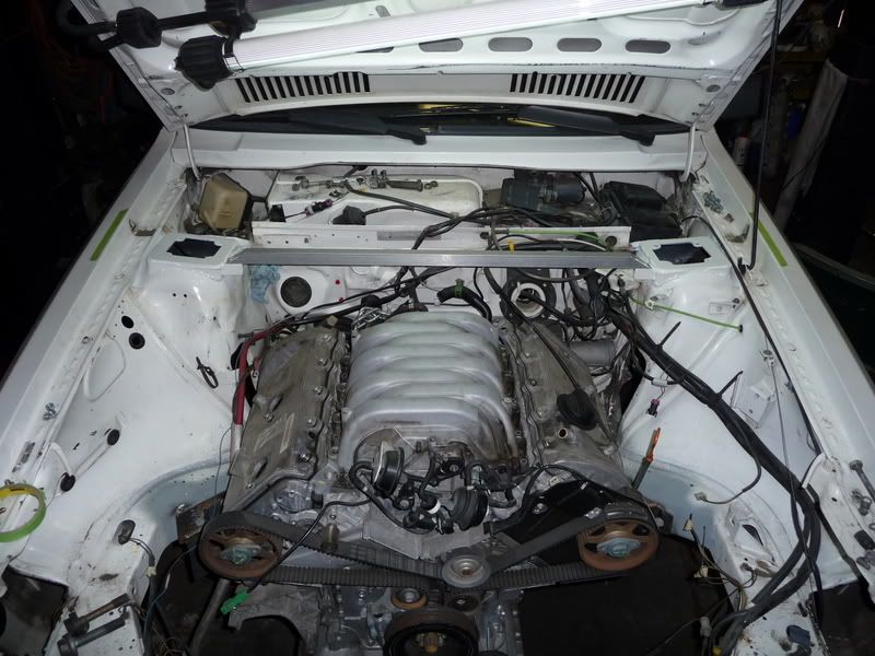

final product... (i'm still amazed at how low this engine sits
that's it for now. we'll see what kind of time i have left over this week before i go back home.
comparison
measured up
then up top

Those look really nice Derek. That is a buttload of work. I like how you put the plates up higher, and hten put the camber plates under. I guess that is cool because then all the stress of the suspension isnt on the four bolts...
I put mine on the top, which is nice because you are four bolts away from changing springs at the track.... But I hope that the bolts dont ever fail.
Good work!
Good work!

ShavedQuattro wrote:Those look really nice Derek. That is a buttload of work. I like how you put the plates up higher, and hten put the camber plates under. I guess that is cool because then all the stress of the suspension isnt on the four bolts...
Good work!
actually, Jay, the owner of ground control, told me to mount them from underneath or else they will crack. i got the most compact plate set they have (it's the 5bolt universal set on their site).
Timmy- yes, that's why i loaded the primer in there. it's a high zinc content primer, then i loaded the undercoating spray in there as well. i think it'll be ok.
Wiz- no, the heads are mine
Tox- i don't think Christians coupe has even as much castor as i'll be running, so i'm really interested to see how this works out.
Doug- work light was obtained at a local parts store. like $50? it's a great piece though!

ShavedQuattro wrote:The aluminum plate will crack? Hrm. Interesting. I'll have to take a look at that.
well, the ones i got will. they are just aluminum, and yours are about twice as thick because they are for probably a vw right? they design the thickness accordingly for cars where they will sit on the topside of the strut tower. the ones i happened to get are designed for mounting under the steel
Aw, yes, that is the deal. Yeah, mine are for the VW application. They are pretty darn thick. Anything is possible though I suppose. I wish I would have put more caster into mine. At the very most forward possition, I am at stock camber(or 0) so I think i only get about 4 degrees with the camber plates right?
