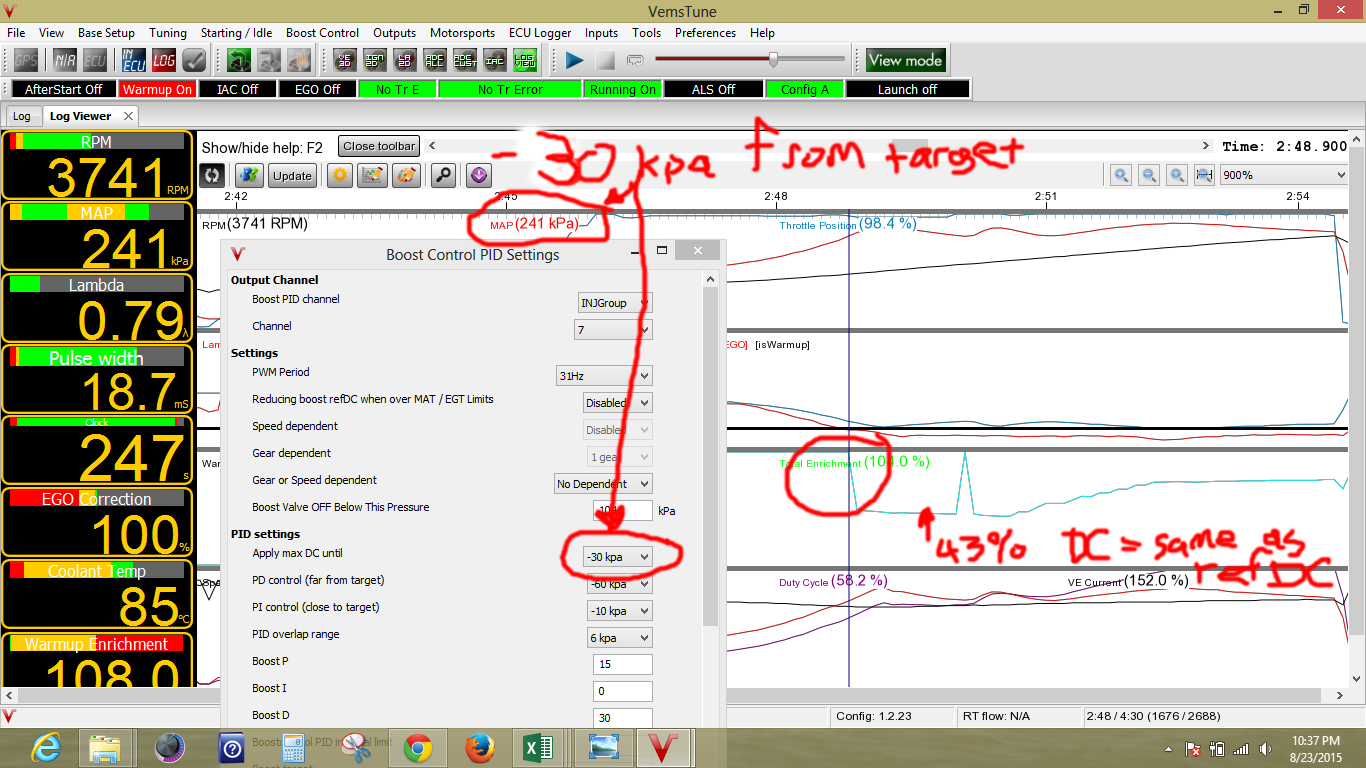

I don't think this is really related to your oscillation issue, but it probably doesn't help... look at your ref dc table and clean that up. It goes from ~45 to ~75 dc within one cell. That isn't helpful for boost control. You might want to smooth it out.
Looking more closely at your PID tuning, I can see the problem. It is DEFINITELY because of the "Apply max DC until" setting. It is currently set at -30 kPa. That means it will apply max duty cycle to the boost valve until boost is 30 kPa below the target boost (in this case 270 kPa). If you look at the log, this is exactly where the boost duty cycle drops off and your PID tune starts to kick in AND where your first oscillation is. Then, later where the boost duty cycle picks back up in value, its not because your PID is doing something. It is because your refDC table is requesting that value!
Your PID tune is essentially doing nothing lol. It is, for the most part, applying your base ref DC values. This is because your PID values are so small, they are essentially zero. You need to get rid of this 100% bs for a while and get your PID settings on point. Then you should fine tune with these auxiliary settings.

Ah man! That was my favorite setting lol. I'll check that out today thank you
Ha it was your favorite because it's not pid! It's cheating and it completely open loop control lol.
