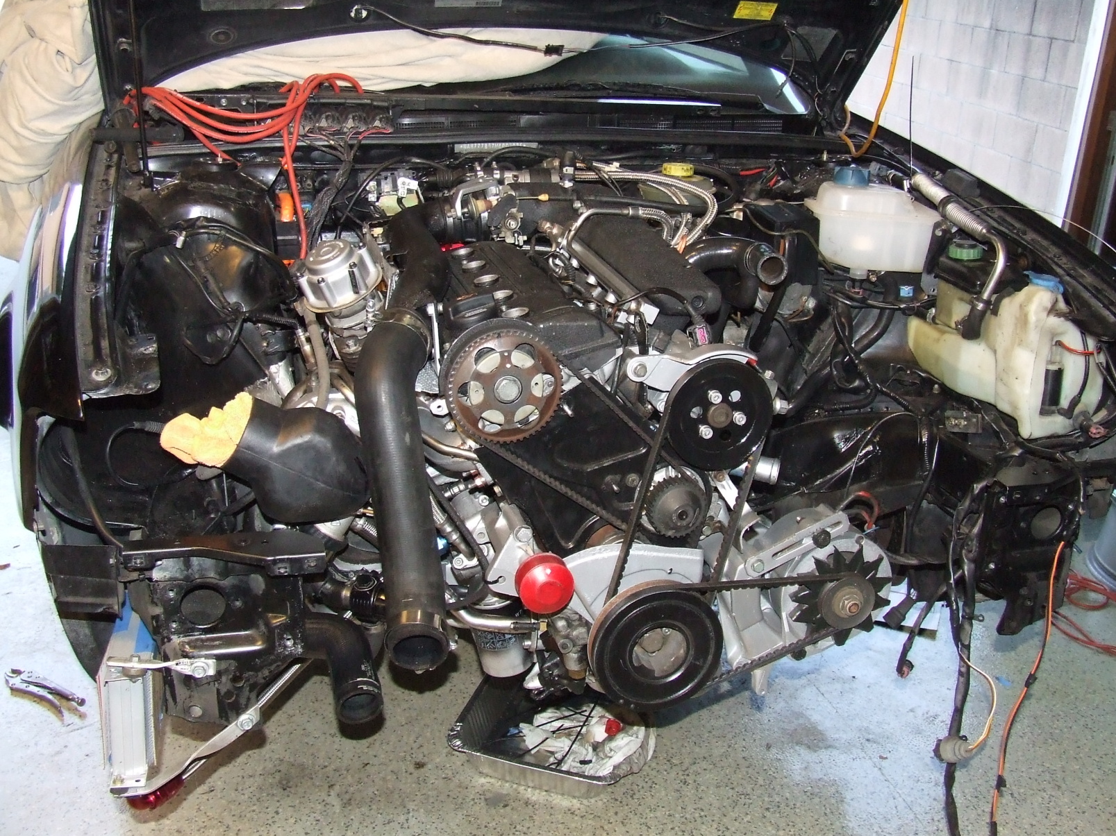

Ive cut the v-band off the volvo turbo and welded the stock k24 outlet

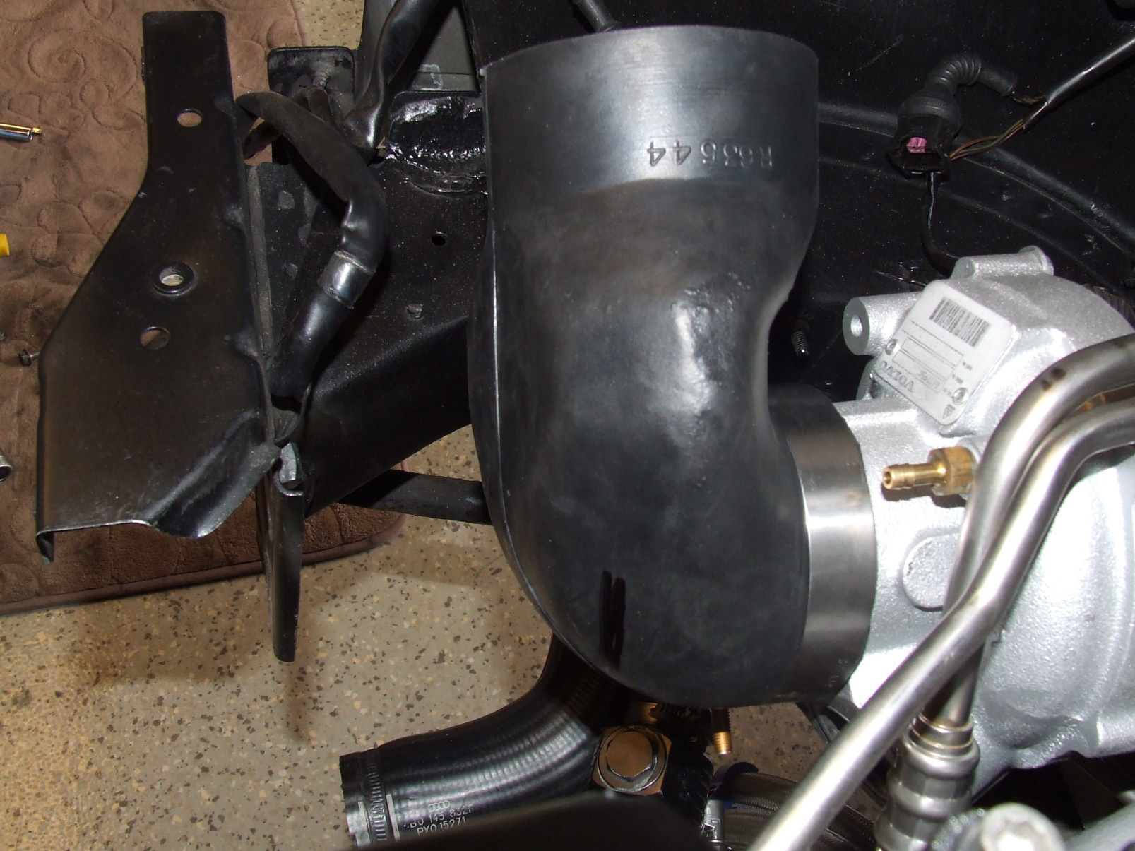

made some progress:
i had to play a lot till that cobra head was fitting
however i ordered some low profile mushroom filter, i think i will go with that.
Re: another S2 conversion
Posted: Fri Sep 11, 2015 11:41 pm
I would go cobra head and real filter like the aem dry over those crappy mushroom filters. They suck and tend to fall apart
Posted: Fri Sep 11, 2015 11:42 pm
I have run a lot of cobra heads and they work great. No restriction.
Posted: Sat Sep 12, 2015 12:09 am
When Eric was installing his Volvo K24, he had me turn down the inlet so he could use a smaller cobra head to clear everything.
Posted: Sat Sep 12, 2015 12:50 am
by varia
DE80q wrote:When Eric was installing his Volvo K24, he had me turn down the inlet so he could use a smaller cobra head to clear everything.
yes, i've read that, but its too late now. i wont remove it. maybe later

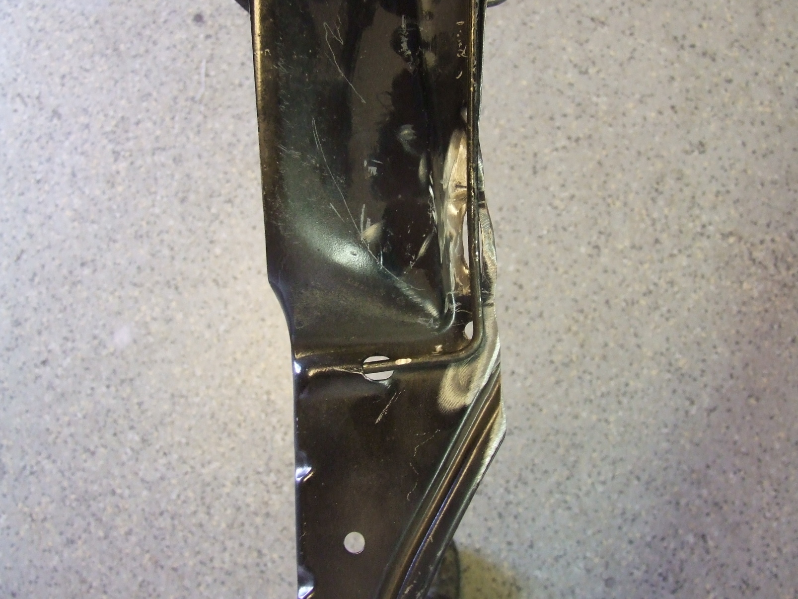

the interesting thing is, David had the same turbo, exhaust manifold, and cobra head, and he had no problem. mine was an inch longer, i had to trim from the cobra head and from the passenger side frame

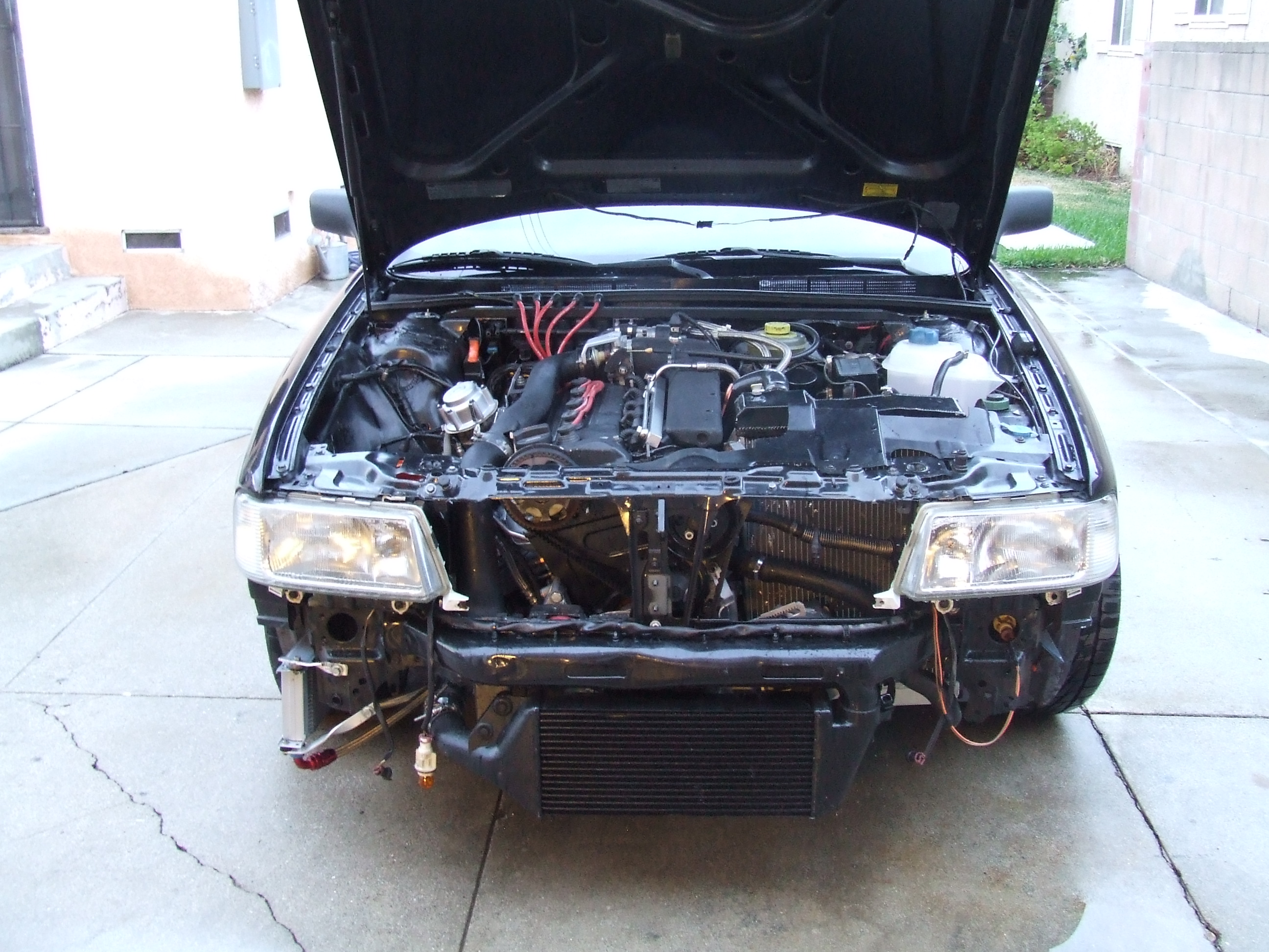

i will try to start it tomorrow.
otherwise its all together
