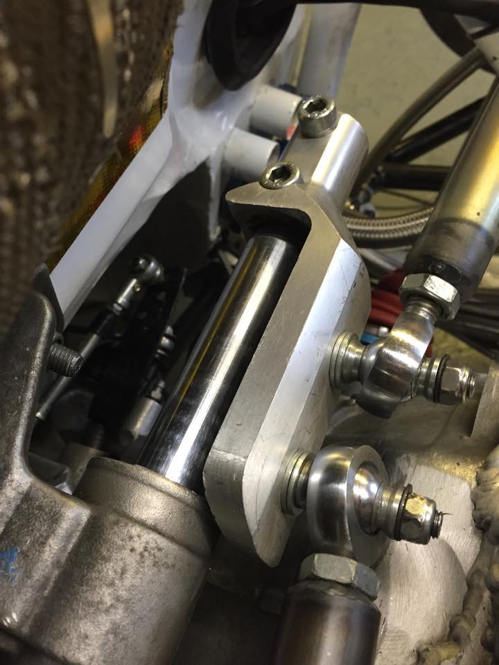

Wow. That intake is killer! I came across something that was shown to me
They make it for the S2 which has a 24mm rack bar
I’m trying to get one for our cars which I believe is a 22mm according to them.
I need a 7A steering rack which I’m going to be putting in my car to take measurements from just to be sure.

I can’t seem to get my micrometer in my 91’ 80q. But I have a 90’ cq that measures 22mm.
I found a cq steering rack locally that will work with The factory 7a high pressure line and accommodate this bracket from Dynamic Motorsport Developments.

So I did some measuring on 3 different racks. On the picture above the red line signifies the first measurement. A VW fox manual rack bar end measures in millimeters 26 x 20. A 90' CQ measures 22 x 20. S2 measures 24 x ? and my 91' 80q measures 24 x 20. Wish I knew the other measurement for the S2's. So at this point I think my 80q is the same as the S2 because the other measurement isn't asked for when wanting a 22mm one. We shall see

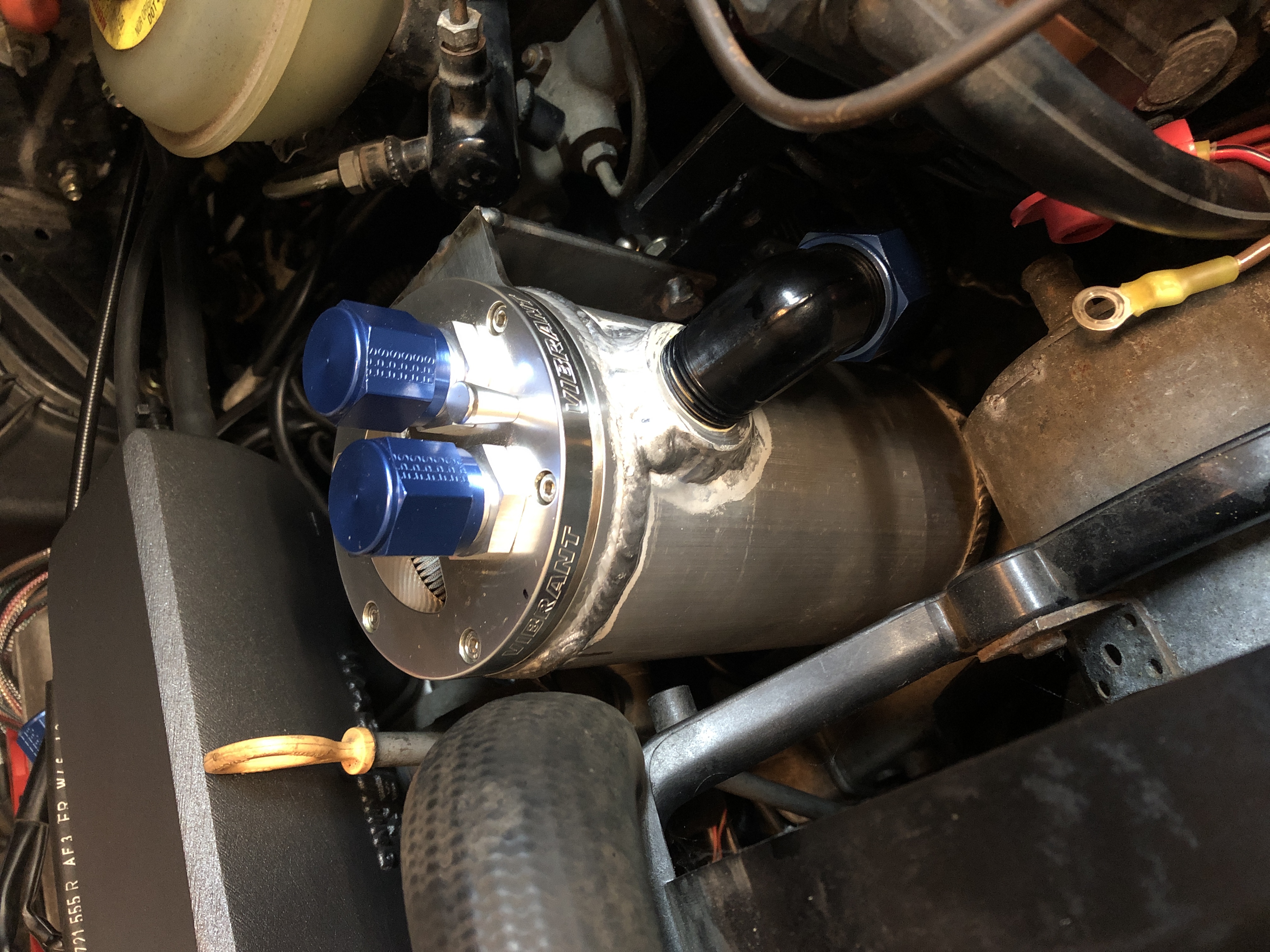

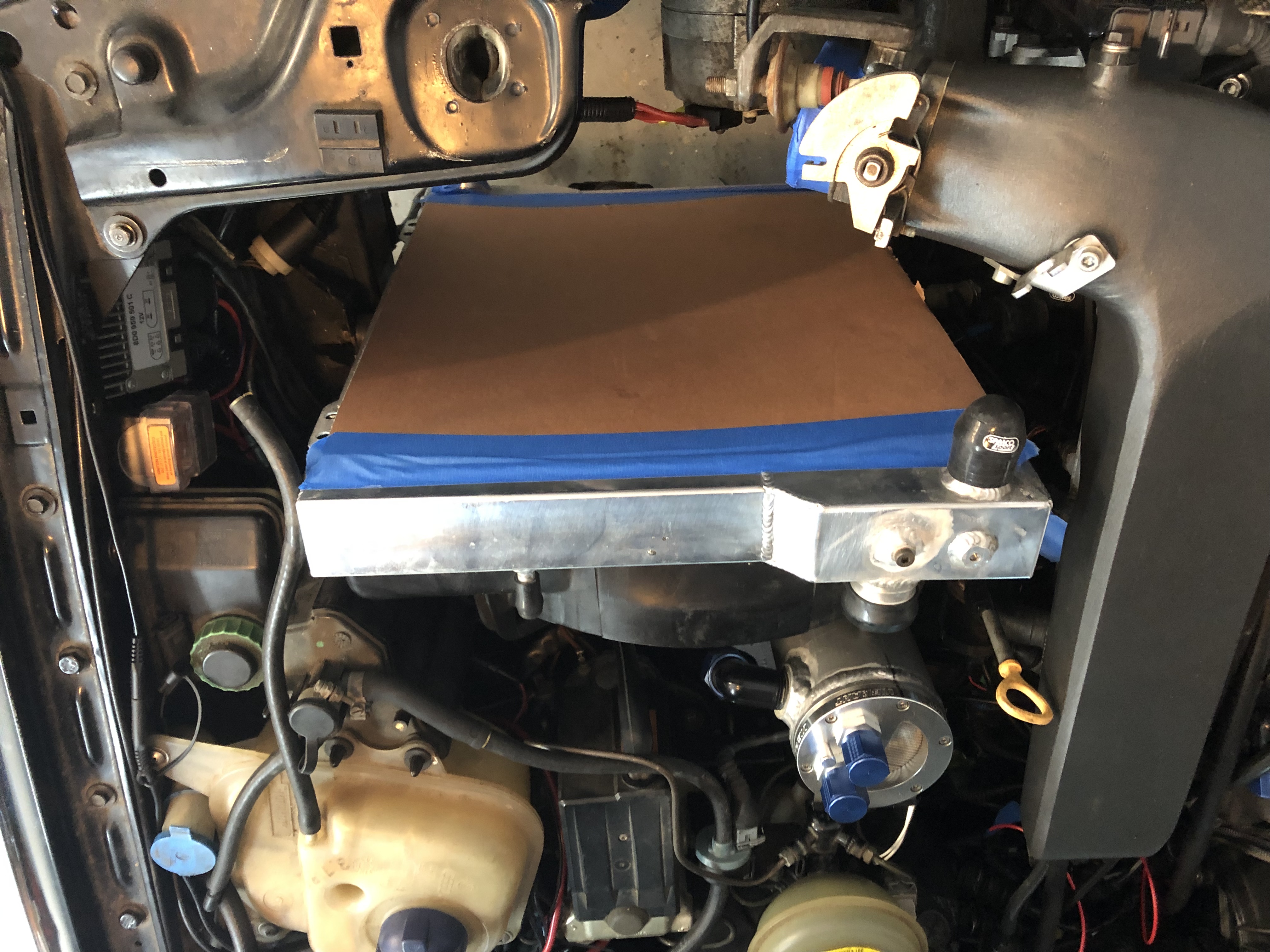

Here is my catch can all done. I had to modify one to work.

Nice that looks good . Hard to find a place to put that thing in a B2/b3 engine bay .
You running the crank case to it, no valve cover vent or suction ?
Re: Andy's 91' 80q
Posted: Mon Dec 31, 2018 9:12 am
by rennenmsports
Thank you! Yes. The two blue -10 fittings on top go to the valve cover and the black 90 degree -12 on the side goes to the crankcase. It’s a modified vibrant performance atmospheric vented can.

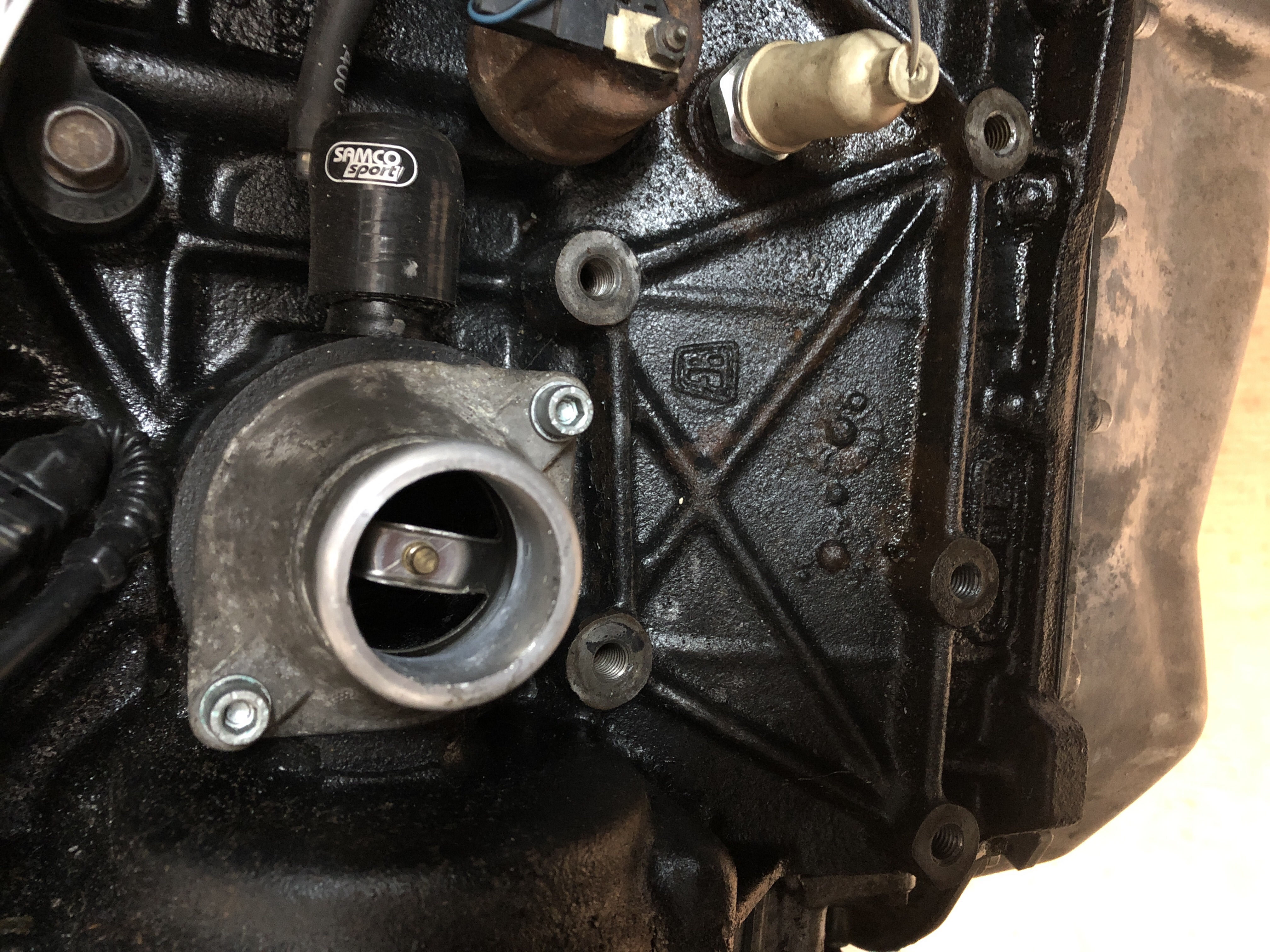

V8q thermostat housing is about 9mm bigger

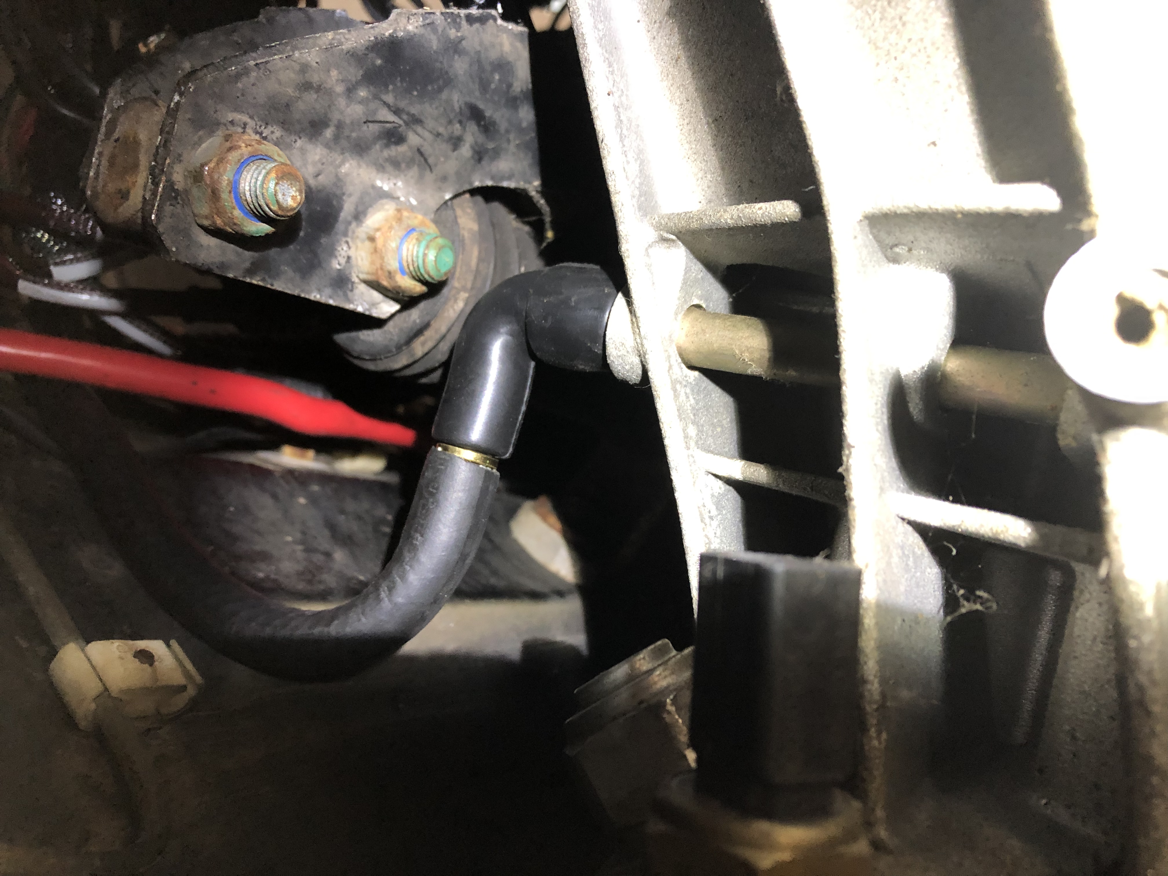

I used Dorman 46022 pcv elbow on my 01E breather to get past the steering rack so I could take on deeper water

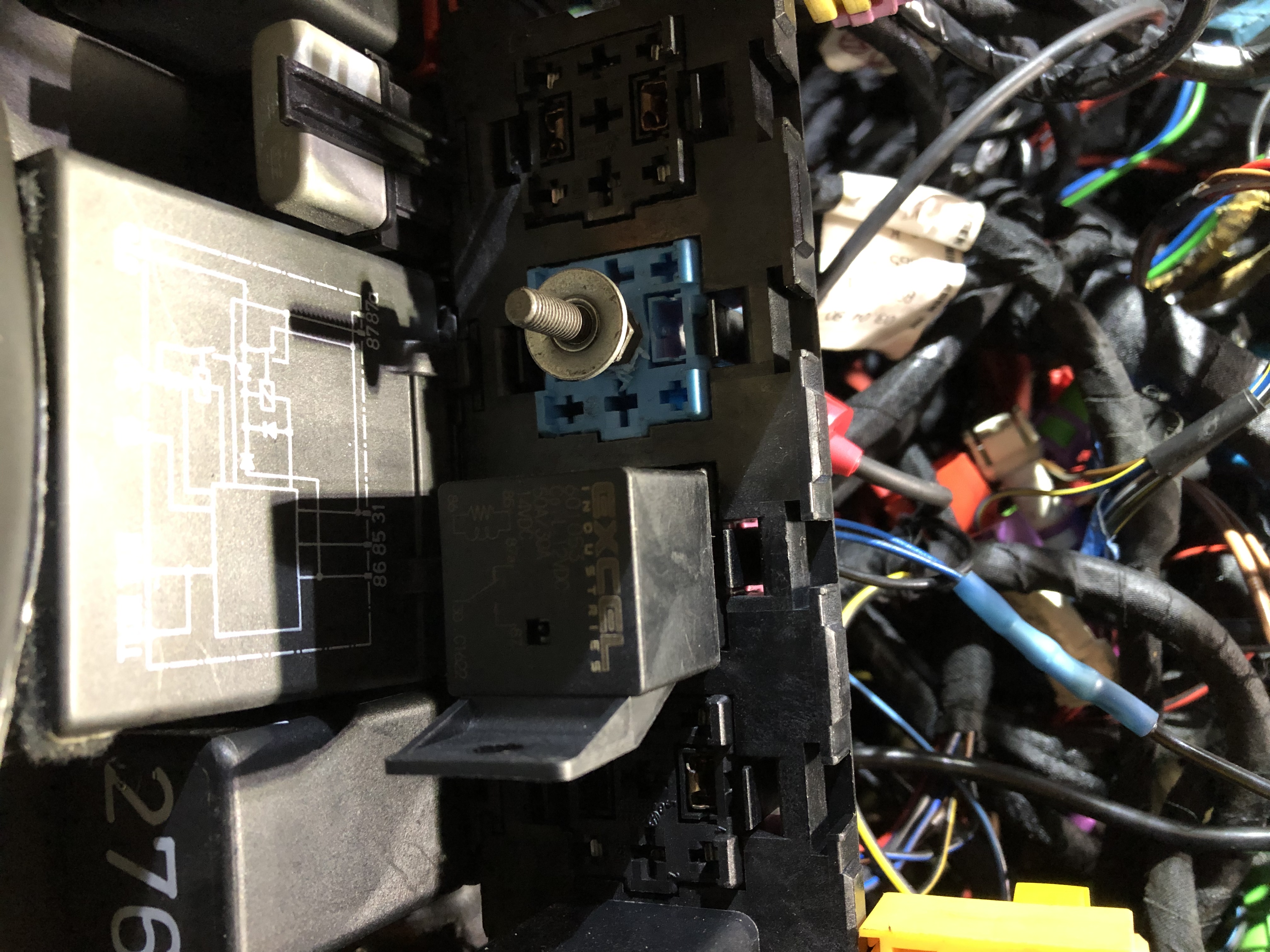

Well. I need a switched power source so I robbed it from the door chime relay and used it to trigger a relay so I could put a lot of accessories on it. I was able to repin a factory relay holder to accommodate what I needed. Then took another relay holder and drilled a hole in it so I could put a stud for power

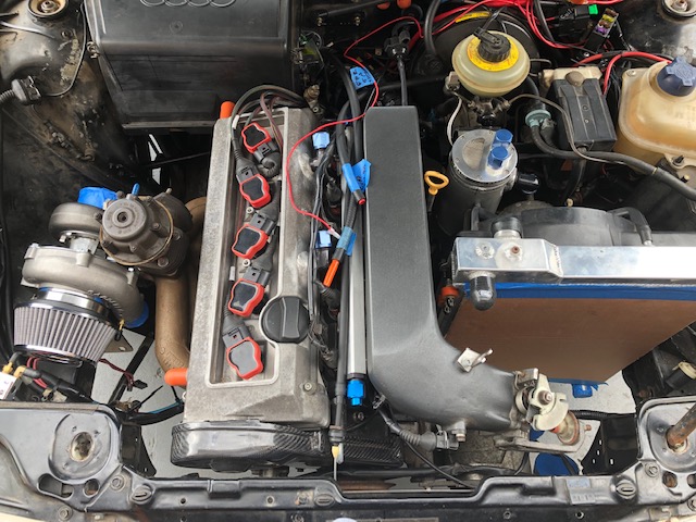

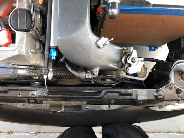

by rennenmsports
here's a birds eye view
I had to cut some of the B3's hood frame out of the way from hitting the throttle body when using 034's phenolic intake manifold spacer with the wagner intake
