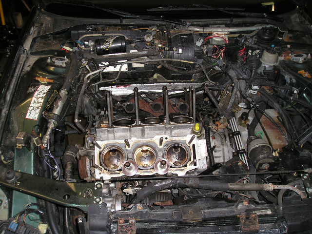

Nice project, I have always thought the Biturbo is pretty cool.
Those are cast iron liners correct? Although they are probably pretty well stuck I would still recommend some hold downs like this:
Jeep ebay and 164 Verde 011.jpg (67.1 KiB) Viewed 64606 times
Good Luck!

Yeah - I had the same thought and put some on there last night!
