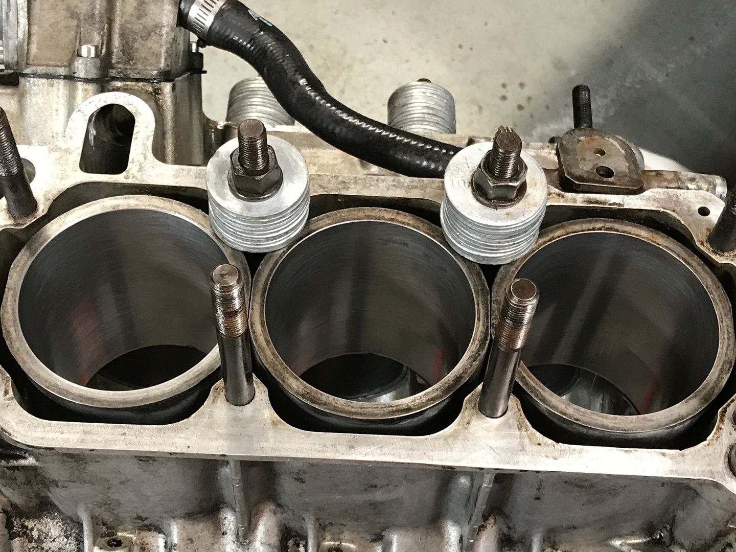

Those are cast iron liners correct? Although they are probably pretty well stuck I would still recommend some hold downs like this:

Yeah - I had the same thought and put some on there last night!

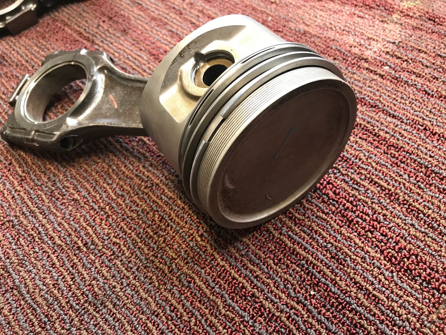

I got the whole thing reassembled last week and it still smoked like crazy.
Pulled it back out and disassembled today - stuck oil ring on Cylinder #4:

Yeah, I think I have it all figured out now though! Just waiting on a new set of rings and then to reassemble

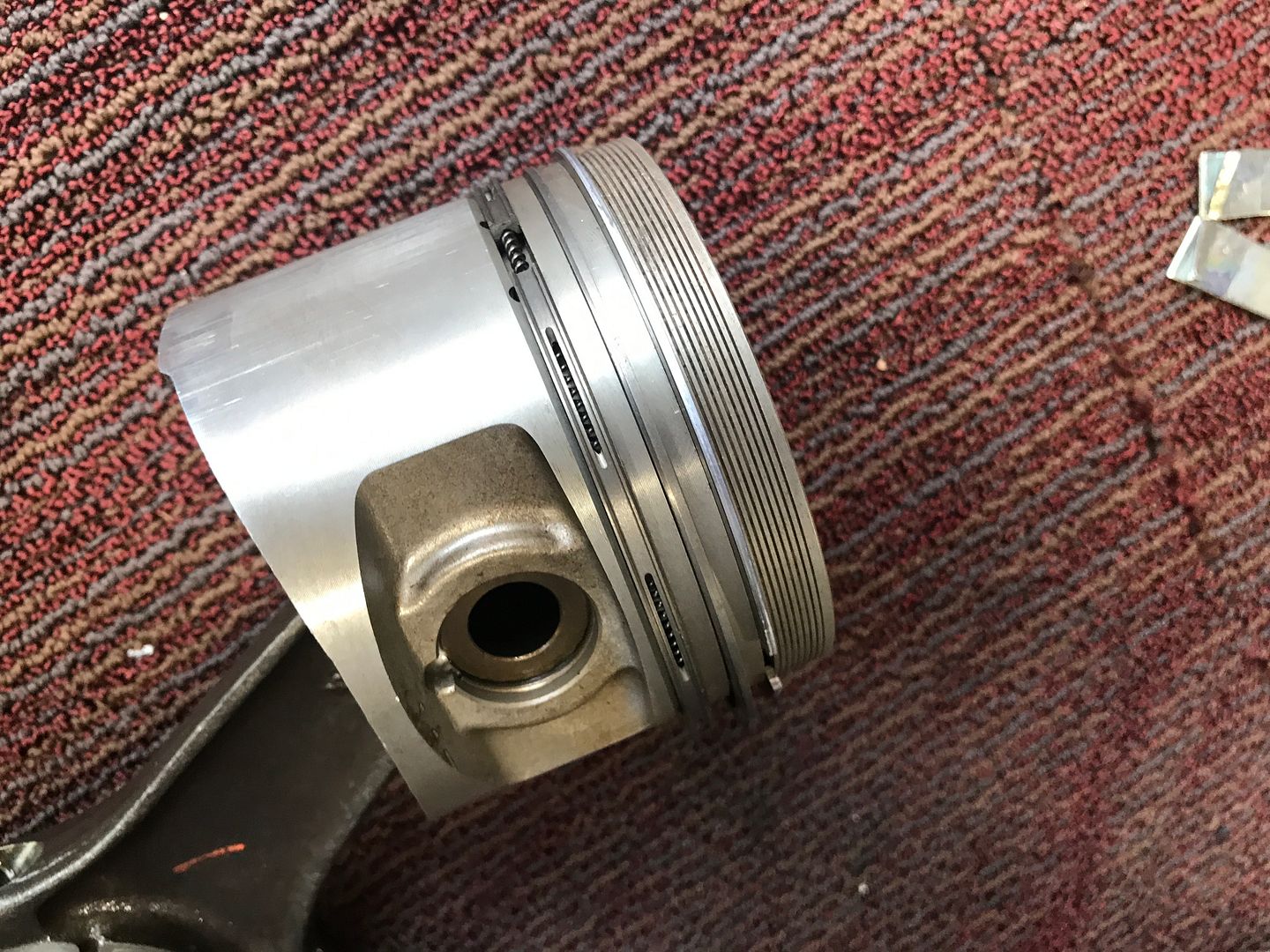

Rings now installed:
Cylinders Honed:
before and after here:
Now just waiting on some loctite 510 to join the two halves of the block back together and then I'll get it all back together and in the car.

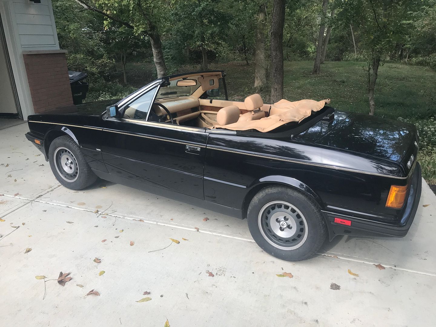

Got this thing running today and put about 15 miles on it.
A couple issues to work through: a heavy bogging down when going uphill or mashing on the gas pedal. not sure why yet.
runs decently on flat or downhill roads
A couple pics:

If only this had been a happy ending at the time of the last post...
I drove the car a bit more in early October and I was hearing a lot of valve noise. Turned out that I had zero oil going up to the head on the driver’s side so - engine out again to try and figure out why.
I believe the culprit was an overly aggressive application of the Loctite flange sealer on the two halves of the engine block. There are little grooves behind the main bearings that channel oil up to the top half and then up to the head and there was some loctite visible blocking at least part of that channel. For good measure I also replaced the main bearings this time around since I realized that too much clearance between the crank and the bearings could also cause this problem and there was definite wear on the mains.
Got it all put back together and no smoke, plenty of oil and I still had the bogging down issue.
I was able to isolate it to a fuel problem and it turned out to be a bad vacuum hose routing. The carburetor requires about 3 psi of fuel and when the engine is at boost the Rising Rate Fuel Pressure Regulator increases the fuel pressure by the amount of boost. Otherwise, bogging! I had the routing wrong and it turned out it wasn’t getting vacuum or boost at all.
Anyway, I love the fixes that are free and simple. Teed off the manifold and Voila!
I drove the car yesterday and today quite a bit and I have to say it’s pretty awesome.
I got new tires on it Friday and took the plenum back off today to give the carburetor a better idle tune and it is running pretty well now.
It’s a keeper!
So now I have to figure out what to do with the 5 speed Cabriolet. I definitely don’t need 2 convertibles and the wife can drive the Maserati since it’s an automatic. Also I have to say the Maserati is WAY more comfortable than the Cabrio. The interior really is pretty amazing. Plus - the tiny turbos are actually kind of quick!
The clear coat is falling off the Cab at an alarming rate and while it runs well I expect that I would be better off taking the euro bumper, rs2 lights and the JHM short Shifter off, part what I can and scrap it. I don’t expect anyone to spend the $2,500 or so that I think the parts and scrap value are.
