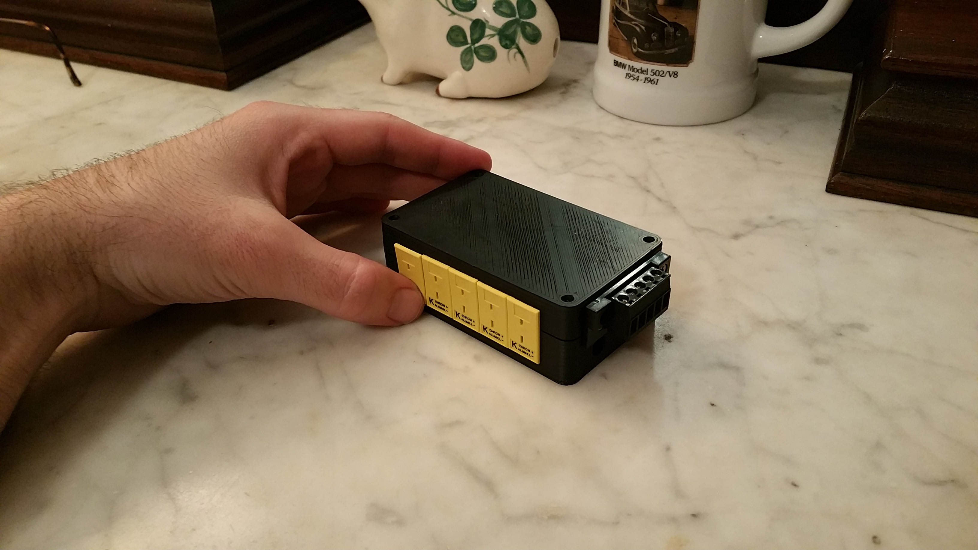

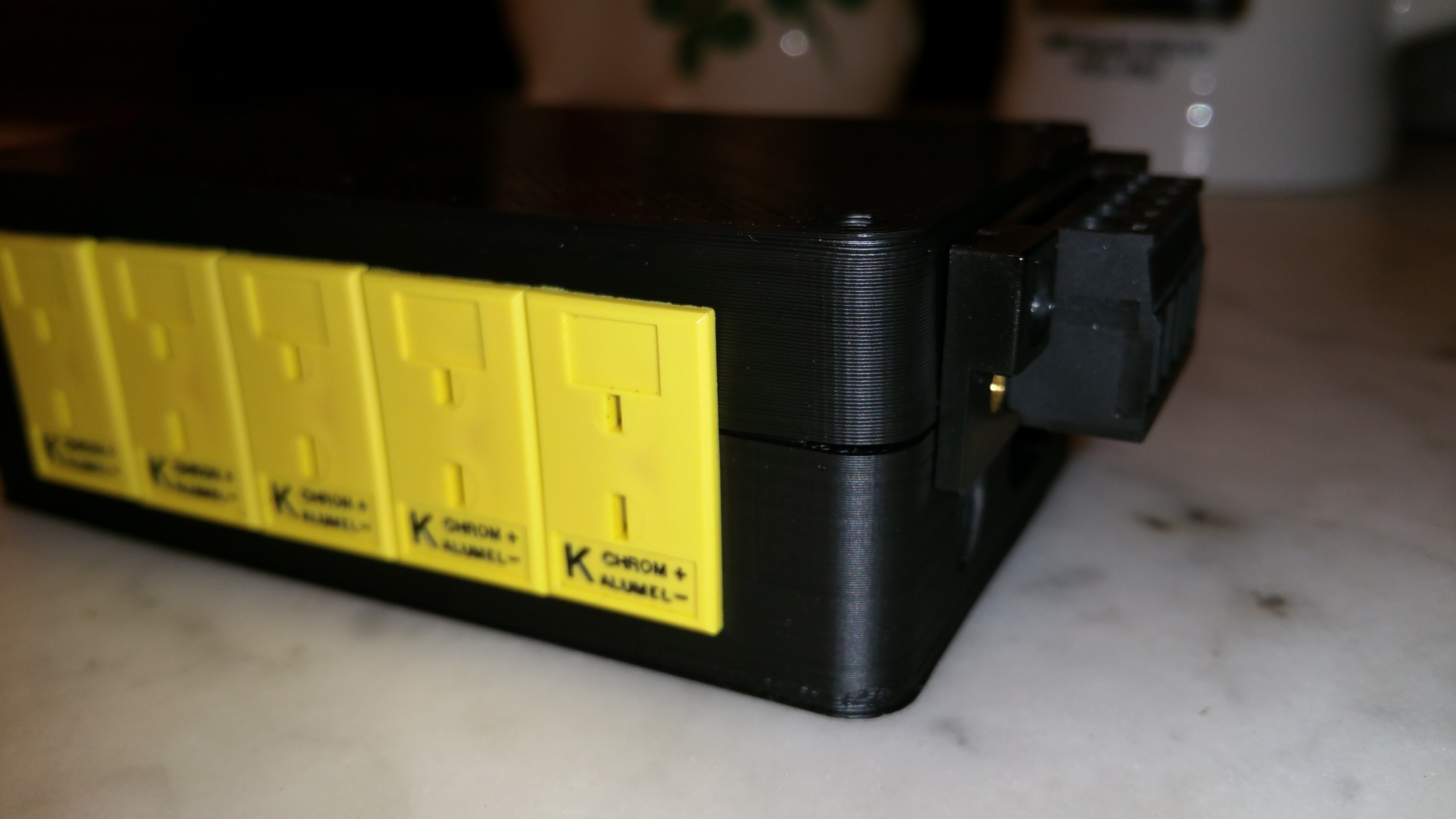

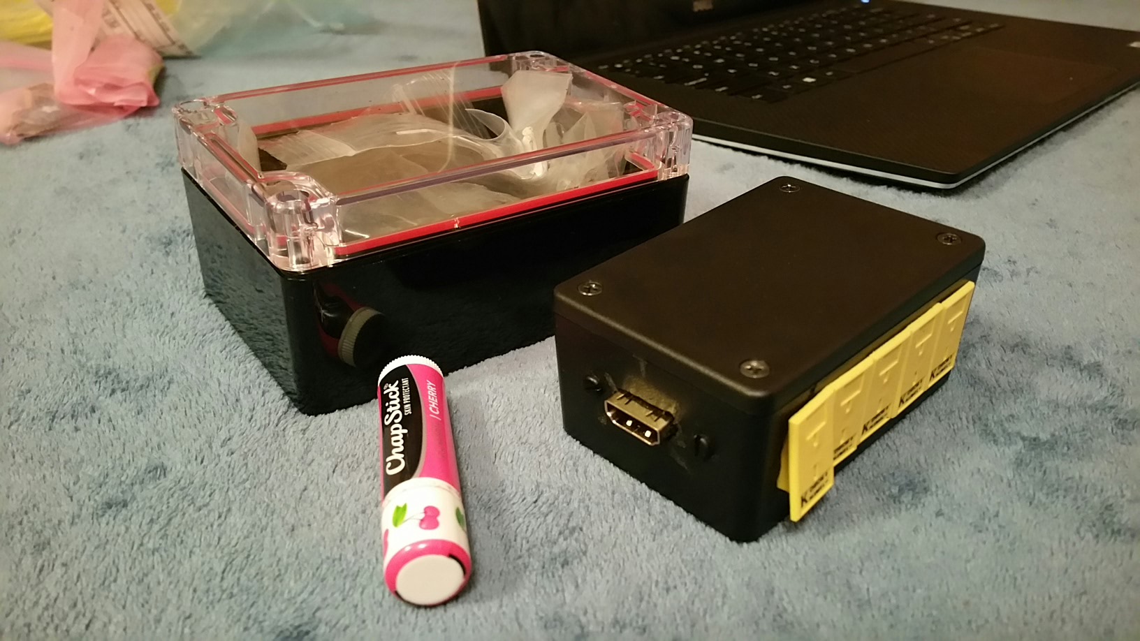

Last week I got the chance to try making some hardware fit in a nice little box. Unfortunately, I didn't account for a few things and it doesn't quite fit everything in the configuration I wanted it to. I will have to find a slightly bigger box. It was a good learning experience though.
I had to use a dremel to cut most of the holes out unfortunately. I will come up with a way to avoid that in production models (templates, jigs, waterjet, etc). I have a die for the thermocouple connectors, but it doesn't quite work for the outer connectors, and it definitely doesn't work for the HDMI, USB, etc.
Here are some pictures. Please ignore how rough everything is (especially that floppy TC port lol). This was just me experimenting with different layouts, trying to make the smallest enclosure possible work.
TC ports

Analog outputs, power, and HDMI out to LCD display (HDMI connector will probably not stick out like that)
2016-06-04 22.13.42.jpg (243.05 KiB) Viewed 168692 times
Chap-stick for scale. The box in the background is another one that I ordered for consideration, but it is too big and expensive.
2016-06-04 22.11.36.jpg (273.32 KiB) Viewed 168692 times

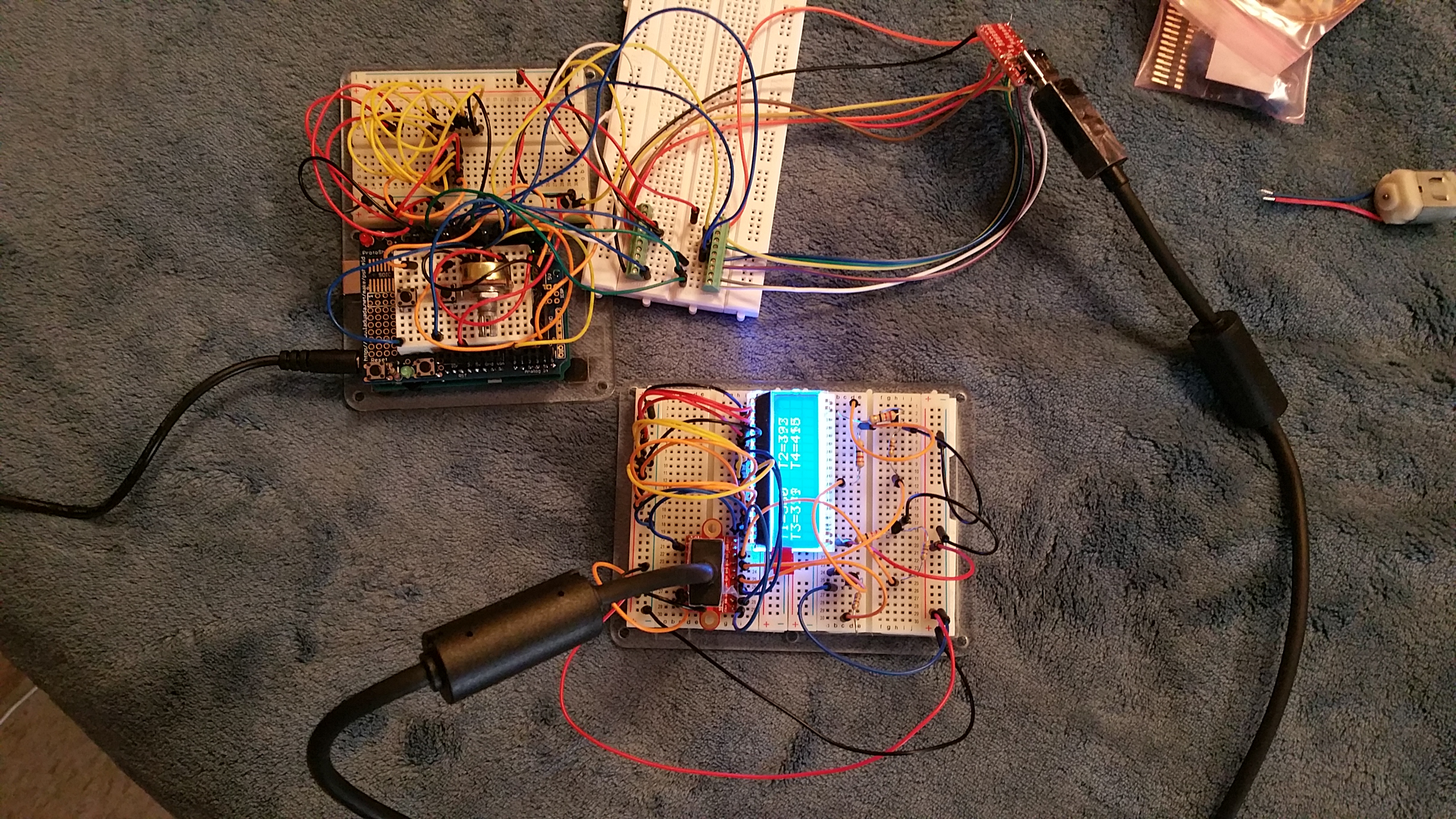

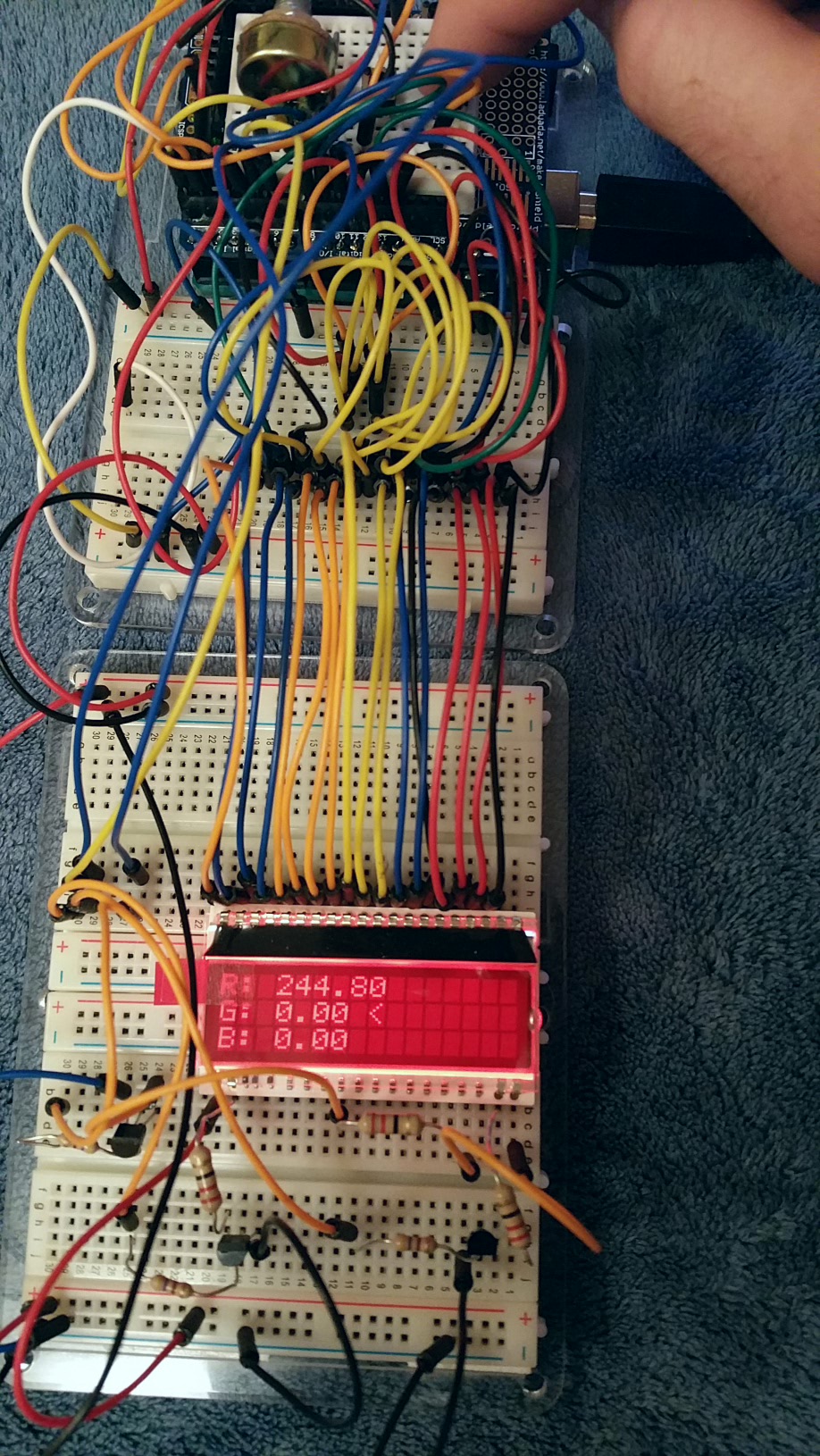

Over the past few days, in-between 18 hour shifts and despite the most contradictory and conflicting documentation I've ever received with an electronic component, I somehow managed to wire up the RGB backlit version of this display. I only had to fix a line or two in the code that I'd already written but had been unable to test and it worked. It had a strange "beat-like" flicker to it though, and it turns out that one of the PWM pins I was using runs on a different timer than the other two. Not the most fun kind of issue to chase, but I managed to track it down in a reasonable amount of time. That would have been super annoying to have to deal with! It's perfect now though :)
2016-06-04 22.17.39.jpg (366.08 KiB) Viewed 168692 times
2016-06-04 22.15.27.jpg (492.13 KiB) Viewed 168692 times
I haven't taken it in the car to find out what settings produce the stock instrument color yet, but I do plan to do that and send them out with that as the default setting.

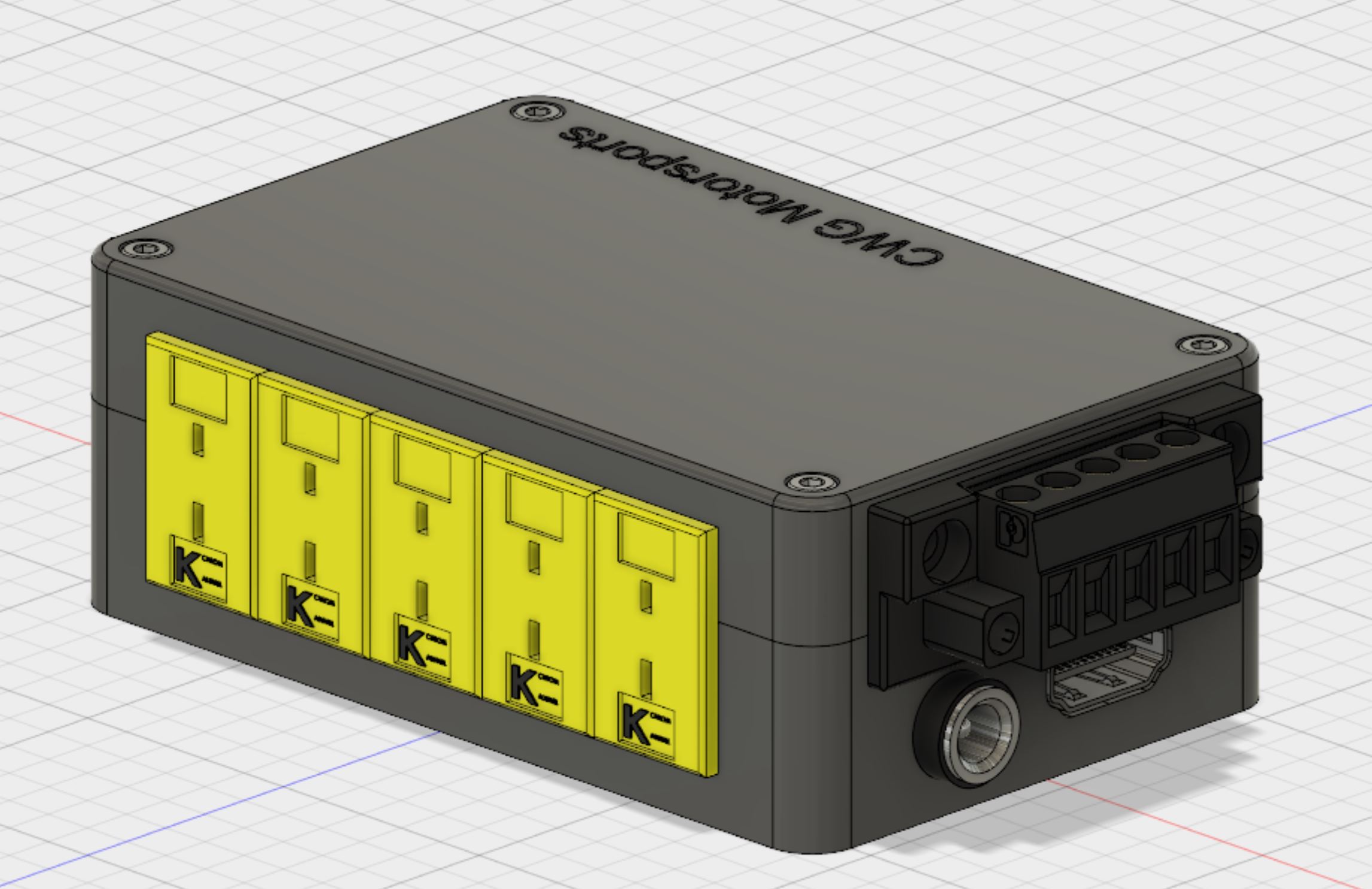

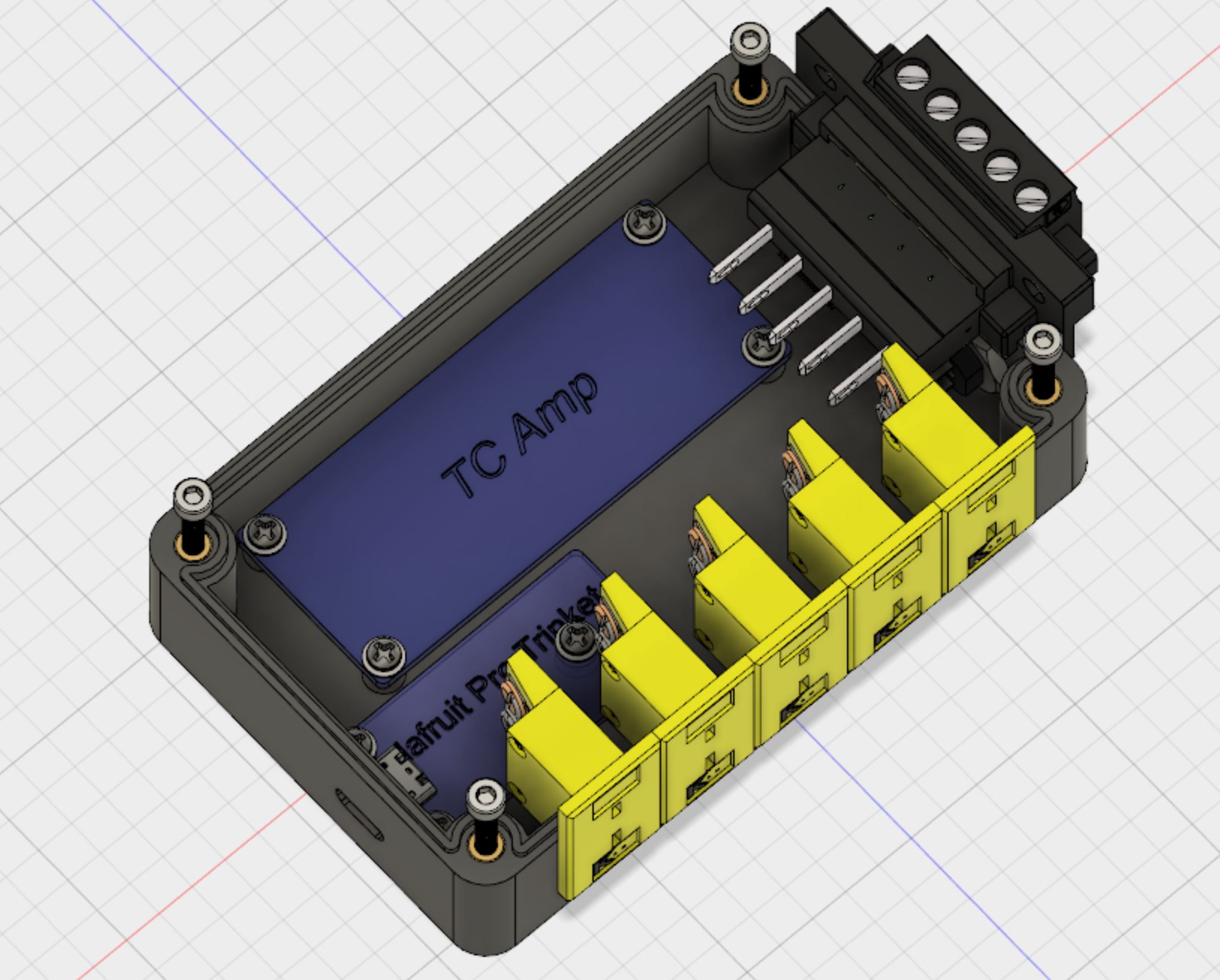

Posted: Sat Jun 11, 2016 8:13 am

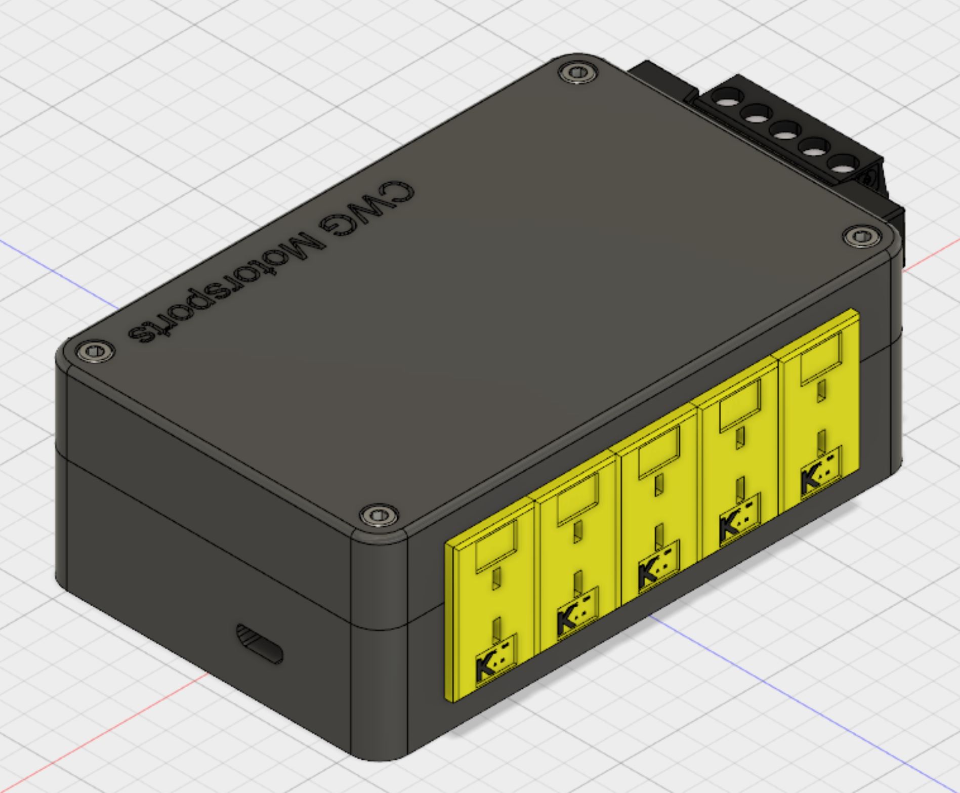

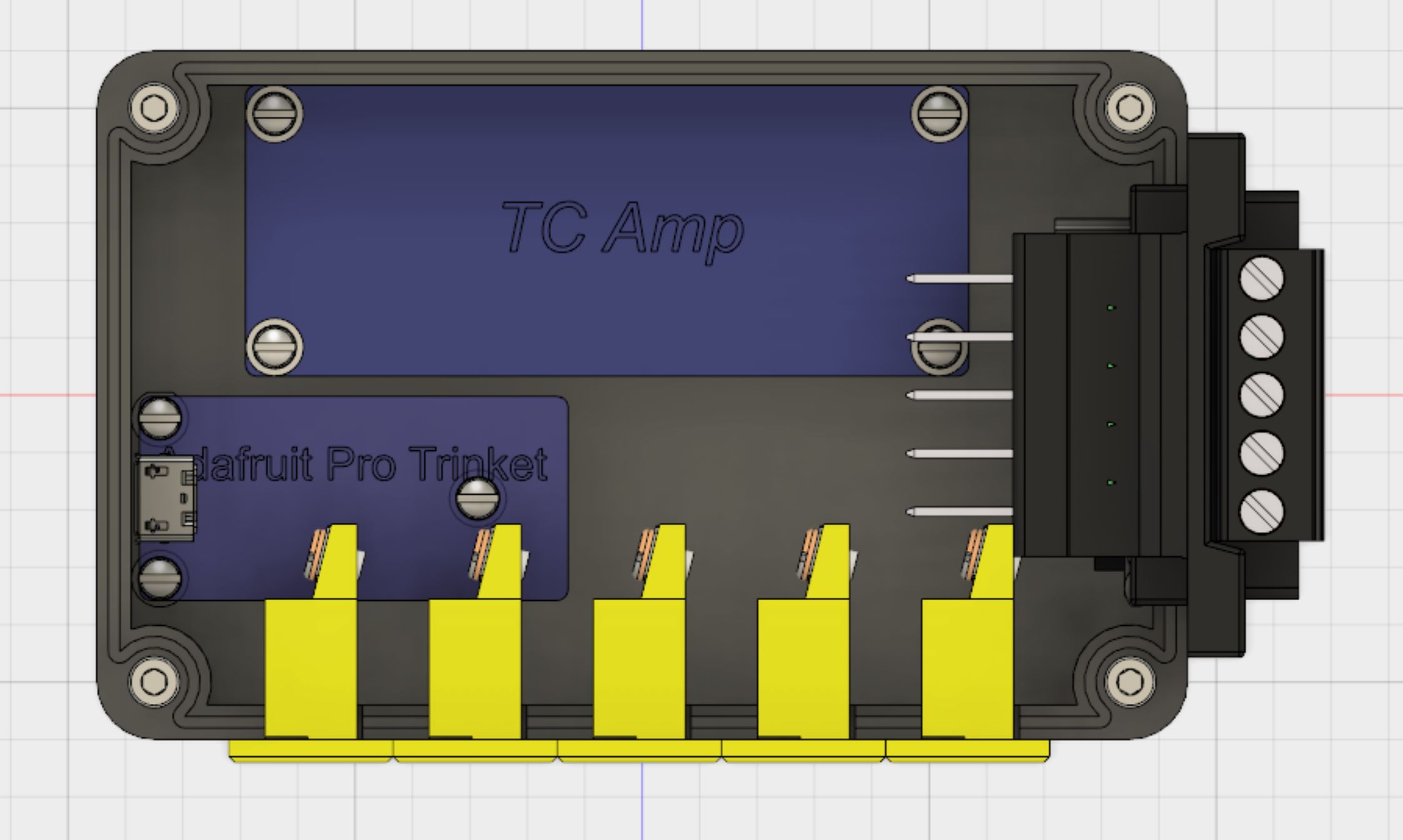

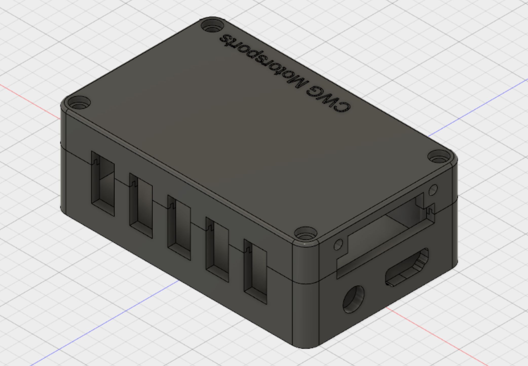

The layout is coming along pretty nicely.
HDMI for LCD and buttons, power, and analog output are all on one side of the enclosure.
Micro-USB port on the opposite side (not the front like I said it would be before, due to space constraints) for programming, updates, etc.

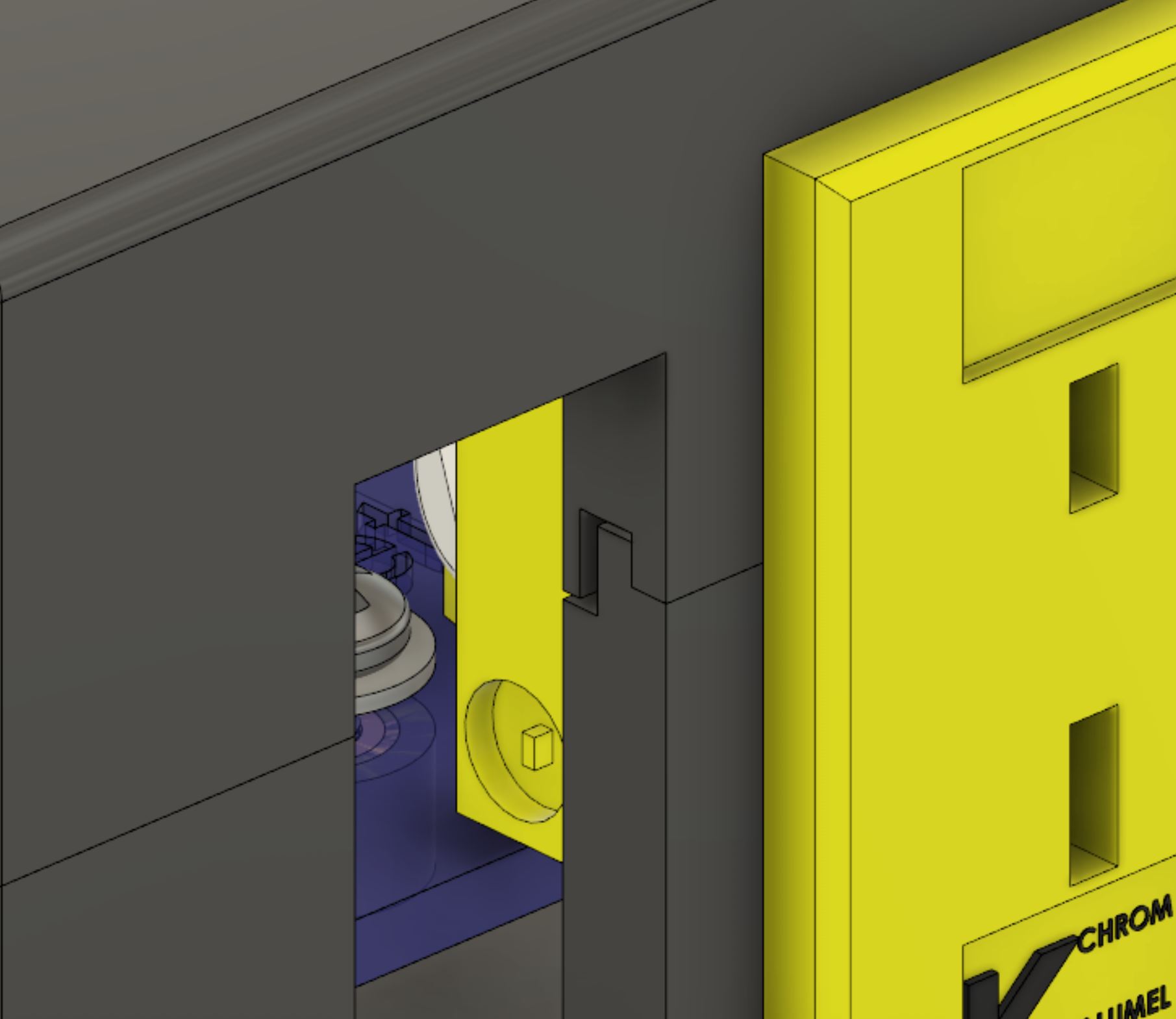

General layout is now mostly finalized. Brass inserts will be used for PCB mounting and for clamshell closure.
A sort-of tongue and groove closure at the clamshell will help keep things aligned. The gaps have to be sized very specifically for the printer to be able to print them.
One more of the general layout with almost all components modeled and in place
I should get to try out the printer this weekend. Then I'm sure I'll have to change the design a bit here and there based on how it prints. I'll purchase all of the hardware after that. Then hopefully I can assemble a compete enclosure. Then it's on to testing the LCD over HDMI and figuring out how to package the LCD screen, buttons, and connector.
Posted: Sat Jun 11, 2016 10:18 am
Two questions.
Will heat be a concern here at all, with the tight packaging?
Also, it's tough to tell by the rendering (which look top notch, btw), but with the micro usb is it mounted flush with the face or inset into the box? It would be nice if the plug went into the case a few mm's to prevent it from wiggling out.
Posted: Sat Jun 11, 2016 10:33 pm
PRY4SNO wrote:Two questions.
Good questions.
No, heat does not pose a problem here. The amps and outputs operate at very low voltages and amperages. In fact, I wanted to make it a lot smaller, but the size of certain components has dictated it be the current dimensions.

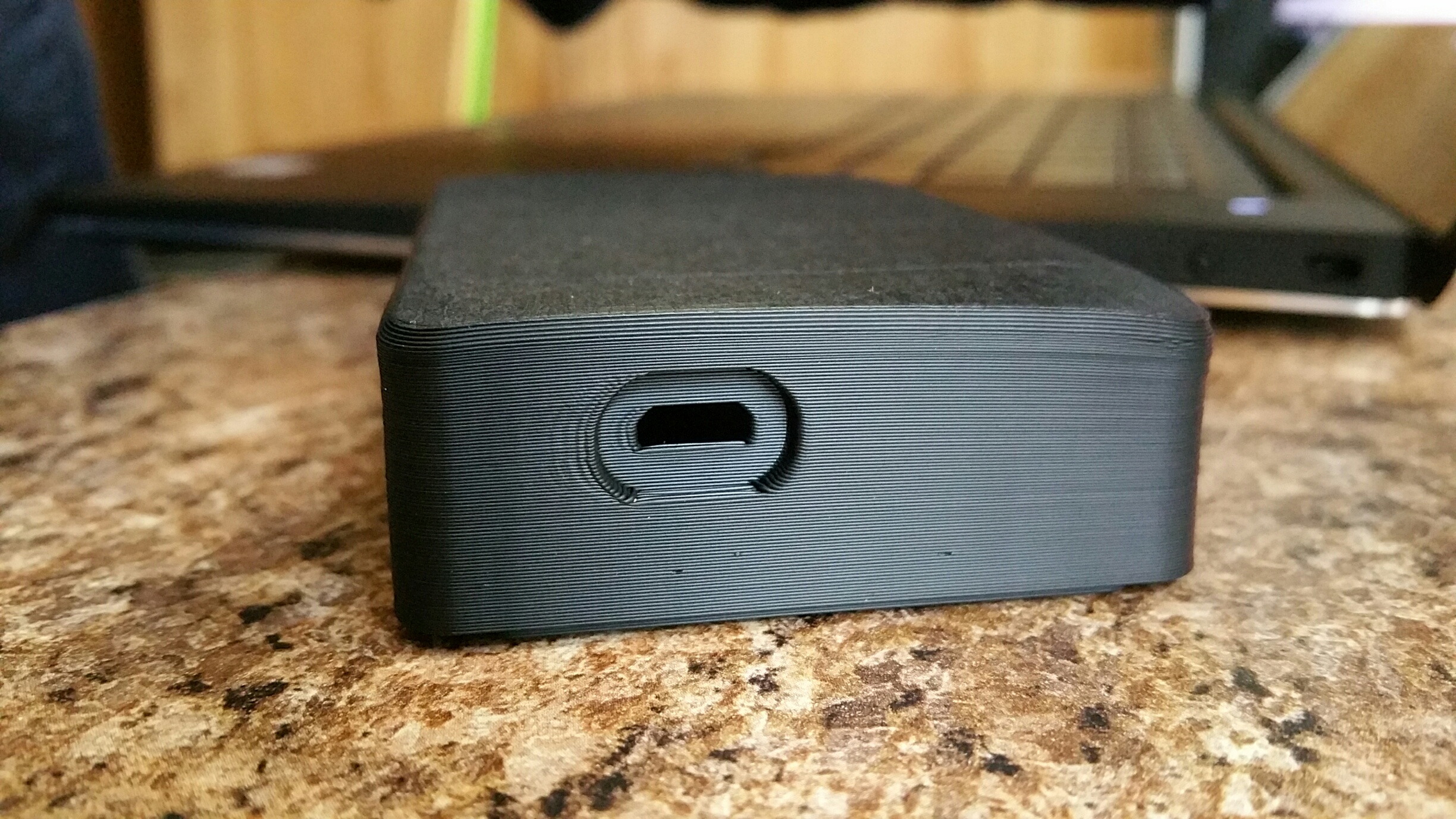

I was expecting you to say you wanted the micro USB to be flush when I first read that, but luckily for you, it is inset about 4 mm. I didn't like that at first, but you make a good point and I didn't have much of a choice anyway! I will have to make it a big oversized since there are many shapes and sizes of micro USB plugs (the part of it which isn't standardized).

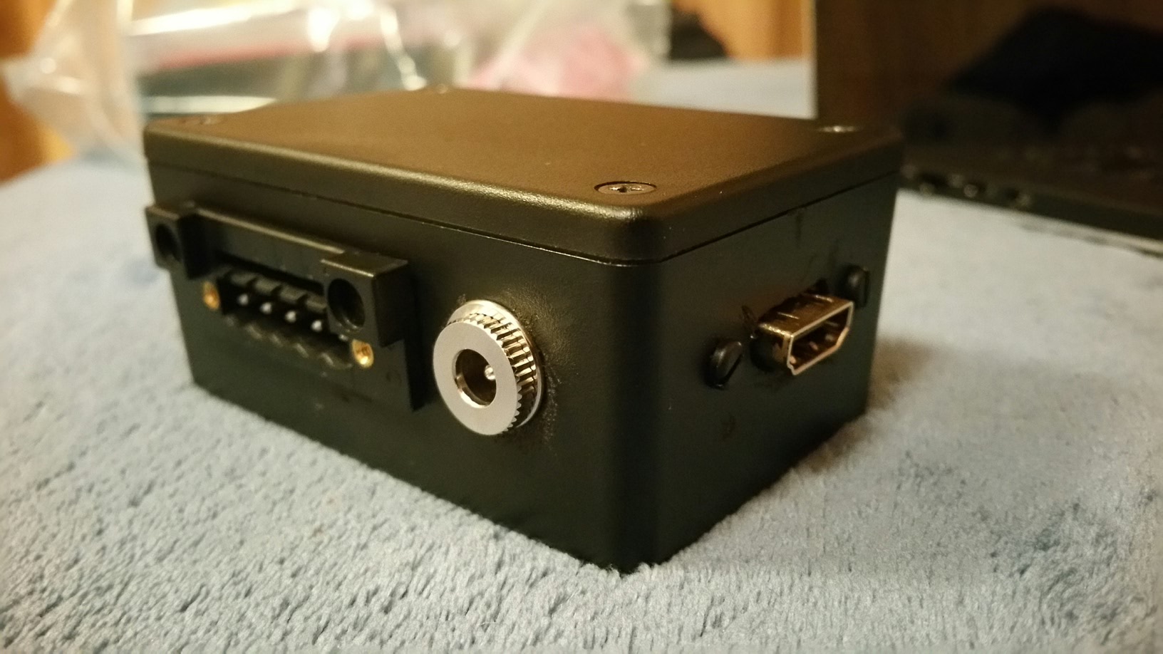

Posted: Sun Jun 12, 2016 10:52 pm
Yesss
This is working out nicely. The very first print was 99% successful. The box snapped together satisfyingly with no prost processing at all.
One small detail did not print on one half, but I suspect it will when I make it print a little more slowly/finer like I did on the other half.
Printing-wise the only thing I would want to improve is the finish on the top of the box. I'm not sure it is possible to improve, but I will try different materials and techniques in an attempt to improve that.
There was one component which I didnt have the dimensions of when I made the design, so I will have to make a small change or two to the design to accommodate that, but otherwise nothing needs to be changed.
I think the size is pretty reasonable.
The print quality is quite good in my opinion. The clamshell gap should close down on the finalized version, especially when it's fastened together with hardware and not just snapped together.

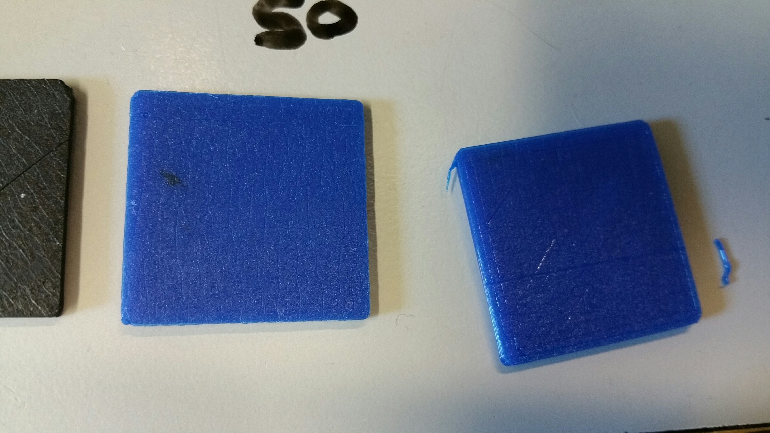

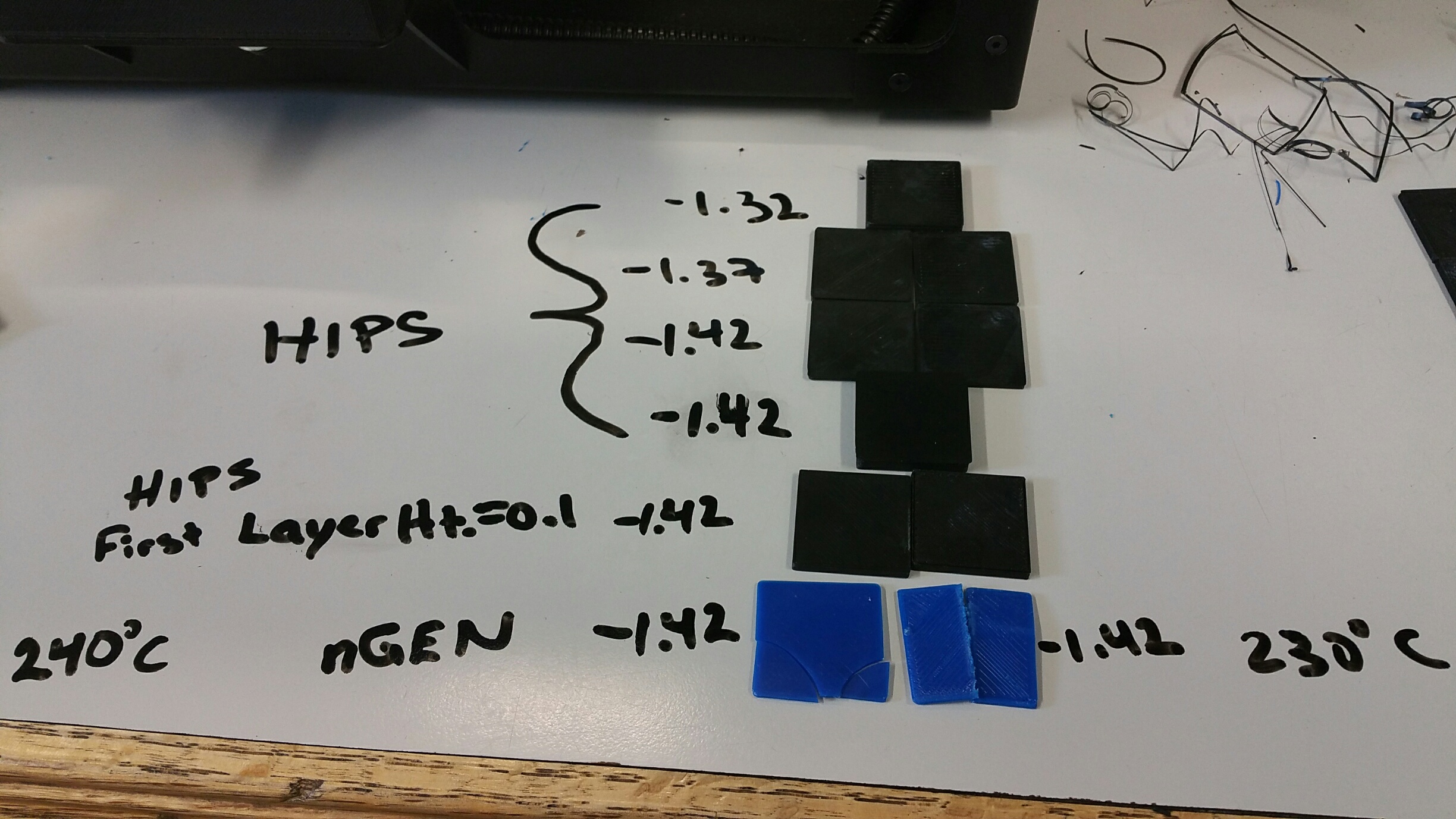

So I've been tweaking the design in very small areas and trying to optimize the prints. It's very easy to print on this printer, but getting the surface finish absolutely perfect is not easy. I've had some success getting perfectly smooth bottom and top surfaces, but not repeatably. I'm not sure what made them so good the one time the machine got it right for the two materials I'm interested in.
So far I've narrowed it down to two materials. High impact polystyrene (HIPS) and a co-polyester named nGen based on Eastman's Amphora 3300. The nGen has really nice properties, but is about 3x the cost of HIPS. The HIPS is awesome other than the fact that I've had trouble optimizing the flat surface finish and that it has been warping the parts such that there is a gap where the clamshell design meets. The warping is fairly minimal and the end result is pretty decent. If I could have the surface finish or that fixed, I'd be pretty happy. The surface finish has a chance to work out.
The nGen definitely does not warp as much, so the box fits together more nicely when printed with it. It has similar problems with the flat surface finish though. I'm printing a buttload of test squares to try and get to the bottom of it. For now, the only color of the nGen I have is blue.
The other materials have proven either too difficult to print (so far) or the properties just aren't sufficient. PLA for example is really nice to print with, but it will start to lose it's shape if left in a car on a hot summer day most likely. We can't have that!
Luckily I *just* got a pretty decent one with the nGen. I'm going to keep at 'er to make sure we can get some acceptable results.
Top right is similar to what I had before with the hips surface finish. Bottom right is the best I ever got with hips. Not sure how.
Bottom left is the best I got with the nGen. Top left is the latest print. Hopefully I can at least repeat that.

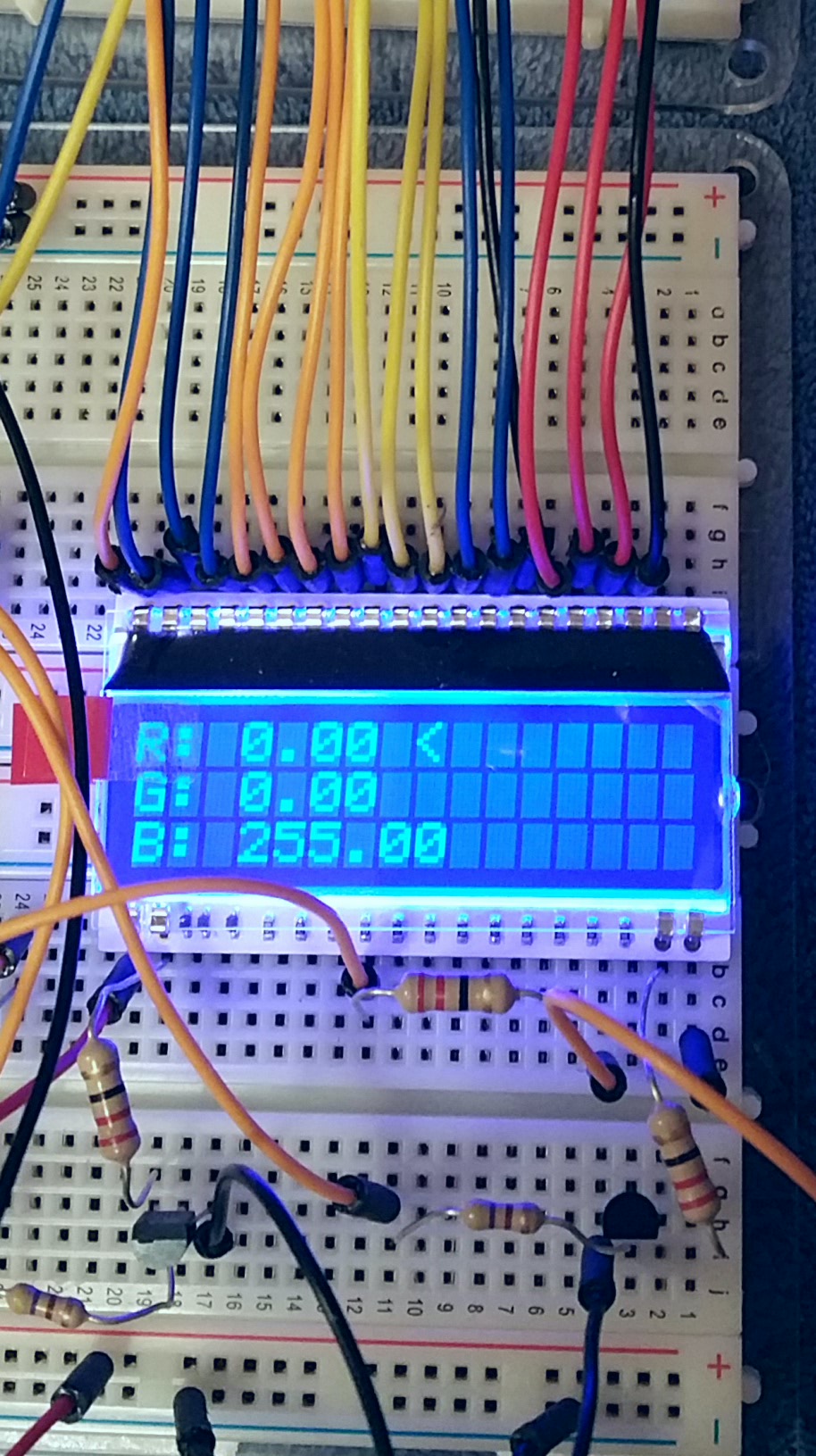

Tested the lcd screen via hdmi tonight. It was a success!

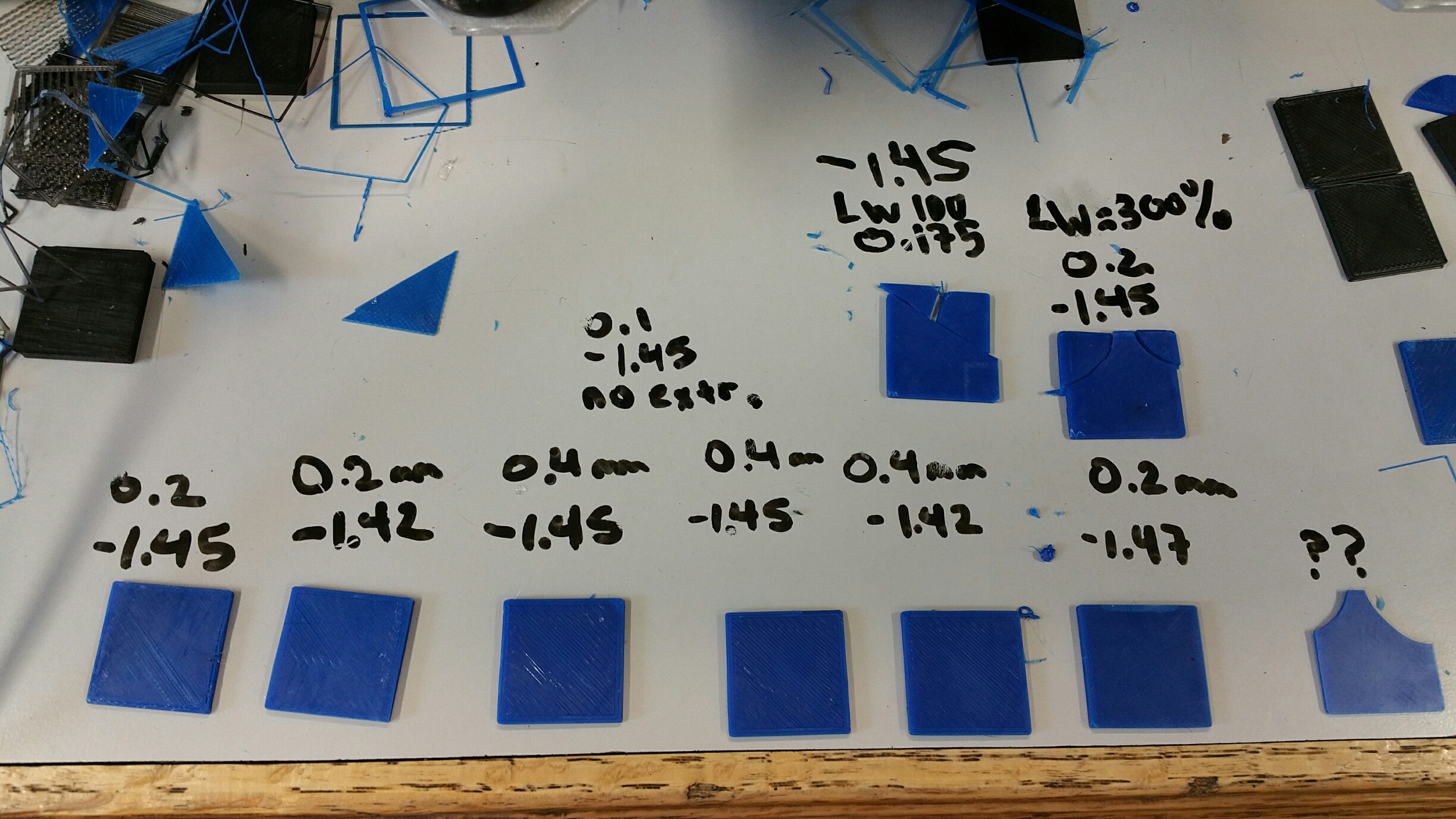

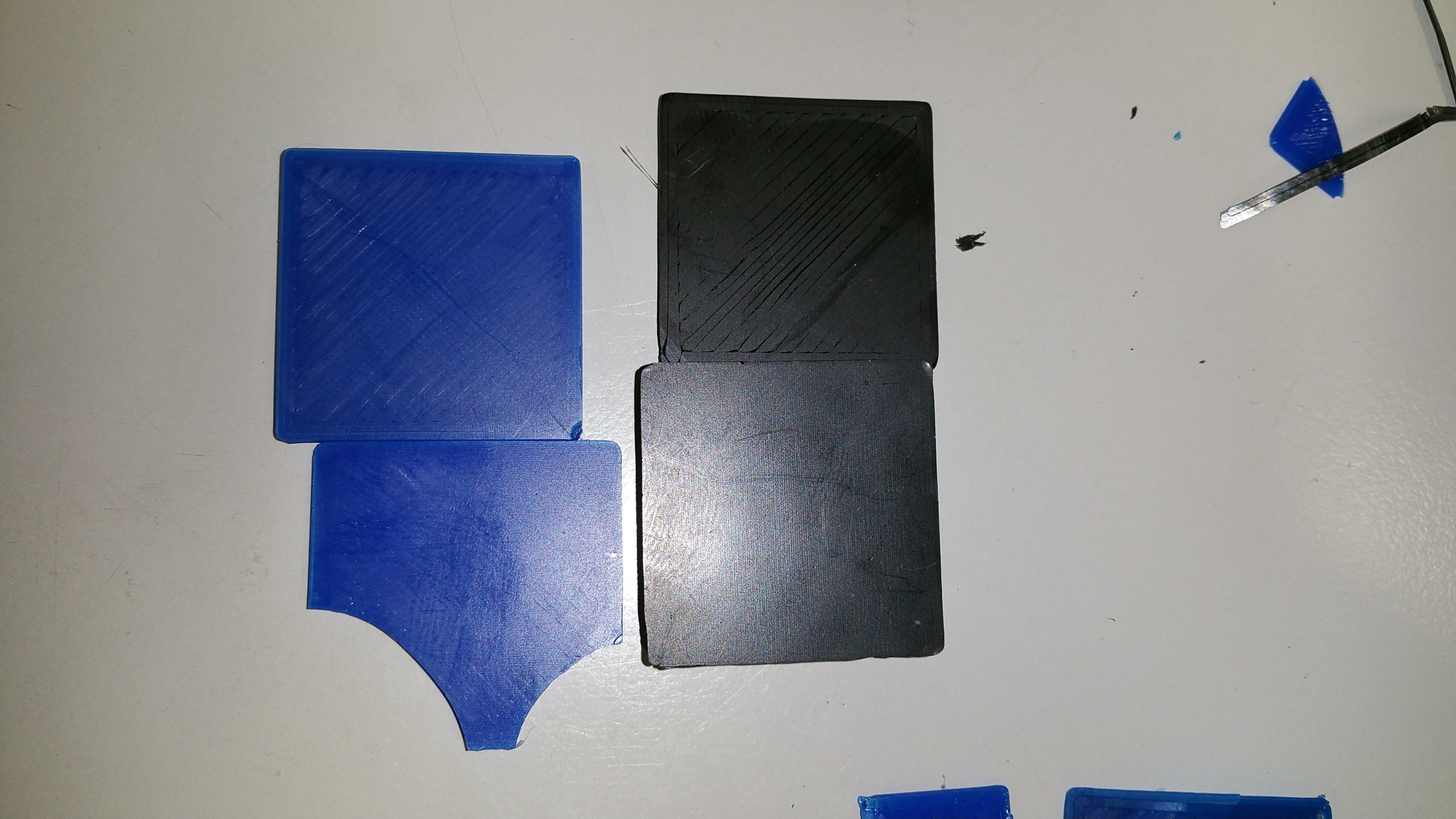

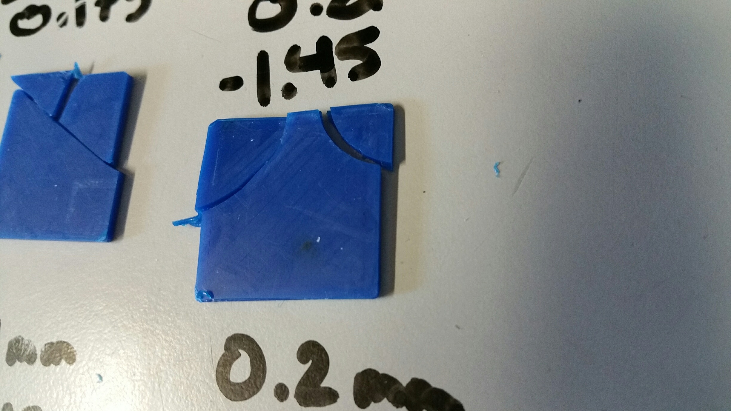

After extensive material testing, I have what I deem an acceptable solution.
Some pictures of the testing. I probably have 30-40 test parts like that for finish and durability assessment.
Durability testing. The finish was pretty close to something I'd like here, but you could still see the lines in the finish (through the first layer actually). When I got it totally perfect looking, that's when I had the next problem explained below.
I figured out how to get repeatable surface finish results with both materials (HIPS and the co-polyester). However when printing like that, especially with the co-polyester, it became extremely difficult to remove the part from the build plate. I tried removal at all different temperatures and even tried freezing the plate to get it off, but I ended up essentially having to chip it off in small pieces and then finally having to melt off the last little bit. It took me hours to get it all off.
The reason it stuck so well is due to the relatively large, flat surface area of the part, extremely consistent deposition and fusion of the material (smooth finish), material properties, and the build plate coating. So now I am using a different material to print on which gives the part a nice, uniform surface finish and allows for manageable removal of the part. It does however leave a textured finish on the part. I may try some other things along the way if a different surface finish is desired, but I like it actually and I hope you will too. If not, well... that's too bad for now I guess! I was looking for something which would be presentable in a professional product while keeping the process foolproof with no post-processing needed.
Here is the textured, but consistent surface finish I plan to use.
I have determined that using HIPS is out of the question for now because of the warping. I think a lot of it could be solved with an enclosed work space, but I am not equipped for that at this time. Plus, the co-polyester doesn't give anything up to it in terms of material properties. The co-polyester is heavier, but that contributes to a more quality feel anyway. The only drawback to it is price, but that isn't a huge factor in the grand pricing scheme.
The co-polyester I have is blue since I couldn't get black when I ordered it, but now that I know it is the material of choice, I will be ordering it in black for production (I will make it blue if you want though!).
Up next, figure out what to do with the wiring inside the box (trying to avoid a PCB) and how to do the same for the LCD to keep costs down.

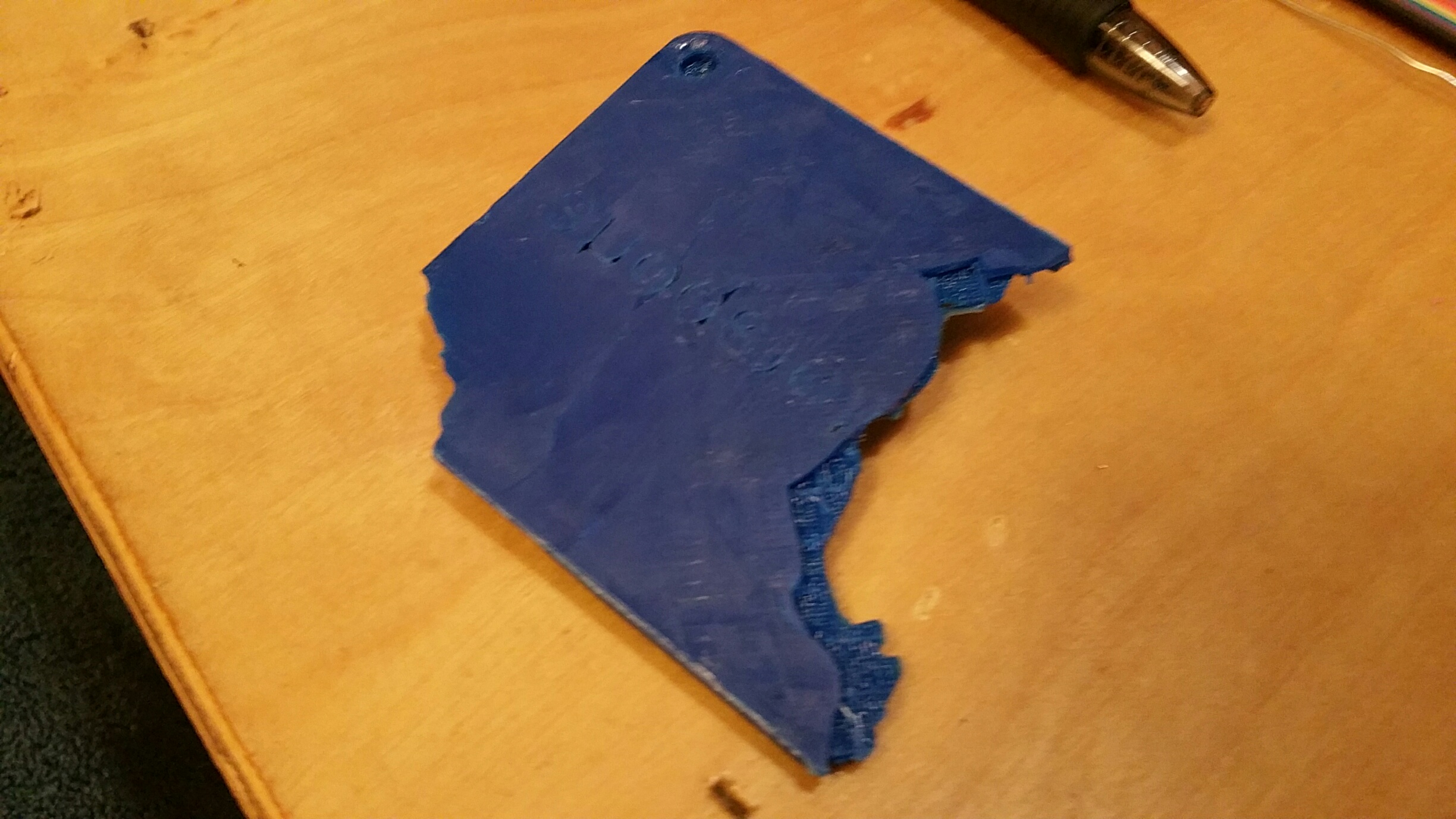

Posted: Tue Jun 28, 2016 12:06 pm
Here is a good demonstration of the warping issue with the HIPS material. This particular case of warping is due to the material lifting off of the less-sticky print surface I was using for the co-polyester, but it is present in other places in the part too. The co-polyester does warp a little bit too, but not as much and it allows for a nicer looking closure when the two parts are mated together.
Posted: Sat Jul 09, 2016 7:05 pm
oh man - it looks so good.
Simple question (Like always) have you tried reducing the print speed? I'm having a hard time believing it's warping that way. That looks like it has not had the proper time to cool before a new layer (just a thought!)
I have no use for one... but I want one! haha
Posted: Sat Jul 09, 2016 8:11 pm
The reason that one warped so much is becuase it lifted off of the print bed. The method I used for that part was better suited for the copolyester. I think controlling the print environment will help warping more than the layer speed will becuase I already have a minimum 20 sec layer time set for that material. I may experiment with it though. I think I want to insulate the machine first.
If I make the minimum layer time much longer, it'll probably hinder layer adhesion unfortunately. I think having the part cool down uniformly will be key. That said, the copolyester parts aren't even close to as bad about this, so I'm not extremely concerned at the moment.
