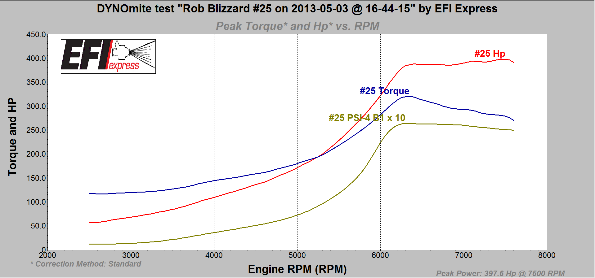

Sorry for the delay on getting you the graphs Rob. I was away at lemons this weekend. the boost curve will be improved with N75 control once the drop-out is sorted (I still suspect some form of cam offset problem). As you can see here, the manual boost controller thats in there isn't holding boost very flat.
- rob_blizzard_400hp.png (70.87 KiB) Viewed 38028 times
Re: roortube's UrS6 Avant...billet 35r ish driving impressio
6k! Something is wonky dude.
That is when my HX52 (aka huge diesel turbo) was getting 25 psi. Something is definitely wonky! I'm sure it is still fun though!

Easy with freaking out on the "dyno says I am getting full boost by 6000rpm" mindset. If you overlap this with a HTA3582r like Ed's that was performed on the same dyno, the similarly sized wheels(HTA3582r 59.5mm and this 60-1 59mm wheel) manage to spool very close to eachother. Dynos are ultimate tools for calibration and simulating load, but they do not ever 100% represent road conditions.

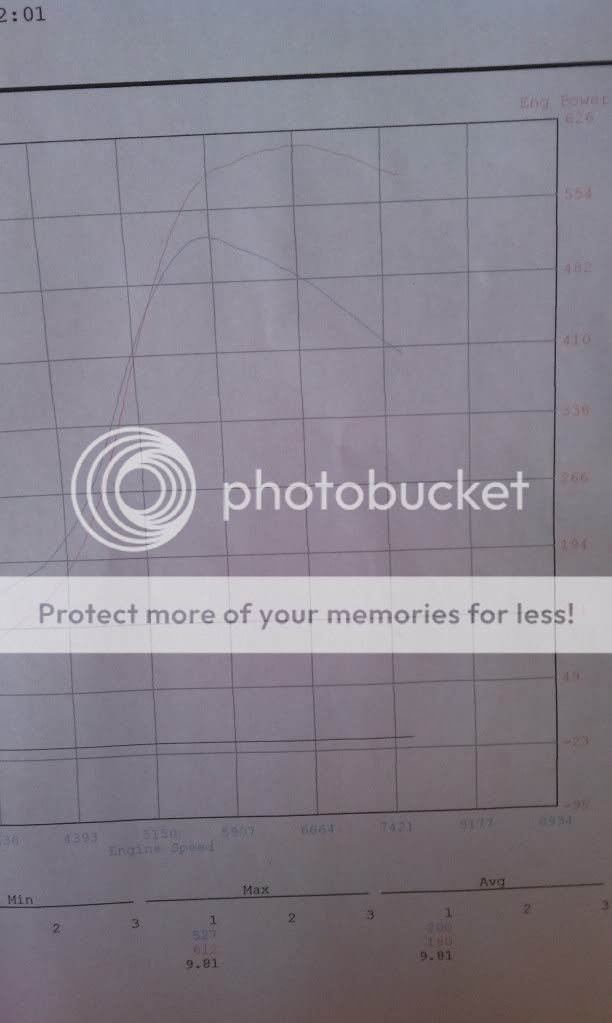

My own 2.2L on e85 in 4th gear
Vs my dyno in 4th gear.
25psi and 400whp is probably 30-40whp less than what I would have guessed, but there are other variables to consider. I have been high on e85 for to long to make rational estimation of power!

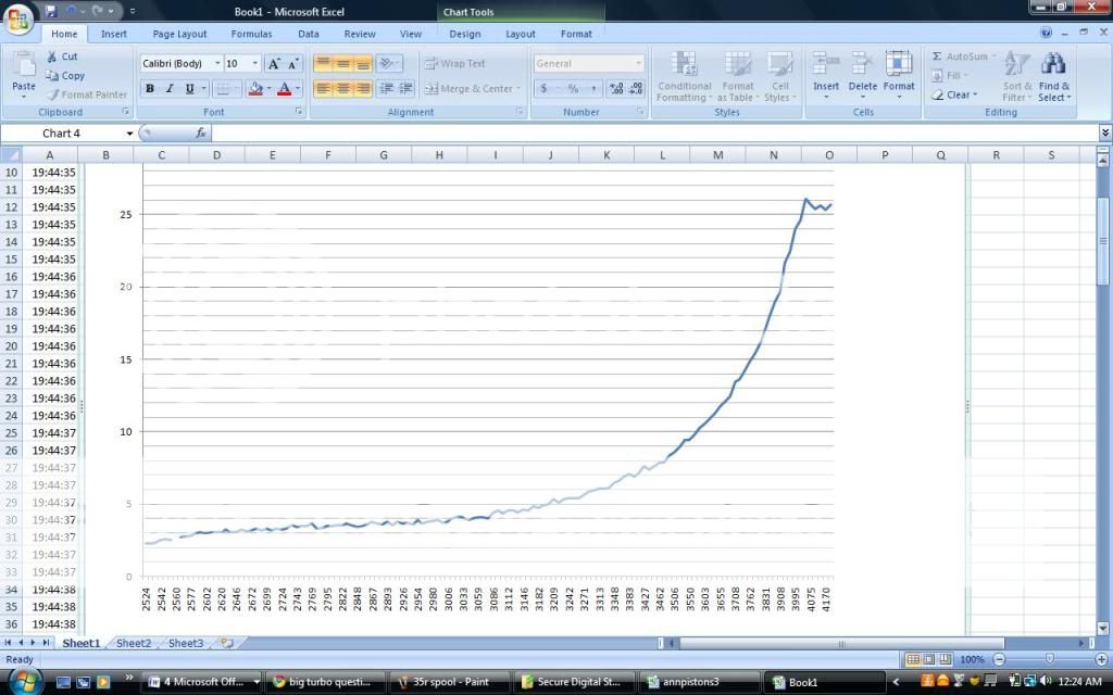

That is true but note that we had a known final drive calibration issue (didn't calibrate) with my car...which explains why it was showing so late on the dyno graph. I don't think that is the case for Rob's car. Coupled with his description of "below 3500rpm the car feels like it has a 2.0 8v under hood" makes me think there is actually something wrong.
Fortunately in my case it is easy to compare the VEMS logs with the dyno logs and see that there is a clear disconnect (dyno was seeing 8000 rpm while the actual rpm was 6500).
Right, but that would reflect less HP than indicated. If you run the formula for HP( RPMxtorque/5252) you will see that while spool would improve incrementally on an incorrect cal, hp would decrease. Also it would not be a 1500 increase in spool as it would be a ratio, much like a MPH gap in ratios as you increase engine speed.
I too think there is something wonky going on with Robs car. 5000 RPM street spool is still unacceptable to me for those sizes of wheels.
Yes, but it was nowhere close to a complete tune. We stopped as soon as we discovered the fuel pressure issue, never got to tune boost and didn't even touch the spark map. That plus the calibration issue make the numbers irrelevant/useless.

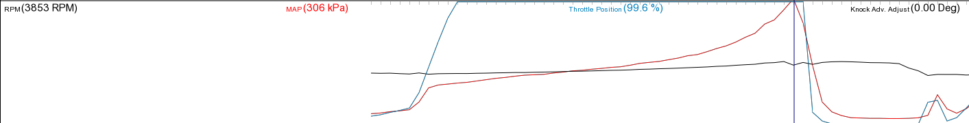

Don't know what the dyno "should" have shown for spool, but it should be wayyy to the left. Maybe even more than 1500rpms - dyno shows 30psi @ about 6,100rpms while my street log shows 30psi @ 3,850rpms (both 4th gear). There were changes to the boost settings after the dyno though, so it is a combination of factors.

Now this sounds like fun on the street...EDIGREG wrote:my street log shows 30psi @ 3,850rpms (both 4th gear).]
