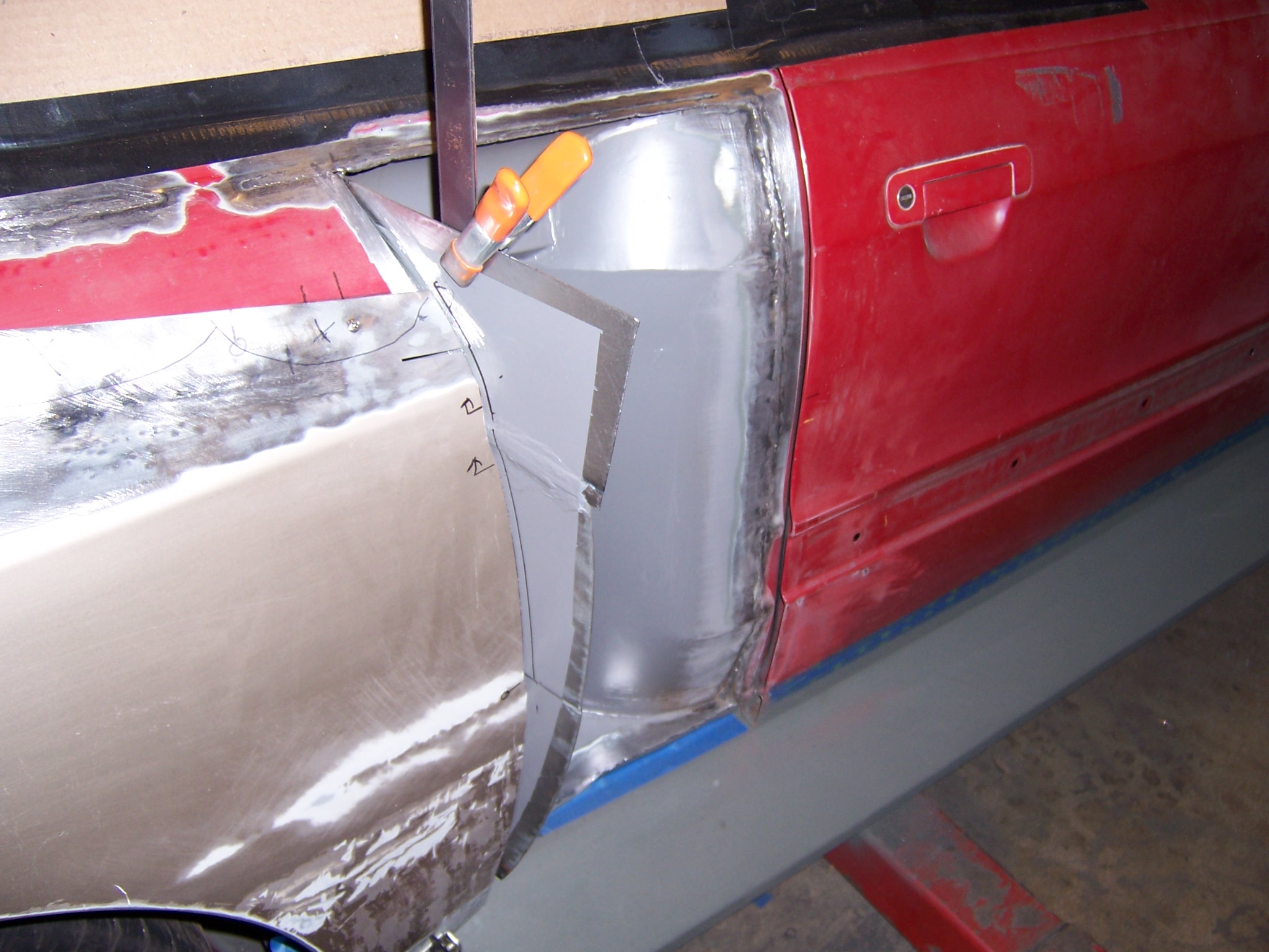

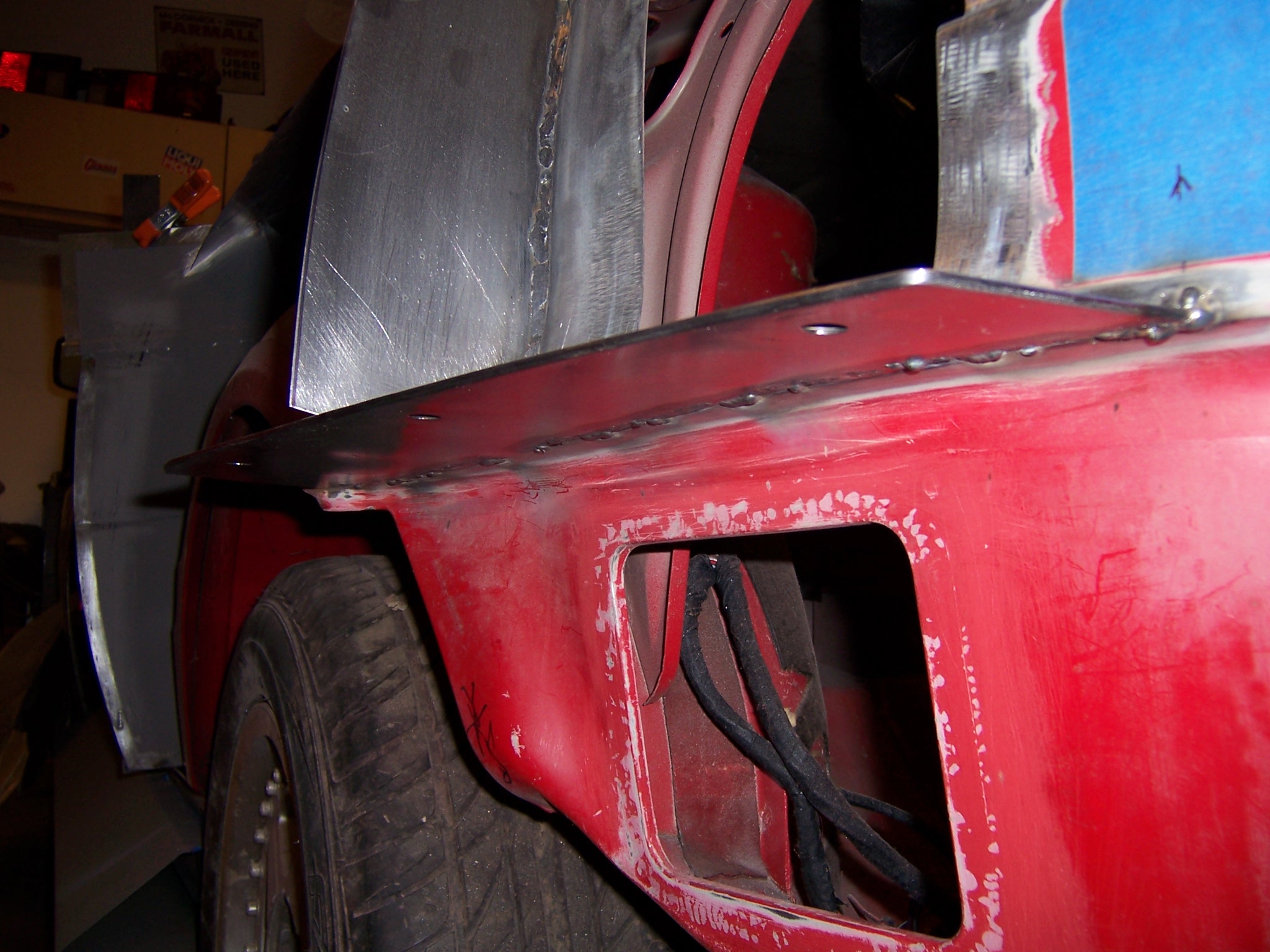

Welded most of the slots left in the car
Fender slots welded for the most part and patch panel on pass. side
One of the Radiator outlets is framed in and welded
Also cut down the Tailight to make room for more RAD. outlets :idunno:

Side Rad. air outlets are done so I can weld on the rear quarters. This is why I had to cut the taillights down.
Self satisfaction pic.
Still need some more adjustments on the quarters before the final welding. I am probably going to do the air intakes next and then get the rears on.

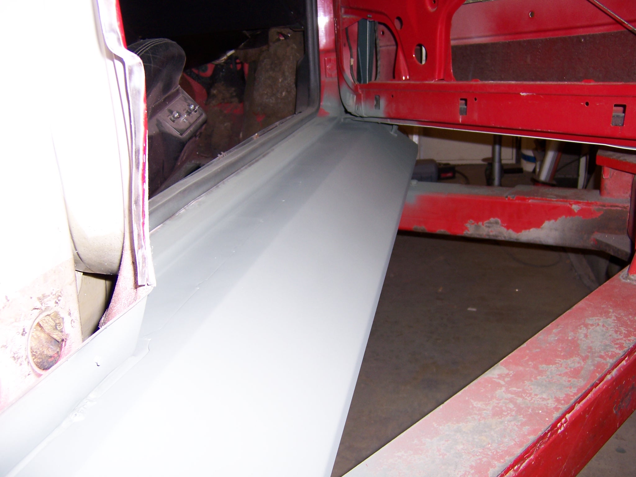

Since Rad. inlet is now on rev.B I needed some more metal, and cutting the roof of the Porsche for the metal was going to leave me
still needing rocker panels. I had some metal cut and bent along with some other stuff. For the revision of the Rad. intake I had to put the rockers on first to get some hard targets for more sheet metal work. Also managed to add some more panels to the Rad. air intake to make some headway there, but I don't have any pictures of that. These intake panels are welded in a boxlike structure that is removable so I can paint the whole thing before it gets welded in.
Prepping for rocker install
Bottom of door extended and rocker on
Front: Not sure what to do there yet

Other rocker is on to
To bad there is a slope in those, if they where straight they would make a pretty good workbench. Also made some more progress on the Rad intake.

Working on the side Rad outlets ,so I can get the rear fenders on. I know that I told you guys that the rear fenders are going on after the Rad intakes where done ,but i forgot the side outlets needed attention as well. :shame:
So the taillights I had cut down sometime ago went back in the car for some sheet metal work.
Added a barrier behind tai light to close things up.
This is how much the tail light gave up to make this all fit
A few more pieces of metal to add in the rear to keep water out ,seam seal ,paint ,fiberglass work. And the rear fenders are going on for realzzzzzz!!!!!!!!!!!!
Also there are no more slots in the car that I had to cut to pull the sheet metal where it had to go ,they are all welded.
