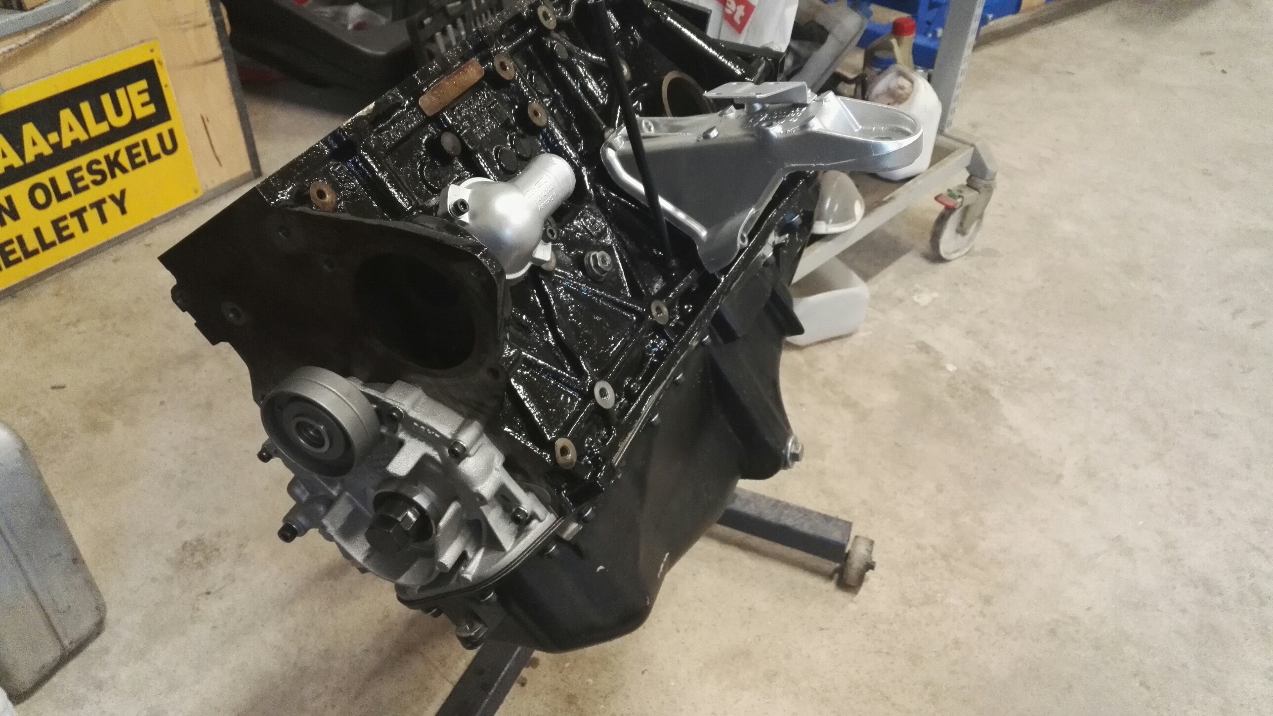

Got the stroker block from the machineshop, waiting for head to be ready. Might start to assemble the block slowly..

1. Old engine and trans out, all of the pistons have substantial side rocking at tdc, explains the blow by?
2. New bottom end mostly assembled with everything new and in upper end of clearances

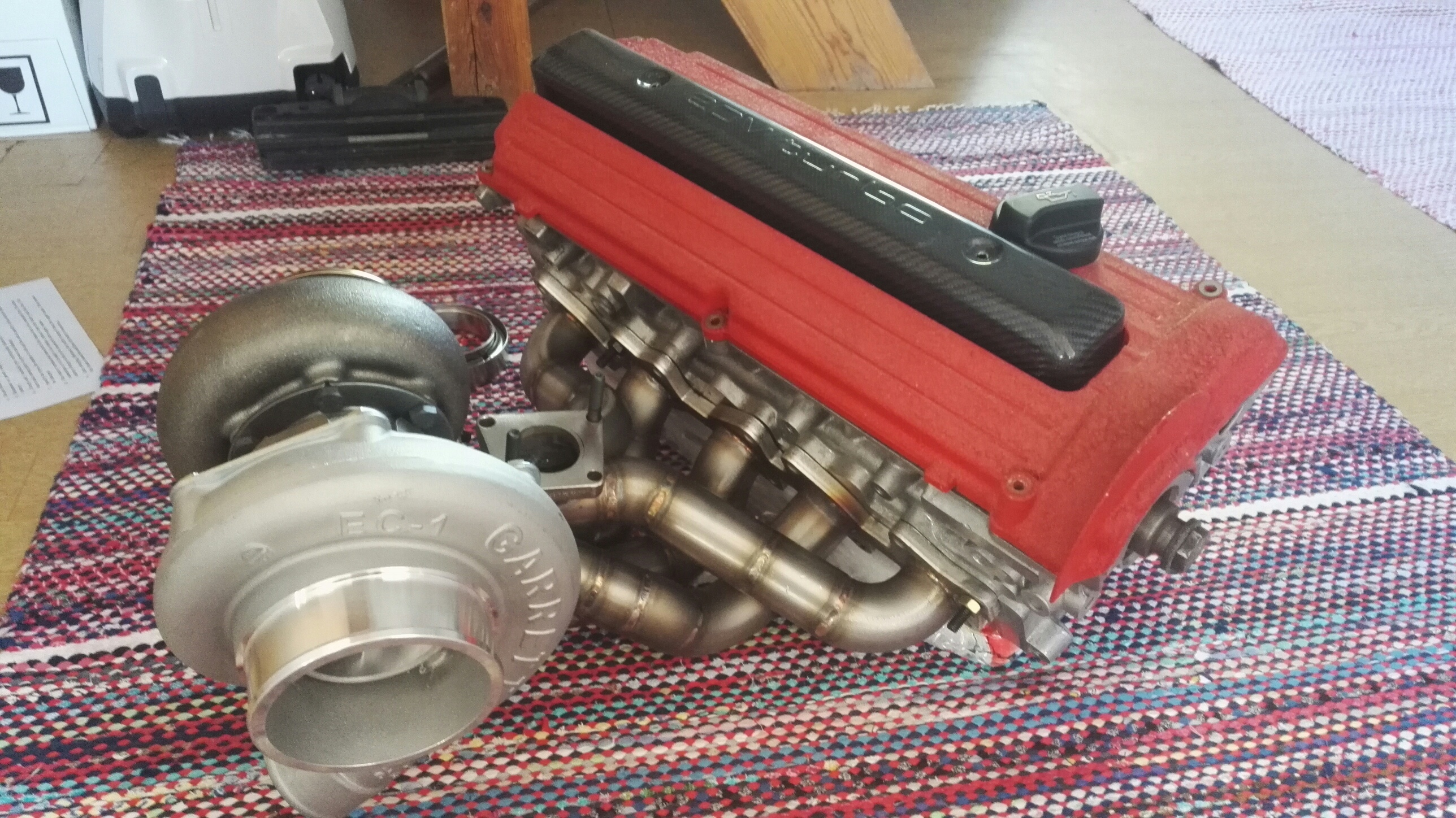

4. EFR turbo changed to GTW garret by recommendations by experts, GTW3884R on shelf waiting for the head to find it's place
5. Tube header waiting for EGT nipples, downpipe for BN-Pipes 2x2.25 full system and maybe a heat wrapping as well?

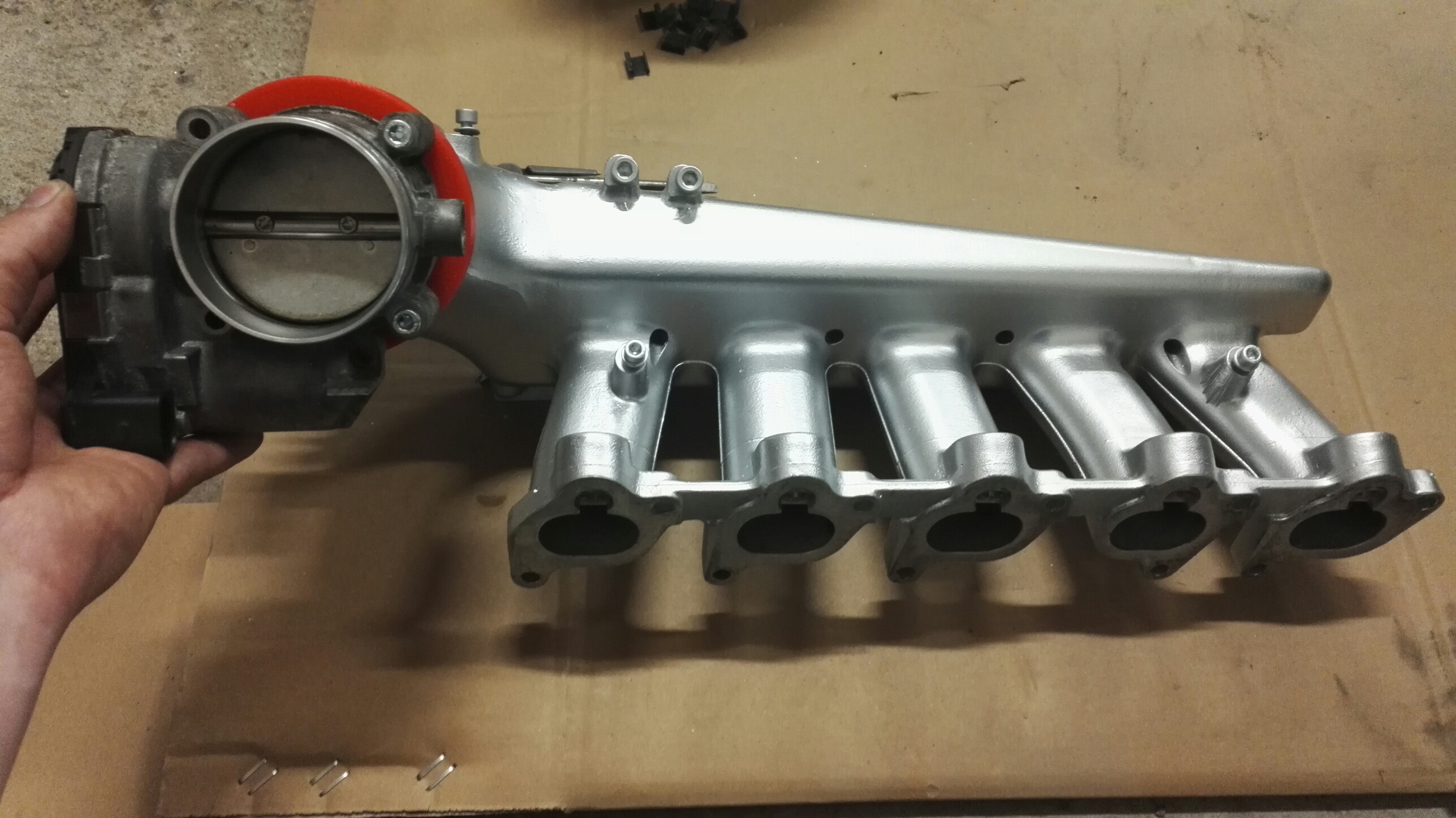

6. Engine needs some wiring for VW Lupo 60-2 trigger, typ44 1T electronic throttle pedal + 70mm RS4 throttle plate (WOT shifting at 1/4 mile)
