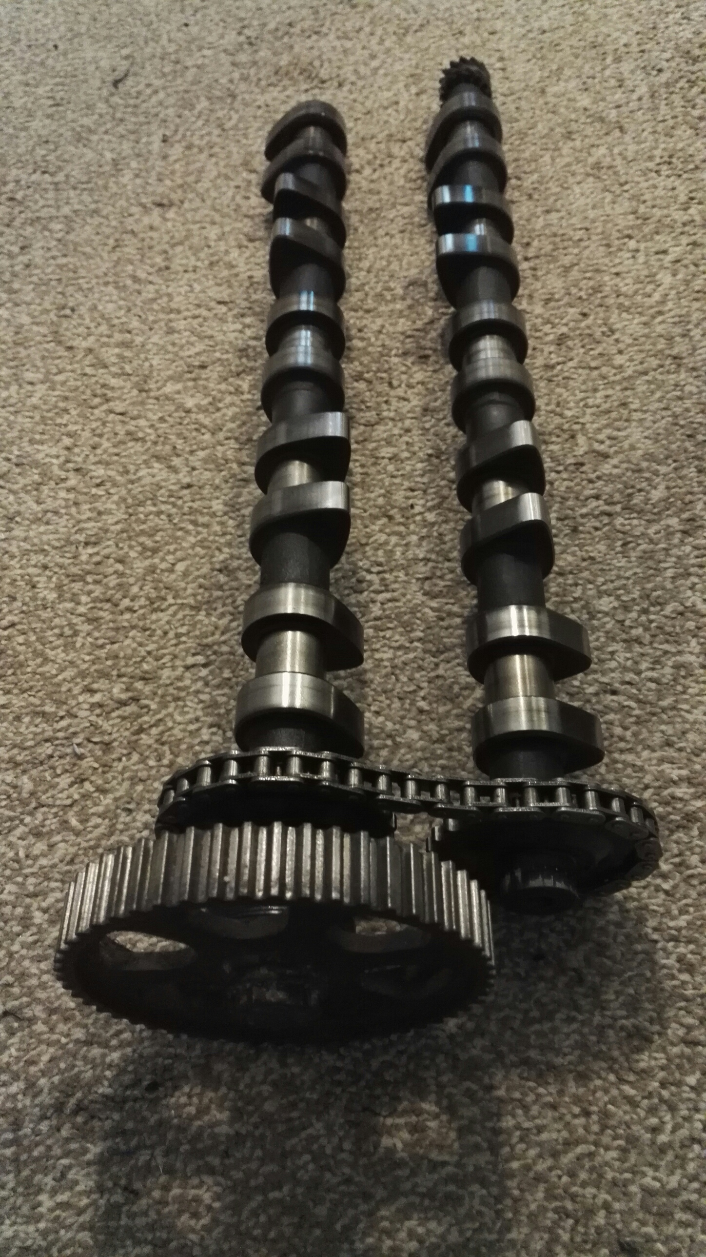

7A cams from same guy who sold me 200 20v flywheel and 7A dampner.

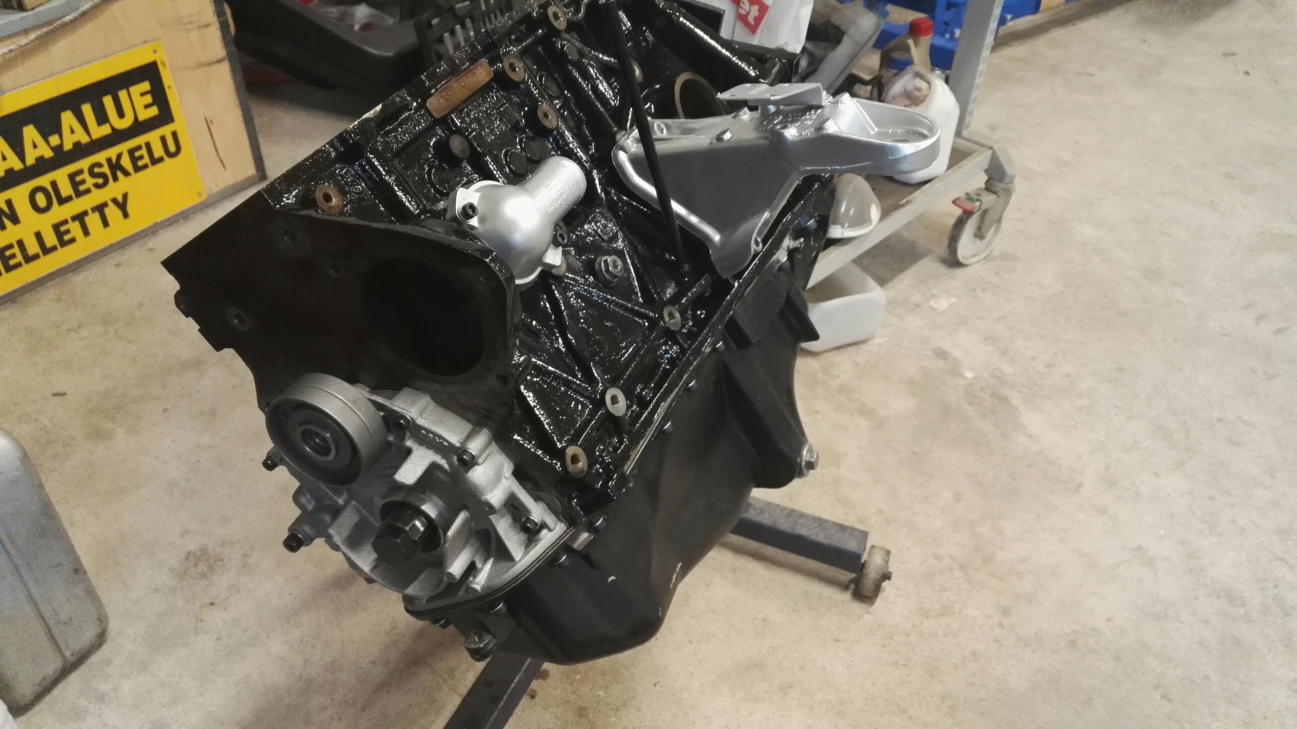

Got the stroker block from the machineshop, waiting for head to be ready. Might start to assemble the block slowly..

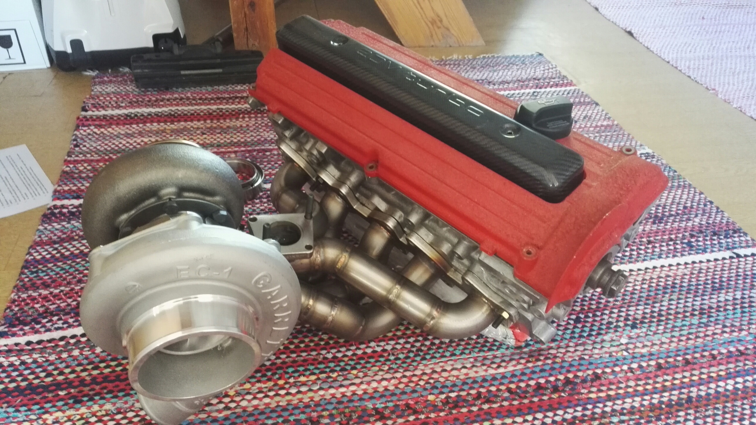

4. EFR turbo changed to GTW garret by recommendations by experts, GTW3884R on shelf waiting for the head to find it's place
5. Tube header waiting for EGT nipples, downpipe for BN-Pipes 2x2.25 full system and maybe a heat wrapping as well?

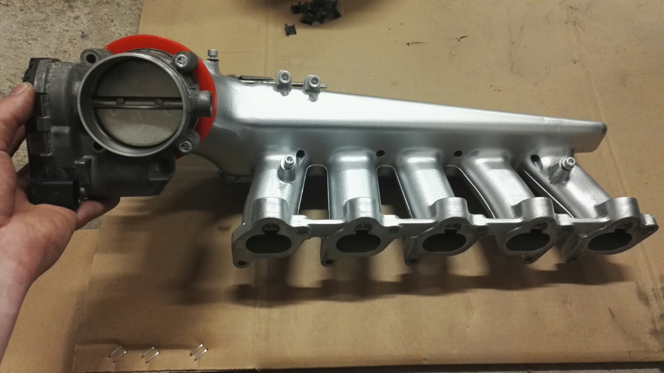

6. Engine needs some wiring for VW Lupo 60-2 trigger, typ44 1T electronic throttle pedal + 70mm RS4 throttle plate (WOT shifting at 1/4 mile)

This thing started with a new heart today.
ACV 2.5 tdi block + 7A head and cams paired to Garret GTW3884R 62/64 and 01E from a tdi A4 B5.
I have to say I'm quite happy, this is the first engine I've built from scratch and it started right away. :)
Ran it to temp and re-torqued the head studs.
Some more wrenching tomorrow. :P
