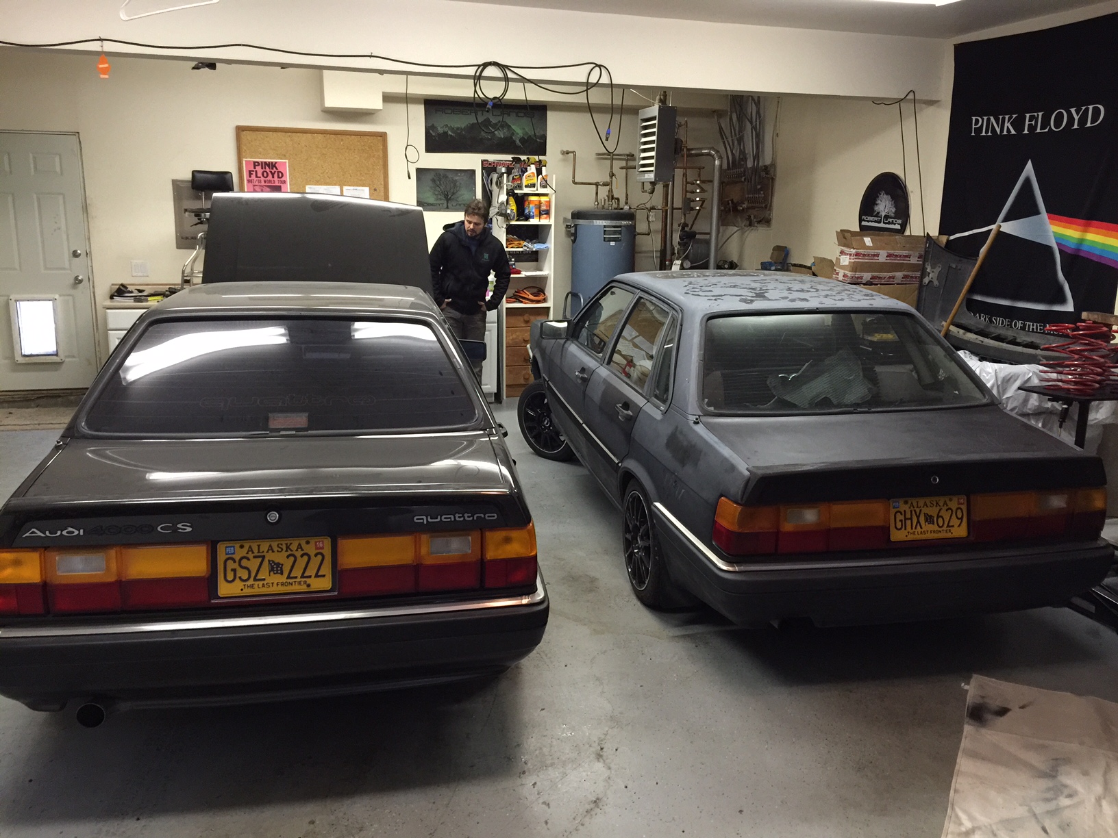

We got a 3B for another conversion. (Blow me Taco) Going to start swapping this into my buddies "Flat Black 4K."
Here is a pic of the strut tower brace we installed on my 4K
We have everything for the 3B conversion except the flywheel and the coil. Coil should be on the way but we may need one.
Going Motronic on this.

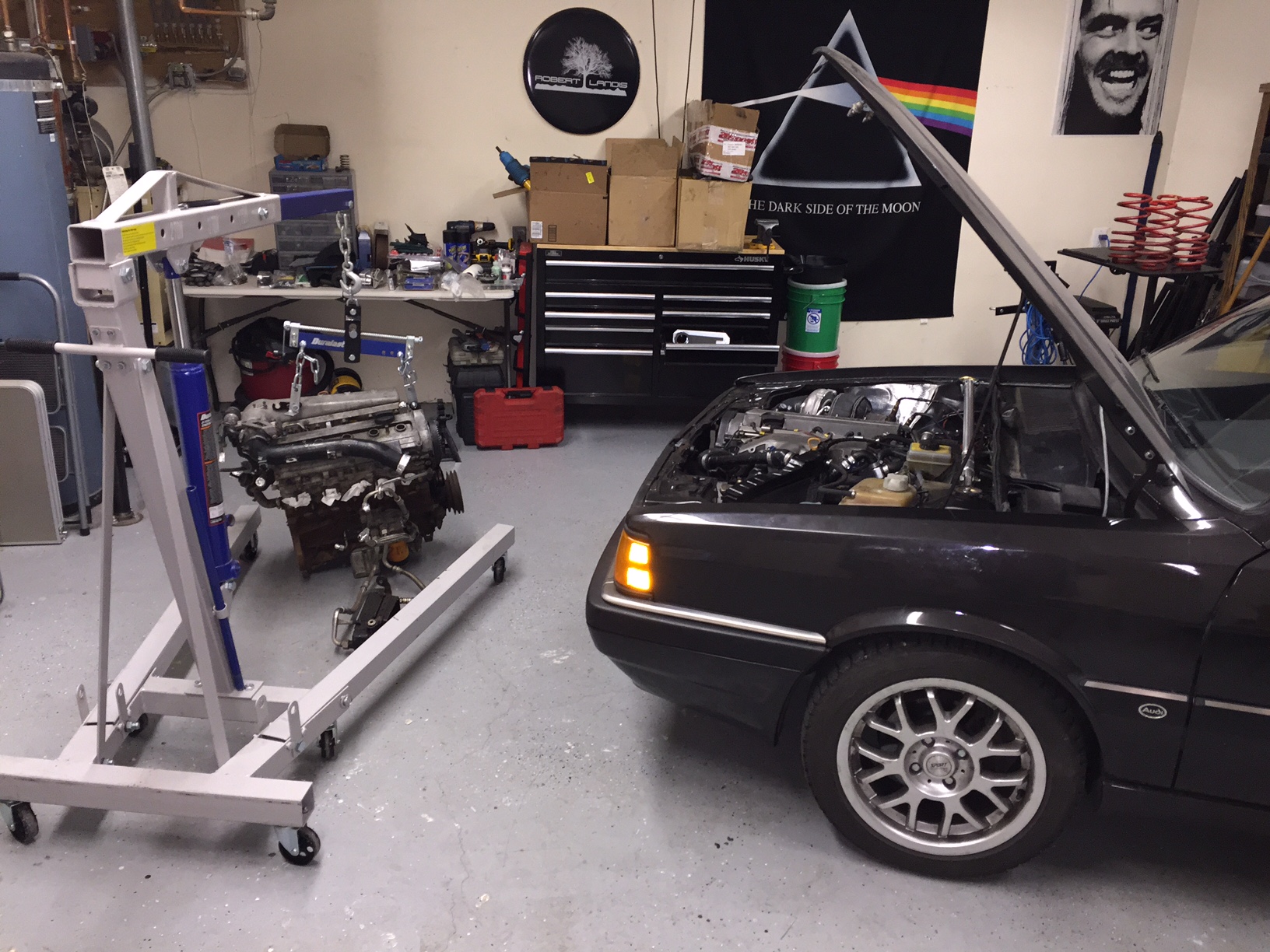

Apprently since my last post I have gotten some stuff done.
3b swapped a 4K we brought back to life just prior to the owner junking it.
Swapped out the old grey cloth with some Quattro script we found in another car about to be junked as well....
Then we swapped the motor and did a Gt3071/RS2 EM/IROZ Exhaust ect... swap on my brothers S6 avant. The motor that was in it was done. Heavy scaring on #5 cylinder and pretty much all valves in the head were loose to the touch with major surface damage in all the domes.

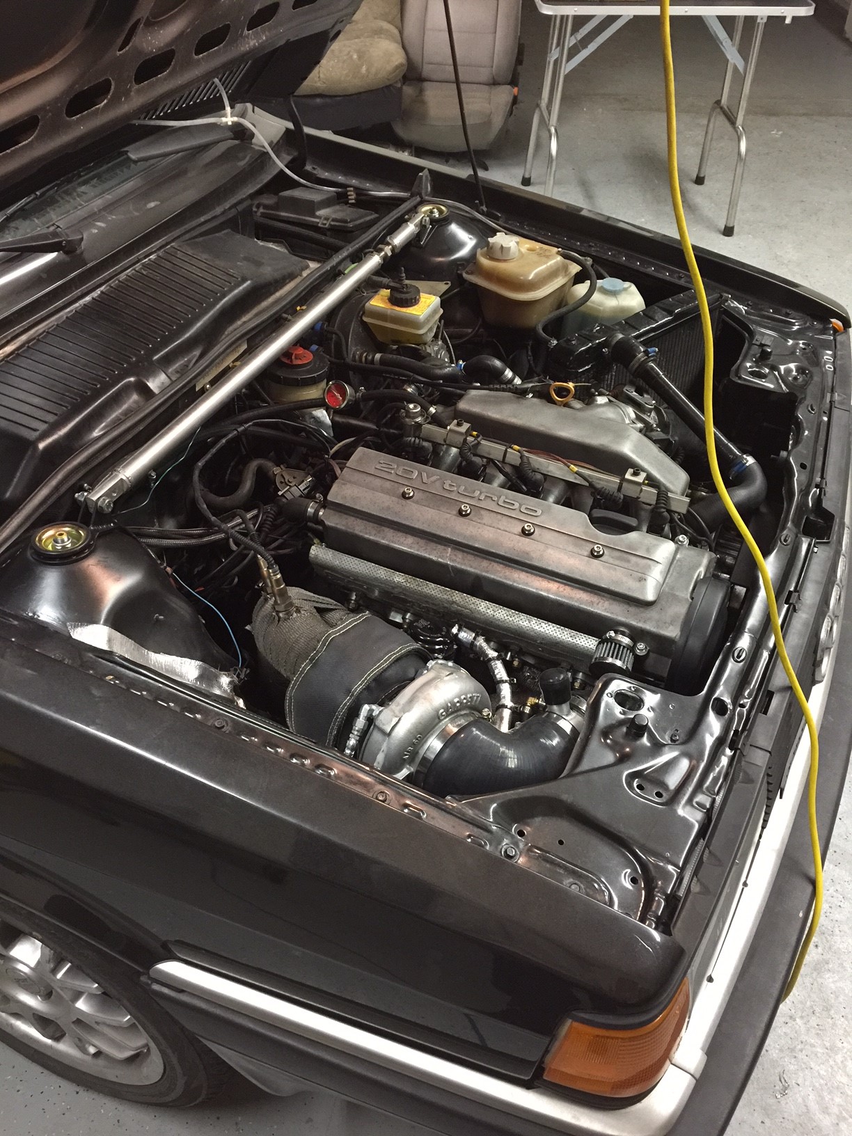

Then I got up with Marc Swanson and had him write me a tune for a GTX 3071 on my S4000 while I pulled the 11c out and installed the Motronic.
I also added a much needed oil cooler and a much larger radiator.
Of course there were tons of hiccups from clutch/flywheel order fuck ups to a bad ECU but everything was eventually worked out.
