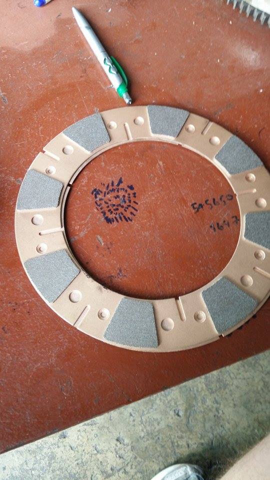

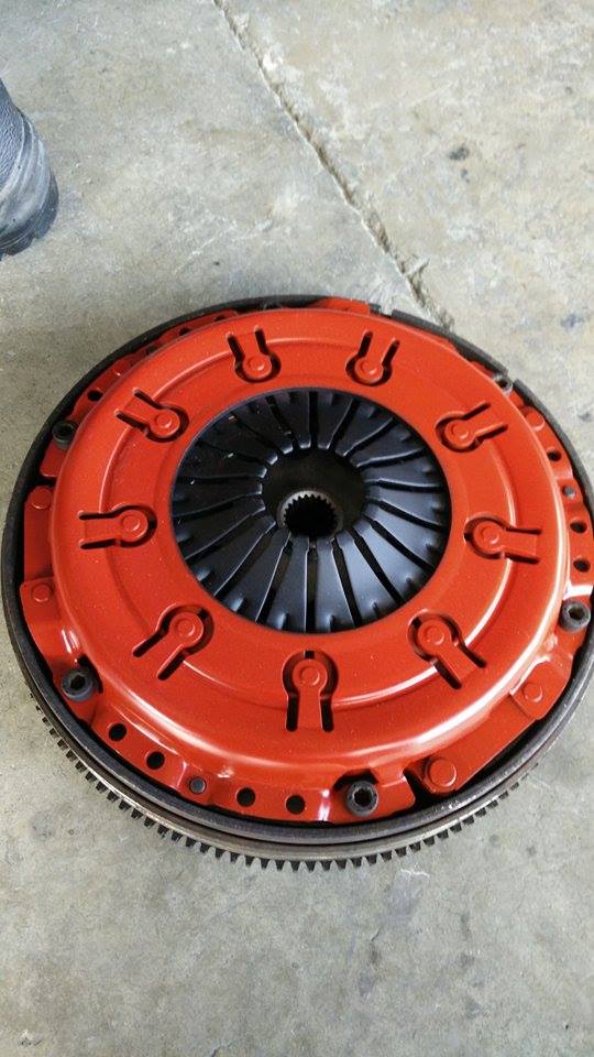

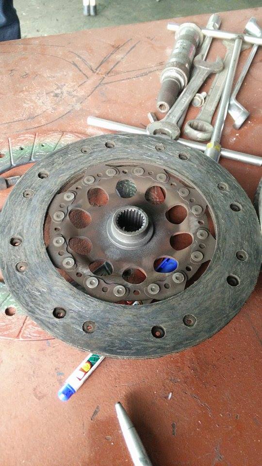

Dropped the FW and clutch package off at the shop today.
My trans has code DJJ, BTW. According to the manual it has final drive 3.889, but it should be 4.111. The rear diff is 4.111, so it must be true.
The new friction discs will be swapped over onto the original disc. This shop is used by all the local diesel drag truck guys. Friend of mine has used them before for his AEB and vouches for them.
Surfaces will be cleaned. Oil all over the bellhousing due to leaky rear main seal. The TO and pilot bearing will be replaced, too.
Some pics.
stock FW.jpg (63.98 KiB) Viewed 67291 times
pressure plate.jpg (90.74 KiB) Viewed 67291 times
new friction discs.jpg (77.68 KiB) Viewed 67291 times
friction disc.jpg (91.06 KiB) Viewed 67291 times

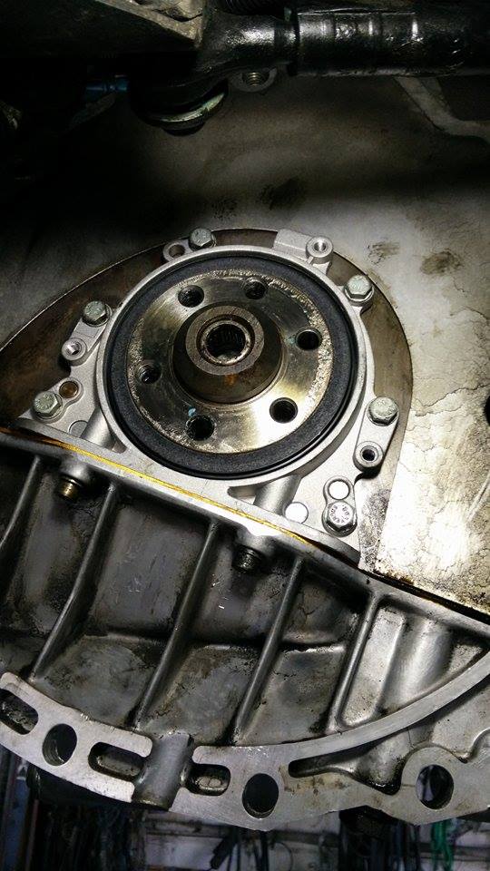

Clutch was done sooner than expected. It is being put in today.
However, we found out that one of the drive shaft CV joints was bad. The rubber sleeve was gone and the CV almost dry! :bangshead: Managed to find another.
Also found out for sure that I don't have 4.111 final drive at all. :shame: Its 3.889. Trans code DJJ, rear diff code DAJ.
new rear main seal.jpg (88.89 KiB) Viewed 67237 times

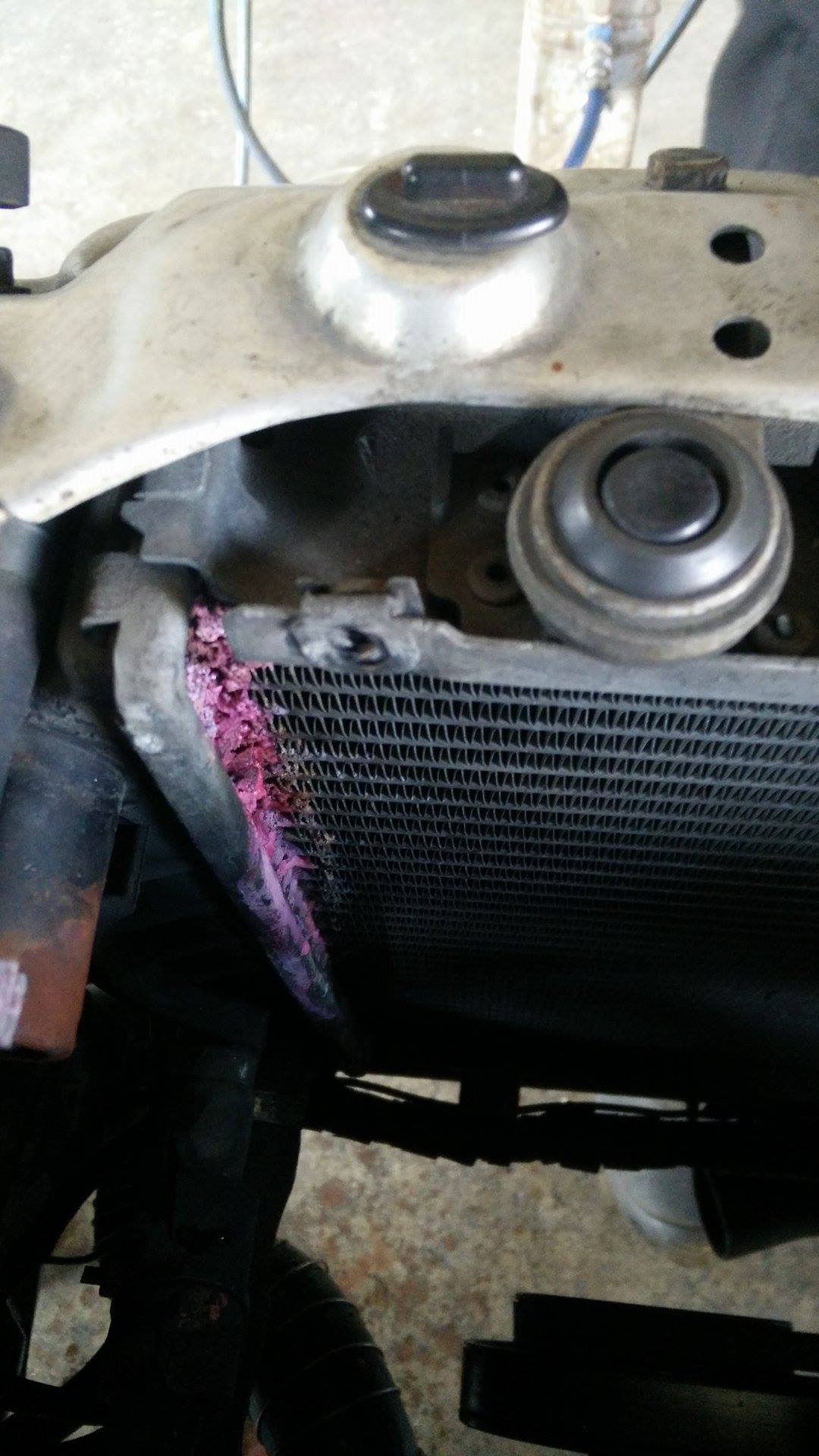

While doing the timing belt service, I ran into another issue. Leaking rad. Not the end tanks, but still wanted to replace it.
Turns out getting a custom made all alloy rad made here is cheaper than a Nissen replacement rad with plastic end tanks.
Installed a catch can, too.

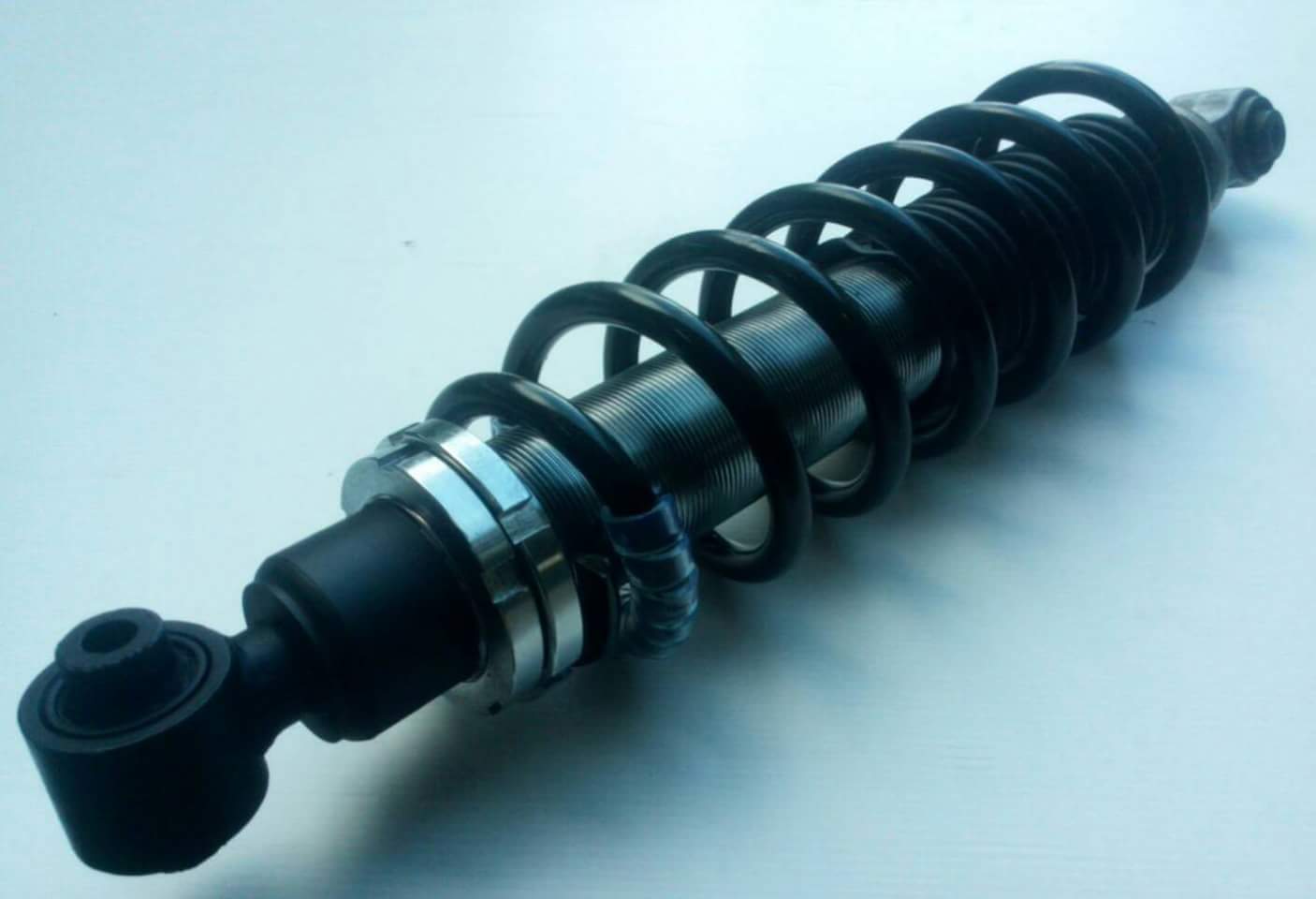

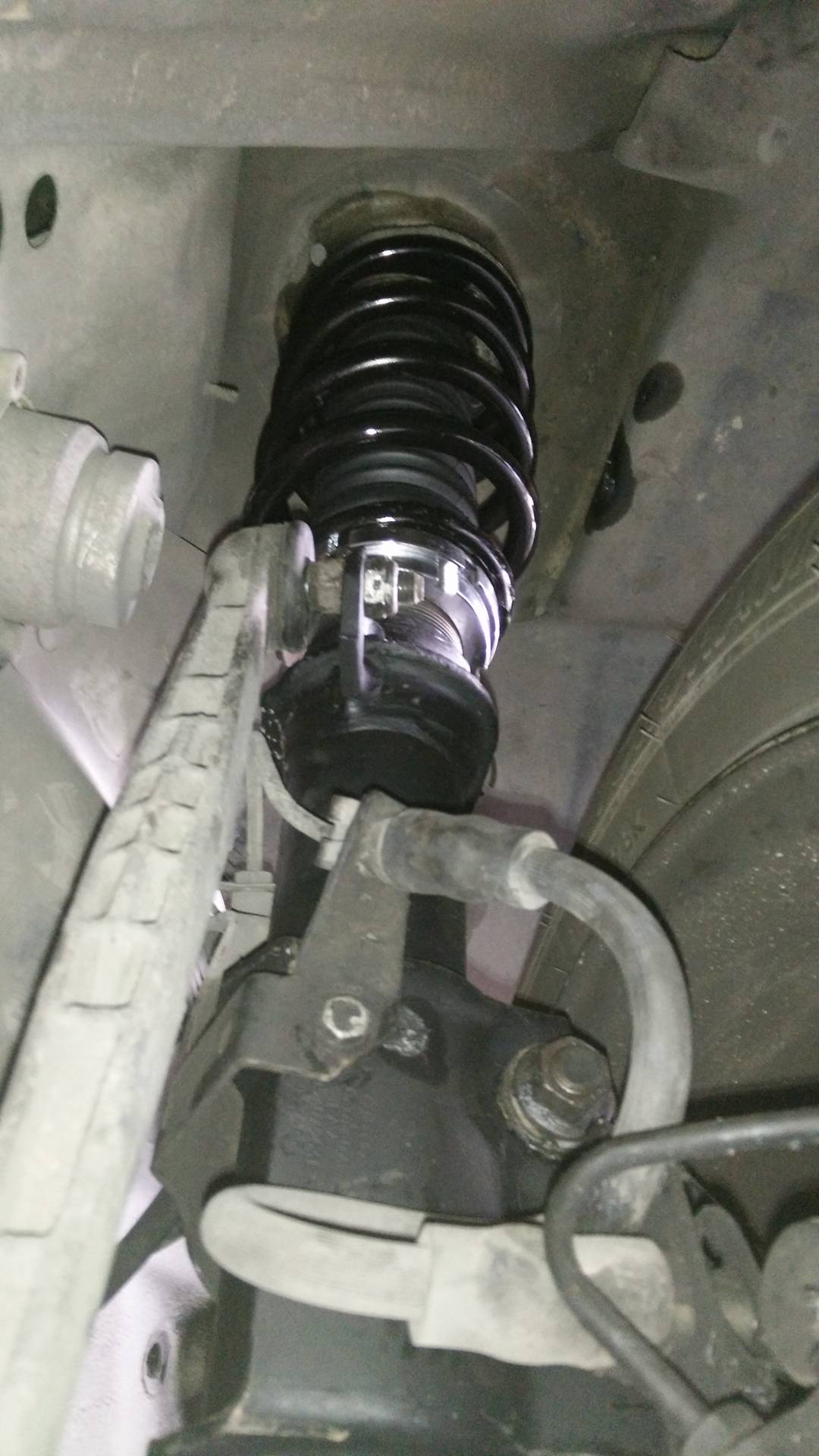

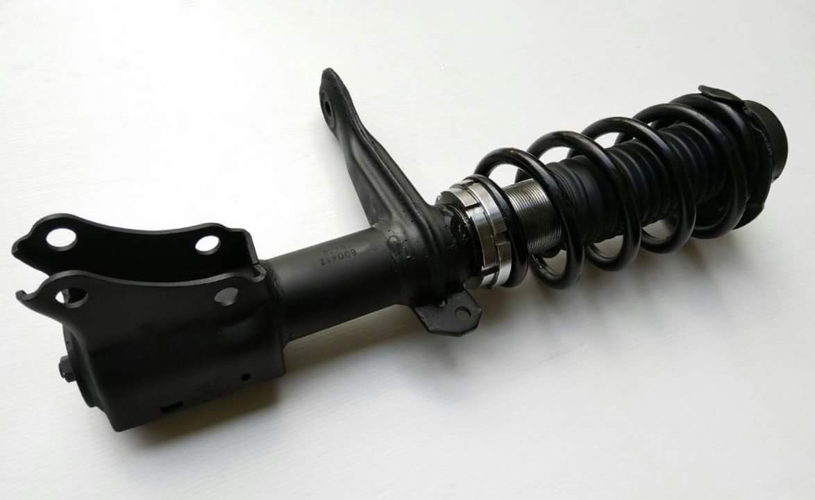

Picked up the car from the suspension shop today!
It now has custom Monroe coil overs. Don't know the exact specs. The ride is firm, but not harsh. A tad higher than before. Way better than the mismatched set up I had before (Weitec springs and KW shocks front, stock B5Q sport springs and shocks rear).
I post a side view picture later. Forgot to take that.
Pics.

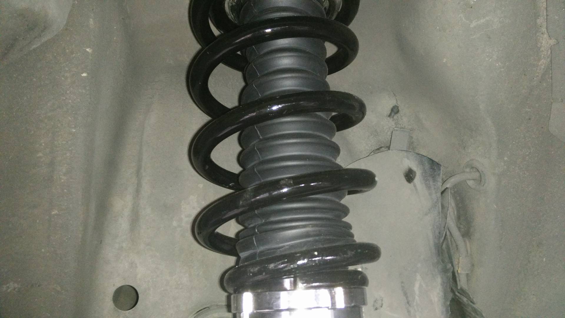

Posts: 875
Location: Bangkok, Thailand
Re: B4Q 80-AEB; Custom Coil Overs!
Post by ChrisAudi80 »
Some more pictures.

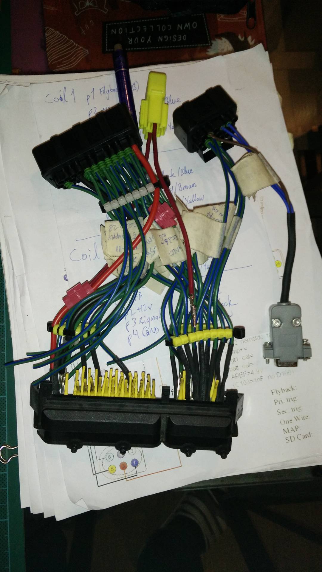

Re: B4Q 80-AEB; VEMS PnP adapter
Been working on making a EconoSeal to Motronic adapter. The Jake W adapter sheet has been very helpful. Making it was fun. Got a lot of help from my teacher/buddy Kot.
Decided that having to route through the firewall a fully terminated harness meant for a VW 1.8T was too much hassle. I did have to go through the harness to check the pin out. That was very educational.
So now I have to try and sell a very nice Lugtronic-made VEMS harness for a 1.8T.
I know the dust plugs are not all the way in, but the wire was just a little too thick. I will have to route the wideband harness through later. I also have an EGT probe I will wire in.
The car is now back to stock power (besides the AAN injectors and E85), no more piggyback. Its soooo slow now. :shame:
