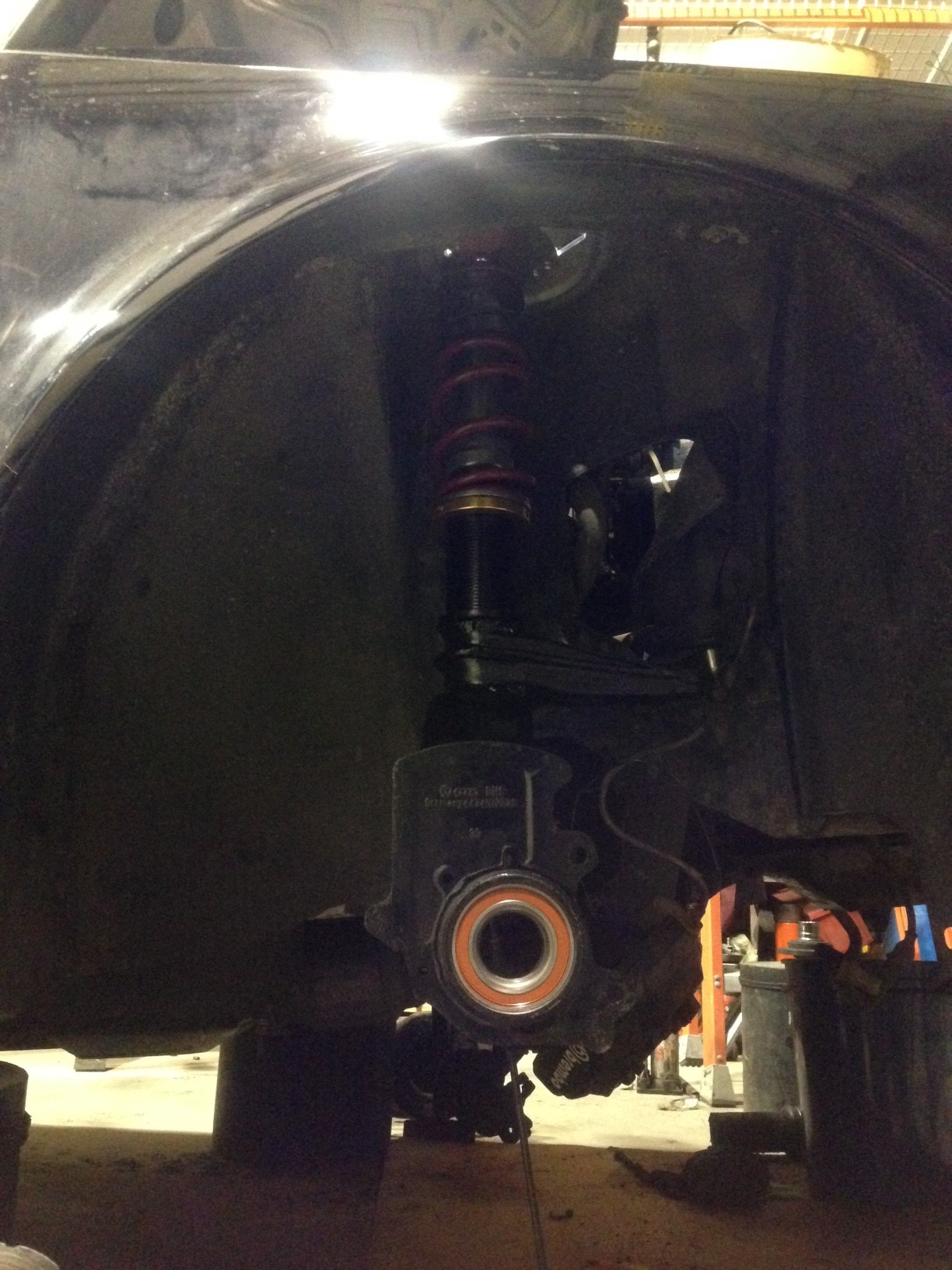

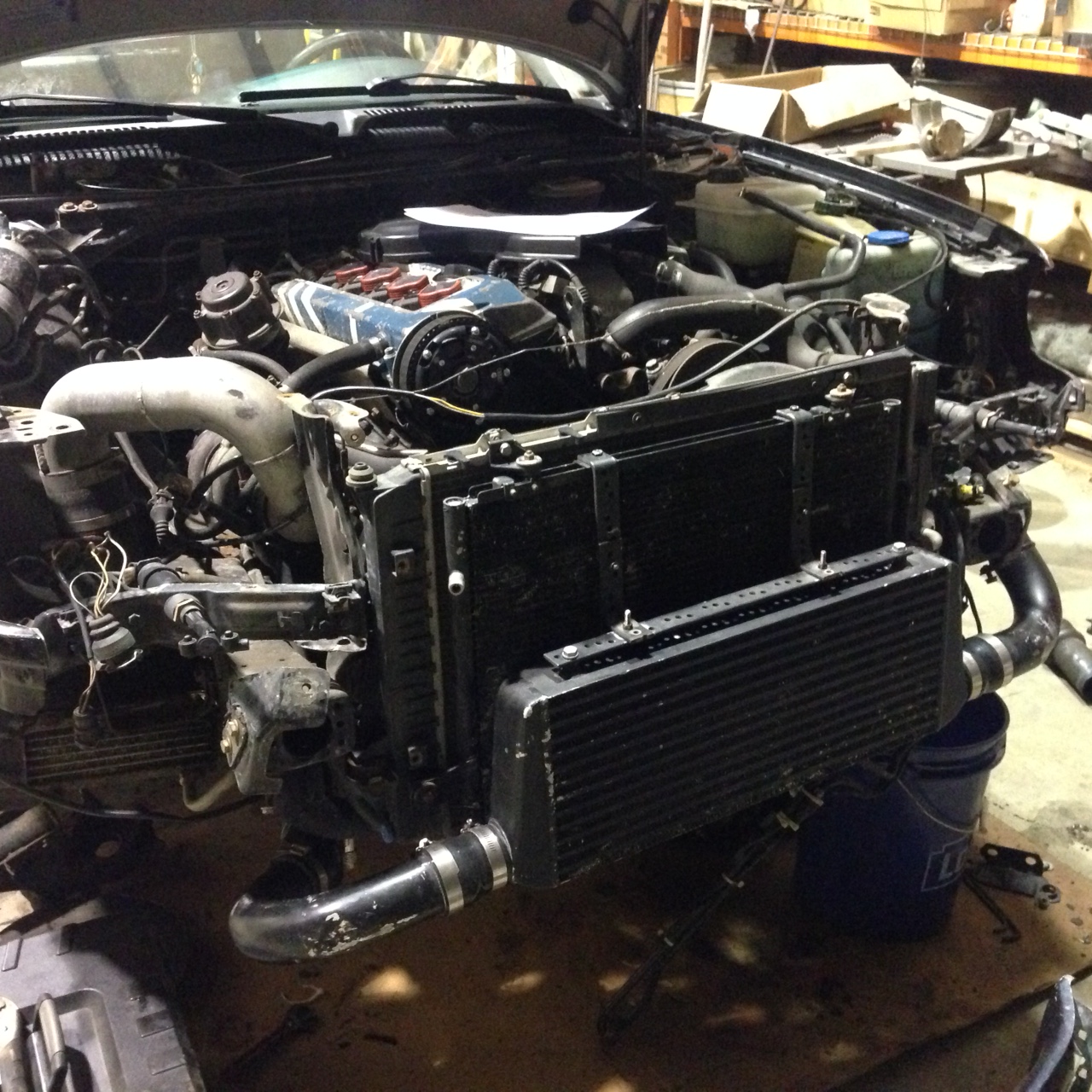

Another busy night burning the midnight oil... Got two OEM axles in hand that only need re-greasing, I got the final pipe routing for the FMIC completed, I got the wrong bearings pressed out and the correct wheel bearings pressed in, and the uprights test fit. The most stressful task at hand now, besides waiting for new swaybar bushings (the subframe ones not the LCA ones), is cutting the euro bumper to fit this IC. :wah: Here's what took place last night.

Coilovers look good on her
wow. such cambers.

FMIC's final resting place

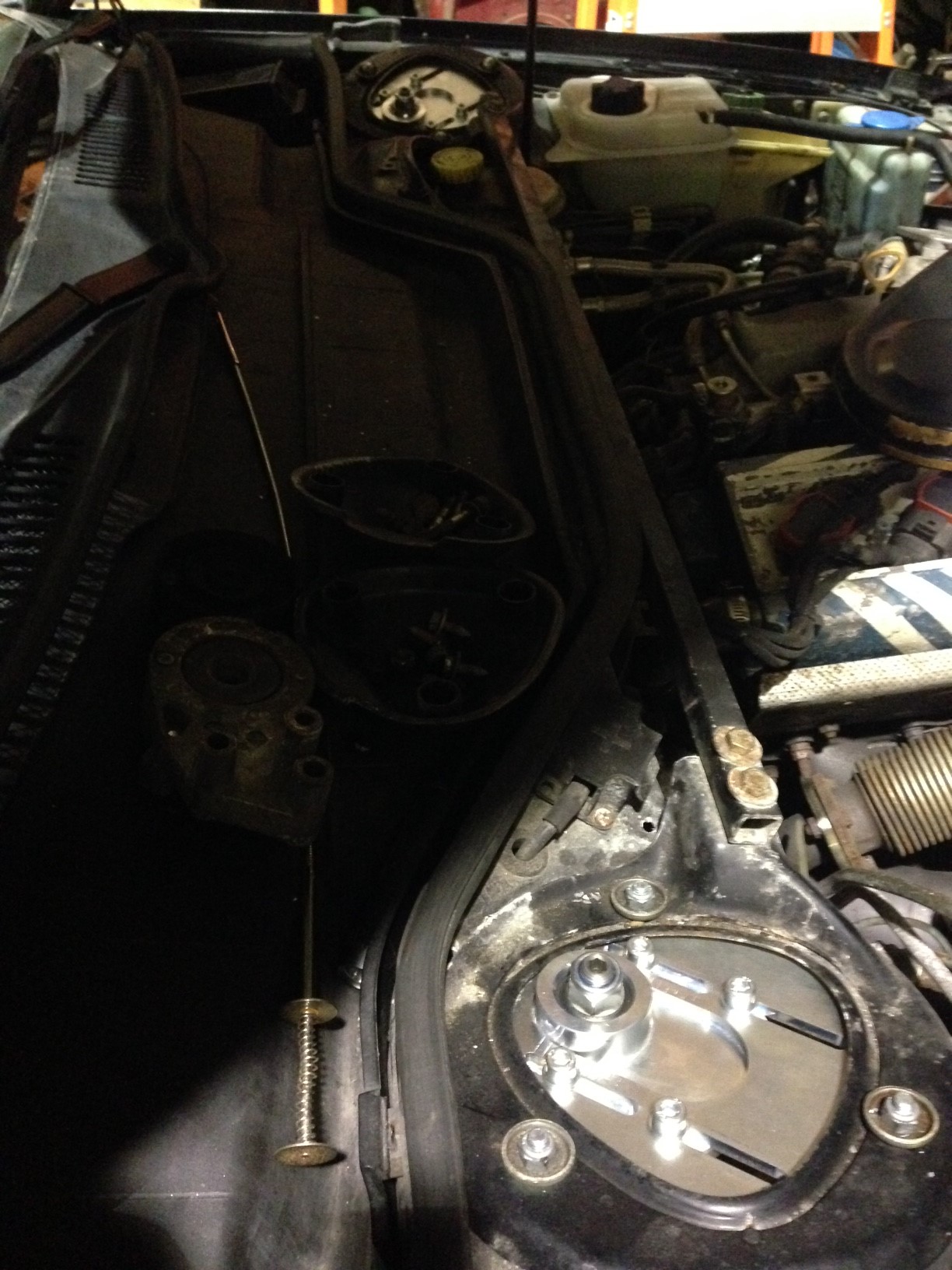

Nothing huge tonight, I got the bumper rebar trimmed back, before I start trimming grilles or anything that affects the look of the bumper, i've ordered some silicone bends to try to remove the need for the aluminum bends that are getting in the way... Got the correct axle in my possession, cleaned everything out, repacked them with moly, and installed new boots. I found a tiny bit of play in one of the thuppu camber plates between the bearing and the housing, so I need to get that sorted out. Small details remain to be sorted out, but the big picture is looking excellent.

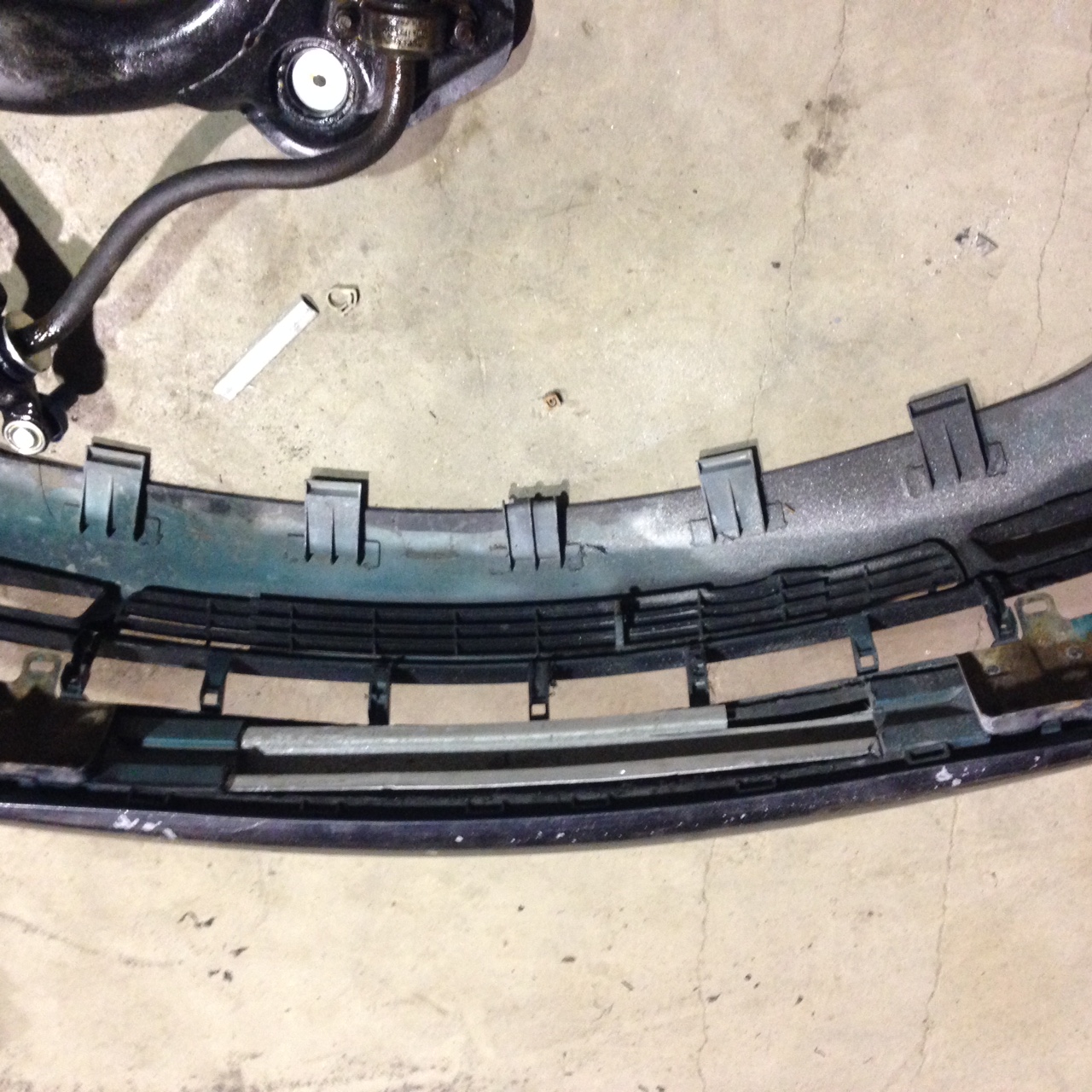

I have a definitive answer for my fellow euro bumpere'd s-car crowd considering fitting a FMIC. FOR THE LOVE OF GOD, DONT.
Ive called an all stop on the FMIC project before I hack the hell out of this bumper. Ive already gone too far and am having heart palpatations. I had figured the setup I bought would have gotten by, since it came off a euro s6 with A/C. There is a minute yet MAJOR design difference in the lower grill section, the s6 is almost plumb while the s4 has a gradual rake to it, meaning you start cutting into the material that makes up what you see from the front of the car very quickly. I'm trying one last ditch effort and ordering some more silicone hoses to remove some of the bent aluminum piping. For anyone wanting to upgrade from stock, use an AWIC. FMIC is NOT worth this amount of heart ache.

Breathe in... Breathe out... Mild weekend. Got the axles re-installed, the tie rods freed up, slathered in never-seize, and installed. Hubs are mostly pressed in, (final torque to be done) and the motor put back together. At this point, "the damage is done" to the euro bumper. I might as well keep on the course until its sculpted to fit the FMIC. I got too caught up in the availability of euro bumpers here in the states, and worried too much about others' perceptions of me cutting one up. I want the simplicity and lighter weight of an air to air intercooler, and that is going to require sacrificing something somewhere. Would I recommend it to others? no. But I think I can live with myself and my modified euro bumper at the end of the day. After all, these are just fun old cars to mod, not an investment vehicle to be kept in a bubble. Cheers.

I was able to source some nice reducing 90* silicone connectors, which eliminated some bulky hard piping. small things to keep trimming minimal. so. many. hose. clamps.

Slow updates lately... parts hold-ups, finessing everything into place, MORE unforeseen issues (rust holes in power steering hardlines can suck ma bag.) I'm finally about a day's worth of work away from rolling into the alignment rack. I got the solid subframe bushings in, the subframe in, the steering tie rods are in, I finalized the intercooler piping and clamped everything down solid, and the euro bumper is finally 90% fit, and it still looks like it should! all I can say is talk about fitting 10 lbs of shit in a 5 lb bag... but here is the fitted modded bumper. I still wouldnt recommend doing what i did!
