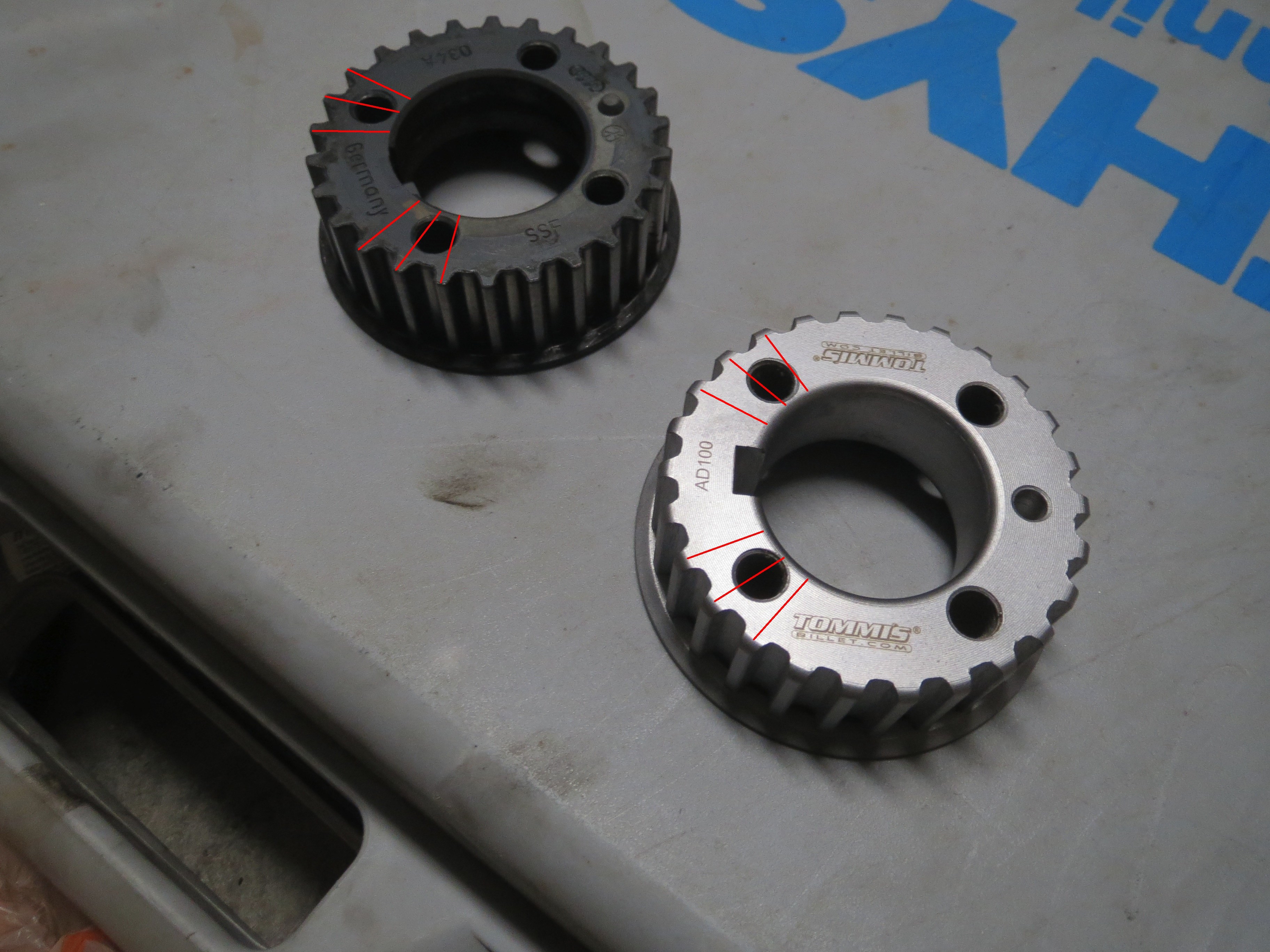

A few things, actually:
- Oil pan gasket
- Oil pump gasket
- Crank seal
- Timing belt
- Crank cog (replaced with this one)
- Associated hardware
My only other idea is that the new cog is slightly offset from the factory one (which it is; I noticed when it didn't line up with the imprint on the pulley), but it's not by much:
In any case, I really appreciate you guys helping out through the beers and all! Despite not knowing what to fix, it's nice not knowing together. :beer:
Re: Kevin's 200 20v + B5
Hmm, if the crank cog was offset a bit, I think that actually would/could make the tension all out of wack... That may very well be your problem. I'd probably put a brand new stock one on there.

In a way, I'm glad it's inconsistent, because it confirms nothing has gone catastrophically wrong (yet). I think the noise is as a result of an over-tensioned belt, but, if I'm honest, I'm not really sure what to do about it.
I guess I could go to the stock pulley, though it'd be a shame to do a downgrade. I think the only logical step is to tear it apart again and see if I can isolate the cause first. I'll check that the t-belt is the same length as the old and, without fully torqueing the crank bolt yet, see if I can time the engine normally with some combination of the older/newer parts. Then order parts, if need be.
Other ideas 100% welcome, though! I'm not a fan of removing the pulley again, since I had to borrow the crank-lock tool from a mechanic.

Haha, excuse me. :) Given the intermittence of the sound and how capably the car made it up my driveway, I find it highly unlikely the engine is permanently or catastrophically incapacitated.
In any case, I was under the impression the OEM cog was prone to cracking the keyway? Is that not as big a concern as I thought? I'm a big proponent of "there's no kill like overkill," so I just sprung for the best I could find, so I won't have to upgrade in the future. I'm too broke for fancy impact tools, so I have to tighten it conventionally anyways. If that'd be cool with the OEM cog, I have no issue going back to OEM.
The sintered OEM crank cog is prone to fracturing with use of impact tools. You should be fine to run it, if need be. Just look for hairline fractures, especially in the bolt holes/threads and at the keyway.
You should be fine... however, the fact that the Tommis one (possibly) isn't working for you gives me pause. How many other people have them (myself included) and have had no issues? Are we talking install error, manufacturing defect, bad luck? Definitely weird.
If the indexing of the teeth is not the same on the two gears, then there is most definitely a problem. An adjustable cam gear may alleviate that though eh?
Anyway, the stock cogs are not an issue when installed properly and replaced with new each time they are removed. It's when you want to reuse the cog that having a hardened one is important.

It's a CNC piece, so I'd think it's close to impossible to have it produced inconsistently - at least without being noticed, and I can't see how I'd be the only one to have issues.
I considered an adjustable cam gear, but that seems a bit like masking some issue in the system, rather than fixing it. Happy to get one for other reasons, though. :)
This weekend, I'm hoping that reinstalling the old parts one-by-one will reveal what confounding variable is causing my timing issue (and hope that the over-tensioned belt was all that caused the noise, or that the cause will be otherwise revealed).
